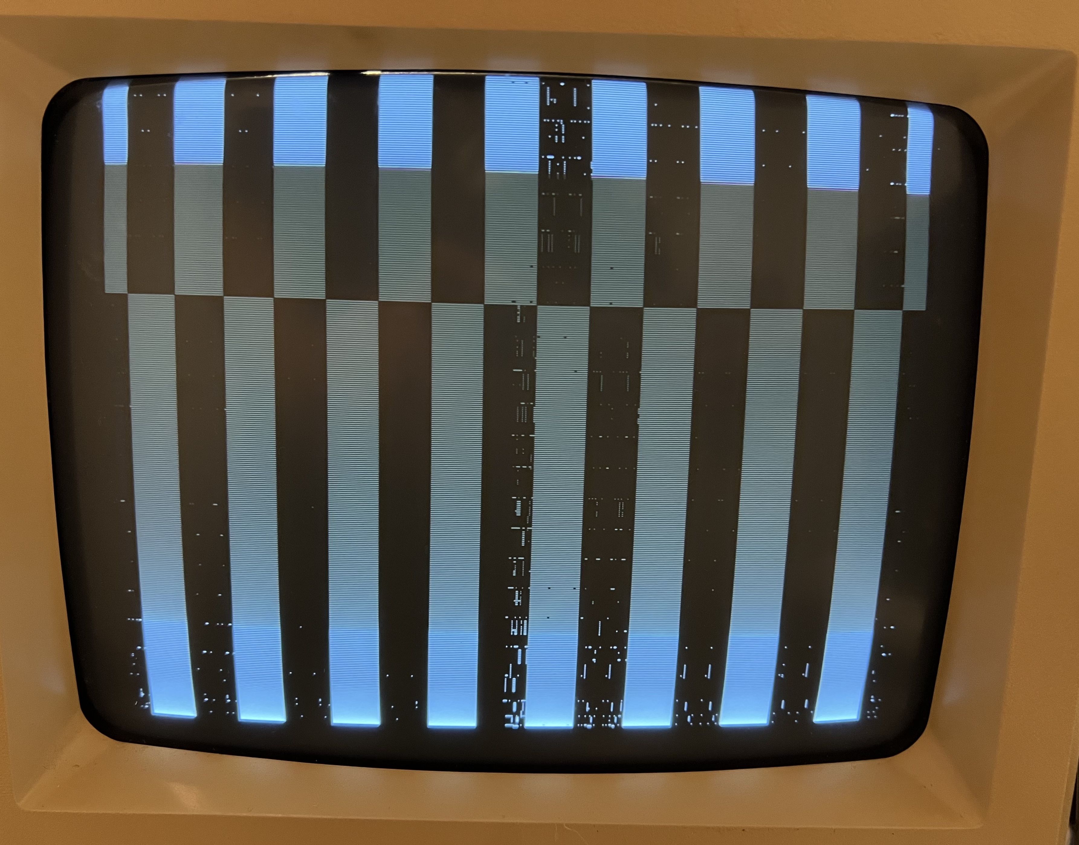

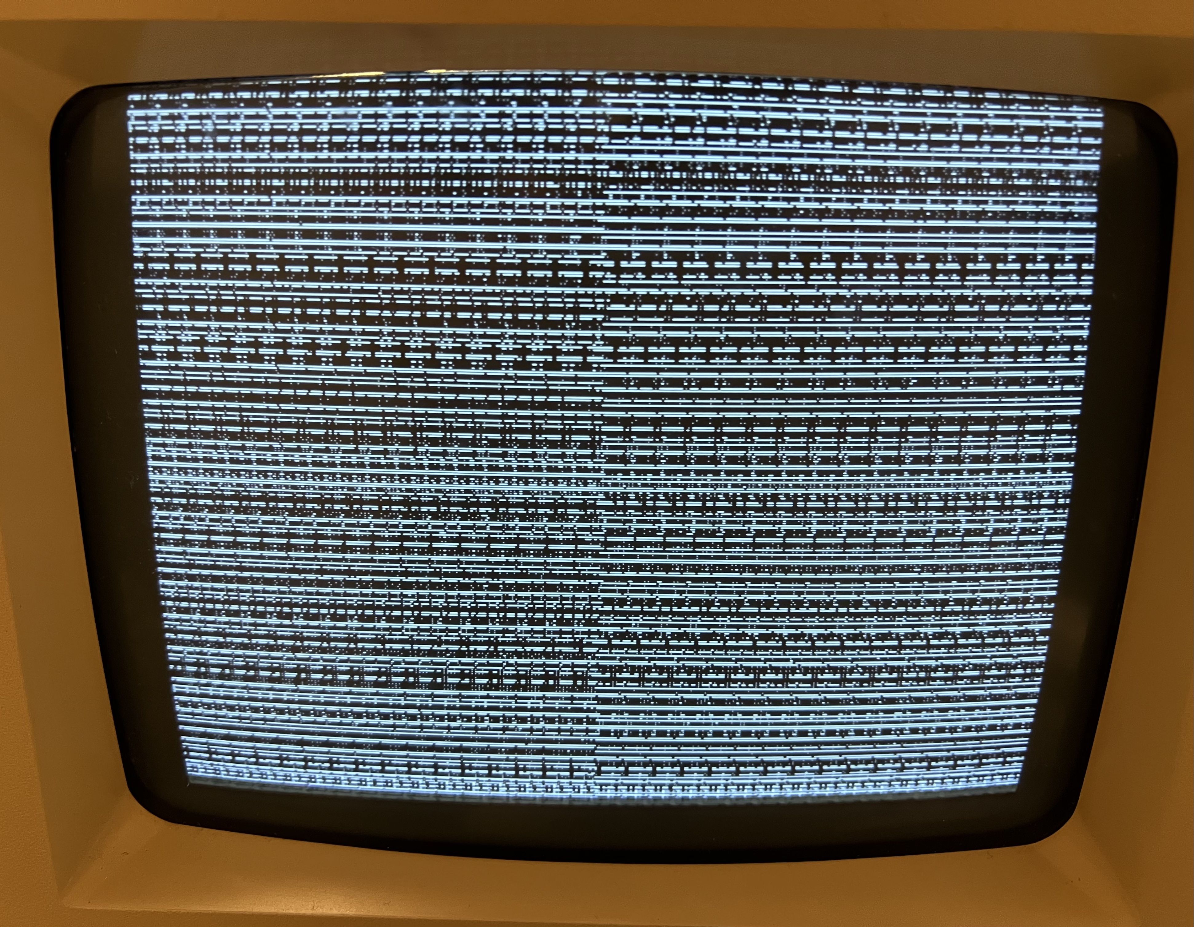

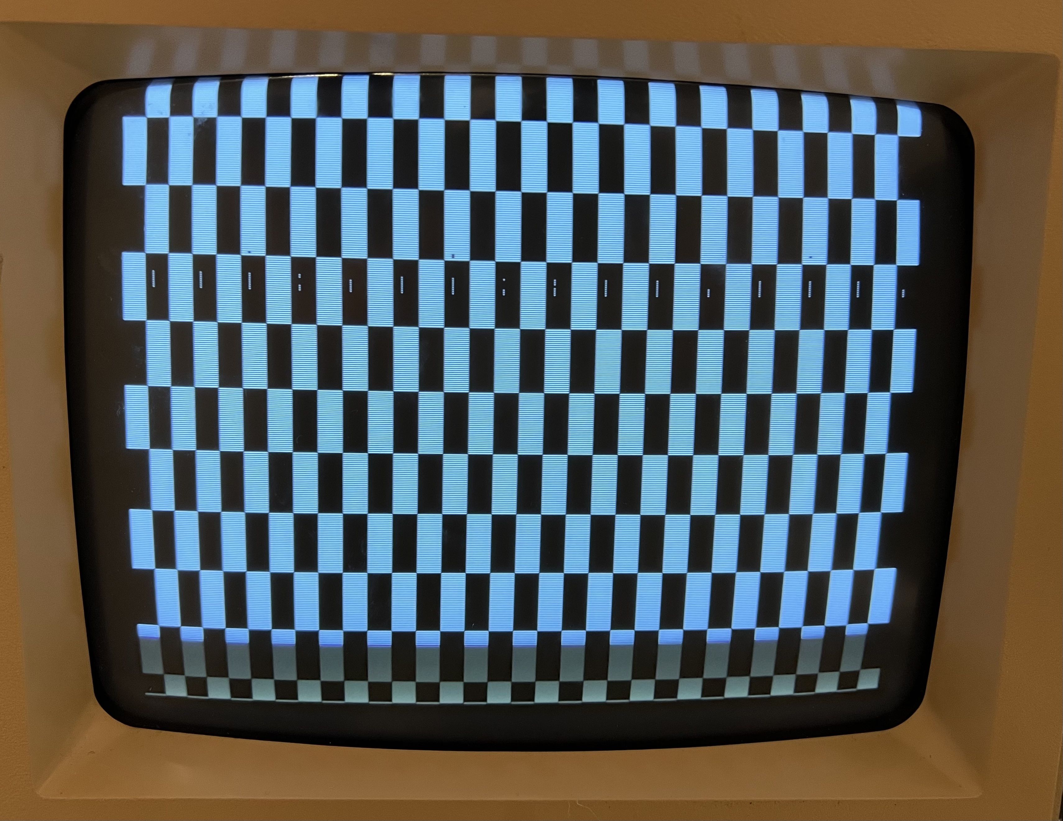

- Tested with 3 different confirmed working logic boards, screen will either show jail bars, checkerboard, or fuzz depending on which logic board I connect (screenshots attached)

Here are the screens that can come up while analog board gets the 4v:

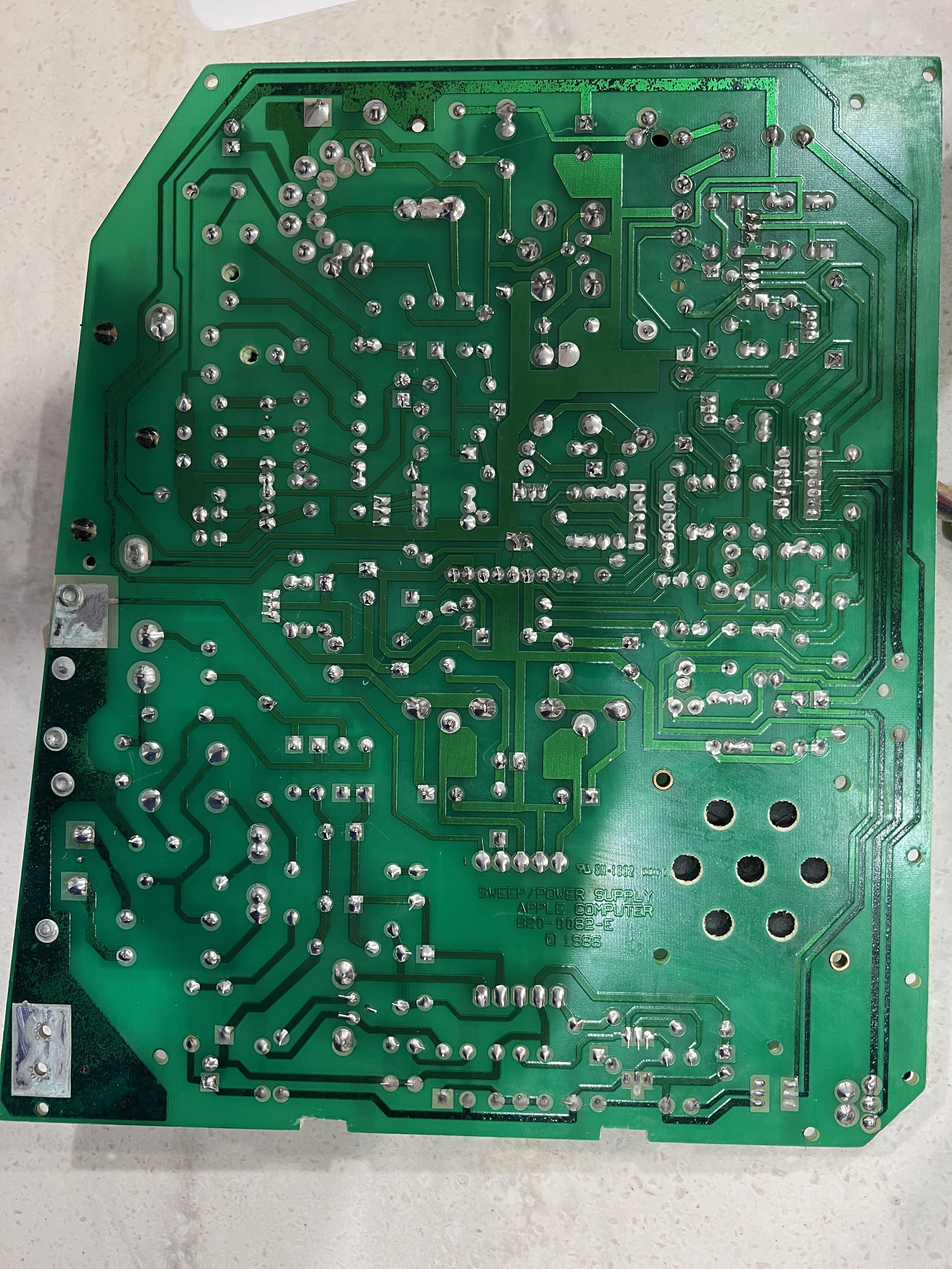

Image of analog board also attached. Thank you!!

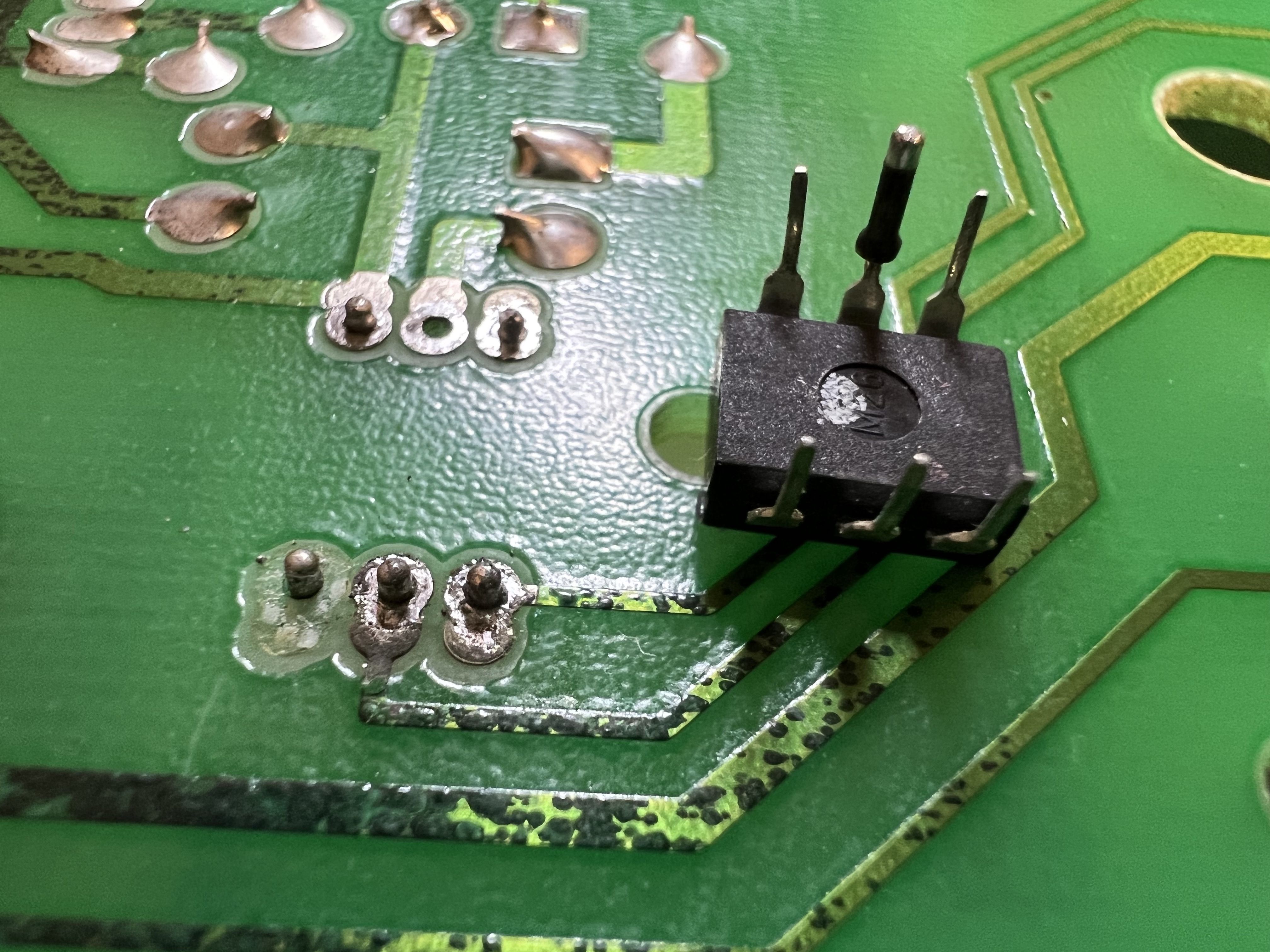

Root cause found! Bad U3 chip!!

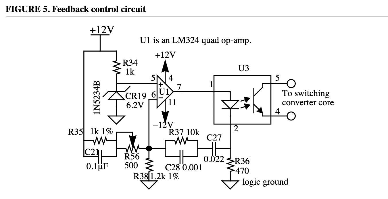

I pulled up the schematic for the board, and it showed the +12v is directly regulated, and the rest are slaved to the +12v. I checked and the +12v was reading +9.7v, so I figured it was not being regulated correctly.

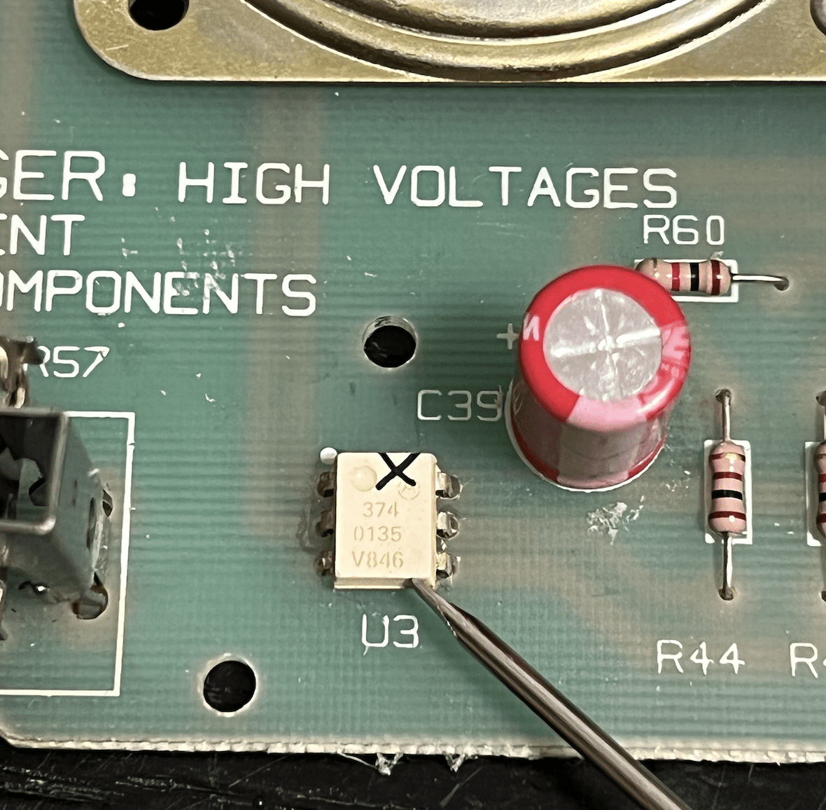

I already checked all the components in the above except for U1 or U3, so I figured it's either one of these, or a bad joint. I replace both and board worked! From there I verified board works when U1 was reinserted, but failed when U3 was reinserted.
U3 is an 4N35 optoisolator. Hopefully I can use a generic replacement like this one
It's interesting that with the 4v input, CRT was displaying different screens depending on which logic board was connected, I would've expected the same to be displayed for all 3.
Here's the guy responsible for all the trouble 😠

U3 strikes again!

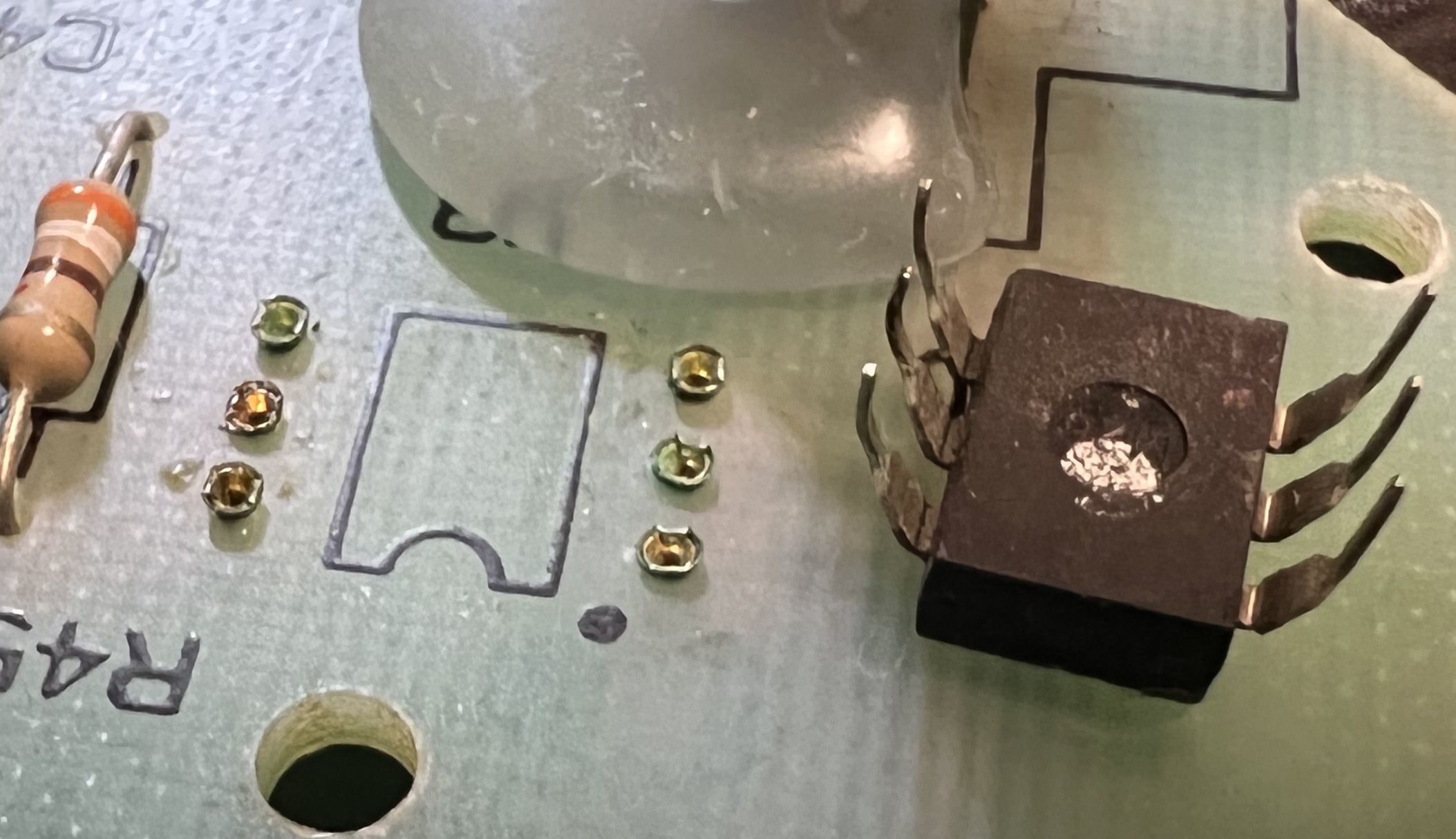

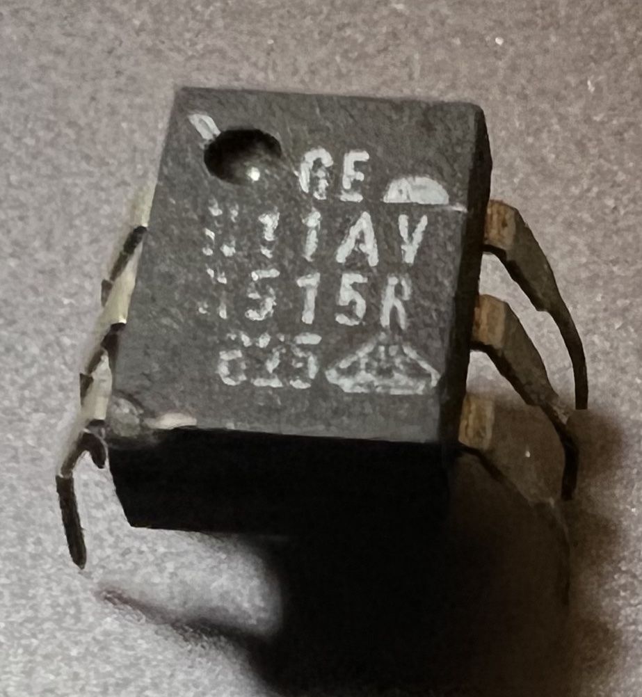

I re-capped an international Mac Plus analog board. It booted just fine. The 5v rail was a bit low at 4.78v, but when I went to adjust the pot nothing happened. After cleaning and testing the pot, I was still getting the same results. I then realized it was the U3 probably again!
After replacing the U3 I was able to adjust the voltage again. This time it was black GE branded 4N35 IC that went bad.
I tried to desolder the legs, but to my surprise, they had tiny sockets! Be careful, your IC may be socketed too.
Another one! Yes - I've never seen the sockets on NA boards, but I've heard of them being on International boards. Certainly makes troubleshooting / fixing easier.
