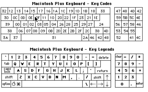

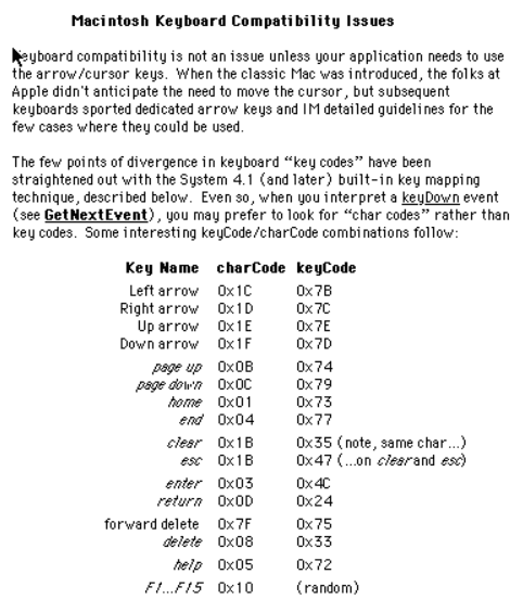

In THINK Ref Viewer, in the page named "Keyboard Compatibility" you get the following advice; the cursors first appear with the Mac Plus keyboard (they are not part of the original one).
Unless you program for System version before 4.1, you should stick with this above advice. You can use the exact notation 0x1C when you're using a short iirc. The compiler will deal with it.

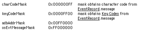

The other parts of an event's message are as follows:
just use those masks as you do with charCodeMask to get to the other bits of info you need.
