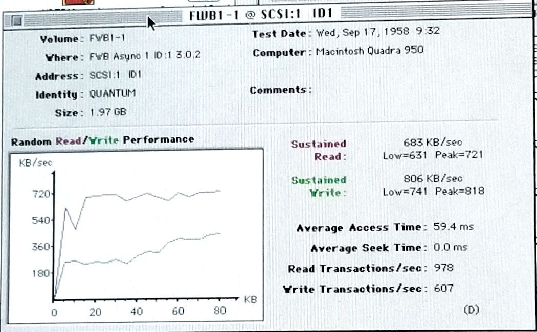

@eric Do you have any thoughts on why the BlueSCSI v1.1a performance is so slow on the Quadra 950? It doesn't seem able to even clear 1Mb/s. The SDCard shouldn't be an issue and it has been fully formatted. On Windows 11, it sustains writes at ~21Mb/s and reads at ~98Mb/s -- far above Mac rates. The main problem seems to be the access time. 60ms is very slow (see below).
The card must be OK, since SPI is running at 50Mhz -- here is the log.txt info:

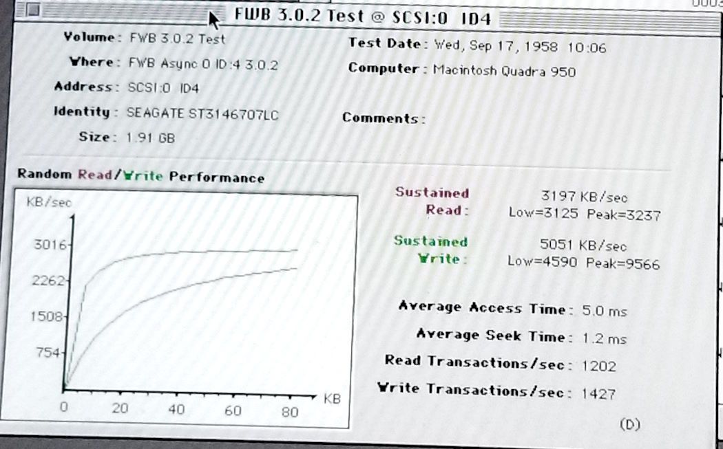

Comparison of Cheetah vs. BlueSCSI -- both using the same FWB 3.0.2 HDT driver on the same Quadra 950:
Here is my Seagate ST3146707LC 10K Cheetah Drive on the Quadra 950:
Here is my BlueSCSI v1.1a with v2023.11.16 firmware on the Quadra 950:
Apparently, Cheetahs sometimes DO win. :D
I wouldn't expect BlueSCSI 1.1 to be as fast as a Cheetah drive, but I'm just wondering if there is some other problem or issue since it is far from its theoretical max.
Anyway - interested to know if you have any suggestions on what might improve BlueSCSI performance in my config, if anything. Thanks.

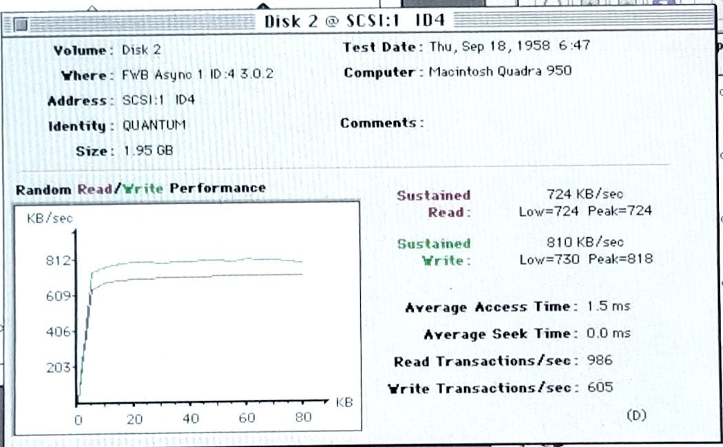

Adding Berg power to the BlueSCSI improves the access time issue and slightly improves overall R/W performance. 1.5ms access time is good.
So, there definitely seems to be insufficient power via SCSI alone for the blue pill on my Quadra 950. My guess would be that BlueSCSI always needs Berg power, even if it seems to work without it. There are probably current draw issues.

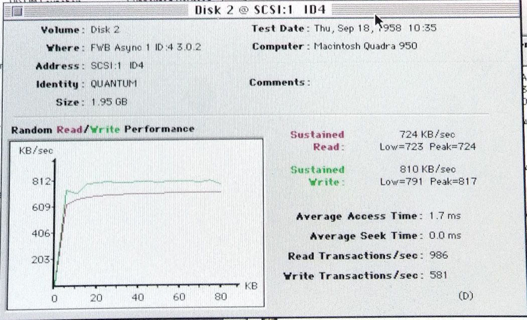

I put together the pin headers for another Blue Pill from the same batch to get the BlueSCSI working again after the failed overclocking/damage. The performance is similar.
BlueSCSI (Berg-Powered) - Quadra 950 - FWB3.0.2:
