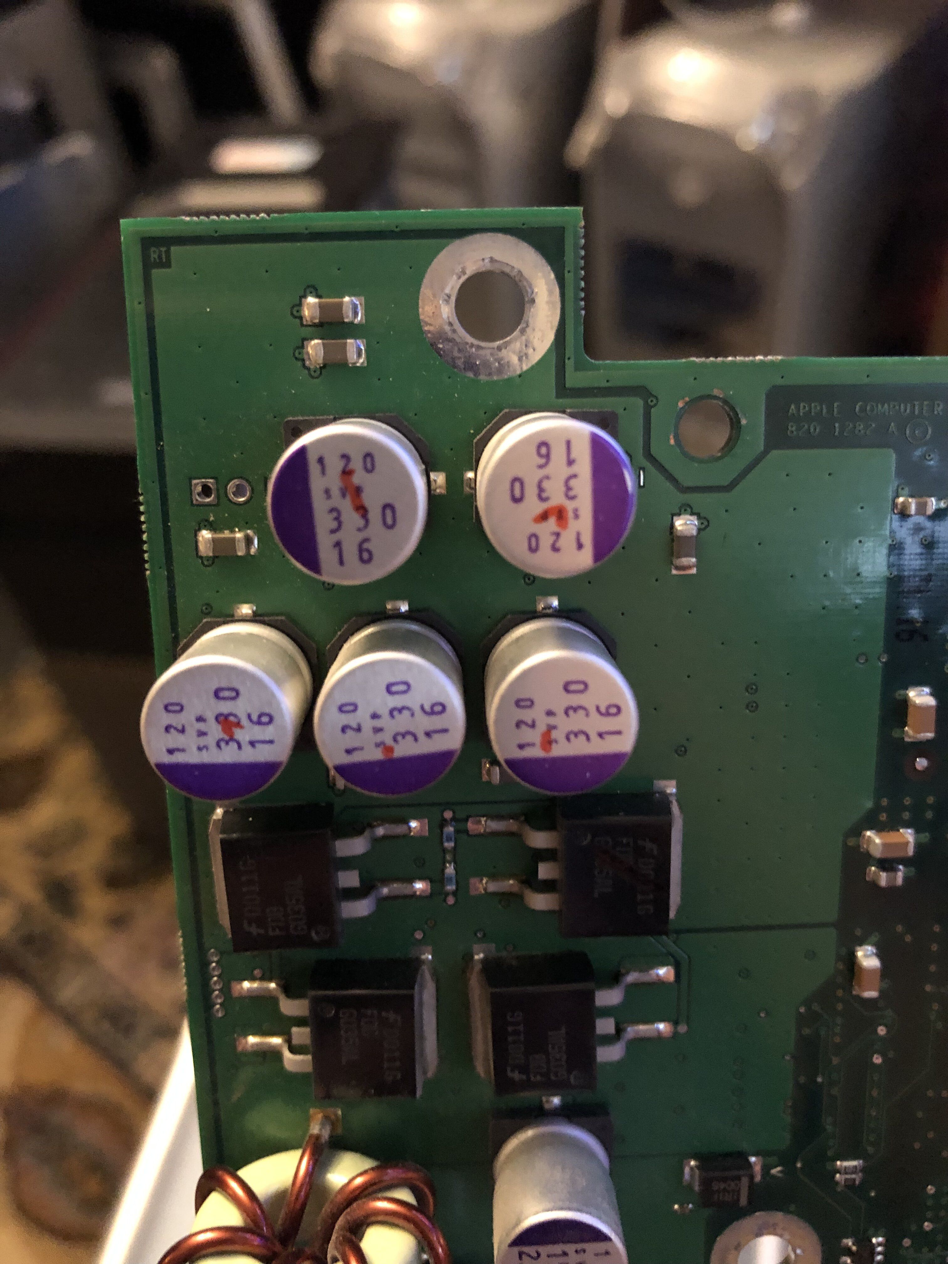

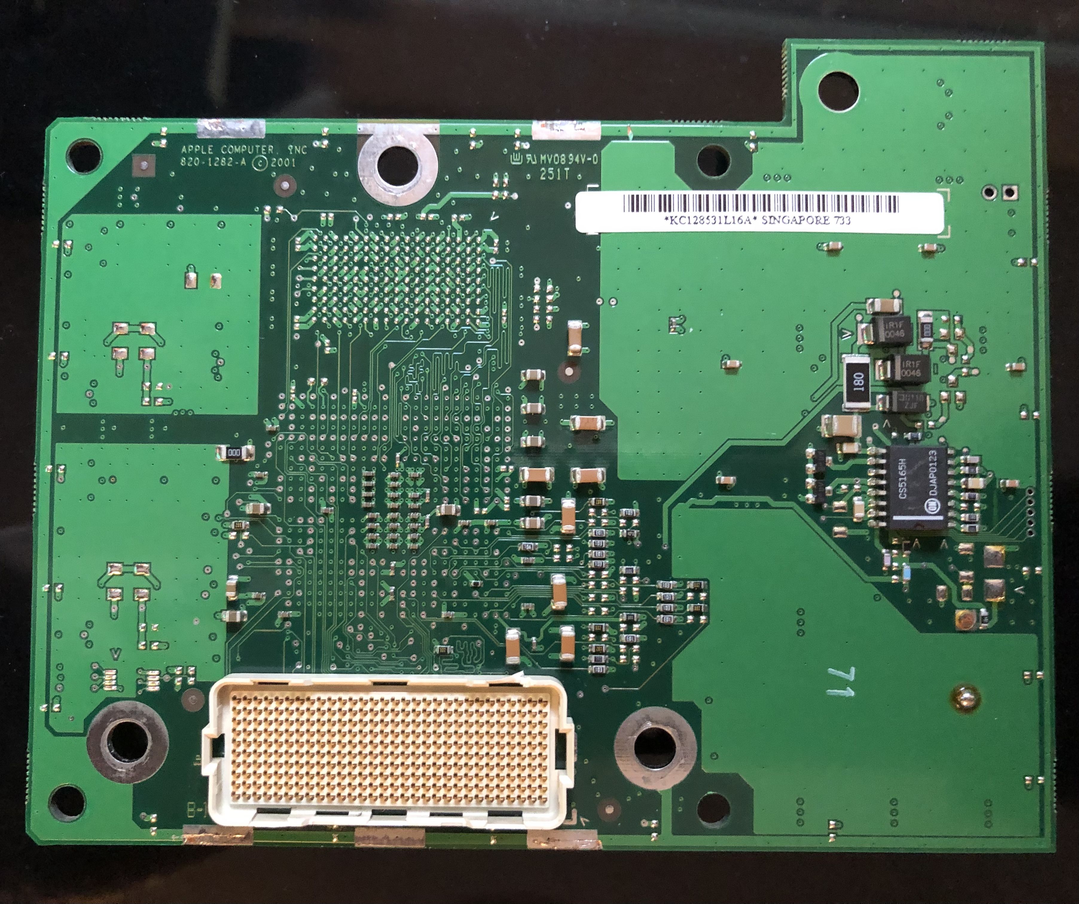

I have a few loose daughter cards for QS & MDD. First off the QS is green
and they debuted in 2001, so likely the daughter card will be dated as such (All of mine are). QS discontinued 2002 at the August introduction of MDD so while I havent run into a 2002 dated card myself, I have seen some photos of a few 2002 dated QS daughter cards on the interwebs.

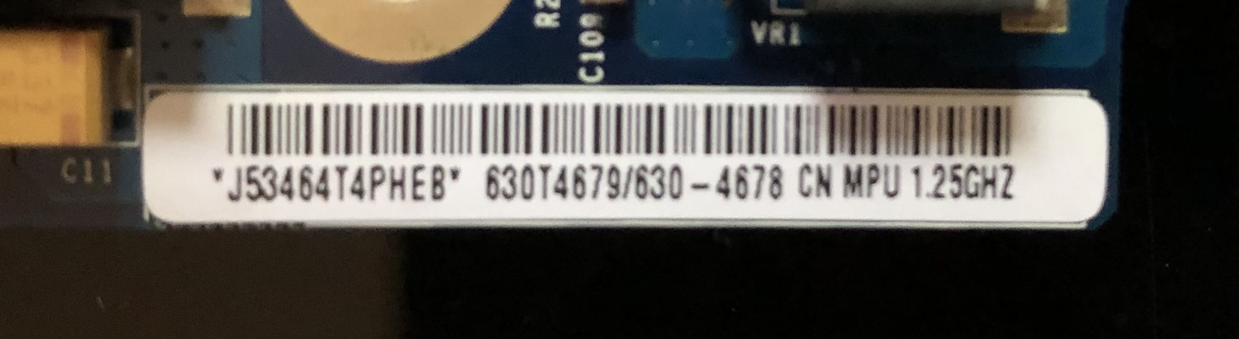

and MDDs are blue. Below are a couple 1.25ghz MDD daughter cards. You can see the variation in color and some different components were used despite being the same card. MDDs debuted in 2002 thus the daughter cards will reflect that date (at least I have not run into anything later). MDDs discontinued January 2003 but was brought back July that year as a OS9 compatible machine out through 2004.

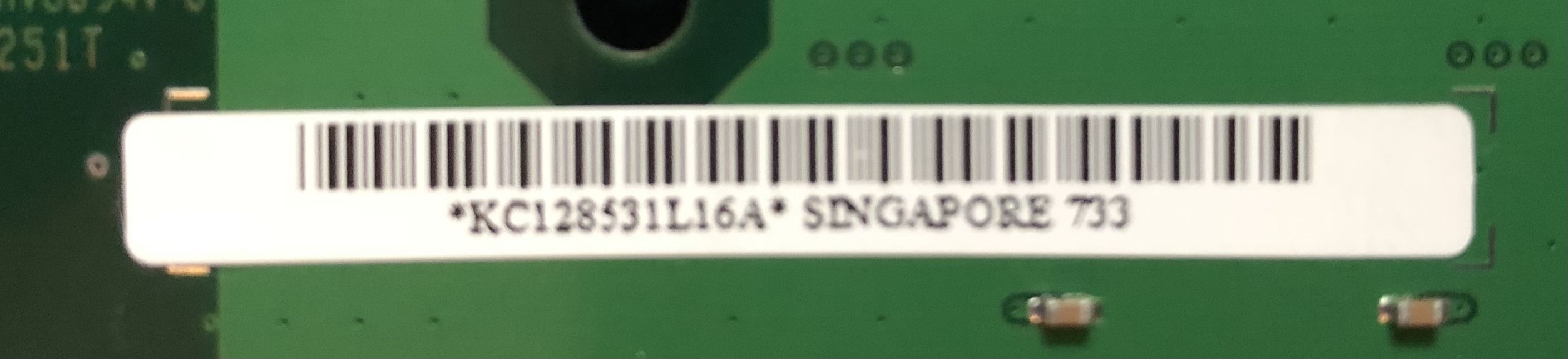

Again I’ve not done it myself but have researched it while waiting to run into cheap GE or DA lobo bits to butcher. :D Another difference is the cpu itself, the QS is a 7450 and the MDD is a 7455 cpu so if you look closely, they both state that on the die itself. The 733mhz QS pic shows this pretty clearly.

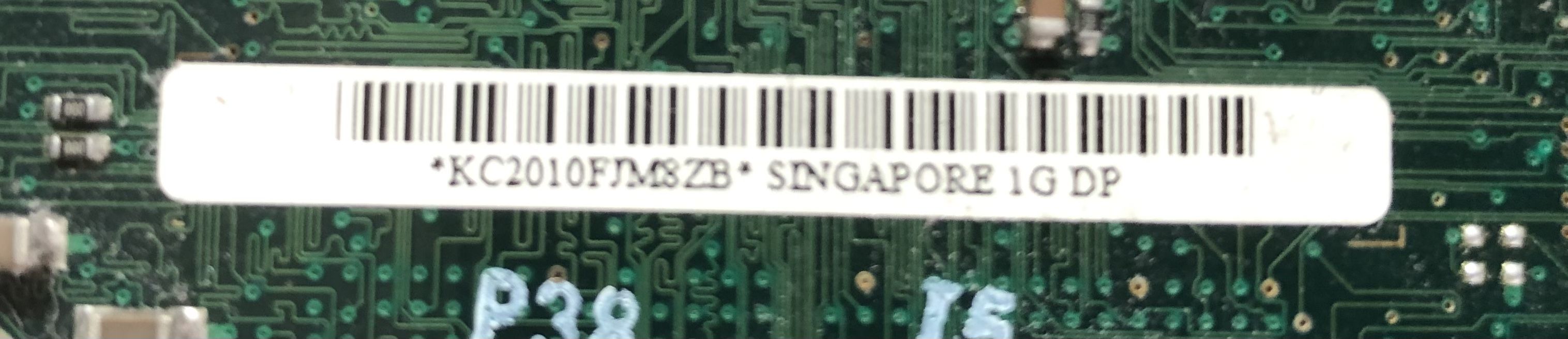

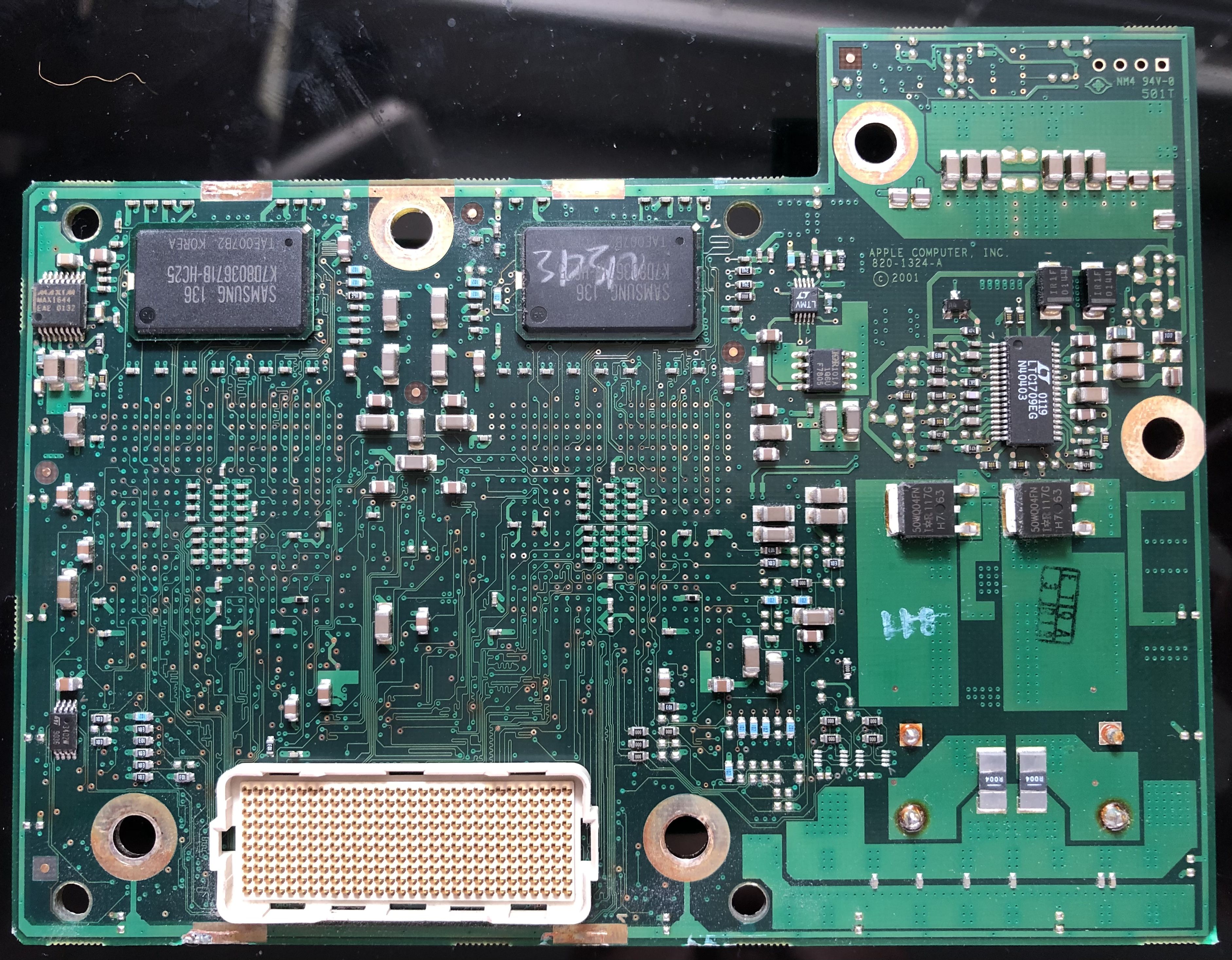

There is alot of helpful experience/knowledge about G4 era Powermacs over on macrumors as well (which is where I did alot of my research on D card compatibility). Quite a few folks over there still daily-ing or close to that their PowerPC Powermacs. Coincidentally, I was doing some maintenance this week on my dual 1ghz Quicksilver (been a 3 or 4 years & needs to be cleaned). Anyways, here is a photo of that daughter card vs the single cpu 733mhz above for comparison.
The date is a little harder to find on these - upper right hand quarter on the backside of the daughter card. A related point to be aware of are the QS heatsinks are different for the single and dual cpu models. The dual CPU heatsink is bigger. Below are some pics of their difference in design - the dual cpu in the pic has the red decal. It can be difficult to spot the differences in online auctions leading to buying/trading for the wrong unit.
The part numebrs on the bottom are convenient ways to differentiate them as well vs just visually which is suprisingly easy to mess up.
