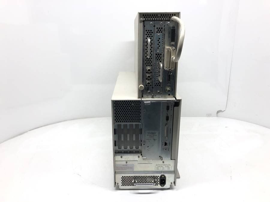

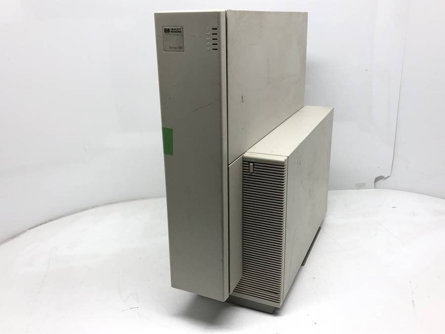

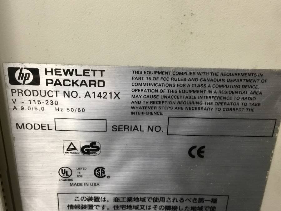

Hello,
there‘s this HP monster up for sale (“as is”), I couldn’t find much info by googling around.
Curious to see that there’s no serial number (washed out by time? Proto?).
I’m afraid it may require huge extra investment for having it up and running again, I doubt it takes a plain VGA display and PS/2 keyboard / mouse.
Any hint?
