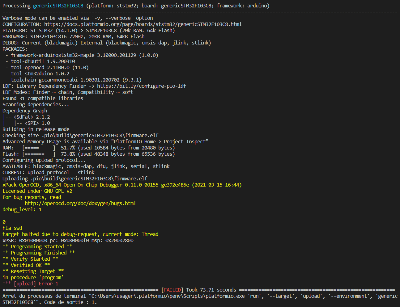

I reflash the Blue Pill in my BlueSCSI using Visual Code Studio, PlatformIO using the Upload task within the project, since the STM32 cube utility has never worked with my counterfeit Blue Pill (which I didn't plan on getting, it's what a generic electronics store sold me).
When the task runs without issue, it shows this, topped off with an error warning way past the upload and verification step (so I guess it's alright!)

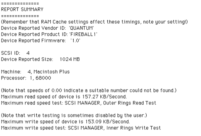

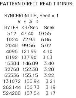

I used SCSI Director Pro v2.17 from a FloppyEmu, so I could intercept the bootup sequence of my System Folders in my BlueSCSI drives and force the launch of SCSI Director before anything else.
Generic info, the 1 gb hda partition I tested shows up as a Quantum fireball.

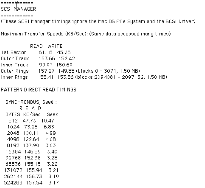

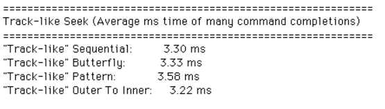

Track-like seek, BEFORE <<-->> AFTER (super slight improvement - a fluke?)

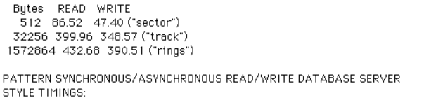

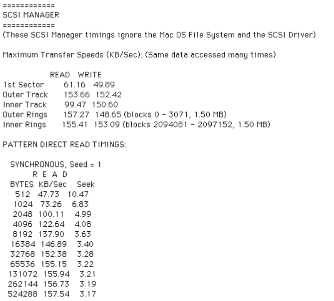

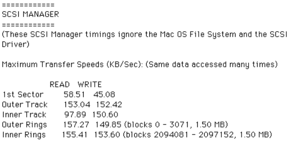

SCSI Manager, BEFORE <<-->> AFTER (slight improved in the 1st sector and inner track, slight slowdown in inner rings)

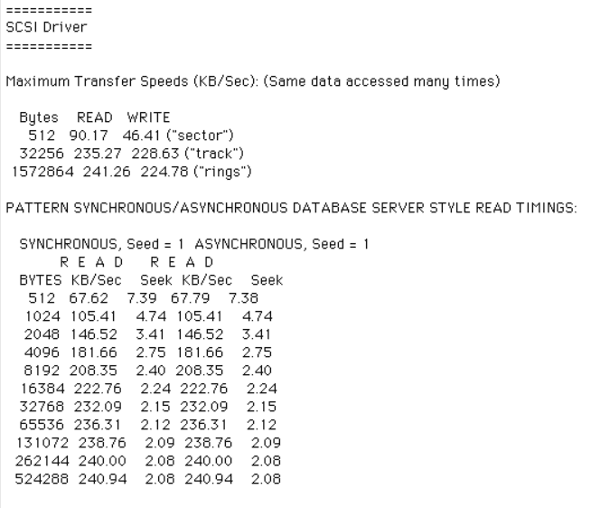

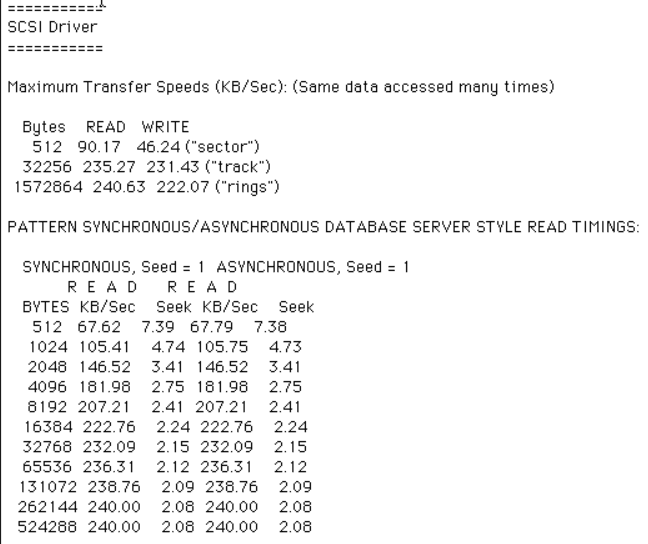

SCSI Driver, BEFORE <<-->> AFTER (slight up and downs, a toss-up)

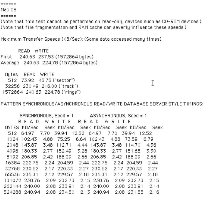

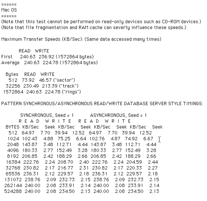

Mac OS, BEFORE <<-->> AFTER (mostly slight slowdowns)
TL;DR: the changes are probably due to the variance in measurements and there's probably very little change between versions for a Mac Plus. Perhaps the bottleneck for this system is elsewhere...

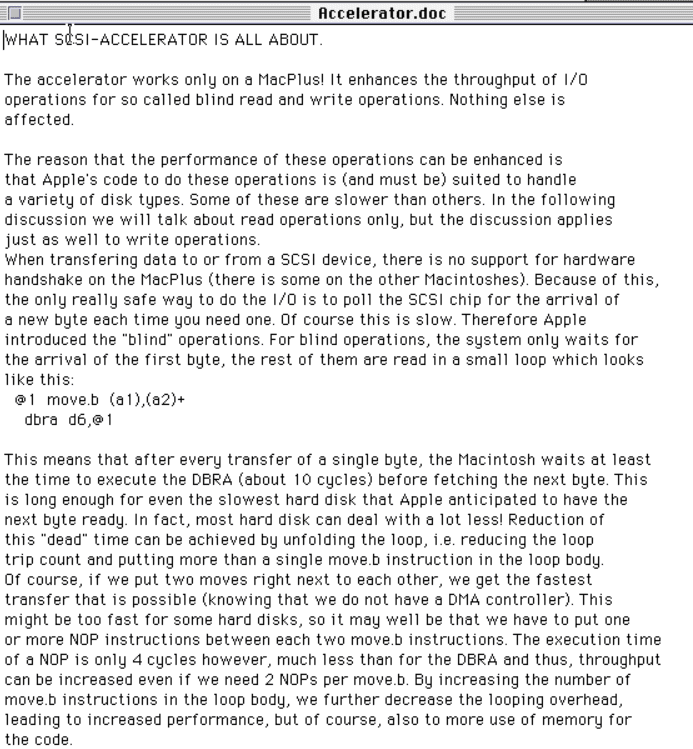

But then, a true hero appears @VicNor on the discord server! He had specialized knowledge about Mac Plus and SCSI drivers - it turns out several drivers of the day were written for the lowest common denominator between manufacturers and there are lots of delays included in the low level read and write routines. The way to get rid of these delays is with SCSI Accelerator which he told me about.

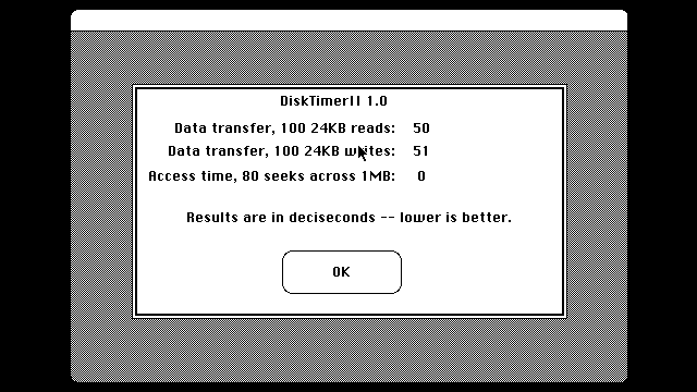

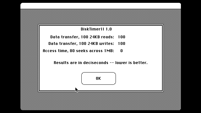

I also checked out the link provided in the mac garden page of SCSI Accelerator to a LowEnd mac article which refers to DiskTimerII for simplistic benchmarks.
Basically, you select one of many extensions named after how many delaying operations it leaves between read/write commands. I went all-in and chose 0 read delays, 0 write delays, an extension called 'r0w0s5'
Before SCSI Accelerator:
After SCSI Accelerator r0w0s5:
double speed, nice!
next up, let's redo the SCSI Director Pro tests:

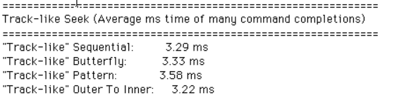

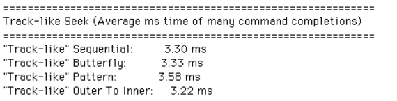

Track-like Seek (no significant changes here)
BEFORE <<--
-->> AFTER w/ SCSI Accelerator
SCSI Manager (basically the same):
BEFORE <<--

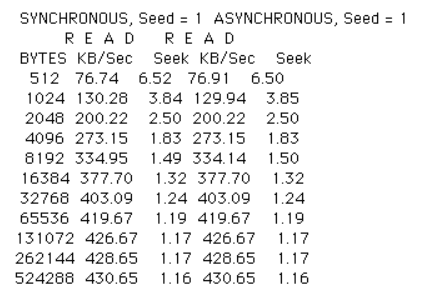

SCSI Driver, *HUGE IMPROVEMENTS* here in the order of 60-75% faster!
BEFORE <<--

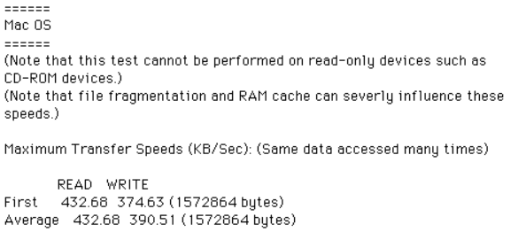

MacOS (cumulative results add up a lot near the end, big improvements)
BEFORE <<--
TL;DR:

Here's the start of the .doc that comes with SCSI Accelerator:

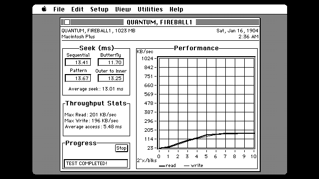

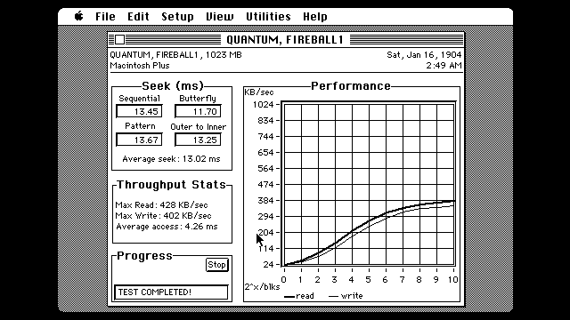

More BlueSCSI speed tests by tweaking the SCSI driver on my Mac Plus w/ system 6.0.8
I tried using the suggested Silverlining 6.0.1 for driver changes and SCSI Director Pro 4 for visual benchmarks.
I got a drop of performance when I tried the "Silverlining fast handshake one", it got down to 201 KB/s read 196 KB/s write.
When I used Silverlining to put back the "Apple drivers fast blind", I got back to similar previous results that I got with SCSI Accelerator v7, 428 KB/s read 402 KB/s write.
The SCSI Accelerator System extension had no noticeable effect whether it was present or not while "Silverlining fast handshake" was installed.
One surprising (to me) thing is that only the bootable volume's driver is used for everything, it's not a per volume basis, am I right? I was using 5x 1Gb volumes on my microsd card here.
It was worth a shot at trying Silverlining's own driver, but it clearly came with disappointing results here.
With Silverlining Fast Handshake (& SCSI Accelerator v7 extension)
With Apple driver fast blind (& SCSI Accelerator v7 extension)
