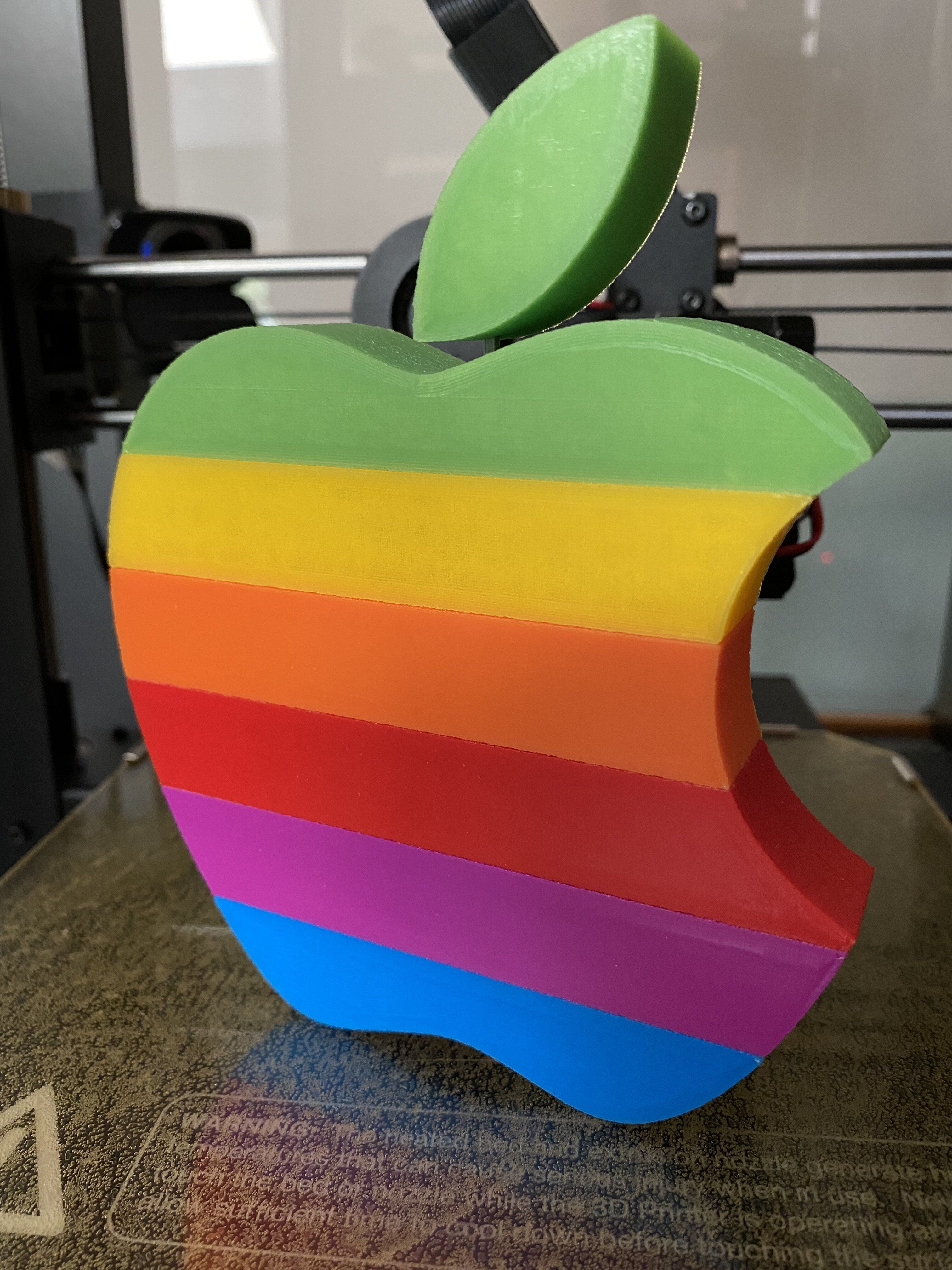

Very pleased with how this turned out! It took some doing to find a reasonable match for the six colors — the yellow could be a bit more golden, the green a bit more saturated, the blue a bit lighter — but in context, I think the colors work well together.
Yellow, green and blue aren’t colors I tend to prefer (or keep filament on hand for), and I thought I might get by with purchasing a small amount of 3D Pen Filament to get just enough to print two of these models. I found Blue that was a good match, but it proved too brittle to be left unattended while printing; I never could find a suitable Yellow or Green. Eventually, I had to give in and purchase whole reels.
Try this at home!
STL files are here. (They’re attributed to “PierreNick.”)
Orange, Red, Purple and Grey (for the pins that hold the parts together) are from Hatchbox, my go-to filament. Blue is Overture PLA Plus Digital Blue. Yellow and Green are from Flashforge.
I flopped the STL files so the front is the top of the print, for the best finish. (I also used Cura’s “Fuzzy Skin” feature to give the sides a bit of texture.)
I found it necessary to reduce the size of the pins to about 90% to get them to fit without having to use excessive force — and they’re still difficult to insert and remove! I may try again slightly smaller.
