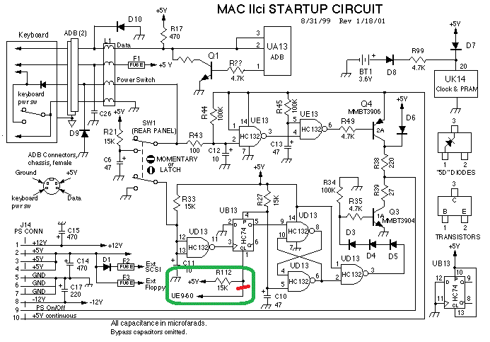

The portion of the soft power circuit that interacts with the machine's OS is circled in green in the image below. Essentially, when the machine is on, pin 1 on UB13 (the reset pin on the flip flop) is pulled high via R112. When you select "shut down" in the Finder, Mac OS does its cleanup work, then signals the ASIC UE9 to pull pin 60 low, which pulls pin 1 of UB13 low, too. This results in pin 5 of UB13 going low which, via a series of steps pulls PS On/Off low, turning off the machine.
In your case, the power on circuitry is generally working properly, and the machine is staying on, which suggests that pin 1 of UB13 is never being pulled to ground, and that you have a discontinuity near where I have drawn the red line within the green circle.
I had a similar problem, except the discontinuity was between UB13 and R112. In my case, the machine would turn on properly, but pin 1 of UB13 would just be floating and the machine would immediately turn itself off again.
You mention that you found no problems with the traces: in my case, the damage was actually within a via. If I had one probe on the via, it would show continuity to pin 1 of UB13, and also to pin 60 of UE9. However, there was no continuity between UE9 and UB13 directly: the multimeter probe in the via was bridging the damage. There were other posts on 68kmla indicating problems with the same via, so I think it is a common problem: the via is right under the big axial capacitors, and I think it is attacked by the leaking fluid.
Maybe this will be helpful to you in fixing that last machine.
Thanks for the great info! I had no idea how the system shut itself down. I spent a couple of hours last night and then a few more today verifying what I had measured last night.
I have continuity from UB13 pin 1 to UE9 pin 60 measuring directly from pin to pin on the two chips. That tells me that the via you mentioned is good, correct? At any rate, I've inspected the via under magnification and ohmed it and everything looks good. As a last ditch effort I did clean the via up with flux and braid and used fresh solder to ensure good connectivity on each side of the board. No change. I have good continuity from +5vdc through R112 to UB13 pin 1 as well.
I have ohmed from SW1 all the way to J14 pin 9, going from component to component along the way. Everything measures correctly for both connectivity and resistance. Both the continuous and switched 5vdc lines ohm good back to J14. I've even tried a different PSU (again) with no joy.
I'm missing something, but have no idea what. I've decided to build an extension cable for the PSU so that I can make measurements with power applied. Should have that soon, but don't think I'll have the time to work on it again for a few weeks.
Thanks for your help!
Any chance you ever tracked down the issue?
I recently replaced all 3 chips in that area with new ones, and there was damage to several pads / traces. Before the machine stopped powering on, it already exhibited this issue, but exactly as you described. Powers on from soft power keyboard button or rear switch. But will not power off. Without a physical switch, I have to unplug the machine, which is unfortunate. I also verified continuity from pin 60 on UE9 to pin 1 on UB13. Not sure where else to look.
