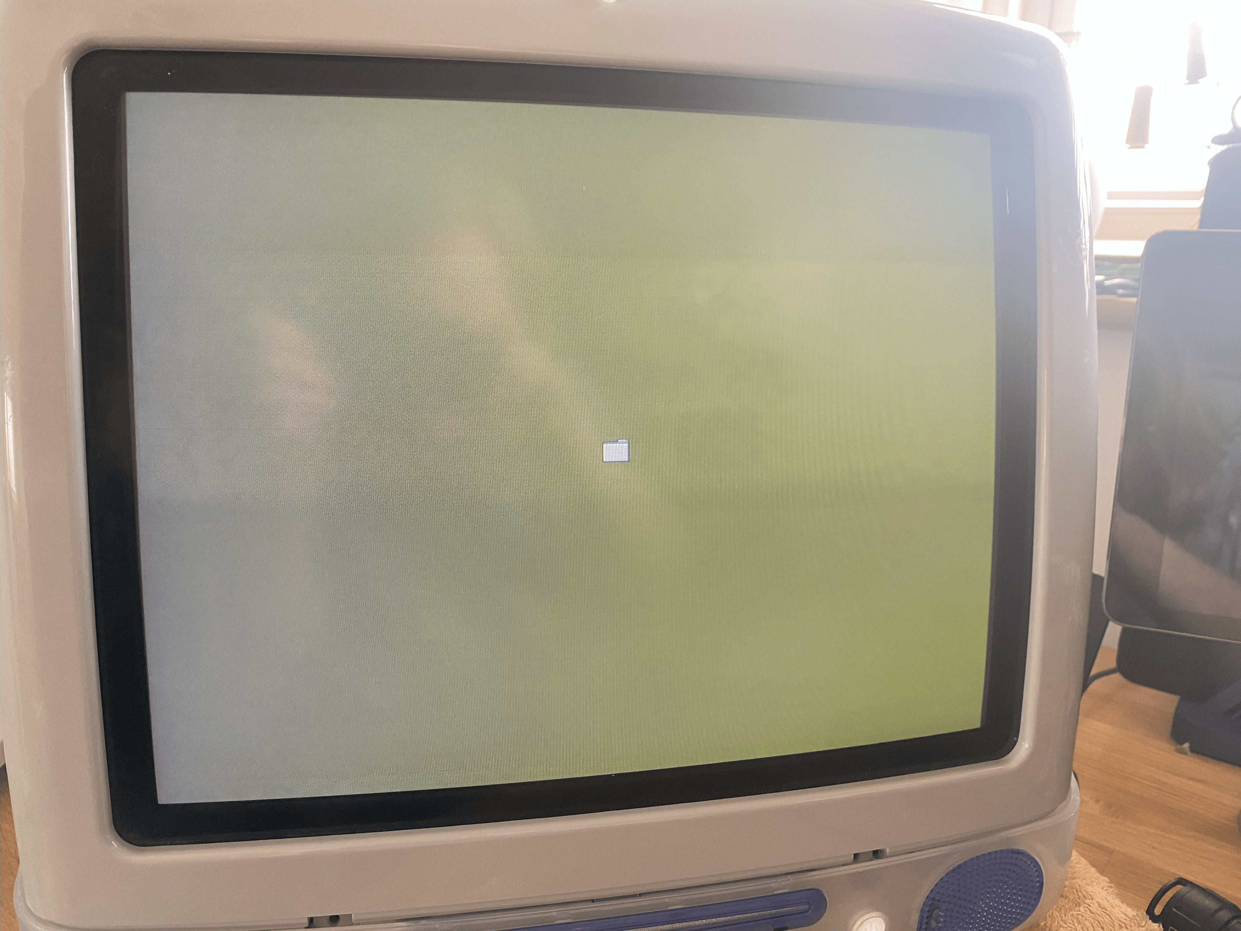

Right! Well, I've got it reassembled as far as needed to power it on. No way I'm putting that tricksy outer shell on until it's working 100%!
Results are:
  • No pops, bangs or flames after connecting AC!
  • Does make a high-pitched whine after supplying AC. The whine varies a bit before settling, but doesn't go away.
  • On pressing the power button:
    • LED illuminates
    • Familiar clonk sound of the degauss ring
    • Staticky noise heard and... the CRT comes up with the Finder/Question Mark icon! Excellent!
    • The display's got a significant yellow gradient, lighter on the left and quite yellow indeed on the right.
    • No weird whistles, noises, crackles!
  • On power-off, the high-pitched ascending whine starts again, just like when AC was originally connected.
Interestingly, it won't fully start up again without having power completely disconnected for a few minutes. Until that's done, the power LED will turn on and it'll sound like the CRT's started up (static noise, degauss thud), but no picture appears.
So.... I think this feels caps-y to me. Maybe on the down-converter board?
(there's so many capacitors on this machine -- I'd like to at least narrow it down to a board before I start pulling and testing caps!)
As for the weird tint... any ideas appreciated!

Seems the tint problem isn't uncommon. For example, https://discussions.apple.com/thread/8000298?sortBy=rank -- which looks identical to mine.
I've had my iMac sat running for a few hours and it does develop very quiet 'crackle' sounds. Initially, I thought, "uh-oh... flyback..." But the sound is coming from either somewhere on the assorted gubbins around the back of the tube or the neck-board itself. The image remains completely stable.
The flyback itself is just making a very quiet continuous buzz, which I think is healthy.
