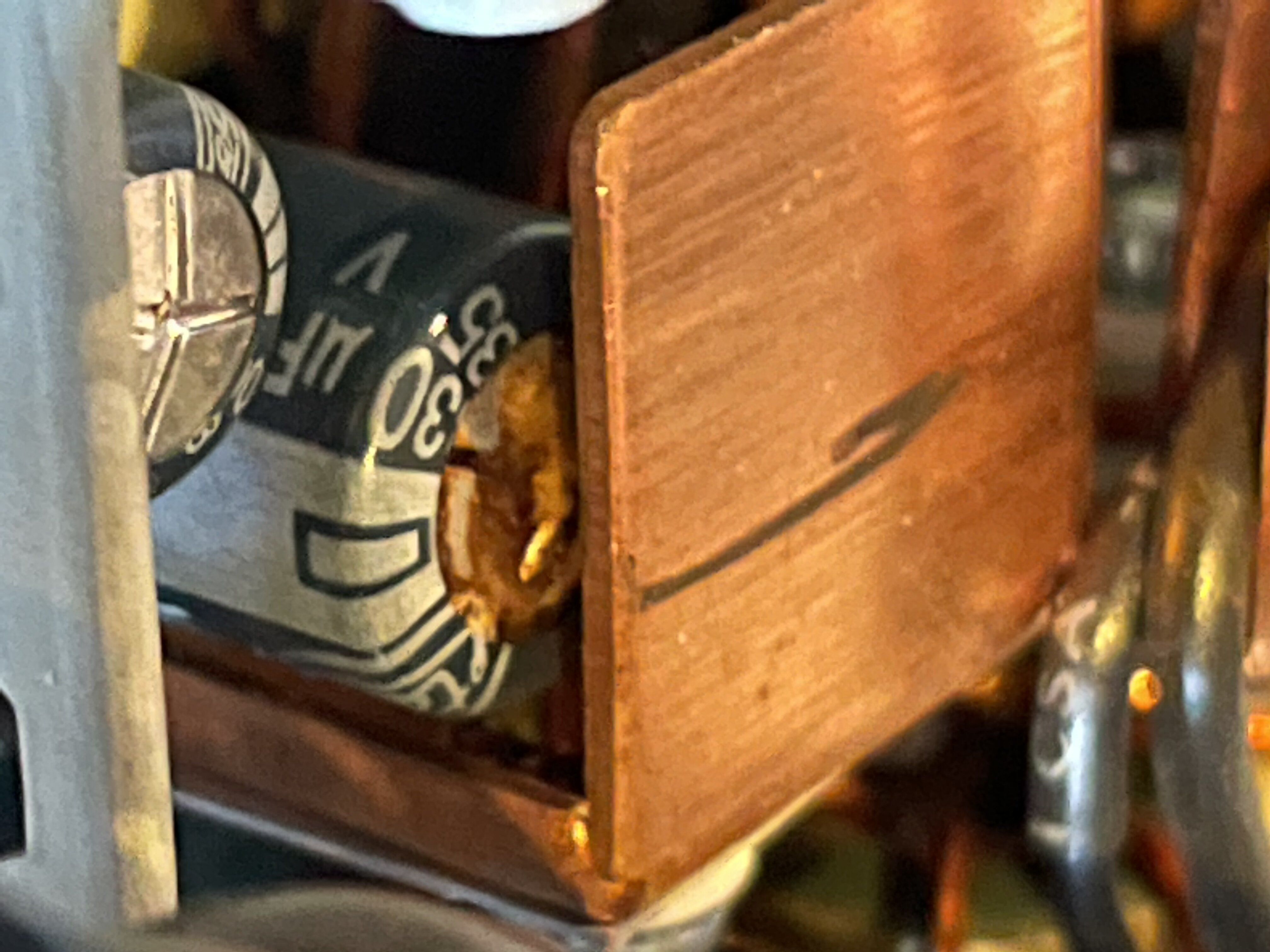

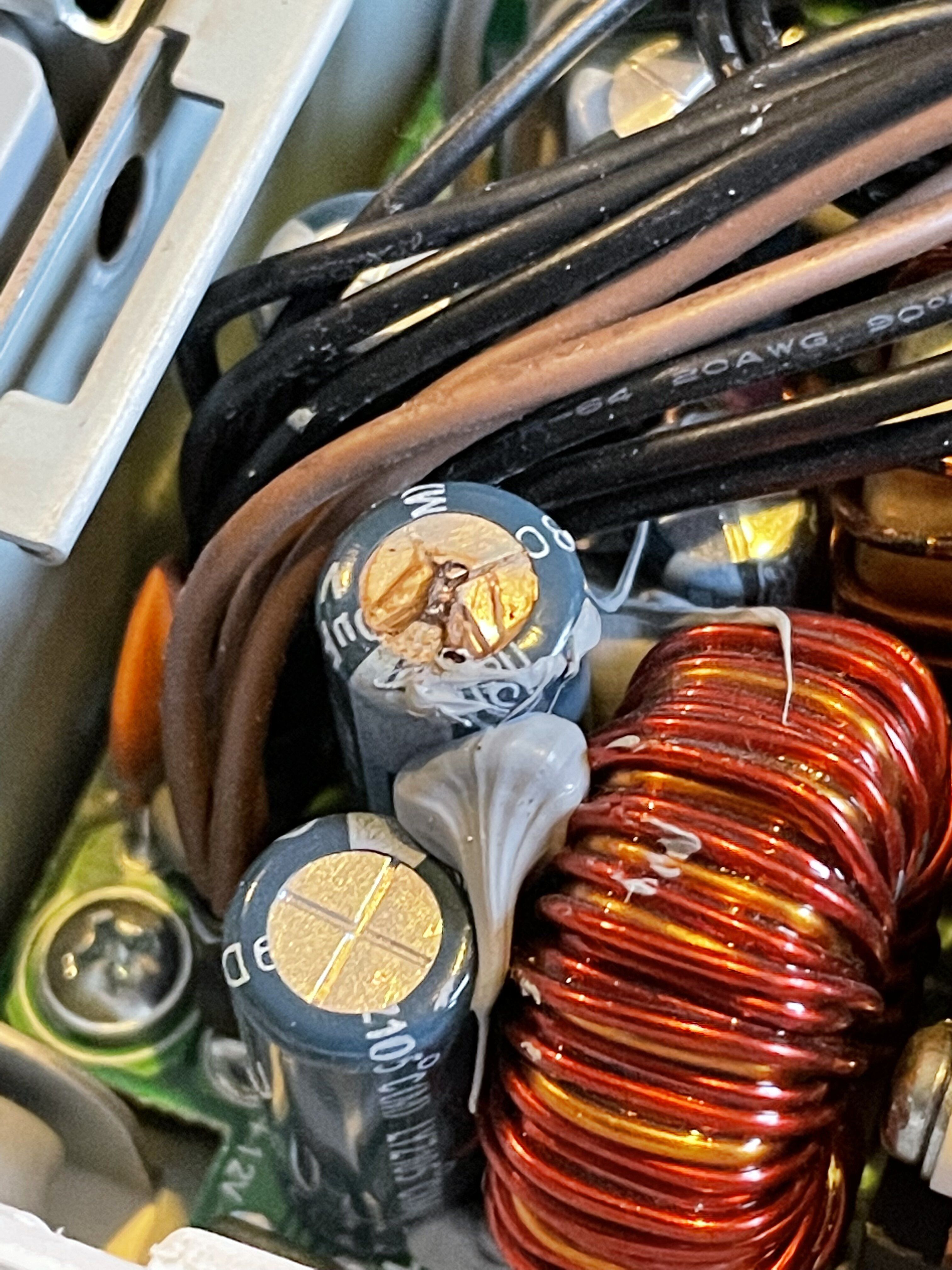

I pulled the iMac G5 (no isight) out of storage and opened it up and cleaned out the fans as last time (~3 months ago) I remembered it was loud! I put it back together and now... no signs of life. Not quite sure where to start here - I didn't do much in the G5 days with Macs. I get no signs of power, no fans nothing. I re-seated the ram, also tried without the ram chip installed, no difference. Tried both power buttons on the keyboard and the back.
What should I try next?
Edit: I see Debug LED1 turn on momentarily when the power cord is inserted.
Pulled open the PSU - few caps are bulged with some brown goop coming out. Fuse is fine.
Following this troubleshooting doc: https://www.macrepaircentral.us/imac-g5-20-inch-11-2006/power-issues-no-power.html
Here's the caps:

So far I've replaced 8 caps in my iMac G5. It was just to get it up and running. Will do the rest when I feel like it. Caps are pretty cheap these days, even good ones.
That assumes you can get hold of any - most of the ones i have are stockpiled, anything from Mouser that's a tantalum is about 2 years backordered (!)...
