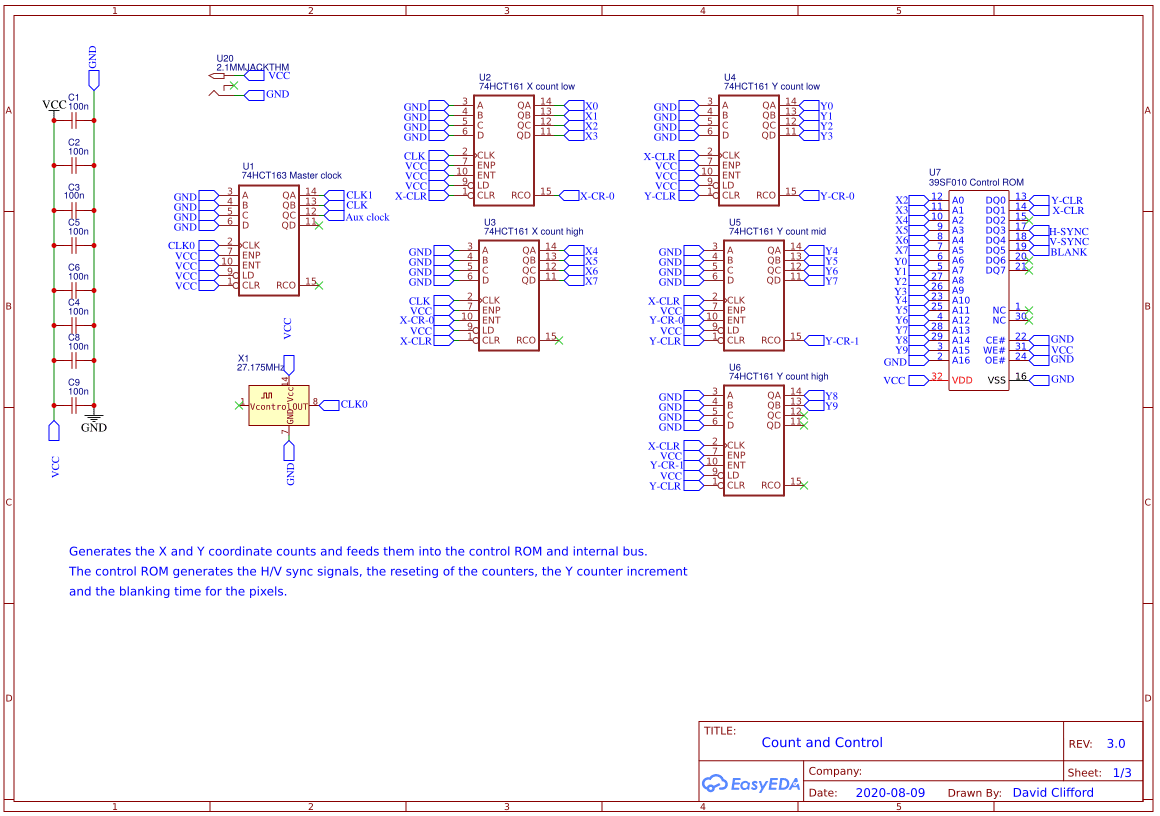

Old project, wondering where it has gone. Full feature set here.

Clarification of question above? *****
Could something like this be run from VGA input to output 8bit GS mode signals to A/B of SE/30 or the GS harness? Could the blanking periods be adjusted in real time? Dropping HDMI video frequency from 60Hz to 30Hz seems to be a thing. Might that roughly equate to dropping every other frame of IIsi video output if real time conversion can't be attained?
***** Further muddled? I think schematic and spec pages go together? Not at all familiar with GitHub cross referencing. They seem to be linked in my duckduckgo hits?

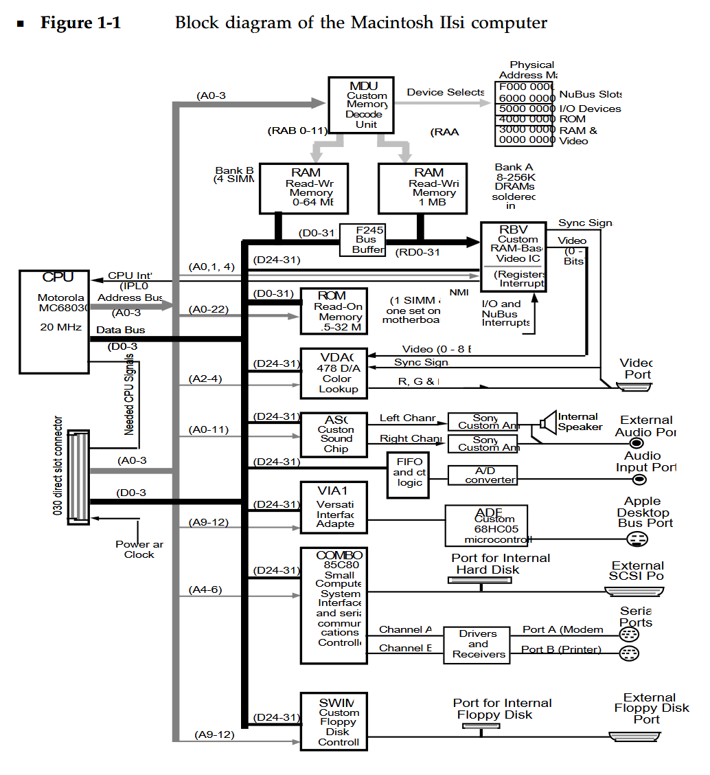

The video signals are generated by the Apple custom RAM-Based
Video (RBV) chip and are driven through a combination color
lookup table (CLUT) and video digital to analog converter (VDAC)
chip. Each monitor identifies itself by grounding certain pins on the
RBV causing it to automatically select the appropriate pixel clock and
sync timing parameters.
Dunno how Sync Sign works, but bits 0-8 of Video output from RBV Might be hijacked and VDAC removed from the schematic? No need for CLUT in a dedicated B&W or grayscale system, no? RBV is the Achilles heel of current efforts over at the MLA. If something like the circuit above can be wedged into the Block Diagram of the IIsi in place of VDAC. we might get there? Might we adjust the blanking period of 12" RGB output in real time at that juncture in real time?
If not possible, redrawing "every other frame" on the CRT a second time whilst adjusting the blanking periods of the next "other frame" is accomplished would halve the actual frame rate, but might be fine in grayscale for everything but demanding gaming?
edit: wouldn't need to excise VDAC so much as to just ignore it? Assumption would be that Address/Data on left side of VDAC only relates to CLUT?

Vampire Video in the IIsi is a well and truly diabolical affair:
- was wondering about bit-banging the DRAM frame buffer to do an end run around RBV entirely?
- if memory check is turned off, might a quartet of 8bit VRAM ICs be addressed as the buffered portion of DRAM in Bank A?
- something along the lines of the IIsi RAM-Muncher INIT might isolate the frame buffer in dedicated VRAM?
- thinking RBV and VDAC need to be there for POST, but hoping to find some slack in an unchecked memory setup?
- dual port nature of VRAM might allow a "Lamprey Video" setup to suck the life blood from the frame buffer on its way to ignored RBV? ***
Dual port SRAM probably won't work for increased bandwidth? Might snag a tick or two to use for front/back porch additions? Thought of that when concerns came up about DRAM based VRAM refresh incompatibility with IIsi DRAM refresh setup?
*** truly clutching at straws in adult beverage consumption mode here. :oops:
