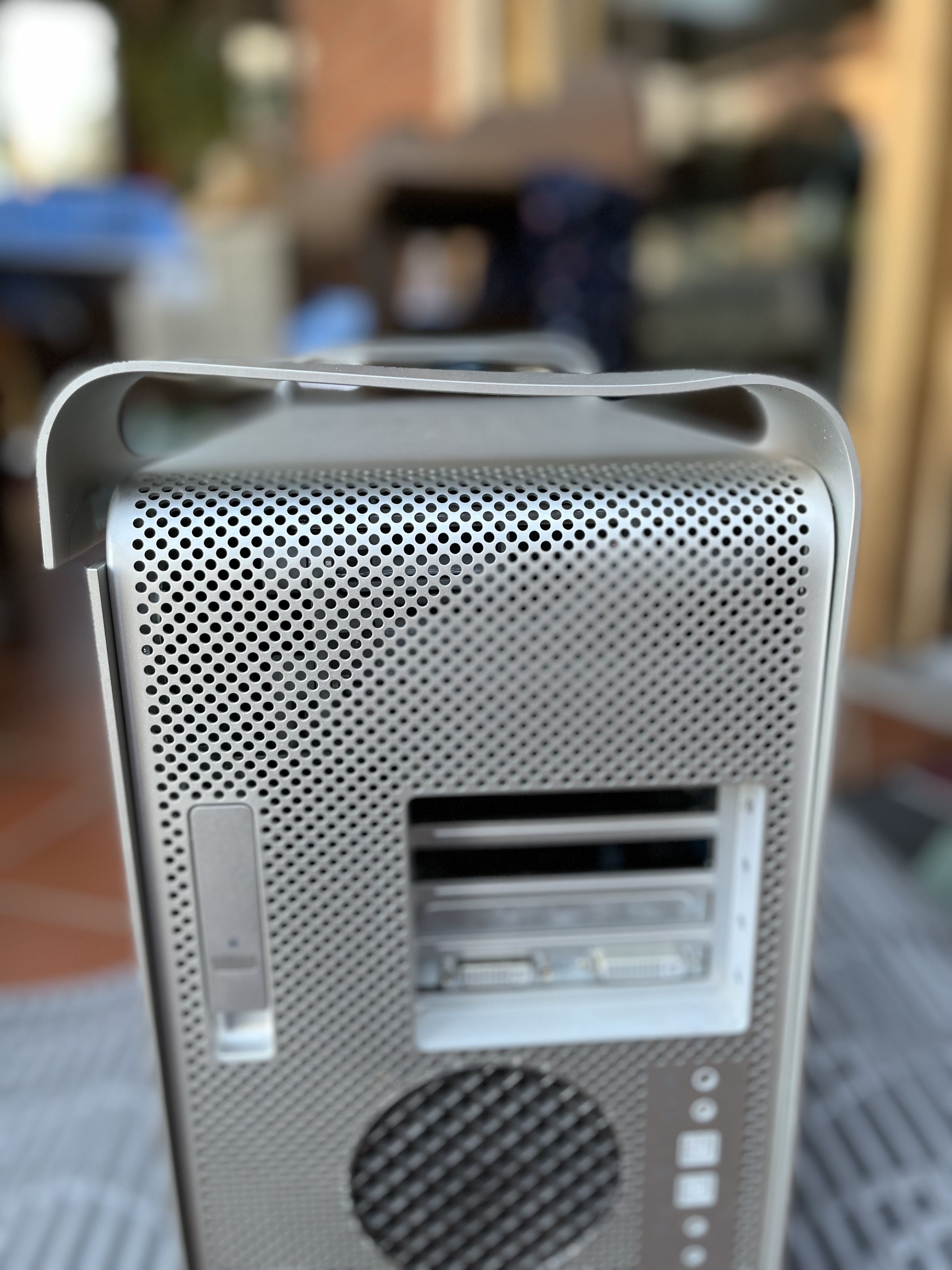

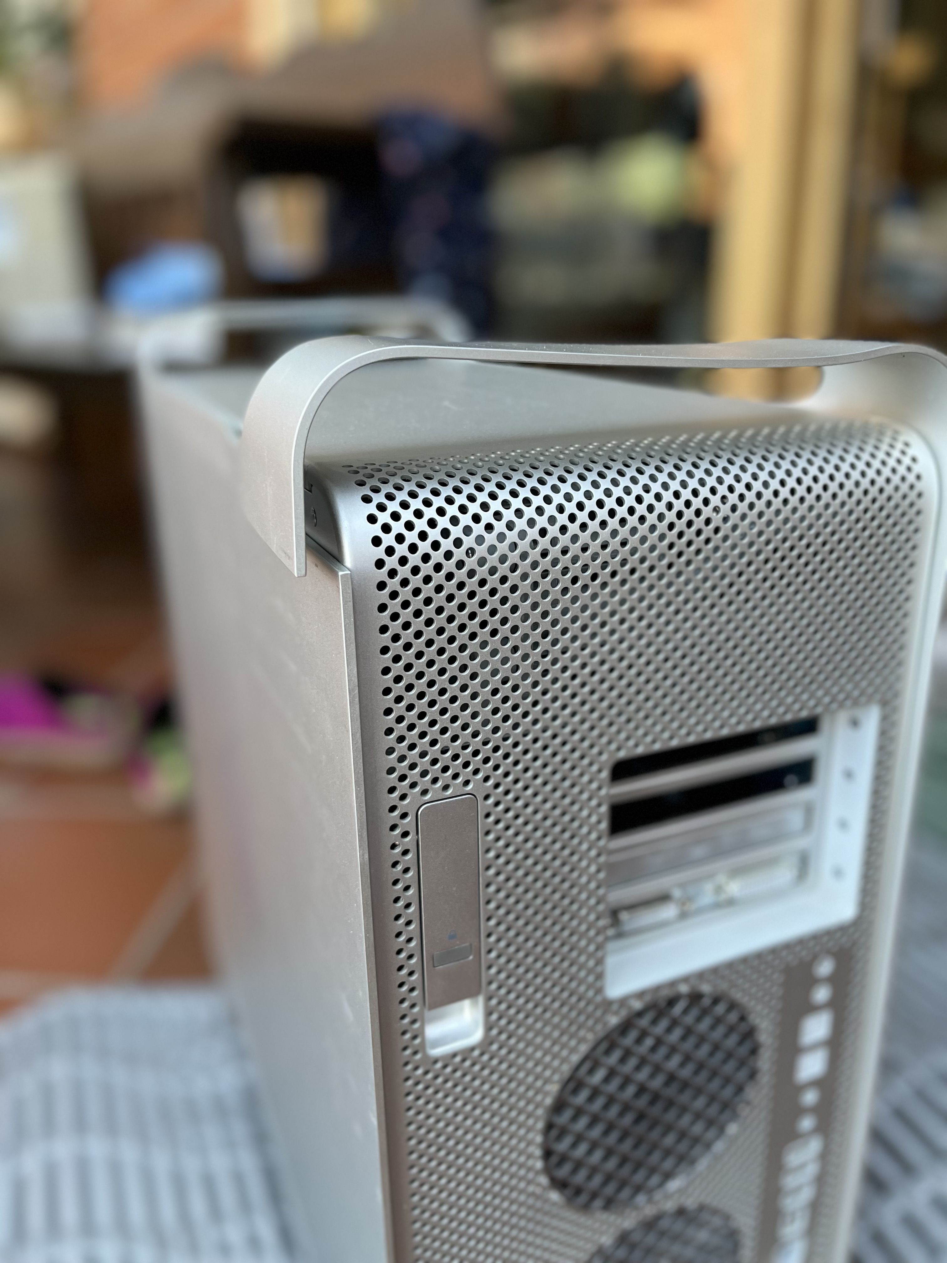

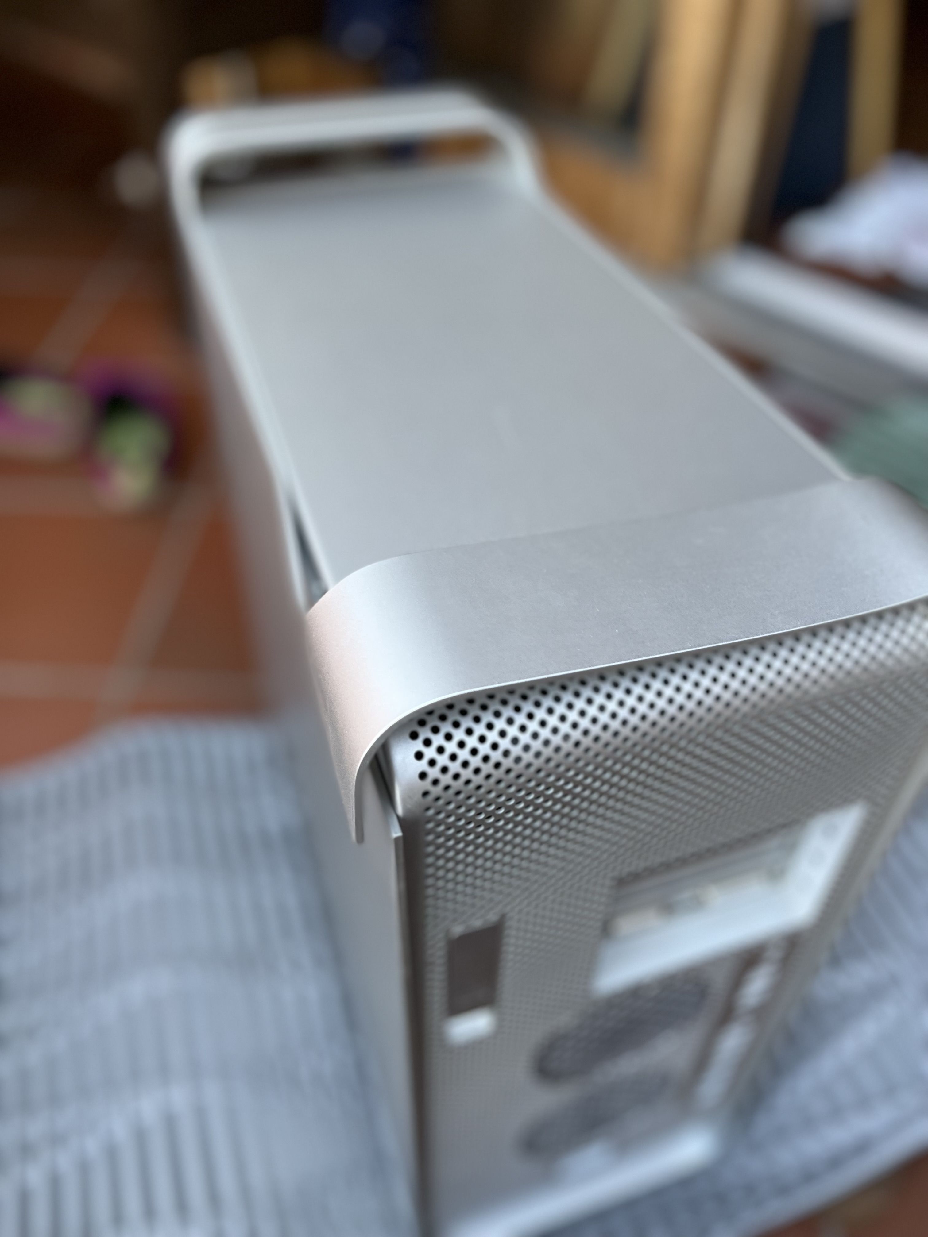

I have a wired problem with my new toy, a PowerMac G5 dual 2.0 GHz from December, 2003. The machine arrived in an acceptable condition, sadly during the transport get damaged, the top rear handling have got a punch and released from the top line of the housing.
It is "just" optical damage and I though it will not disturb the functionality.. but maybe yes, it has effect on it...

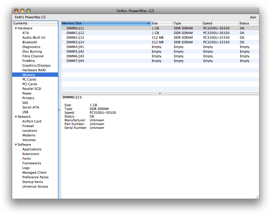

  • not all memory slots working: the machine arrived with 5 GB RAM: 2 x 1GB and 6 x 512MB. It was working when arrived but not working after the cleaning-rebuilding. (the memory slots J11..J14 are working, the J41..J44 are not - independent which modules I try, all modules working in the J11..J14 and none of them working in the J41..J44 slots) In the attached picture ALL memory slots are populated.

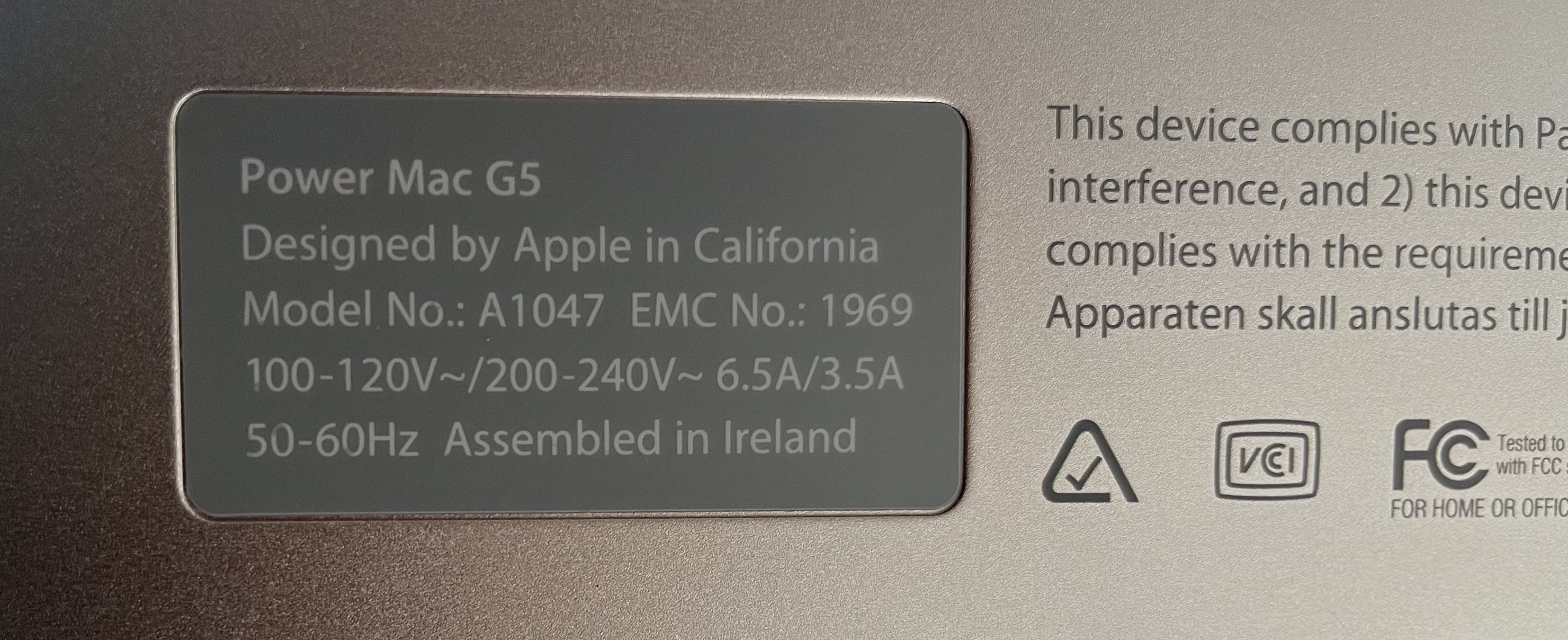

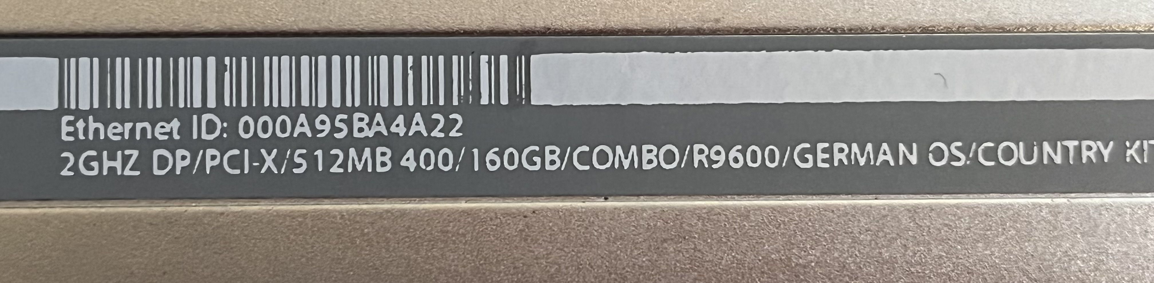

Is your G5 the A1047 PCIX model?

In relation to the ram slots, first things Id do is inspect the ram slots and hit them with canned air in the instance they have debris in them. It sounds like you are installing them correctly in matched pairs from the inside middle out, so Id not suspect that. It is well documented (IMHO) that the solder used in these systems to hold the ram slots in place has gotten fragile over time. The slots can become loose, so when swapping modules in and out, they lose connectivity (get loose like a cold solder joint) and stop working. This hasn't happened to my Powermac g5s but the test I've read about folks using is with the ram slots populated, hit the non-functioning ports with a blow dryer for a few minutes to warm them up, expanding the metal componentry so they make contact and then turn the powermac on and see if the sockets read ram in sys profiler. If they do, the slots are likely not bad but loose. I have not done it myself, but I was chatting with a friend of mine who successfully repaired his non functioning powermac g5 by insulating/deflecting the surrounding pcb area with heavy duty foil, cardboard and ducting foil tape exposing just the ram slot connections and hitting the board from underneath with a heat gun to reflow the solder joints. Seems mildly risky to me with all of the tiny componentry populating the pcb area but it did work per my convo and with a non functioning pmg5, he had zero to lose I suppose, so with that in mind & if you are careful, it seems to be a good fix and has worked long term for him (years).
Then again, you could leave it alone and just max the functioning remaining slots and roll with that. I am responding to this on my own PCI a1047 dual cpu 2ghz powermac g5 which this particular model was neutered with half of the slots of a PCIX thus maxes at 4 gigbaytes but is still a stout little box despite the meager resources comparatively.

Yes, it is an A1047 with PCI-X

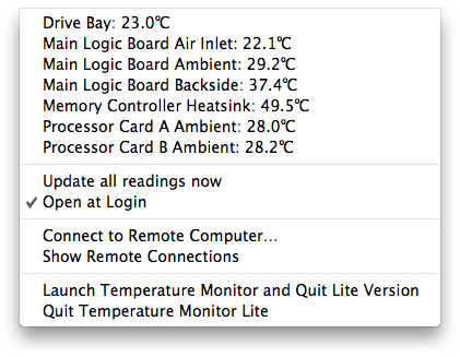

These are my temperature values:
I will try all of it - as well the RAM slots reflowing. If I have to take a part and clean and repaste the U3 Memory Controller, I will have a look under microscope the memory slots. Interestingly, the first 2-2 slots from the inner to the outer direction are working and the outer 2-2 not. If it were those slots (those 2-2 outer slots have connection problem but the inner 2-2 working) then it would be a strange failure. I would expect an area of RAM slots like - all top or the very bottom 2 ... I will check it...

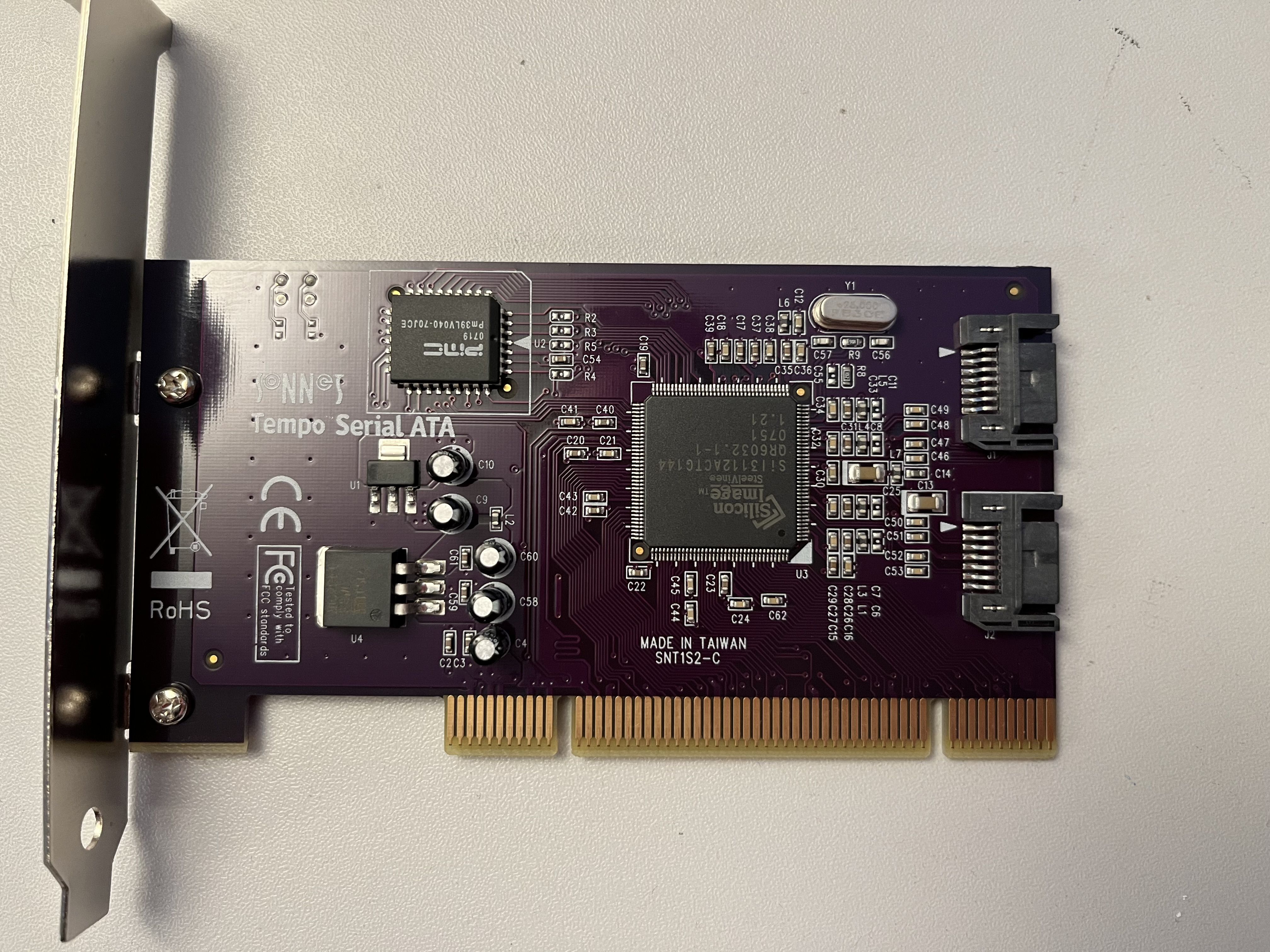

About the SSD, it works in another machine, so I pulled out the SanDisk 128 GB from that machine, and it works in the G5 with the mentioned Sonnet SATA controller (I had 2 in my drawer). The SATA controller on the logic board is not compatible with my SSDs...

The SanDisk 128GB is in the G5 A1047 connected to the Sonnet SATA controller.
