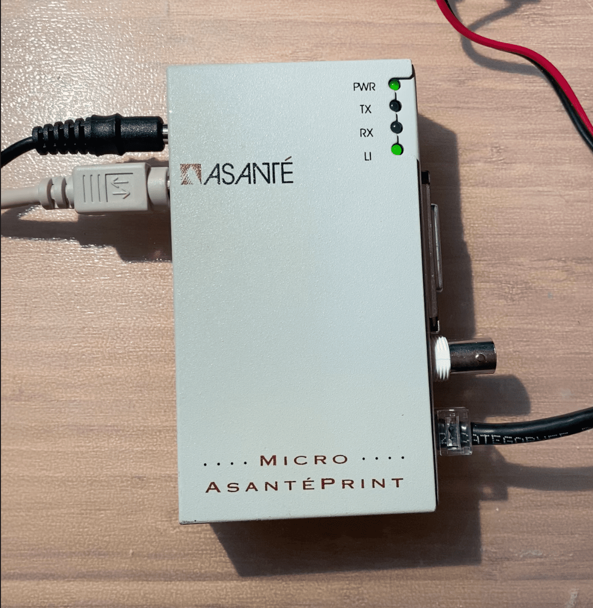

This is similar to this other model, right?
Yes, but the EtherMac Printer Adapter is for getting a single LocalTalk device connected to Ethernet. I have the very similar EtherMac PowerBook Adapter.
