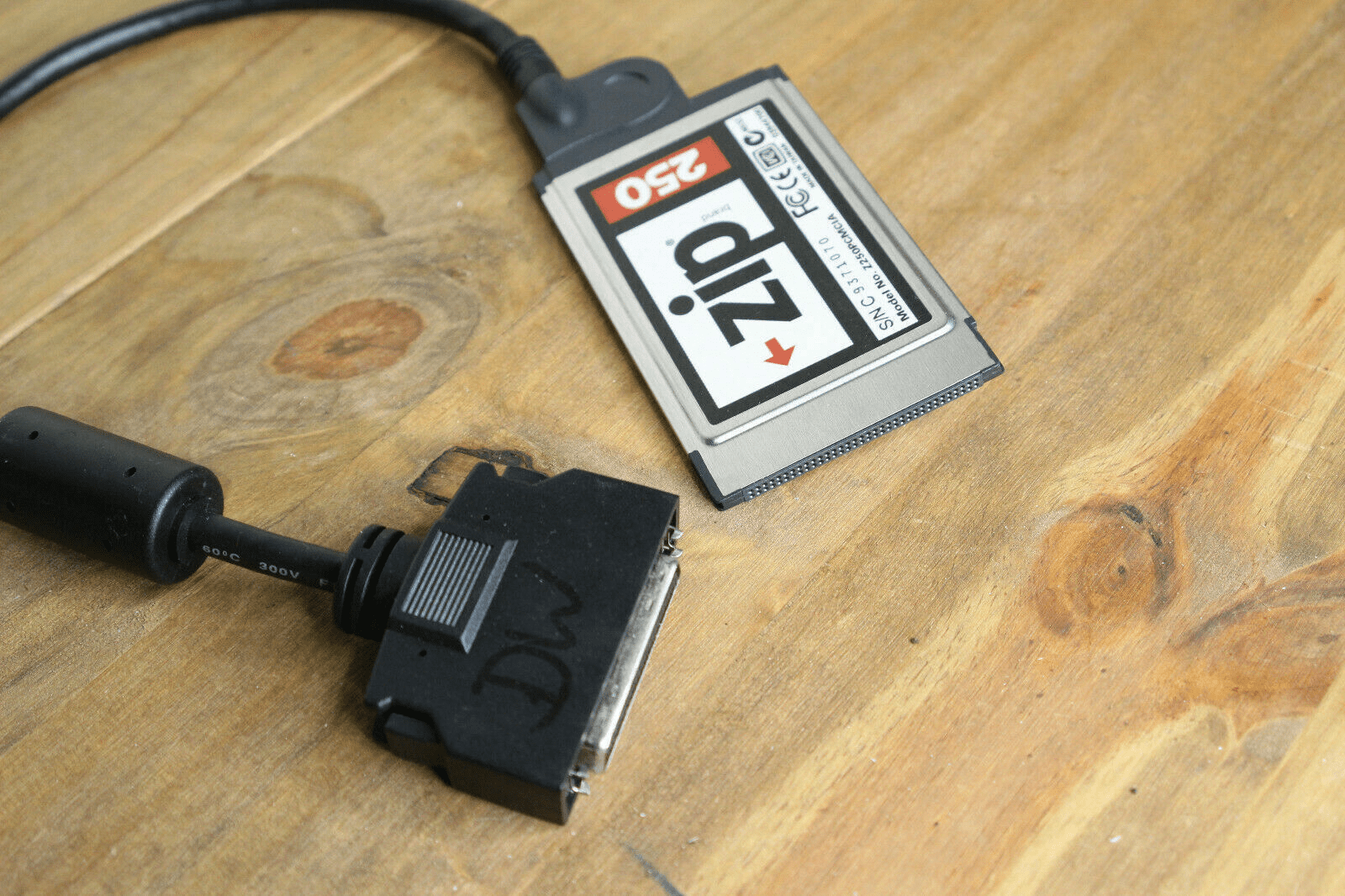

I think this is the cable it uses:

A bit more research and I found this adapter for PCMCIA (see below) So you're saying that port on the back and is meant for a HD-50 SCSI 2 cable. Do you happen to know if they made a HD-50 SCSI 2 cable that could connect to a standard Macintosh SCSI port?
I was hoping I could use this drive with my freshly recapped Classic II :)

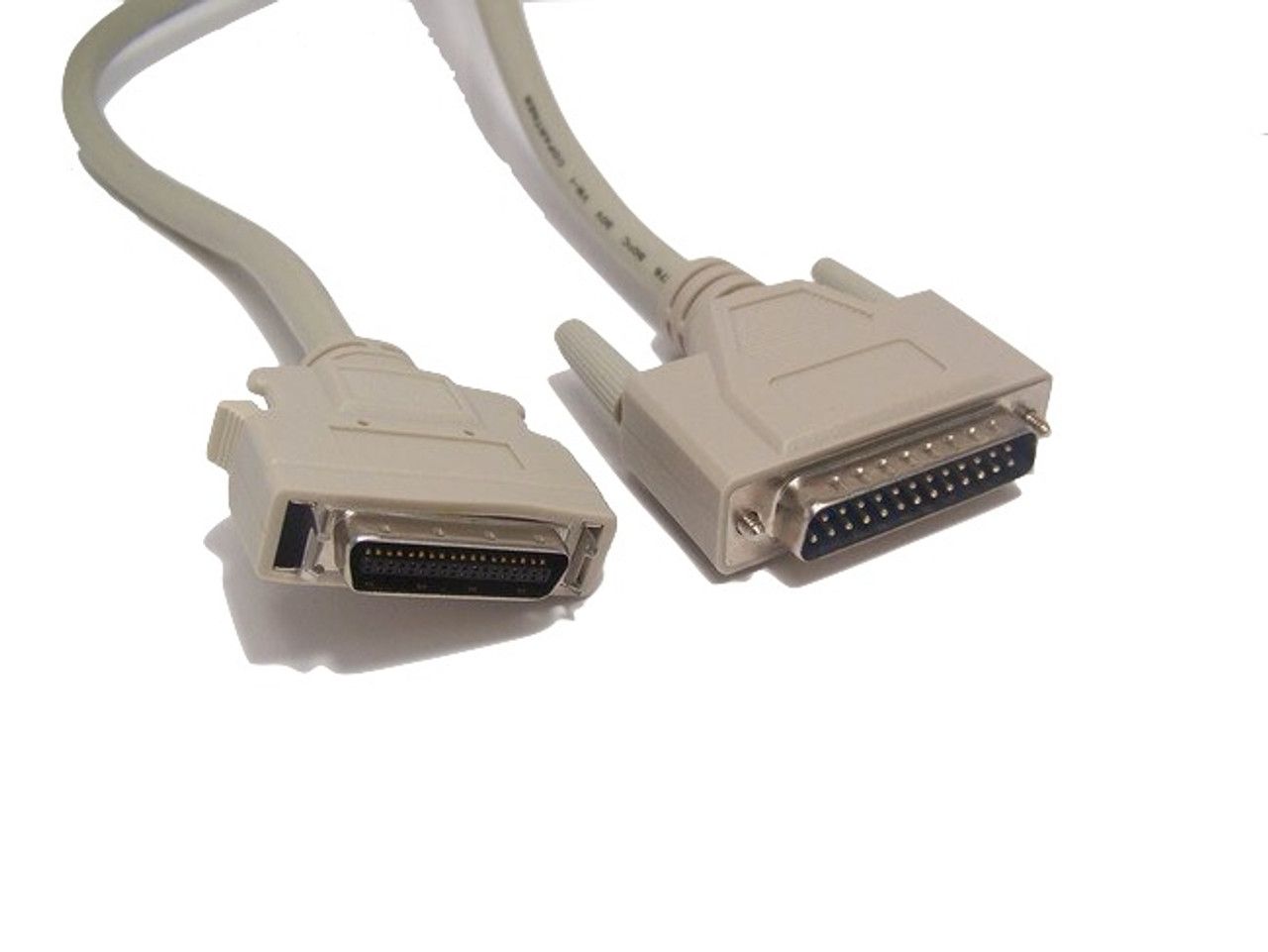

Would something like this work to convert it to something Mac compatible? (From Ebay 50pin SCSI-2 Male Plug to DB25 SCSI-1 Female Jack Adapter)
Well, the adapter you have in that pic is a DB-25 to a SCSI-2 HD-50, which is different from a Centronics HD-50. A Centronics HD-50 is just a smaller version of the typical Centronics 50 port you have on a printer that connects to a parallel port, and is not standard for any SCSI standard. If it's wired for PCMCIA, it is not SCSI compatible since those protocols speak in a completely different way. Apparently that is a Centronics HD-50 to PCMCIA connector, which is rather odd and I have never seen anything used like that before. Unfortunately, there doesn't appear to be a way to talk to your Classic II directly.
It does not look like a parallel port to me. Reading up on some forms people suggest it's a PCMCIA SCSI adapter port. Wondering if there were any adaptors out there that could take it to a regular mac SCSI instead of PCMCIA?
Are we sure the PCMCIA port speaks SCSI? If it does, then one could actually use a Centronics HD-50 to DB-25 SCSI cable. I'm not familiar with what protocols PCMCIA would use to talk to a Zip drive.

That drive was the USB/PCMCIA version meant to be used with the card pictured above. Unfortunately I'm 90% sure it uses an ATAPI interface not SCSI. :(
