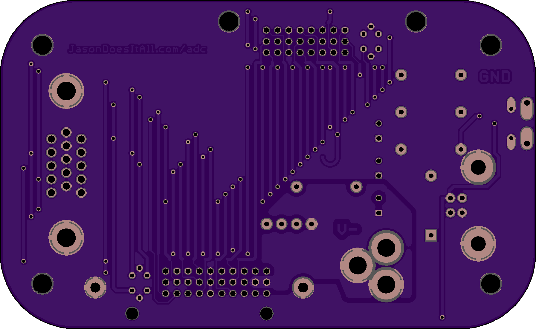

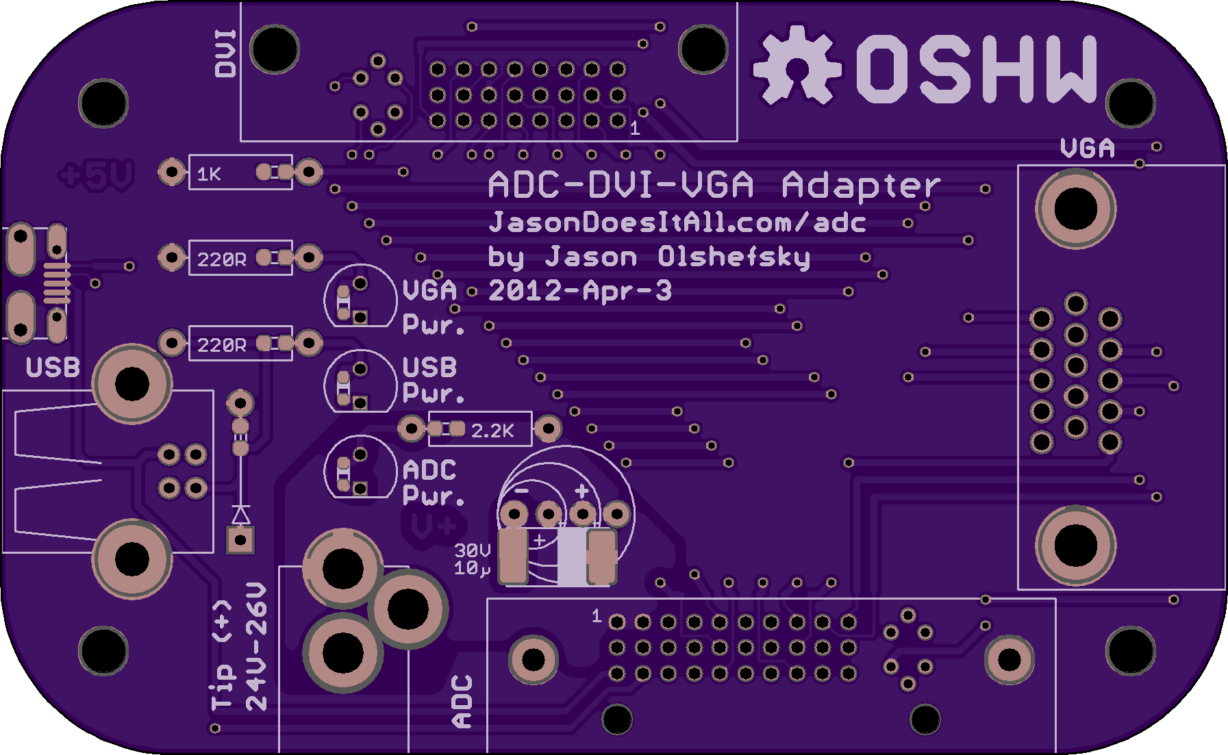

I'm building a JASONDOESITALL adapter for my 17" ADC studio CRT (the clear acrilic one). I have all of the components so it's time to order the PCB itself.
On the jlcpcb website I can choose between 1 oz. copper and 2 oz. copper. The 2 oz. Copper is almost 10 times more expensive.
Does anyone know if 1.oz is sufficient for this adapter?
Are you sure about the 28V? The power adapter that gets recommend is 24Volts and 5 ampere.
Also, what should I enter in the temperature rise field. I'm completely new to this.
I don't know about the CRT model, but all the LCD models work fine at 24v. I haven't seen actual 28v come out of any of my G4 tower ADC connectors.
