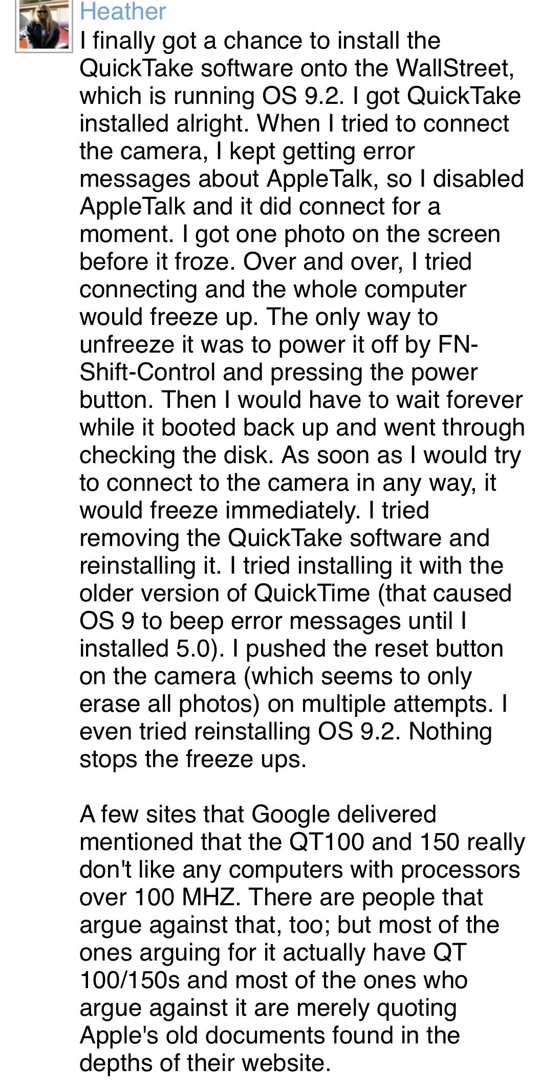

I’m using 8.6 and have zero issues with any of the hardware on my 1400c. It also uses a CF card and 8.6 - someone also said they had the same problem on their G3 when connecting the QuickTake from 2008 but no one responded to her thread so no idea what the end solution was. She was also running 9.2 which I’m not.
