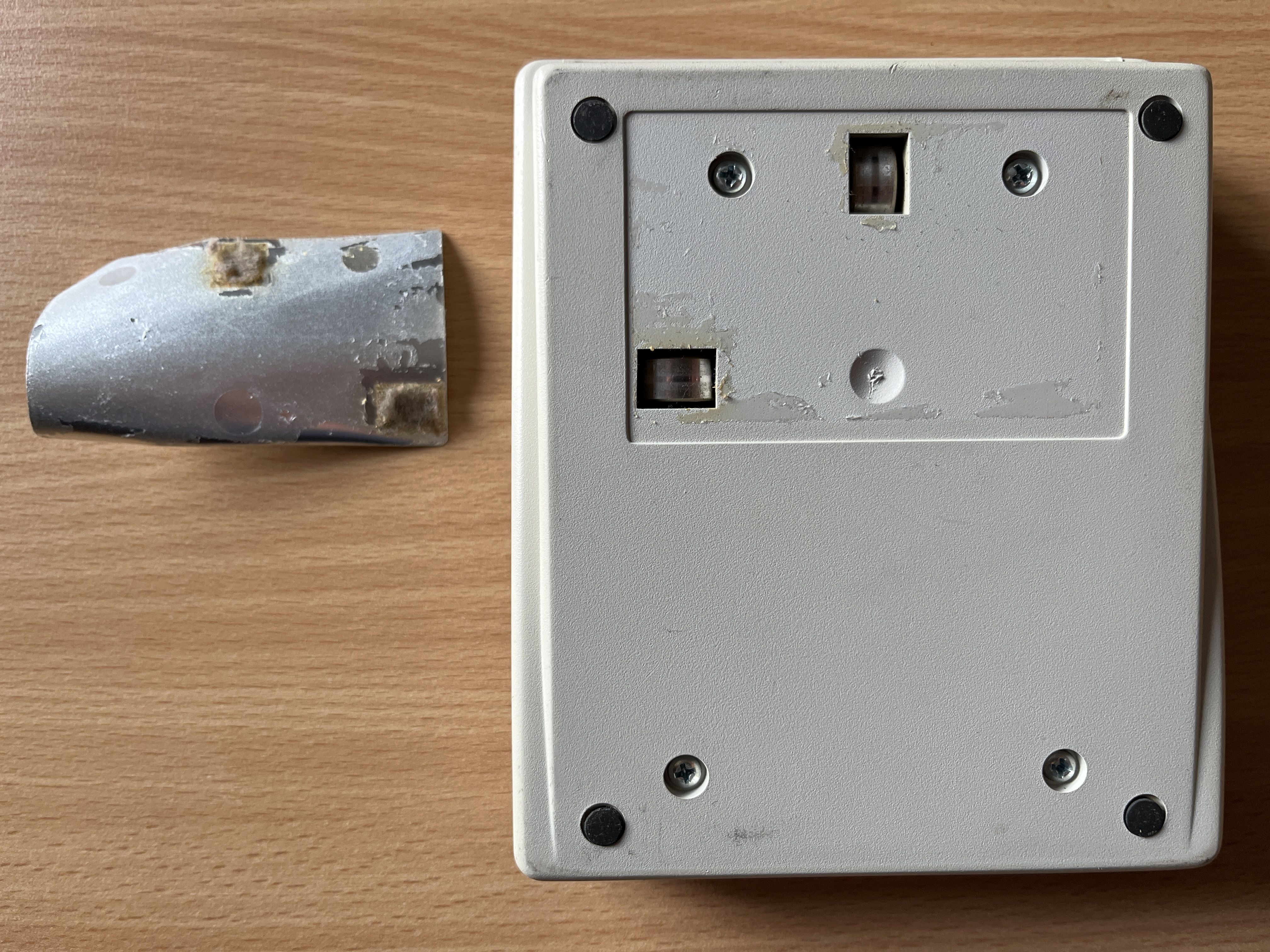

Took apart my recently acquired Turbo Mouse 4.0, there is two screws hidden under the label on the bottom, but that’s not all: there is what looks like two patches of a soft material attached to the underside of the label, I guess to clean the rollers:
They have completely broken down with age, as to be expected. What can I use to replace them? It has to be some sort of brush, or dry sponge, but very soft as to not slow down the rollers.
While I was there I lubricated the rollers: they're so much quieter now!
First time I used, and even saw in person one of these big trackballs, I was surprised that the ball isn’t captive, it just sit there!
Reactions: eric and bakkus
Some low/medium-density foam should do the trick. You need something mildly abrasive to help clean them but not scratch/gouge/wear out the rollers.

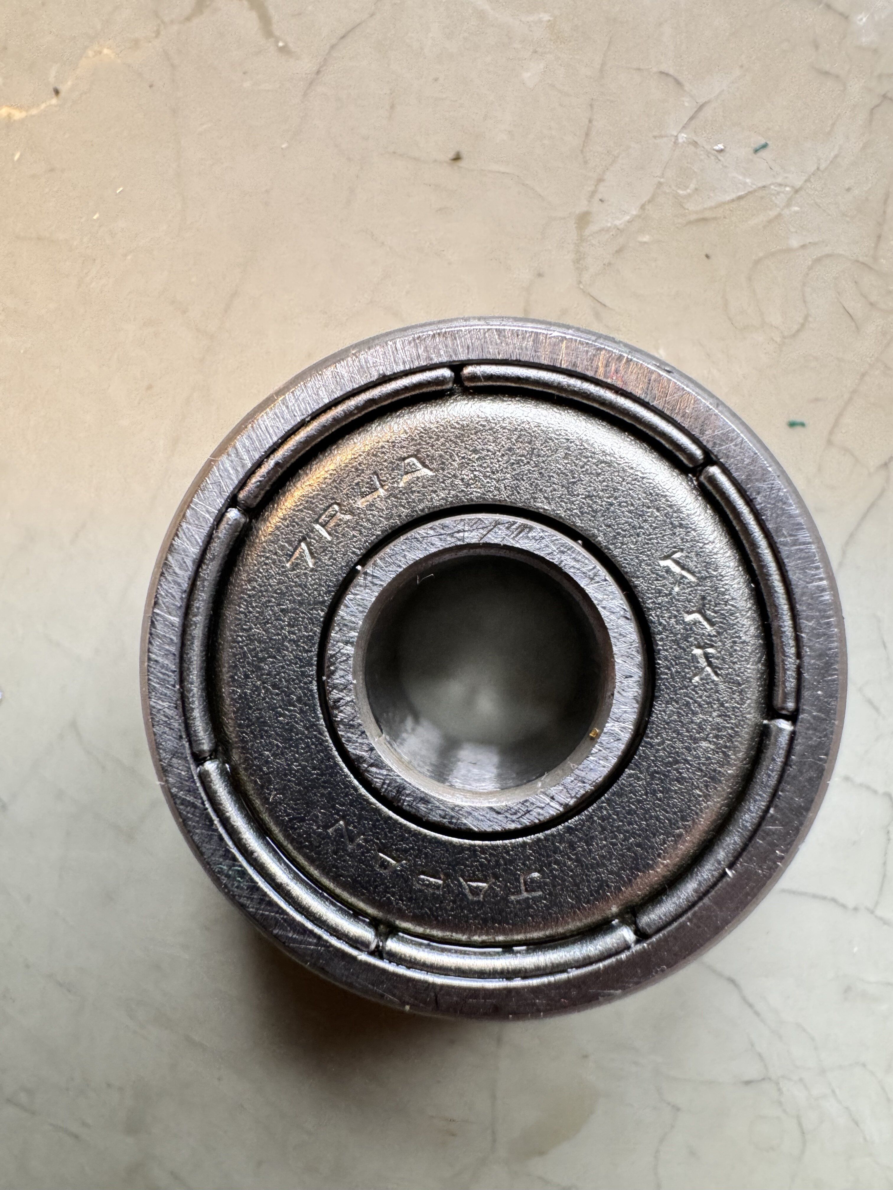

I am in the process of refurbishing one of these. The roller bearings are slow and needs a good cleaning. When I spray some IPA on them they loosen up and feels really good, but as soon as they dry up they’re back to slow and gummy. Anyone here that have had success cleaning and re-greasing the roller bearings?
Have you tried greasing it with something besides IPA, like an actual grease?
Reactions: larsovef
Let us know how you make out! Gotta a few to work on myself.
I’m not sure how to get the grease inside the bearing. I’ll try to use the super oil and see if it will penetrate. If not then I’ll try and open the bearing up some how.
the comment in this video by This Does Not Compute are full of people saying they should be serviceable:
Update:
No luck in cleaning the bearings. So I’ve desoldered the LED and removed the black housing with the bearing shaft on it. The pattern on the bearing comes off quite easy so I’ll try to source a pair of new bearings and glue the sensor-pattern back on. The heat stakes can be converted to screws.
