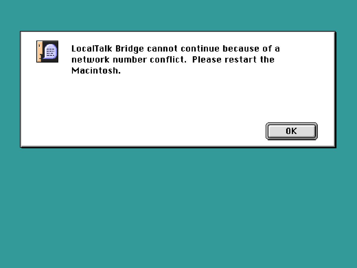

The Second issue is that I use Apple's LocalTalk Bridge to allow communication between my LocalTalk and Ethernet connections on the Iici. As soon as the LCIII connects to my LAN the Bridge on the Iici disables itself with a "Number conflict error".

Still can't get The LCIII (or LCII) to work with Apple LocalTALK Bridge 2.1 (ALB2.1) with the blueSCSI pico 2W - guess its just a thing. ALB2.1 Works with the Fallon card installed.
