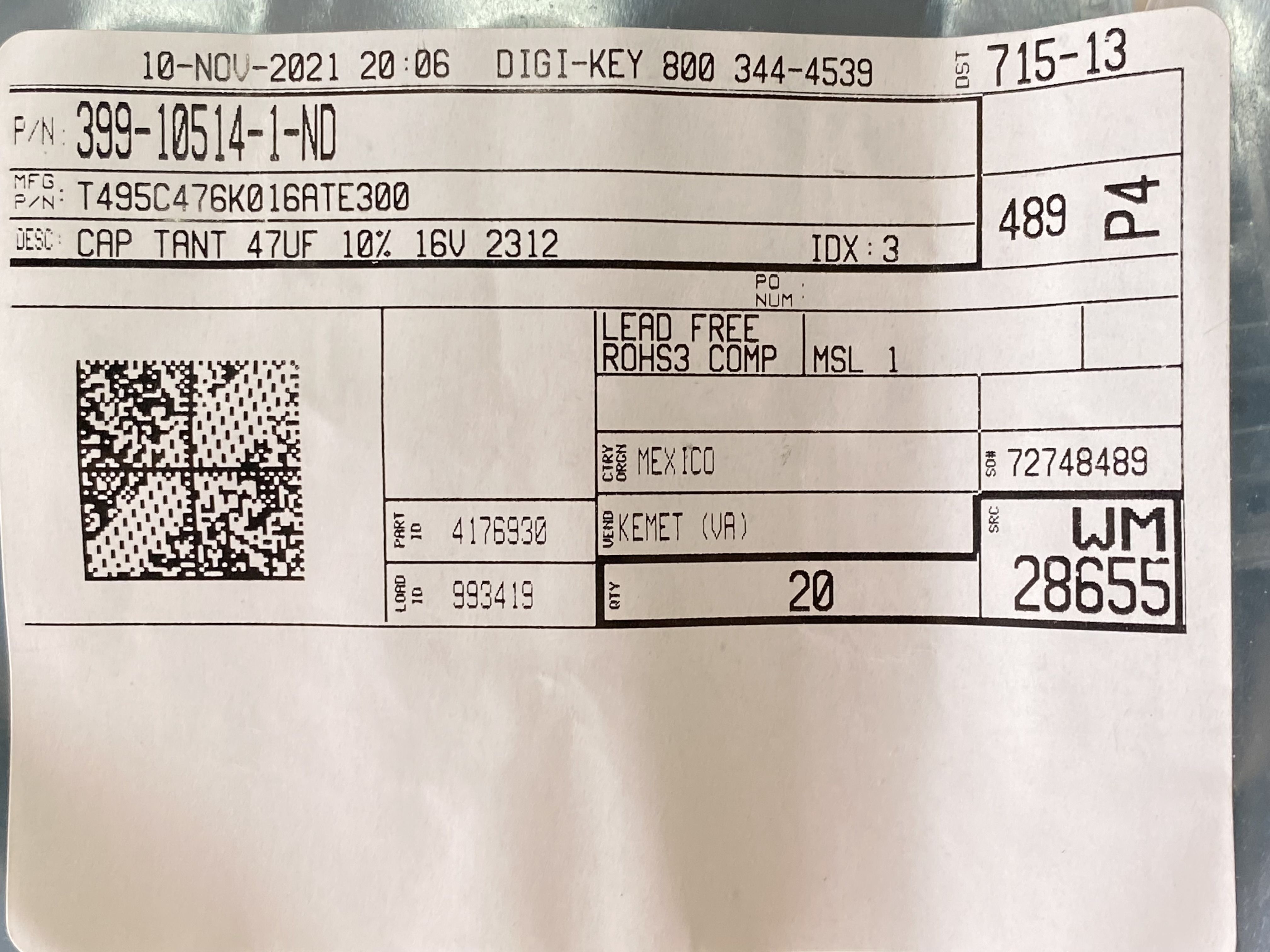

There may be a dependency on the tantalums used. For the record, my misbehaving cap was a Kemet from Digikey - here’s the part info:

I'll add my voice to those who had this problem with the TDK PSU and recapping C22 with a tantalum (I did not order the caps, but they look like Kemets). When following the silkscreen, I was getting -2.2V, but once I flipped C22 around (opposite of the silkscreen), I got a solid -5.1V. I actually have two different TDK PSUs, and saw the same behavior with both (using the same LCIII board).
