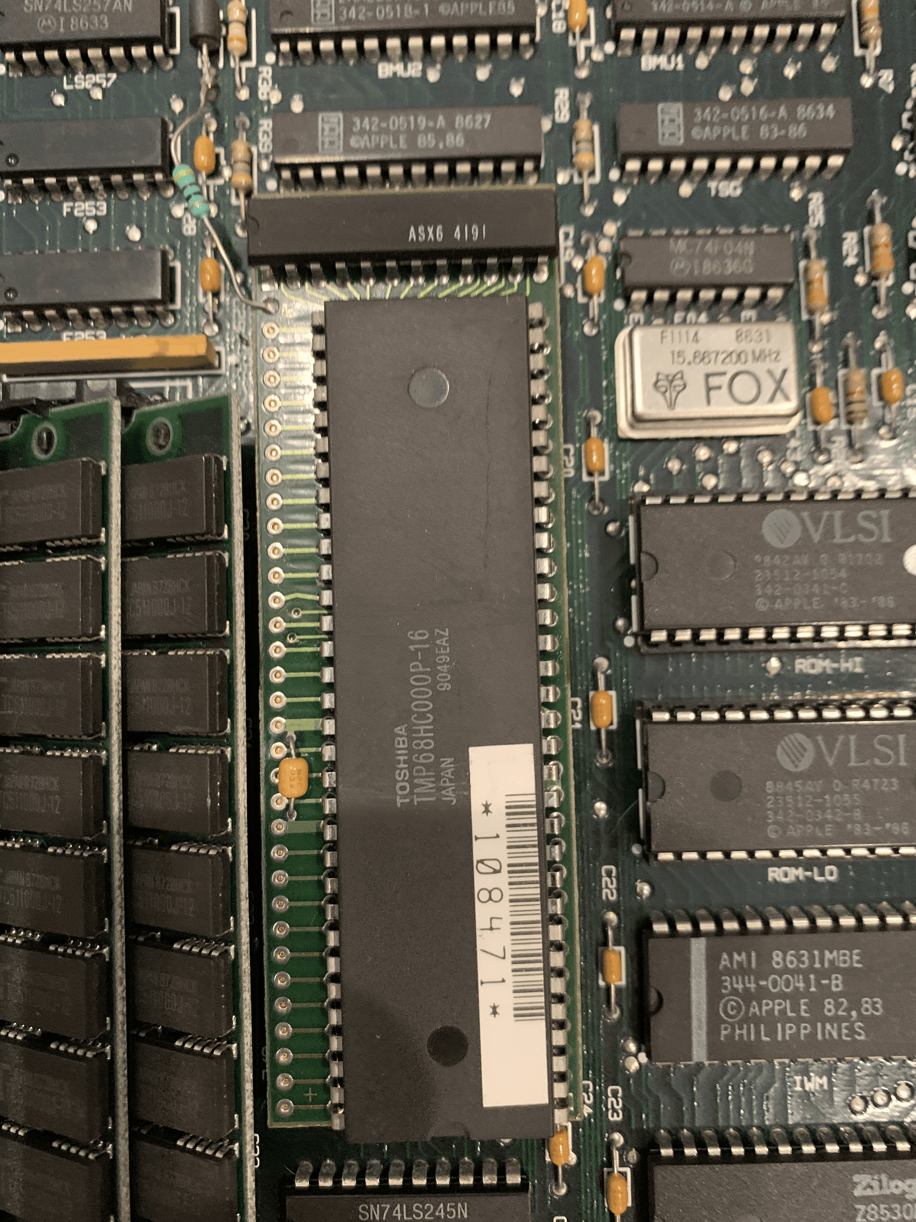

The Mac Plus has a 68000 16Mhz upgrade by Brainstorm, and possibly a RAM upgrade. I am not sure how much RAM it has before since I don't have a keyboard, mouse, and boot disk yet to check. I also notice the Mac Plus makes a clicking noise constantly after the macintosh bootup screen shows, not sure why this is. Is it bad? Also, how do I fix a slightly fuzzy screen?

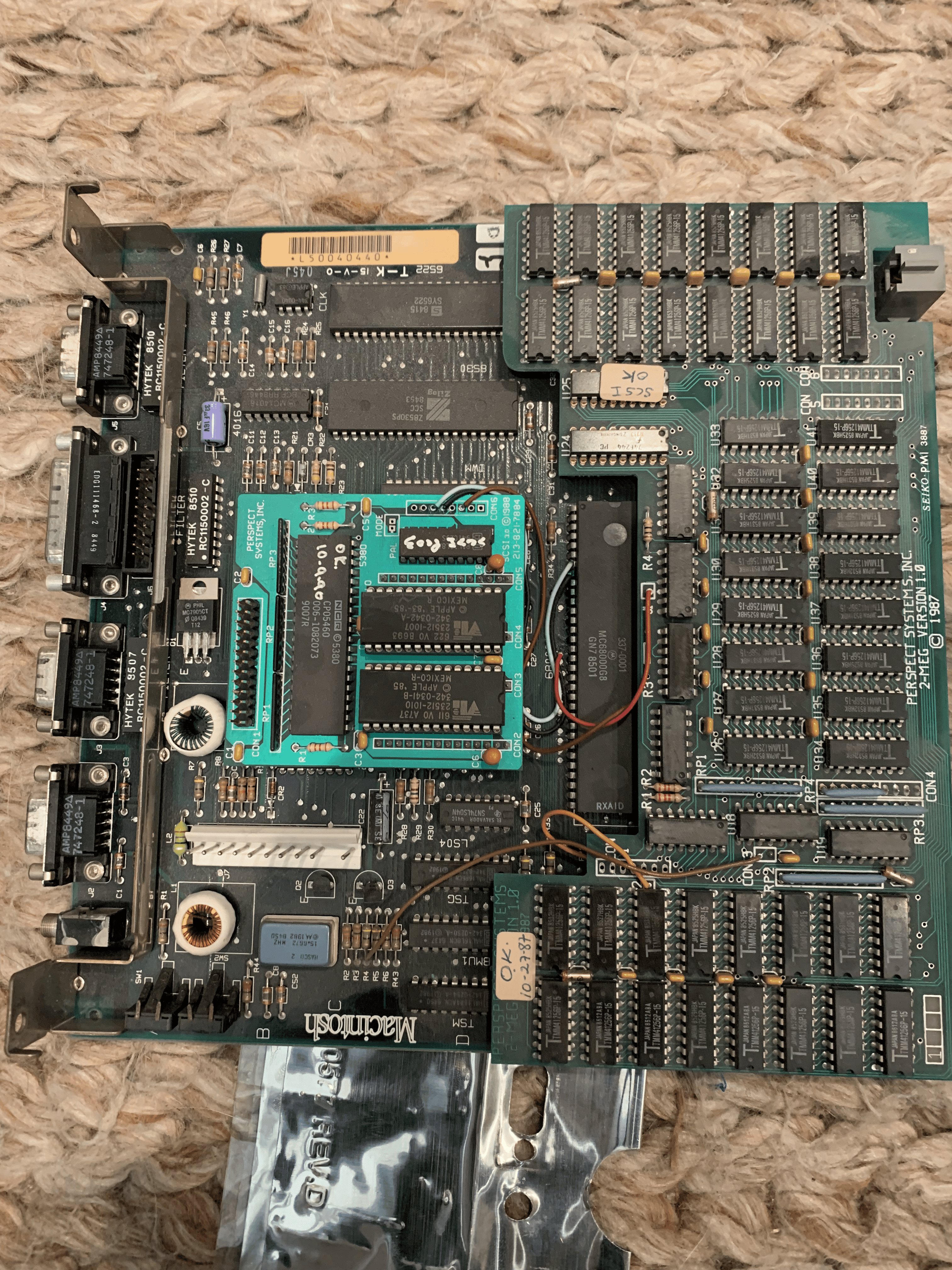

The Mac 512k has a SCSI expansion, and a 2MB RAM daughterboard, both by "Prespect Systems Inc".

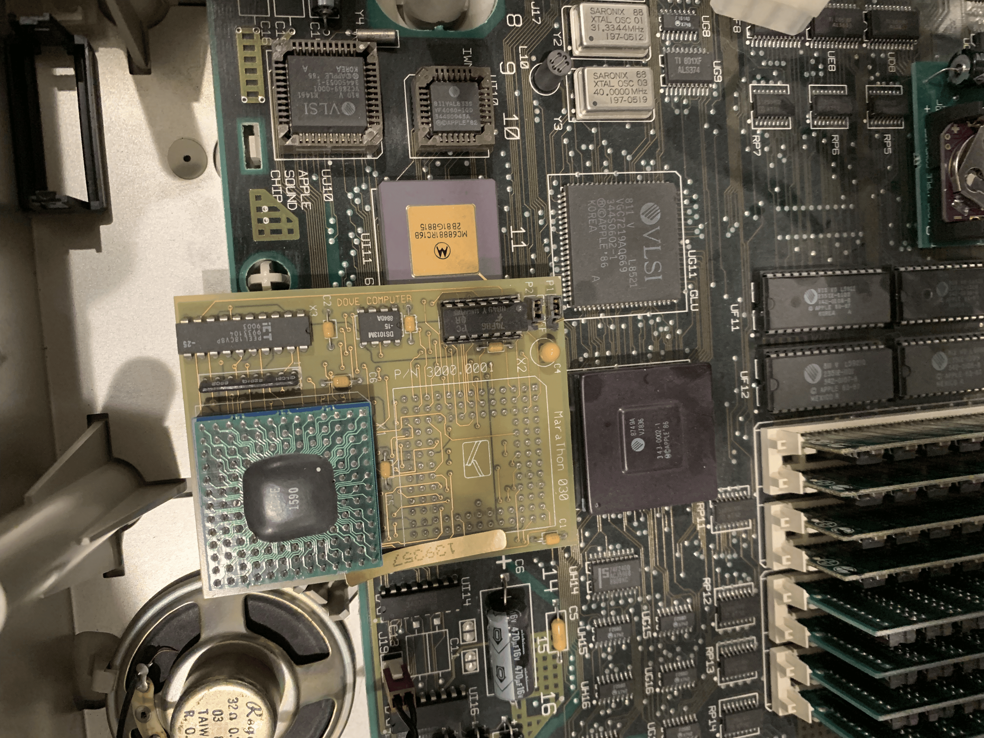

On a side note, the Mac II has a Dove Marathon 030 expansion and 5MB of RAM, but is missing both floppy drives and the bay. If anyone has the floppy drives + bay, I'd be interested.

The Mac Plus motherboard is pretty normal other than the CPU slotted on top an a resistor(?) connecting the CPU board and some component on the motherboard.
The Macintosh 512k has loads of wires and such everywhere:

Can you post photos of that Dove accelerator? I recently removed and socketed the 030 chip in one of my SE/30s in order to install a Dove 030 accelerator. Works just fine, but I'm curious if yours has any bodge wires or other obvious differences.
FYI: The 512ke daughterboard is carrying 1.5 MB of memory which likely extends the on-board 512k to a total of 2MB.
@vtgearhead No bodge wires that I can see or anything. Haven't got it booting yet since I don't have a monitor -- do you have a recommendation for a monitor to purchase?
Is the Dove 030 very rare?
Also, what do you mean by the 512ke board -- Ihad thought it was a 512k, not 512ke? Also, do you mean there is 1.5mb on the daughter card or 2MB? It seems to say 2MB on the card. EDIT: It has a 800k drive, so I think it is a 512ke!

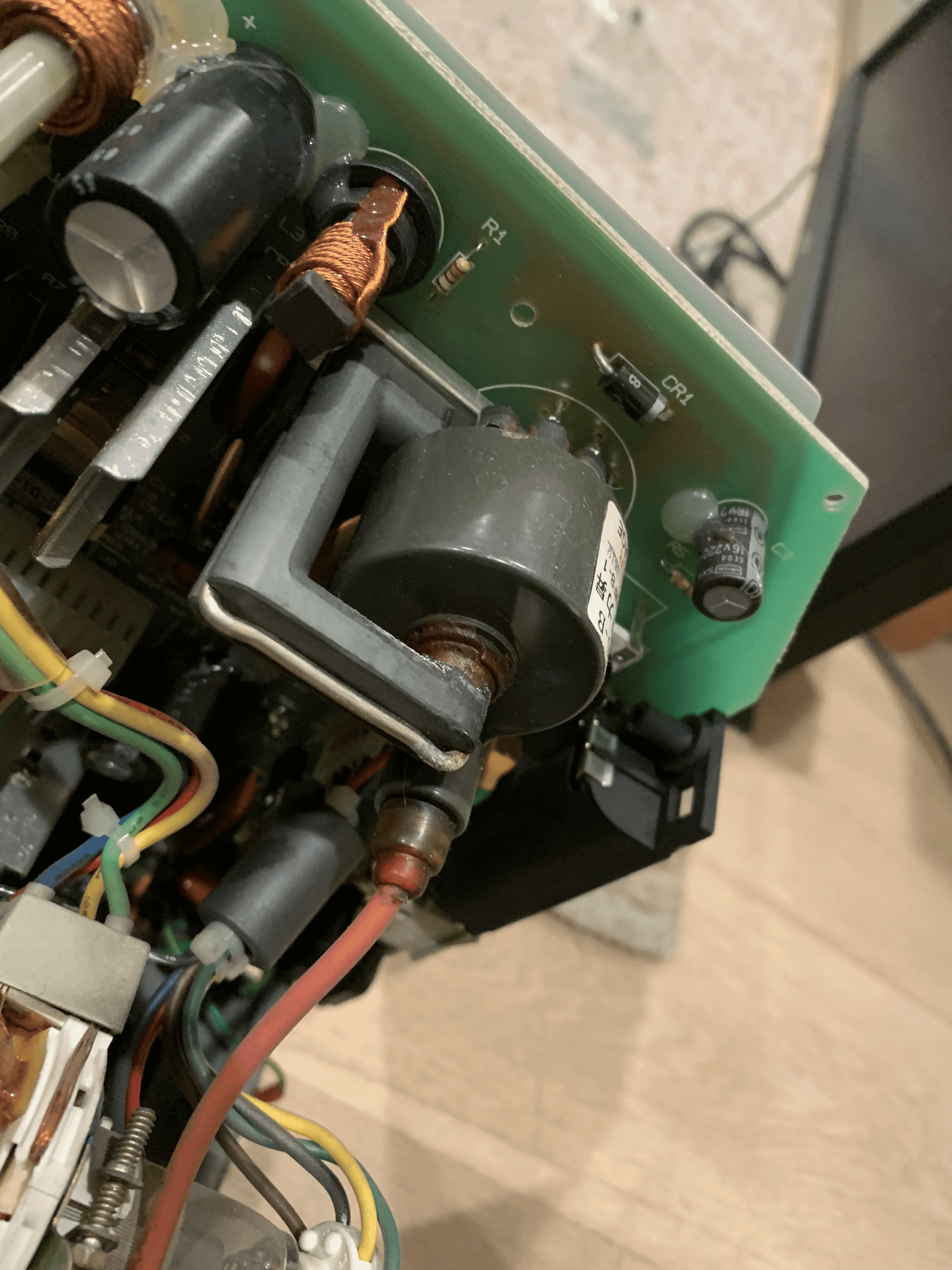

Here's a photo of the Plus transformer -- wondering if I should swap the 512k analog board into the Plus?
Any help is appreciated. Any idea of the value of these things?
Can't comment on the flyback (I don't see anything concerning in the photo, though). Definitely replace the RIFA caps ASAP. If your soldering skills are good recap the entire analog board.
@vtgeargead Ah okay. On the other side of the leg coming off the flyback there looks to be some corrosion. Is one Flyback better than the other?
Already bought a Console5 kit for both analog boards. Do you know if it comes with the RIFAs?
If both flybacks appear to be operating correctly my advice would be to leave them be. The Console5 kits come with all caps required, RIFA and otherwise. Note that most of the board caps are gobbed together and/or to the board with hot-melt glue. If it can be peeled away safely, do so. Otherwise a fresh X-acto blade can be used to cut them free. Be careful around the height and brightness pots. They are made out of ceramic and it's easy to break one with a tool swipe. Ask me how I know....
Would you be so kind as to post a picture of your brainstorm accelerator?
Attached is a photo of the whole board and just the area the accelerator is installed. Lmk if you need any other photos! Out of curiosity, do you happen to have one?
