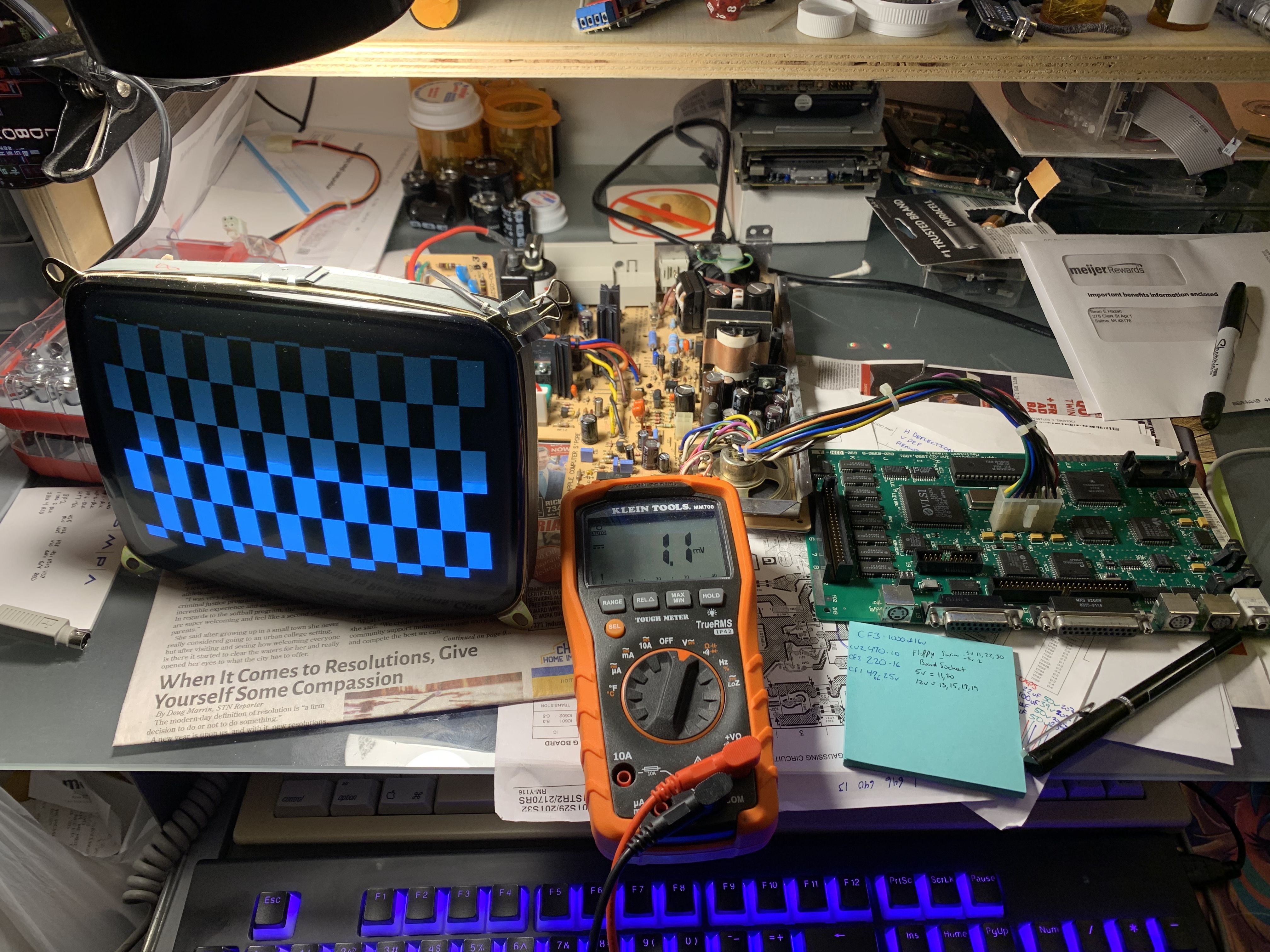

Image 1 current state: all peripherals out on desk to access easier

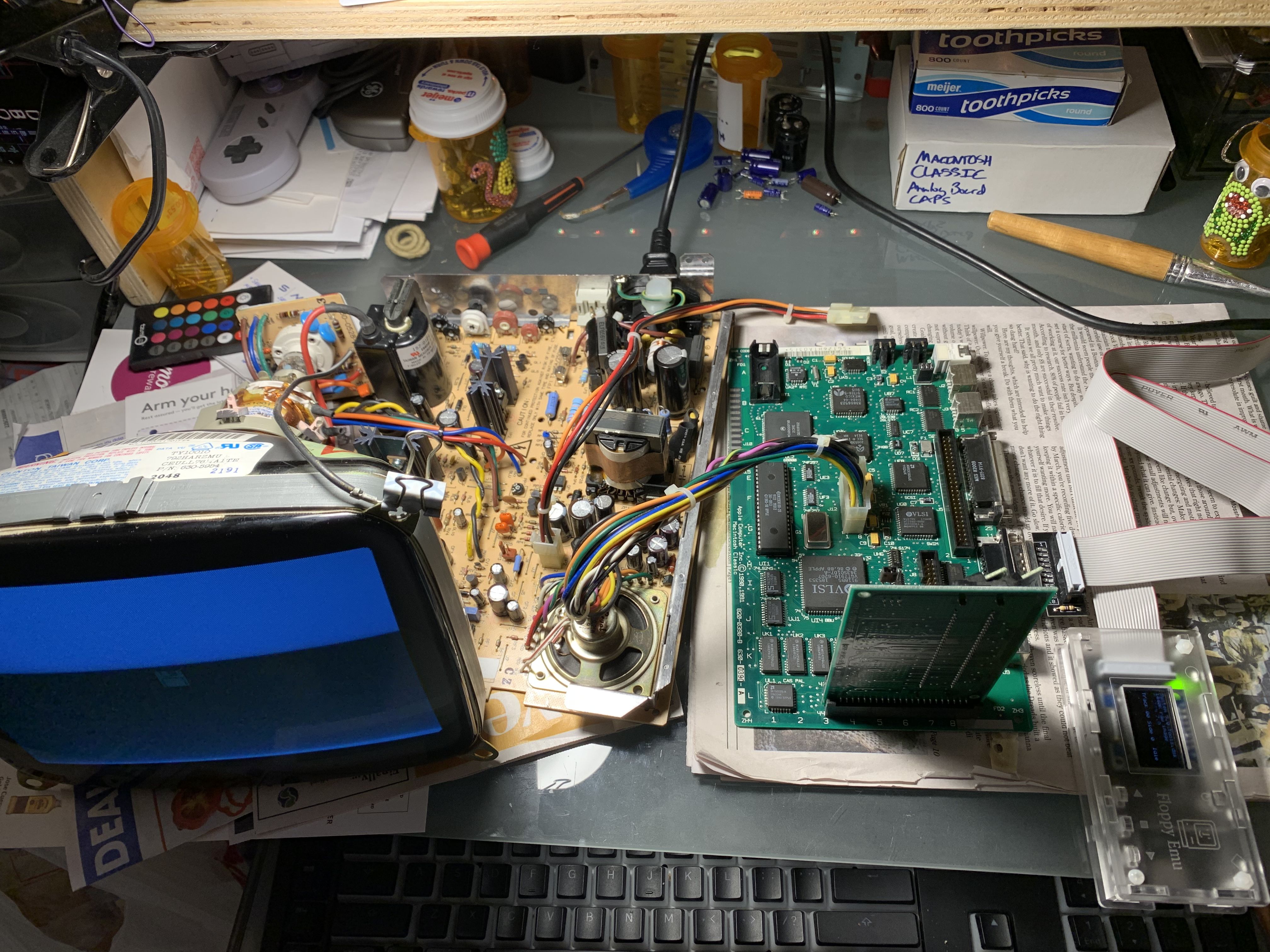

Image 2 Analog board post recap

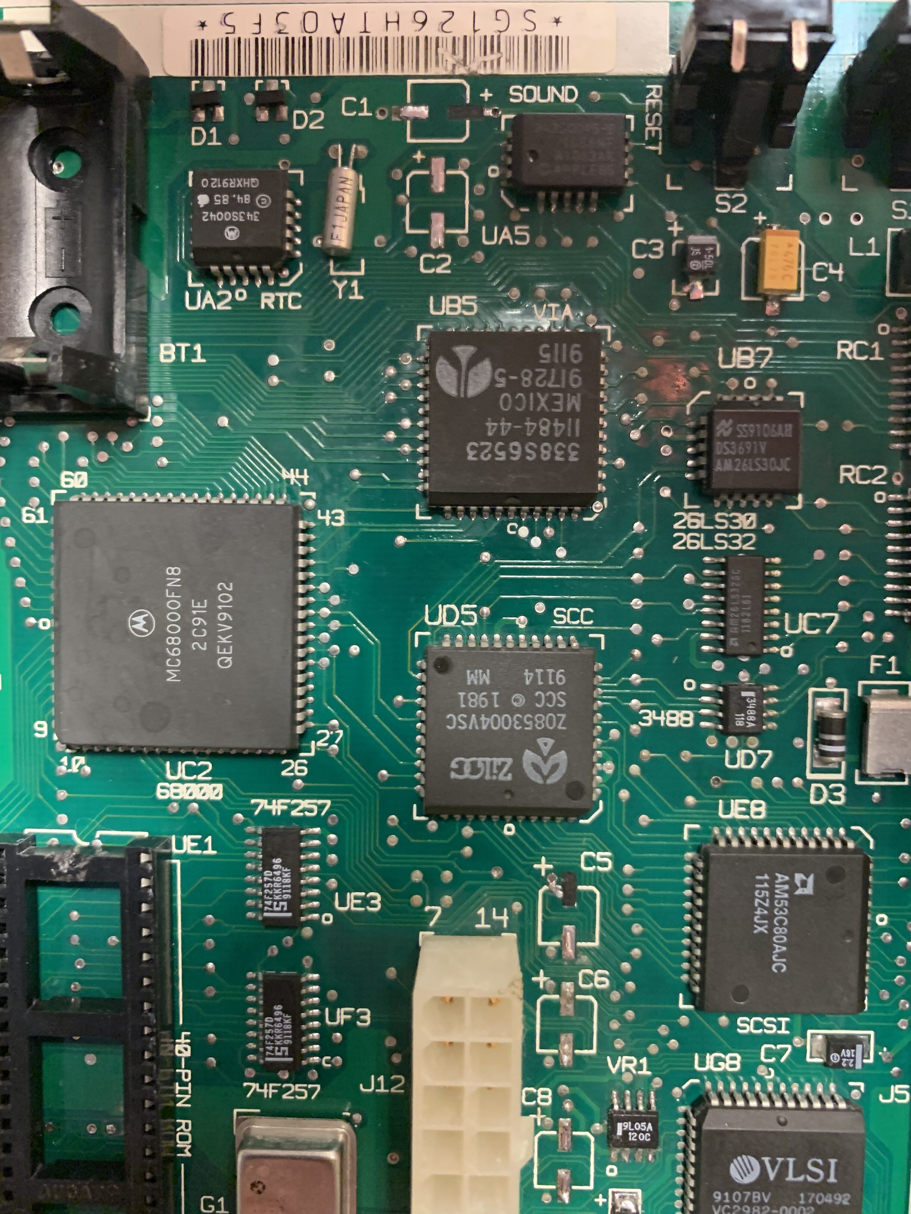

Image 3 worst extent of damages after removal of corroded SMD caps, prior to deep clean, reflow, and bodge. No evidence of any corrosive damage to any traces or chip legs that I can find.

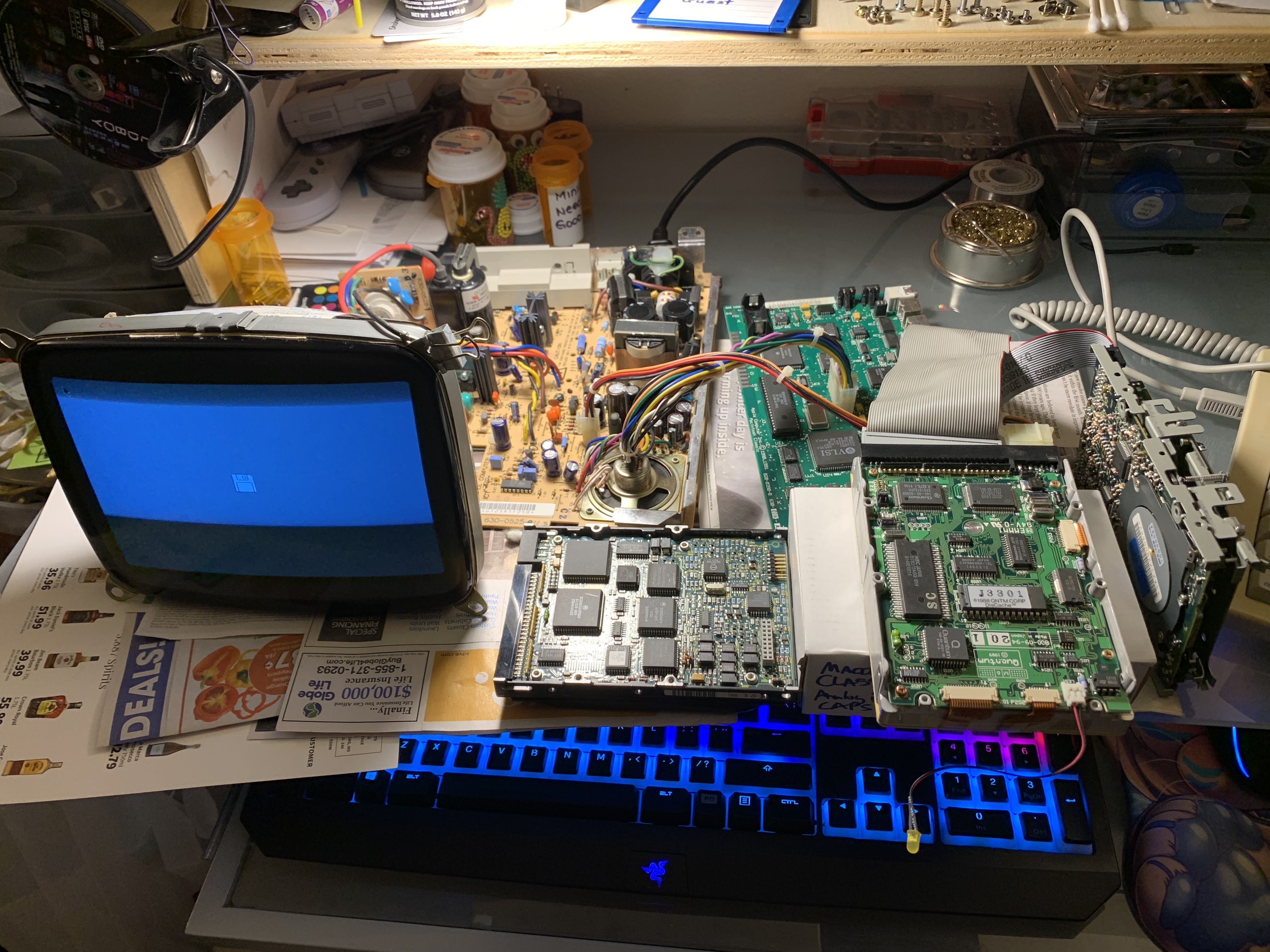

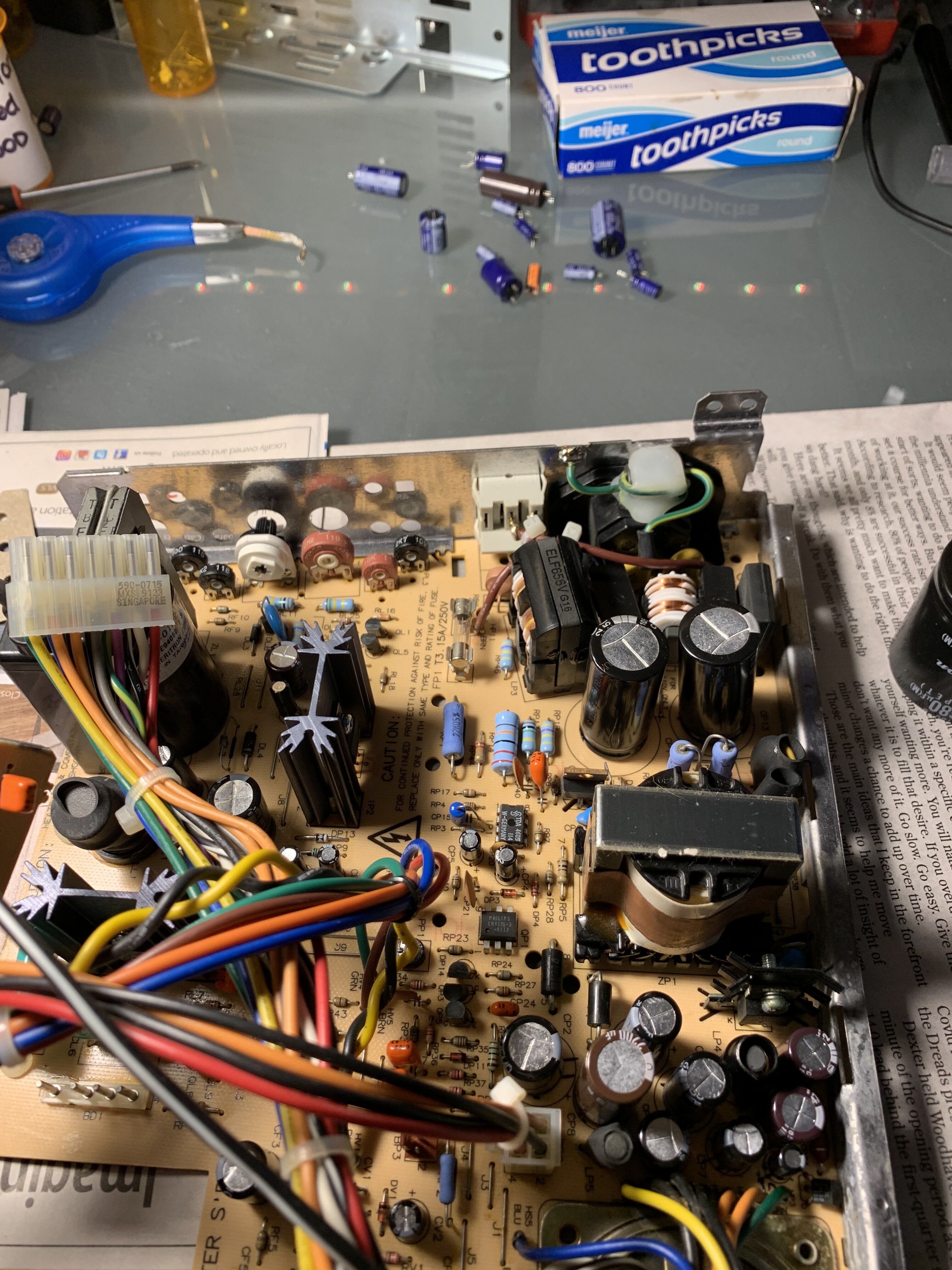

Further testing the Classics drive in the SE might be something to do in the interim, I haven’t gotten it to boot on that machine that I can recall, however the good working drive from the SE won’t boot on this board either. Any drive never seems to go into seek mode beyond its initial head test that I can tell.

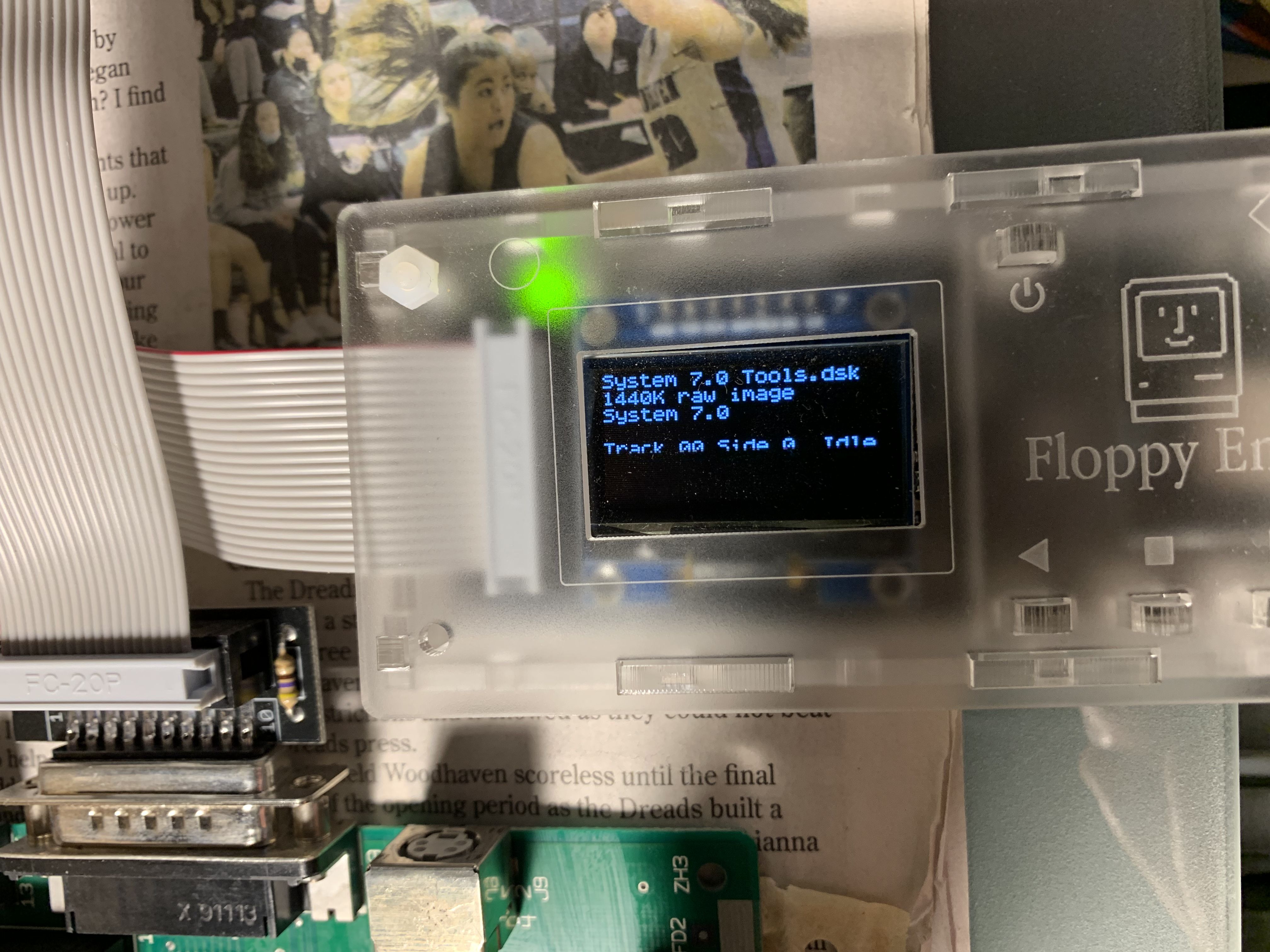

I do not yet have a BlueSCSI, but I did just try the FloppyEMU, it never appears to register with the board either, however, remaining idle on an image that boots fine on the SE
looking more like a logic board issue at this point, both the SWIM chip and the SCSI chip never appearing to send the command down the line to load rhebdrives
