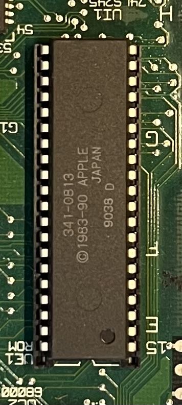

SO, research is guiding me to the ROM. Started by double-checking orientation and position (40 pin chip in a 42-pin socket. . . you know the drill). Tried a little Deoxit. ROM is properly installed position, but still no joy.
I have no knowledge of this ROM chip—might be good, might be bad, might have been installed improperly by previous owner at some point. Who knows. I also don’t have any spare Classic parts to swap.

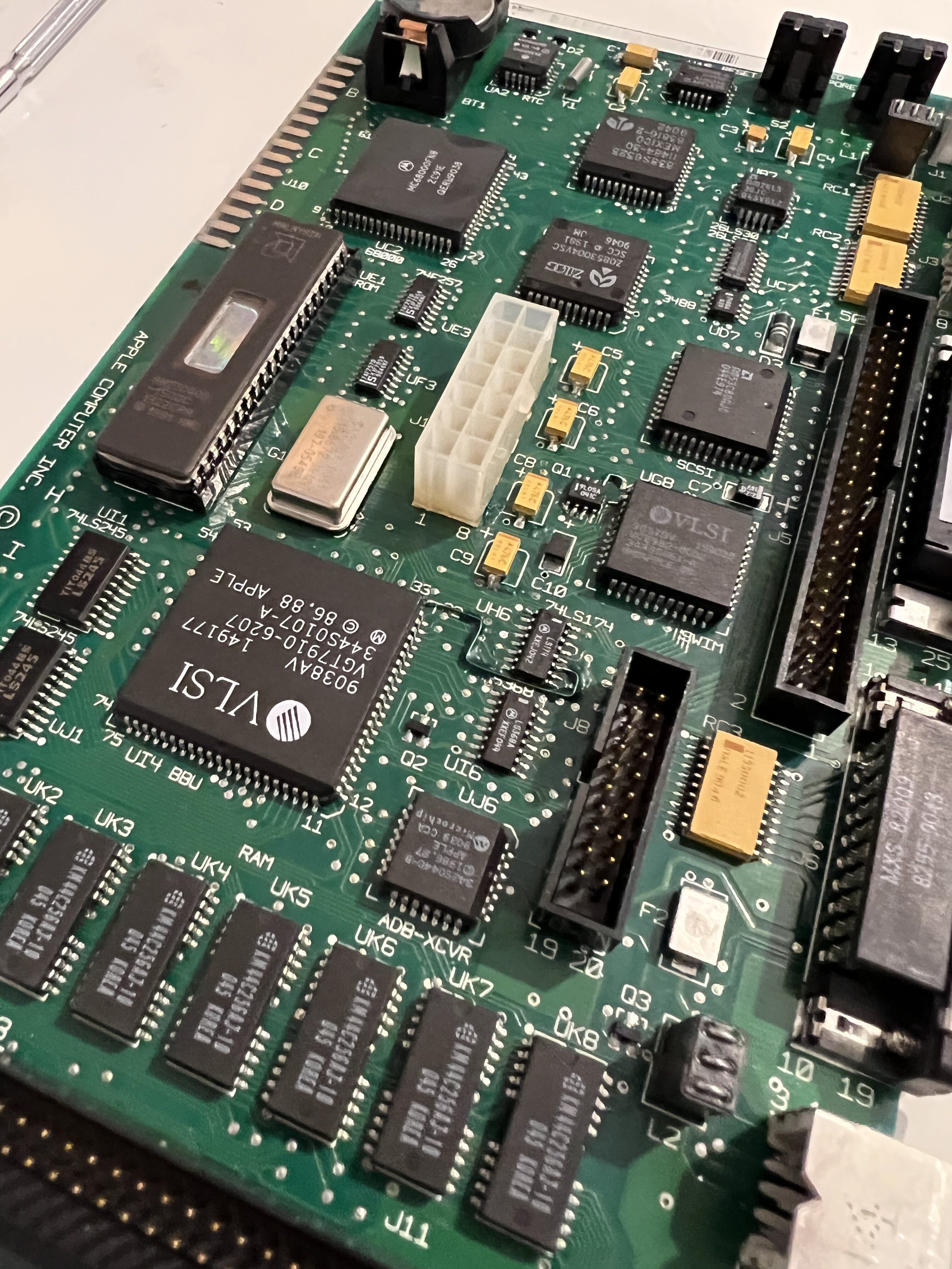

Successful Macintosh troubleshooting is rewarded with a chime! It‘s actually a great feeling to hear that when you have only received blank displays, stripes or checkerboard visuals. I am happy to report that I fixed the Mac Classic.
After an easy recap and cleaning, this logic board had several corroded areas. The pins of Q1 for example were hidden under a crust of black gunk and the via next to pin 5 was rotten. UH6 was hiding a broken trace from pin 11 directly under the package. Yet, even after removing and resoldering these along with several bodge wires I still had the checkerboard. Despite continuity testing all address and data lines from the ROM to the CPU, the Classic refused to sing a note.
As I mentioned above, I was hoping to try another ROM. I even ordered EPROMs and planned a burn session with a friend, but I had obtained the wrong chips! We decided to read the existing ROM anyway and compared it to a downloaded file and they were identical—sort of a good news bad news situation. Frustrated, I worked on some other systems while I ordered the correct EPROMs anyway. My original ROM was OK, but a spare or two couldn’t hurt and it was a good learning process.
Yesterday, I thought I would check my recapping work for bridges or shorts, as several of the caps straddle multiple traces. After about an hour of careful inspection and checks here and there, I turned my gaze back to the area near Q1. Thats when I noticed the thin traces from pins 8 and 9 on UG8 — the SWIM chip — looked a little sketchy. The traces divert around Q1, under C8, then around the power connector and toward the ROM. . . Hmm. . . maybe I was onto something?
I found an easy spot to scrape away some solder mask on the trace from pin 9 which buzzed OK. Pin 8 however was not connecting to its trace! I found a corroded break in the trace right at the pad for pin 8–an easy fix.
BING! Gotta love that sound!

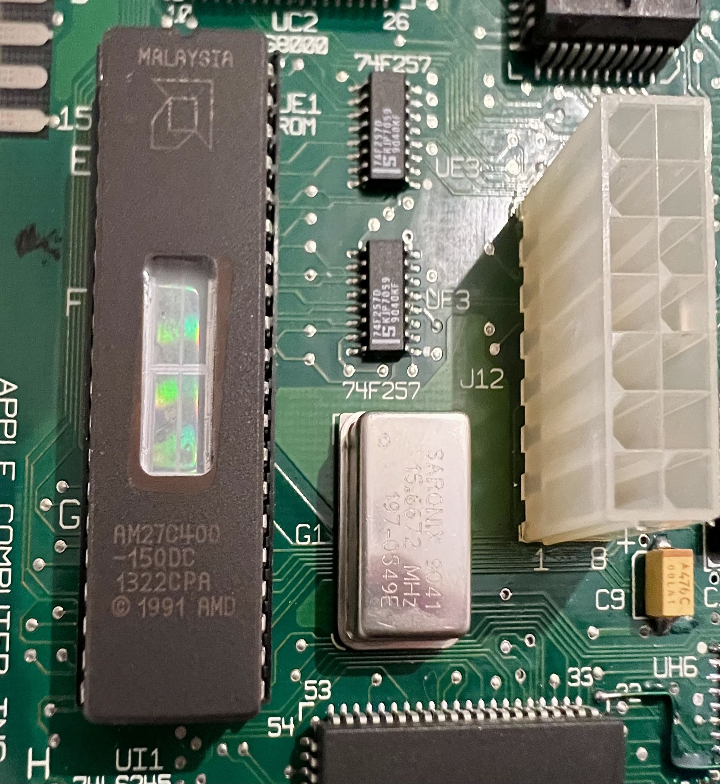

Today, we finally had a chance to burn a couple EPROMs. Two out of four worked fine. The other two failed to write for some reason, even after successful erasing.
I tested the custom ROM and the Classic boots right up! Very cool. Now I have a couple of spare. Even though the original ROM turned out to be OK, I am going to run the custom EPROM for the fun of it. I am attaching a picture of the final work completed. Note the long bodge around one of the smaller chips and some work on the SWIM chip and Q1 near the four capacitors.

Here’s a closeup of my working custom ROM chip in case it helps. This was before I put a sticker over it:
