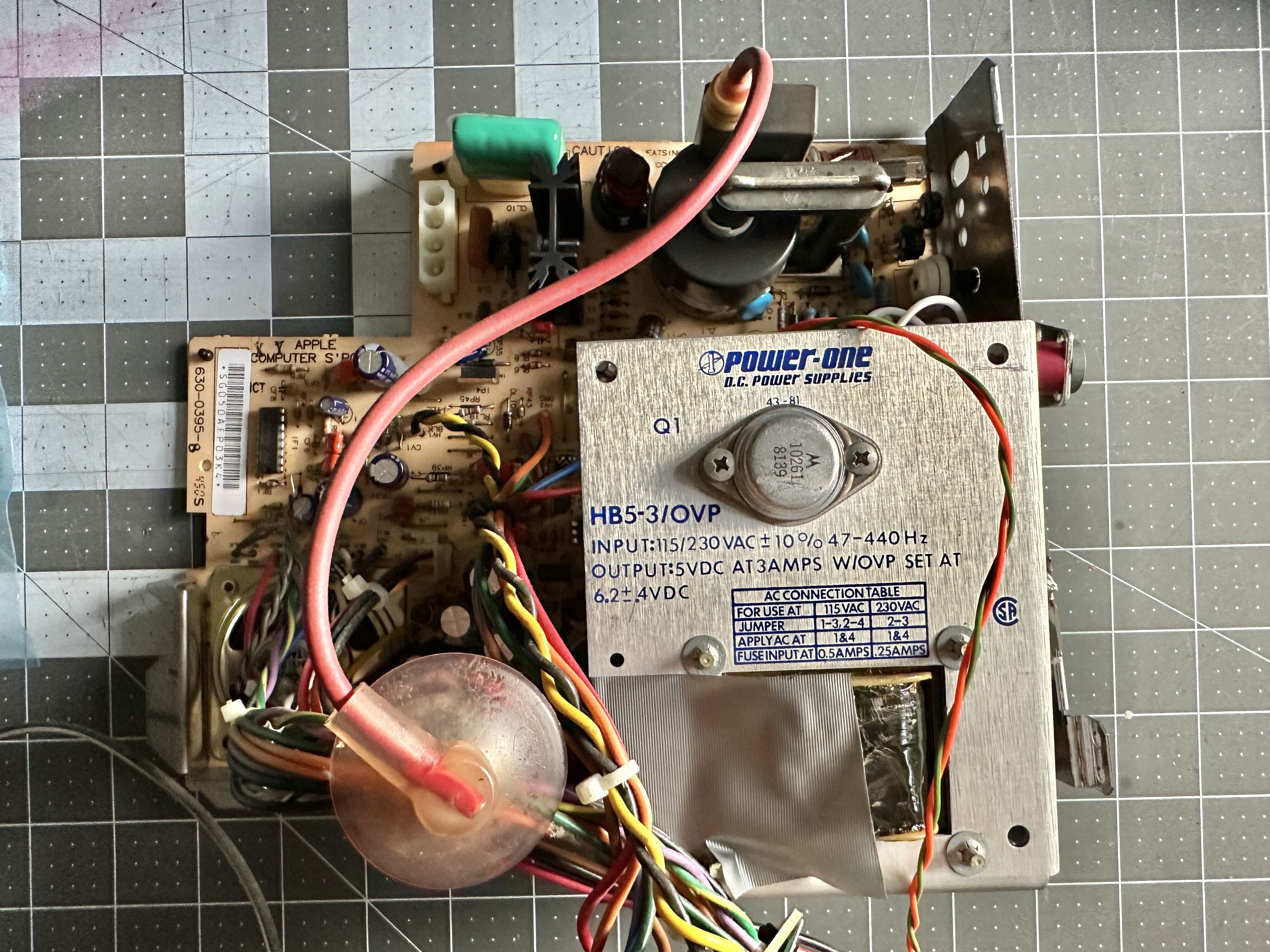

OK, some digging suggests that there are feedback resistors that can drift over time, so voltage sag makes sense. My question now is...where's the voltage adjustment on this analog board? Not seeing anything obvious other than the video adjustment pots on the back.
EDIT: Never mind, found that this revision still has the PP1 adjustment pot, it's just slightly hidden by the big 5V PSU.

I have yet to figure it out. Replaced caps and bridge rectifier and the driver chip.
Hey Colin, I had a similar issue with a Classic AB, recapping it fixed the voltage problems it had but I still had the shake especially when the power supply was first turned on. I ended up replacing the DP3/DP4 diodes as well as the OP1 optocoupler and that seemed to do the trick - it was rock solid after that.
Regarding the capacitors - I’d suggest at least maybe lift a few of them off in that big cluster especially and check underneath them. I don’t think I have seen a Classic AB to date that doesn’t have some sort of cap leakage at least starting to happen. I’d double check under them and if they are still all good you can easily just put them back on.
