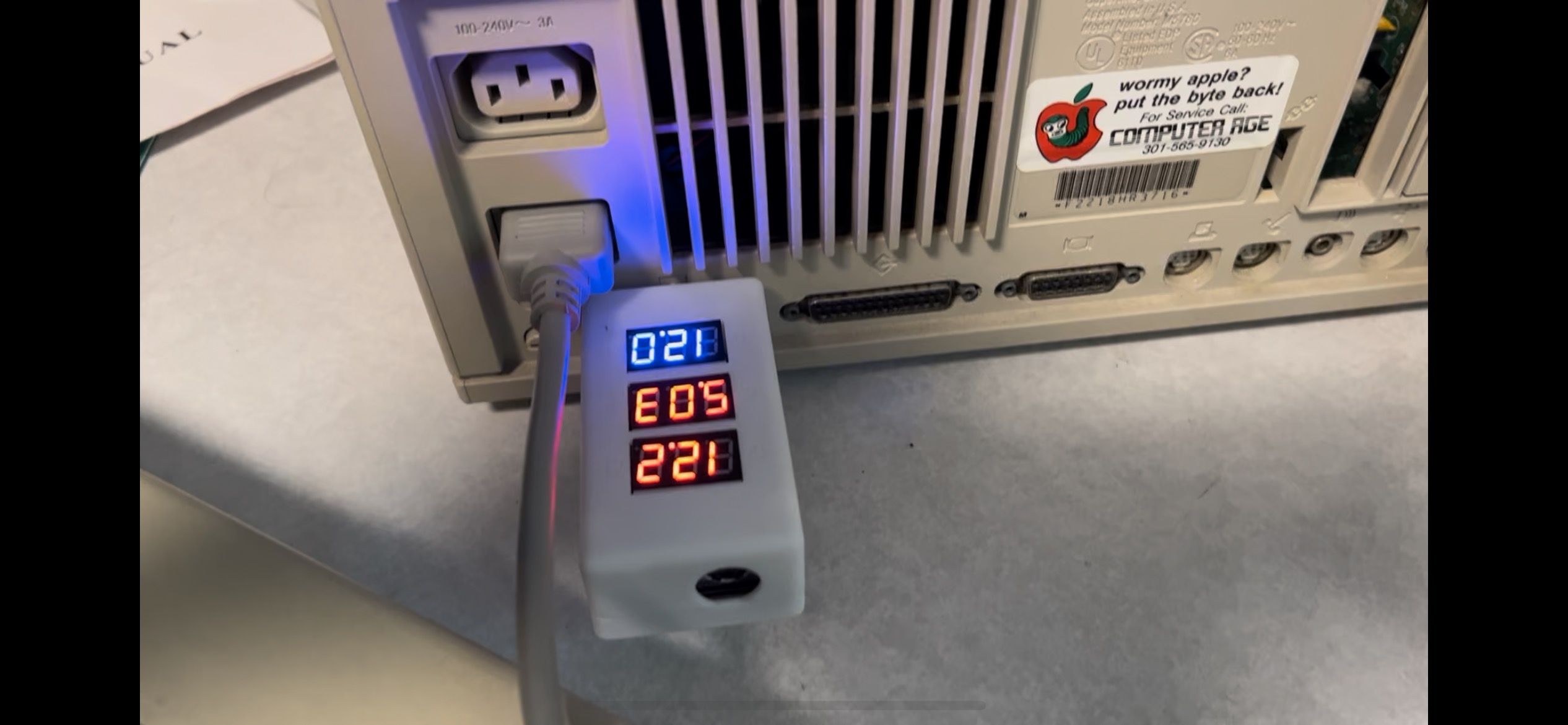

Just put the GE PSU from the IIcx into the ci and it fired up! Mac-O-Meter says I have decent voltages.

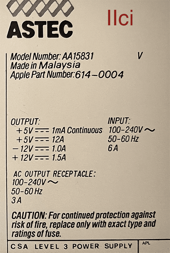

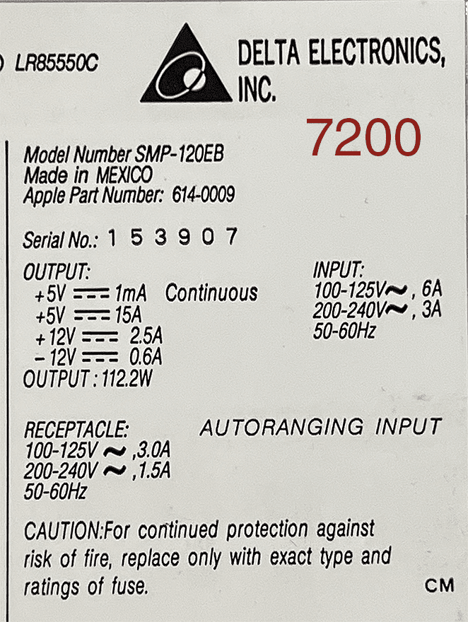

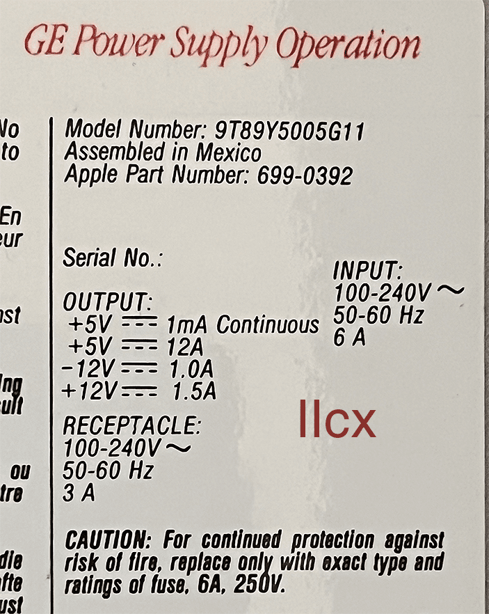

I only have one more PSU of that form factor from a 7200. I did not see it in the last of compatible models Above. Specs are CLOSE, but slightly different.
Here are the specs w/the model names typed over them:
Is it safe to install the Delta in my Iici even though some of the current specs are different? The GE & ASTEC have identical specs.

Think you might mean 7100... The 7200 uses a power supply with a harness, if I remember correctly. Yeah, the part number corresponds to a Centris 650 power supply, so that would've come from a 7100, not a 7200. So, you can just install it into your IIci. With respect to the monitor, I don't think that would've caused the power supply to die, unless it has an internal short somewhere, which is possible, due to it only showing red.
