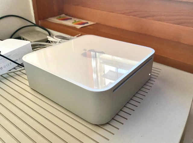

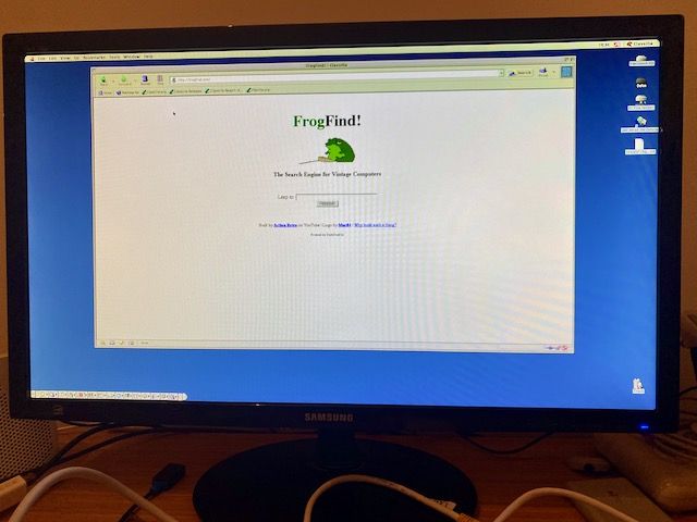

Hi,
this section is a bit empty, so I will show off my new Mac mini G4 1.5Ghz that I got for cheap, mostly with the objective of having something small to run Mac OS 9.

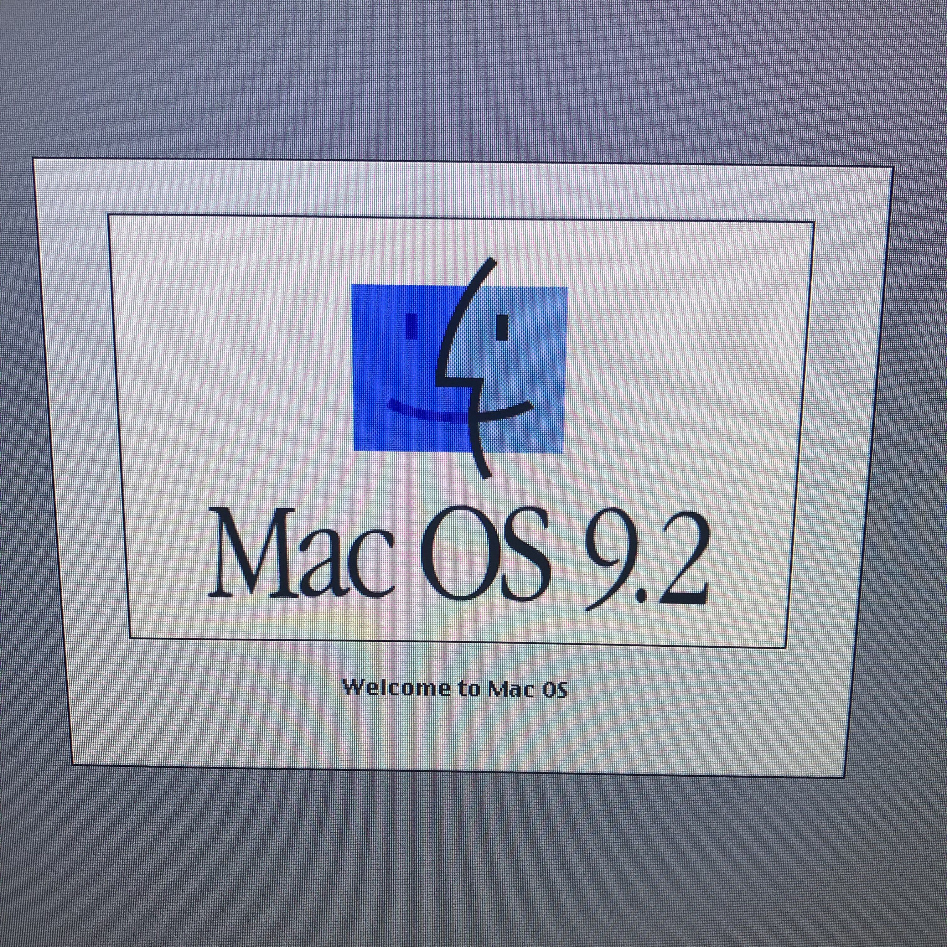

I used the Mac OS 9 Lives! setup for unsupported Macs.
It works like a charm, with the only issue of not having internal sound. Only works with external speakers and the quality is bad, but in theory can be solved with an USB sound adapter. I ordered one and hopefully will do its job.
Definitely this is a great machine to play some games and try stuff made for PowerPC, while I still prefer my good older 64K machines...

The process was surprisingly easy. However, I had to make a late night run to Walmart to pick up some blank CD-RWs. My goal has been to play Deus Ex on a system running the original program on a native OS. With the maxed out RAM and SSD this is blistering fast and satisfying project.
