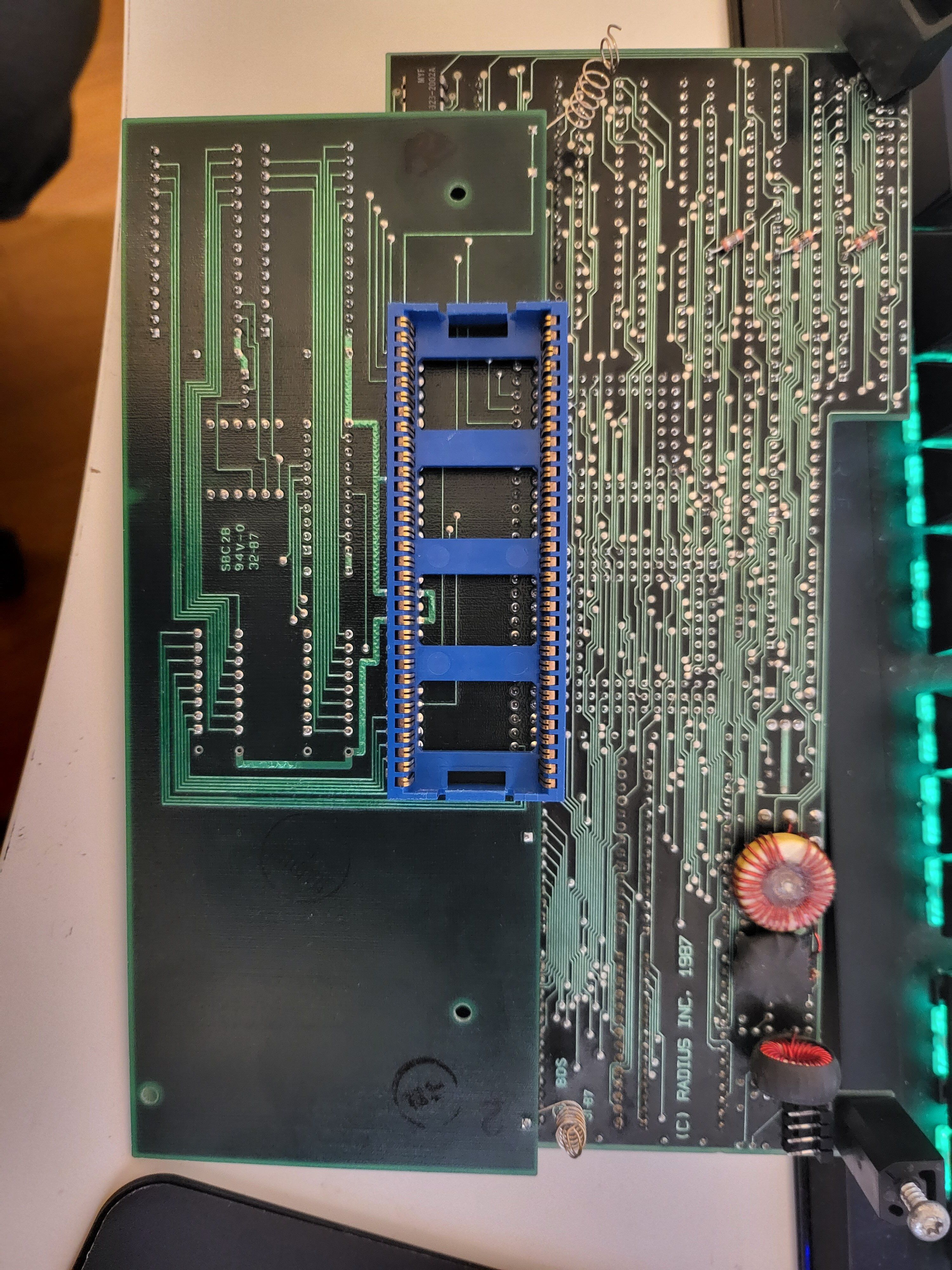

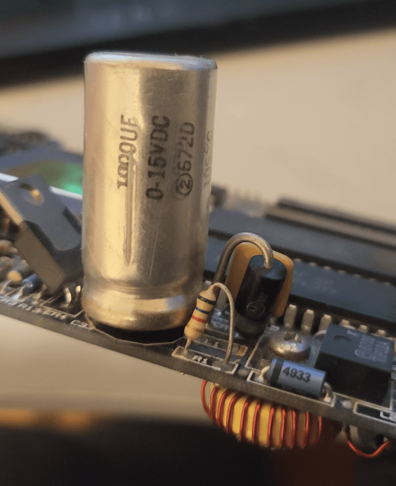

I have a Radius Plus Accelerator that came in my Mac Plus, but there is an obviously bulged cap on it and I want to replace the tantalum that I read somewhere is prone to blowing up. The cap that is bulged on the accelerator board has a mark in the side that makes it so I can't tell if its supposed to be 1000uf, 1800uf or something else. The only other two I've seen online have a different cap where this one is, I've seen one 470uf and another I couldn't make out, but they both were on their side instead of this one being straight up. Is it also safe to replace that tantalum cap with a normal electrolytic? I think I have a 10 or 16v 150uf cap to replace it with already. I do have the software for it, but does anyone have a manual for this? I don't know how you get the Plus board into the computer easily with it in there, I had to slightly bend the side with the rails to pull it out from the bottom because said cap hits against the internal metal frame of the Plus (probably why later versions had it on its side?) as well as where the grounding springs go on the main Plus board. If anyone has any info about these boards it would be greatly appreciated. I've attached a picture of the cap with the mark on it so maybe someone can recognize it.

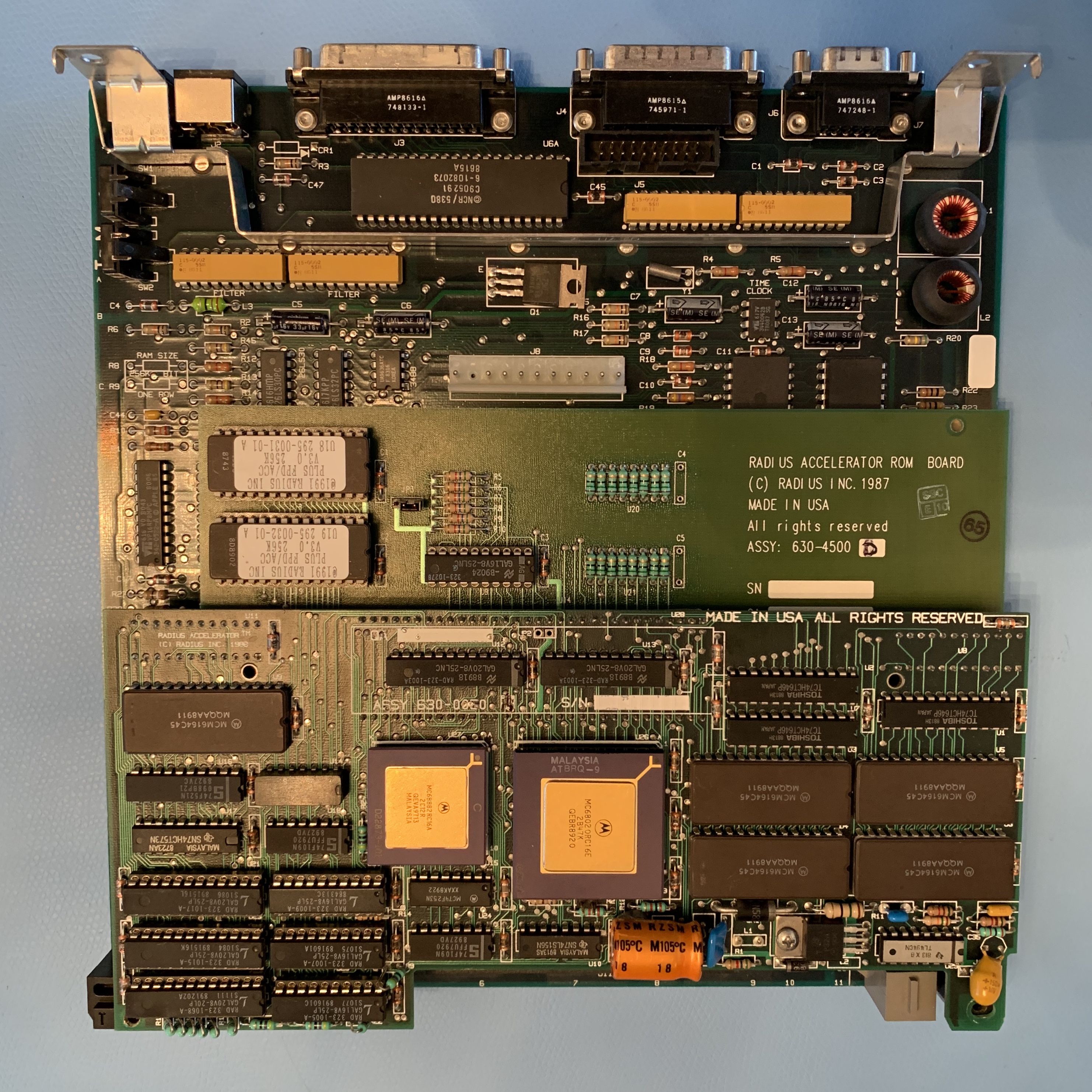

Here’s the one I used to have which clearly shows the fat cap you are looking at (I think). But I agree, yours looks a little funky in that area.

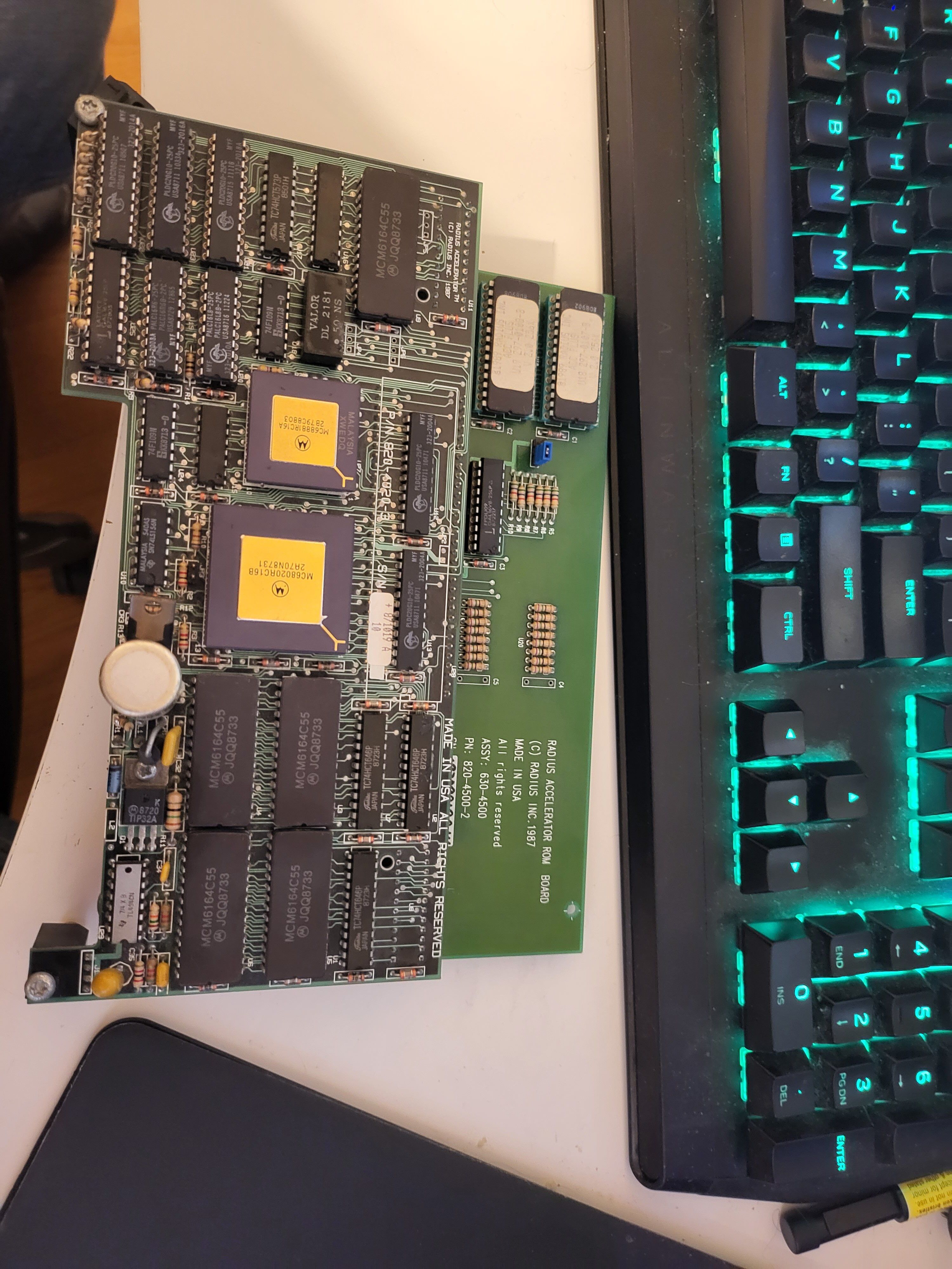

Here's the top and bottom. Going off the copyright date of 87 and the fact mine's serial number and board both say 87 on it makes me think that this is an early one. Are the serial numbers of the boards after the year in sequence?

You can also see the ROM version number on those ROM chips. You have v2.0, I had v3.0 (my recall is that only v3.0 is System 7 compatible).

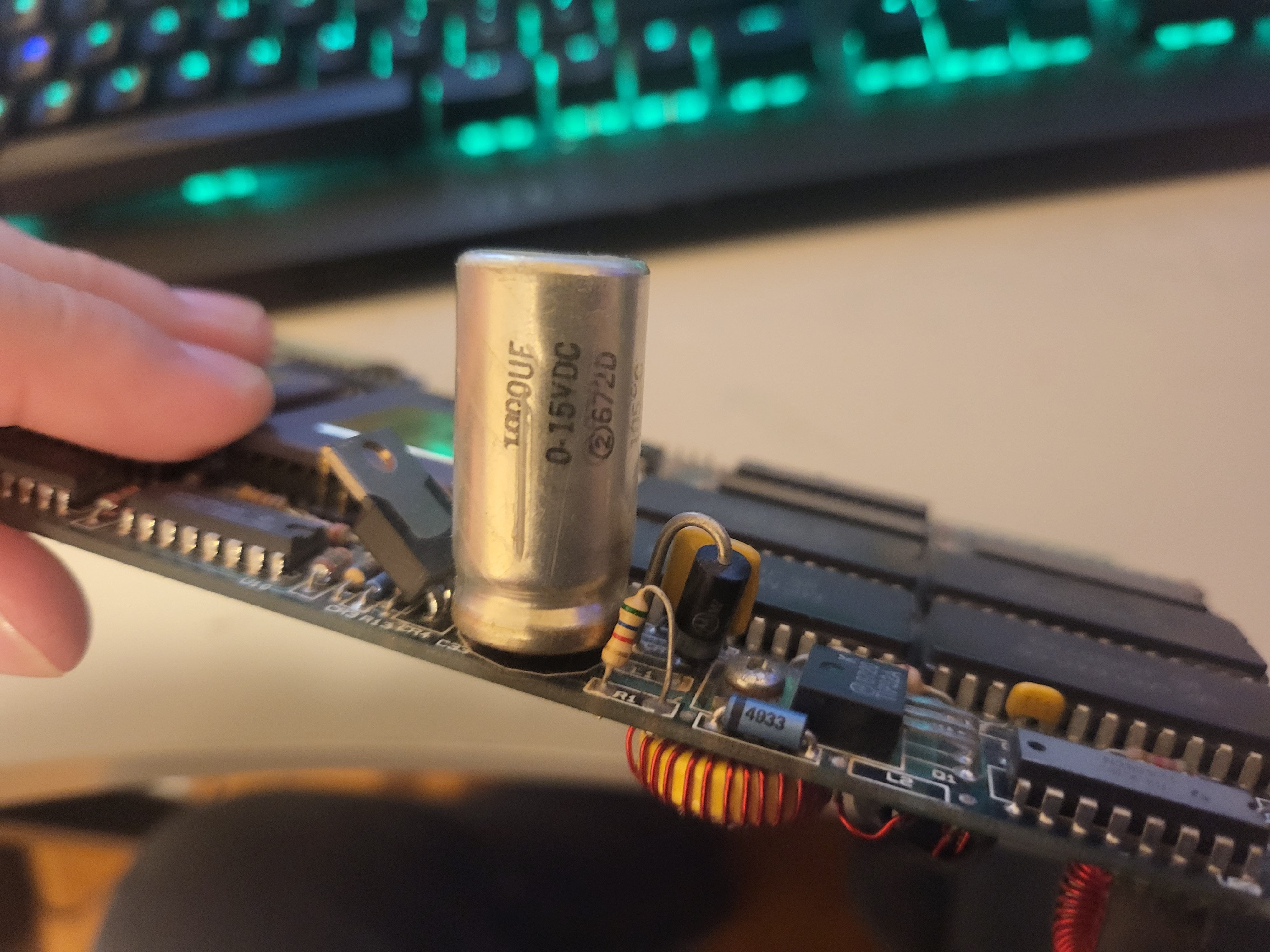

I did intend on replacing the tantalum cap as well, though the big electrolytic is slightly bulged on the bottom and I want to replace it before it gets worse and starts leaking. That gouge in the electrolytic makes it so I can't see if it's 1000 or 1800 or similar uf and I don't have an LCR meter to test it just yet.
Small update: I did test the tantalum with my multimeter and sure enough it is shorted. I tried testing the diode but on mine it is in a very awkward spot to test, one of the solder points is under a coil and its too closely mounted to the board in order to test it above, I probably will end up replacing it regardless.

Yet another update: I caved and bought a cheap LCR meter off Amazon and took that cap which is quite bulged on the bottom off and put it in my LCR meter, it reads about 1300uf which going off the 10% error roughly I notice on this meter I assume is supposed to be 1200uf or so? It doesn't look like it was supposed to say 1200, but its definitely not saying 1500uf. I plan on going out to get the caps and the diode I need to replace tomorrow.
Although Radius was a well-respected Macintosh products developer back in the day, it certainly looks like a case of "what NOT to do" when it comes to accelerator board design. Look at the size of that cap... Holy Cow!
I did end up figuring out it was a 1000uf cap there. I think for the later revisions they wised up about that since they put a 470uf cap there but sideways so it fit much better. Also one that has a readable sleeve unlike that.
