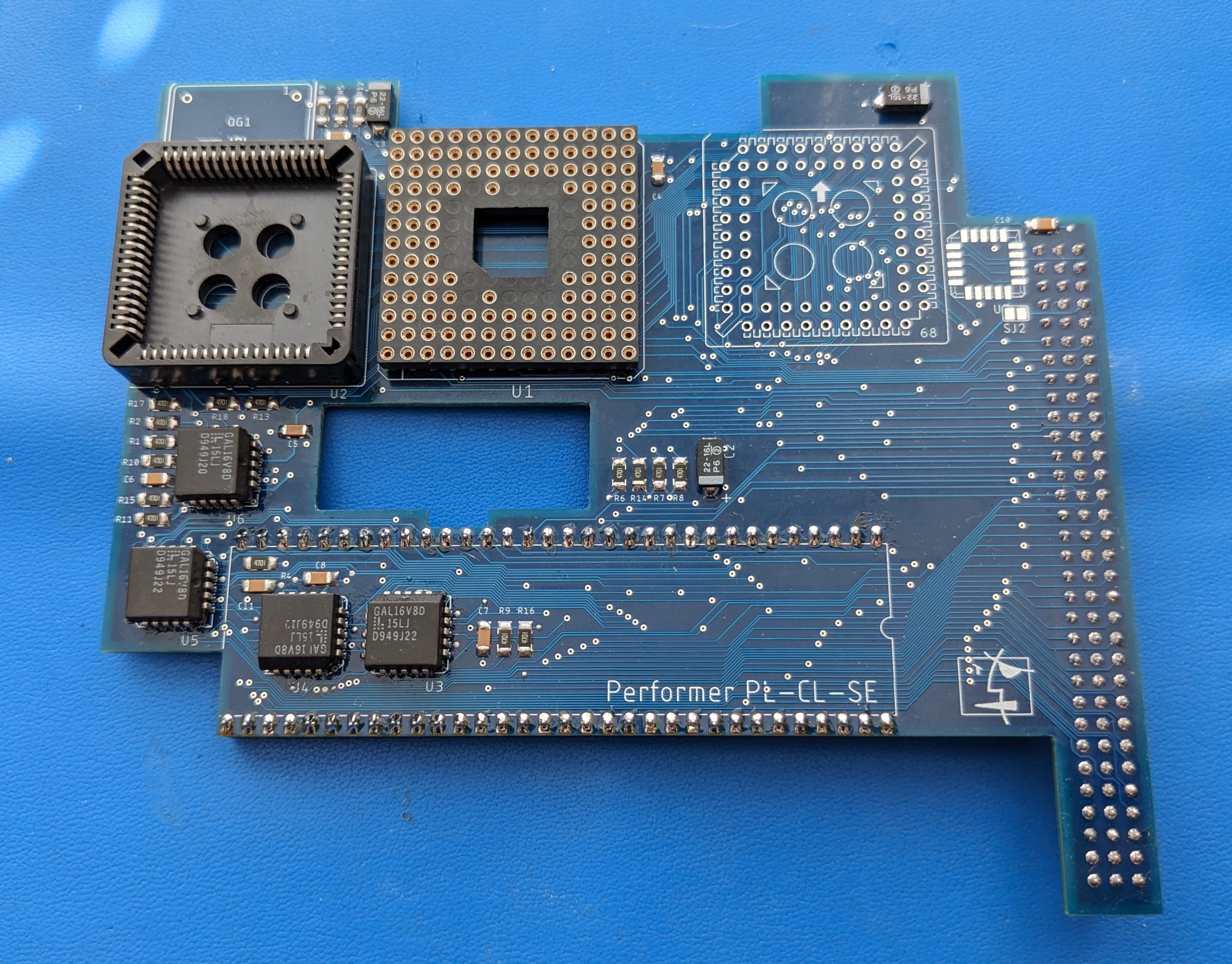

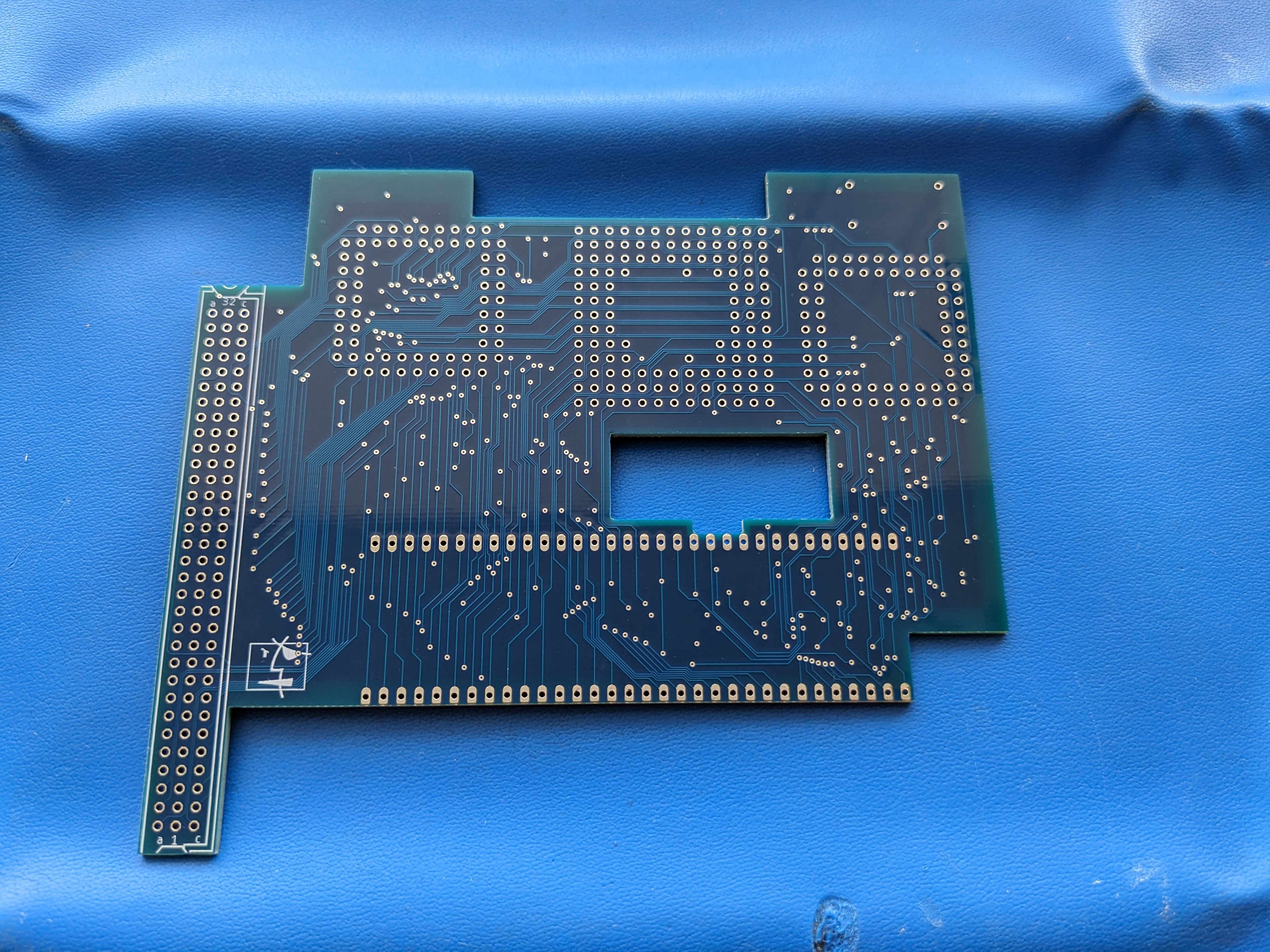

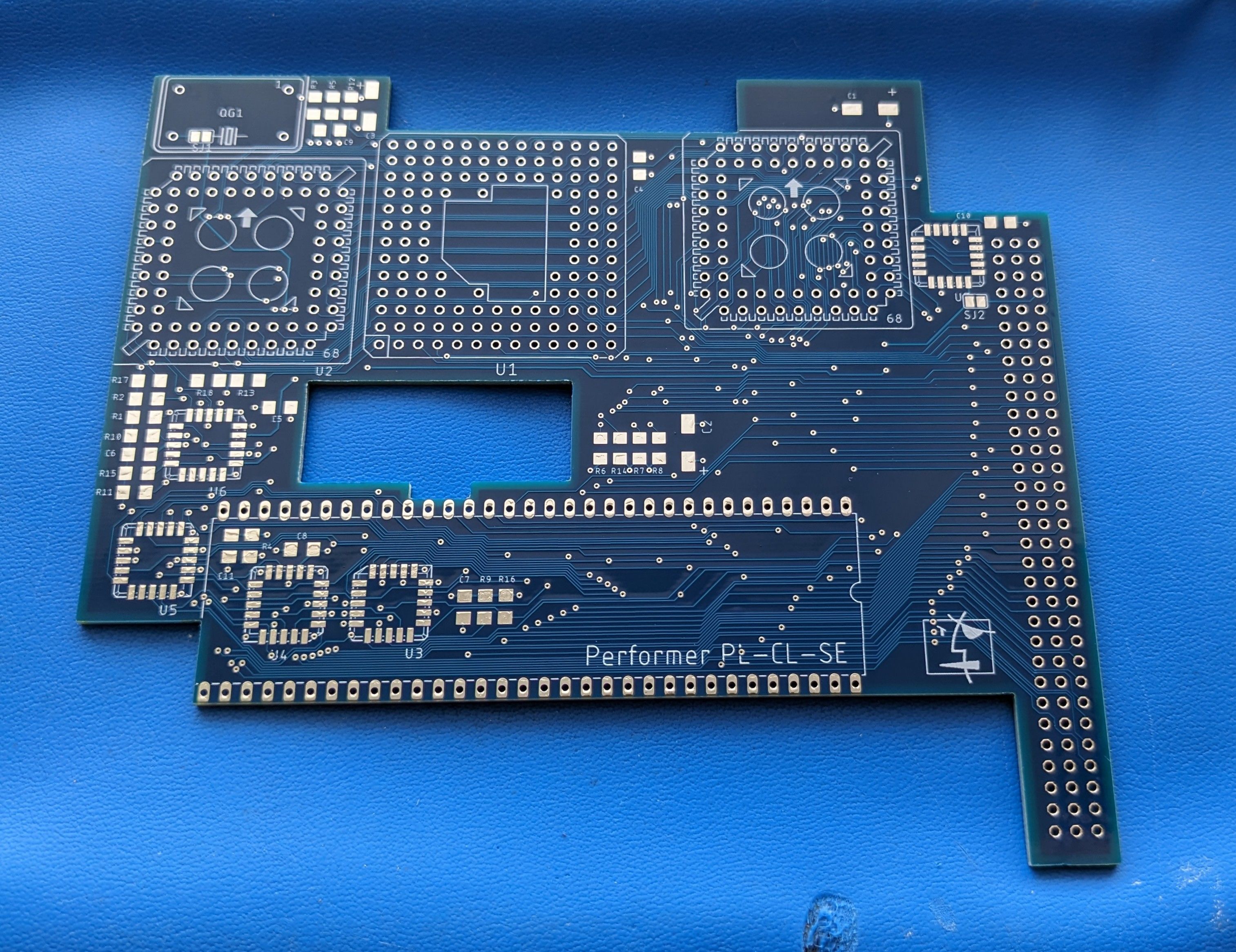

I started by uploading the board files to JLBPCB. I left all the options at their default settings, except I selected the blue board instead of green. After a new-user $10 discount, including shipping, five boards cost me right about $50.
Front

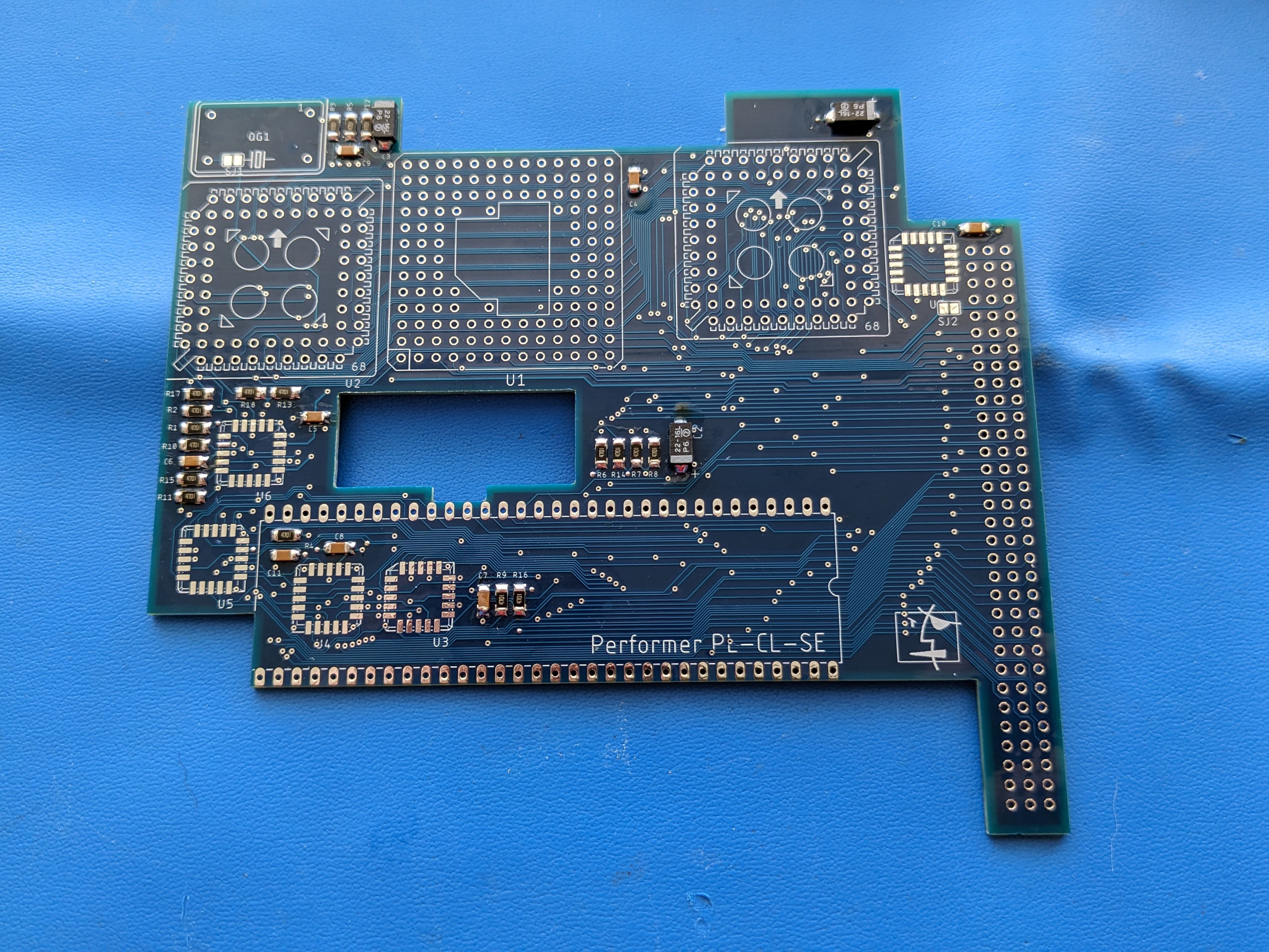

I started by installing the passive components (resistors/capacitors). I selected black tantalum capacitors to match the board color, I didn't like how the yellow ones would look.

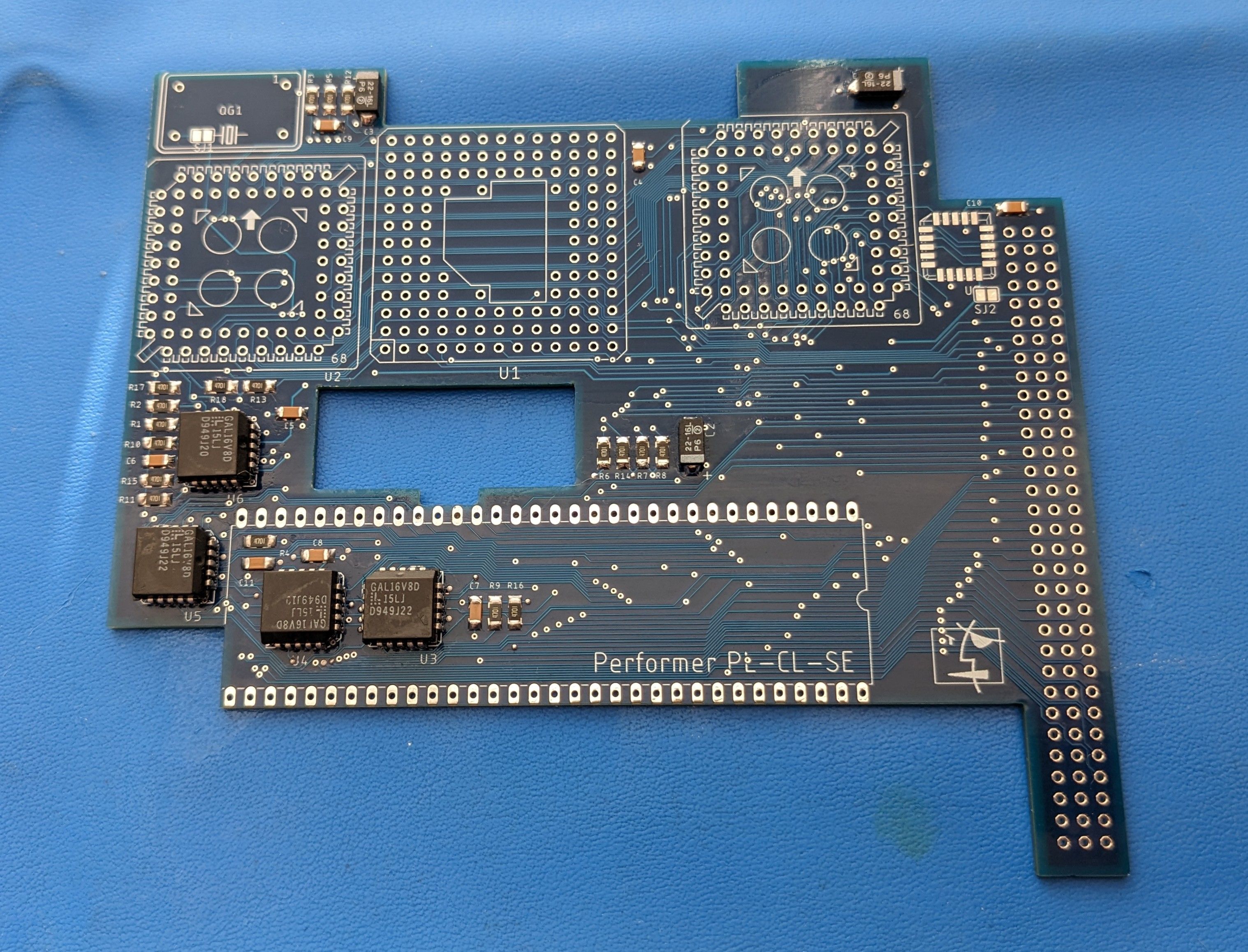

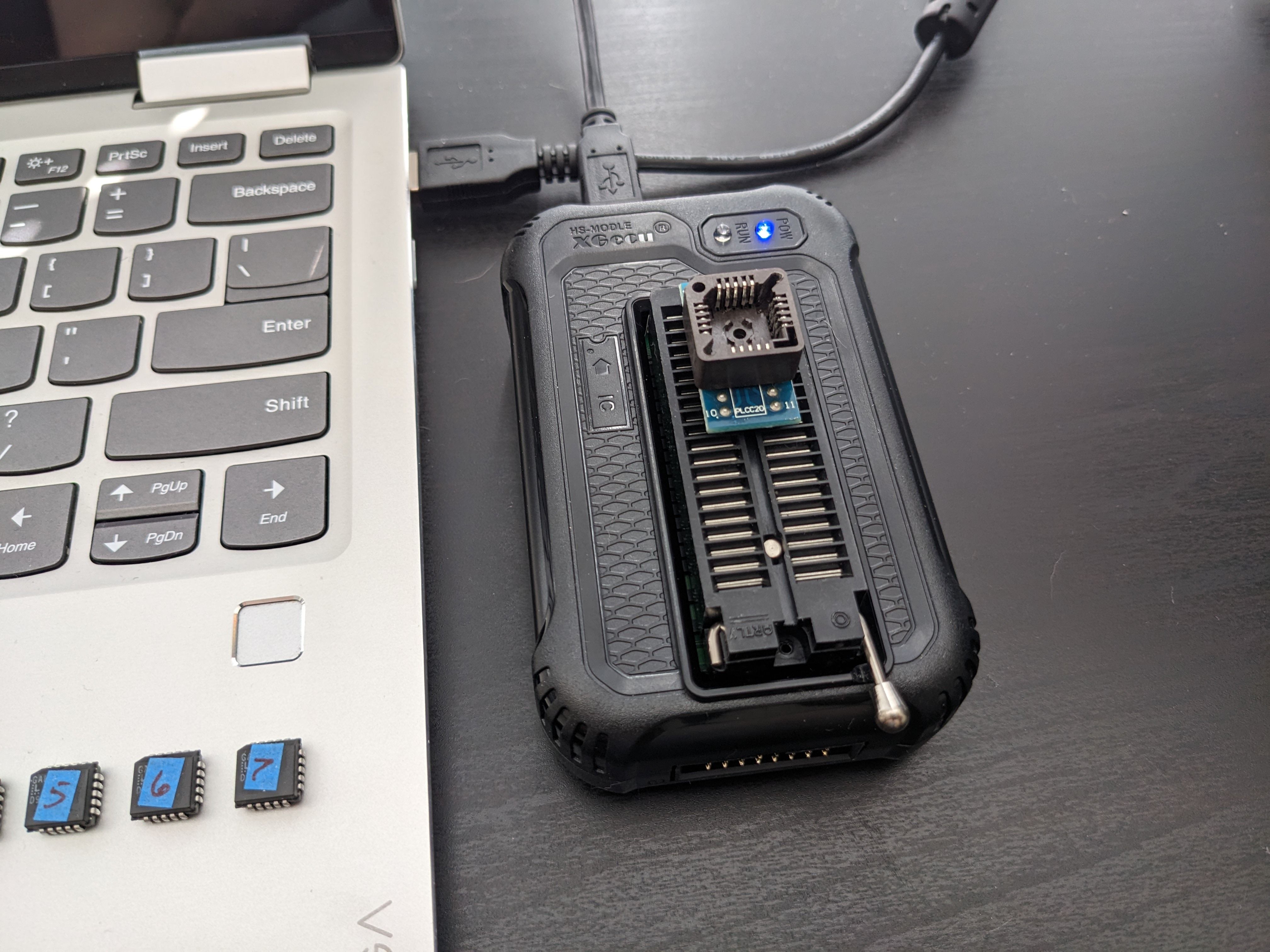

Next I moved on to the GALs. I purchased a T48 programmer on Amazon for $72, there are multiple versions/sellers, I selected one that had the correct 20-pin PLCC socket. The GALs were purchased from eBay, $12.99 for 15 GAL16V8D-15LJ chips. As mentioned in DrGonzo's thread, the "A" version will not work, but anything "B" on should work. I programmed the chips and installed them.
Note if you are using this board in a Mac SE you do not need GAL U7, and you DO need to bridge the SJ2 pads. If you use it in a Plus you will need to install U7 and make sure the SJ2 pads are not bridged.

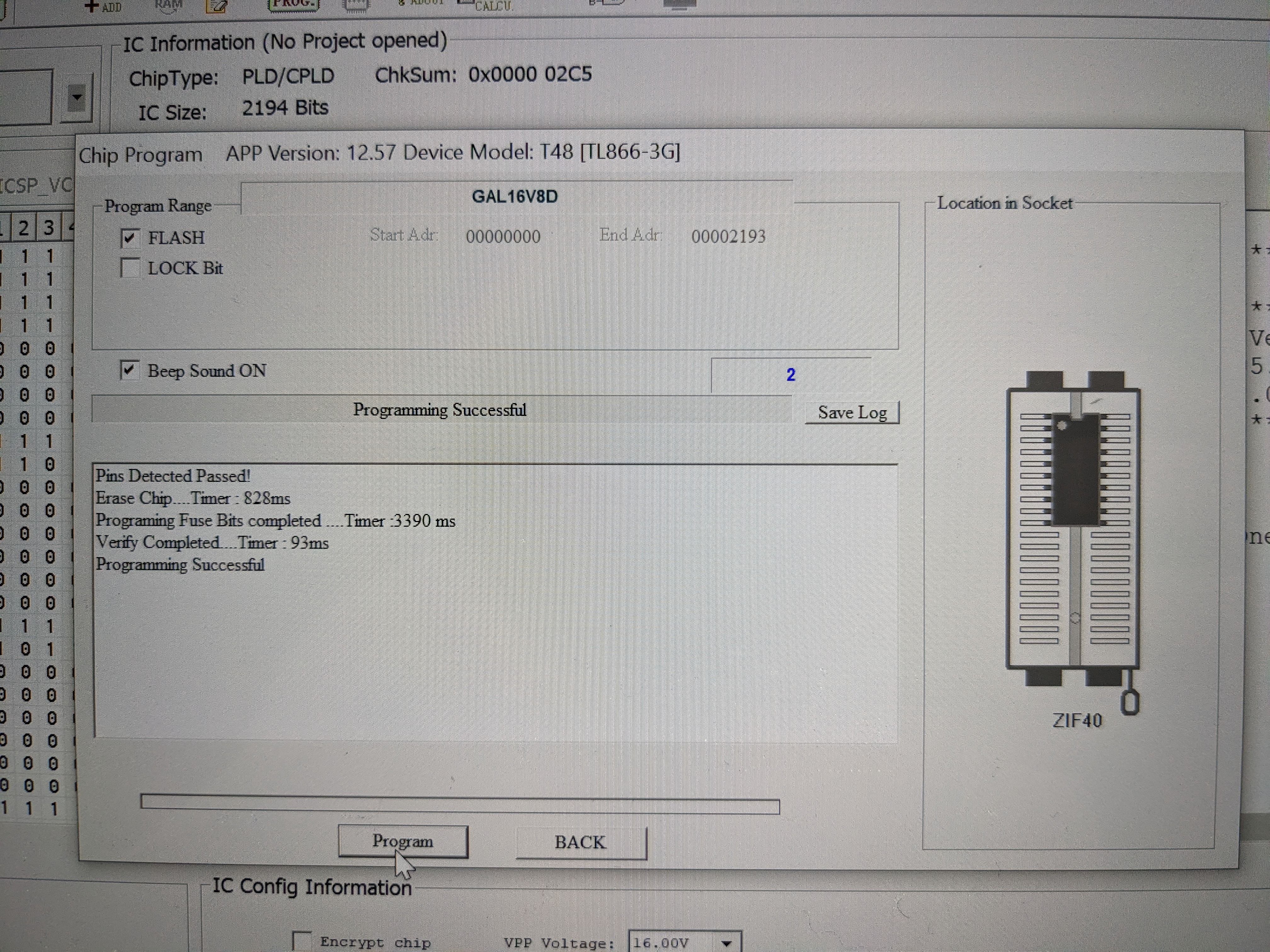

The Xgpro settings I successfully used are not shown in the image below. I used the "GAL16V8D-@SOIC 20", not "GAL16V8D" as shown in the photo. I un-checked encryption, and when I clicked the PROG. button I left both default options checked (FLASH and LOCK-bit).
I do not have a lot of SMD soldering experience, though I am pretty decent at it. That being said, I could not get some of the GAL pins to properly solder to the pads. No amount of solder and flux was doing it. I used a small chisel tip on a good Hakko iron. Finally I bought some ChipQuik solder paste and it worked great. I used my $40 hot air station (from Amazon) to remove all the GALs, and re-installed them with the solder paste. I followed up on each pin with my iron to make sure all the flux/solder mix melted properly.

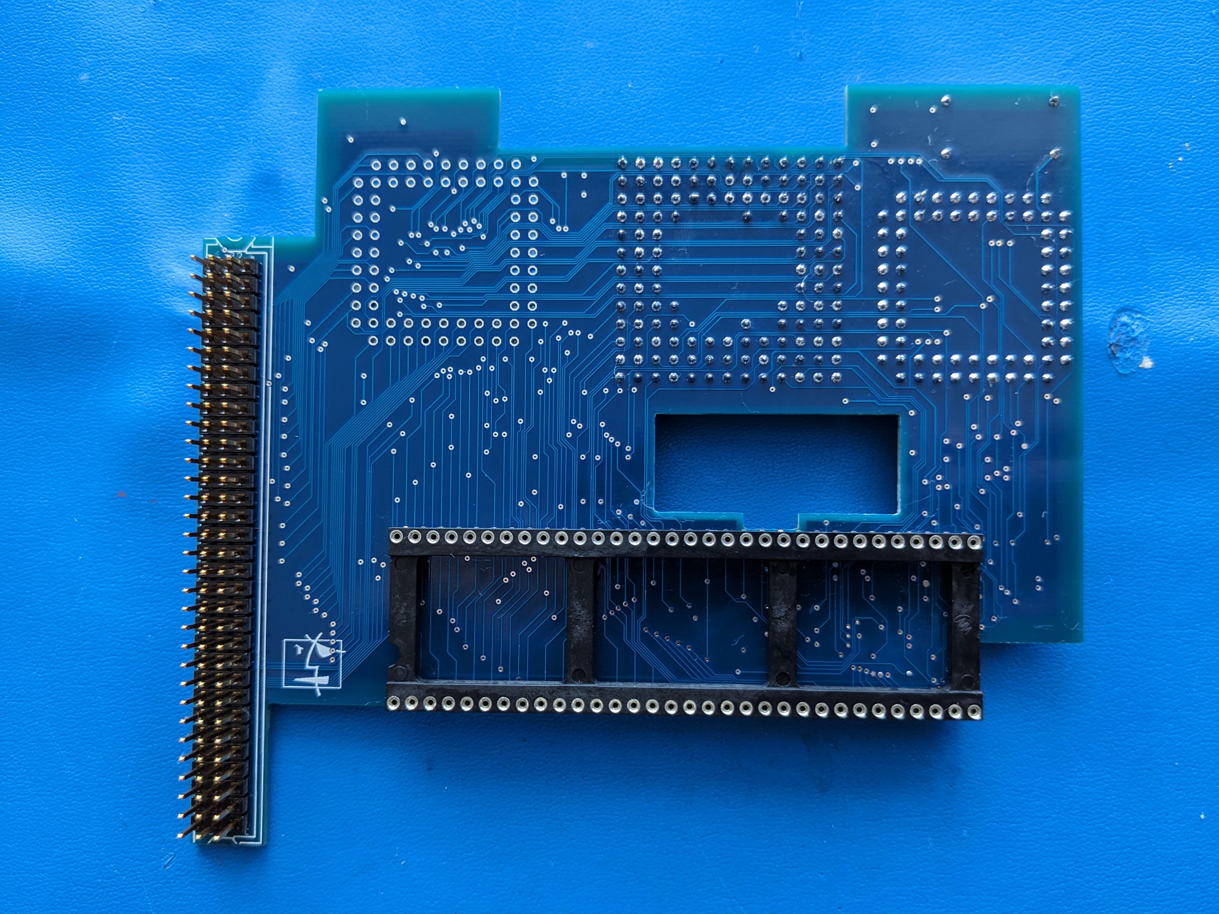

Next I installed the 68-pin socket to attach to a Plus logic board, and the 96-pin header to fit the SE PDS slot. In DrGonzo's build he used a Euro DIN male connector for the PDS instead of the PIN headers and had problems with the socketed CPU interfering with the case. I went with the pin headers to add a bit of extra clearance. In my machine there are no clearance issues, there is probably 1/16" or 1/8" of space above the CPU. I believe there are two different SE chassis, mine seems to have extra space, I do not know how to identify which is which. In my case I could have used the Euro DIN and been fine. Also worth noting, the CPU does not need to be socketed, it can be soldered directly to the board and this will eliminate any potential clearance issues. I went with the socket since I was buying my CPU off eBay and did not trust that it would work. At the time I did not have the proper equipment to un-solder the CPU, so I played it safe with a socket. The Euro DIN socket is about $3 and the 96-pin header I used was $13, so I would recommend going the Euro DIN route. In DrGonzo's build the accelerator still fit, though the top of the CPU scraped on the case. My "new" CPU came pre-scraped from eBay, this was not a result of clearance issues.

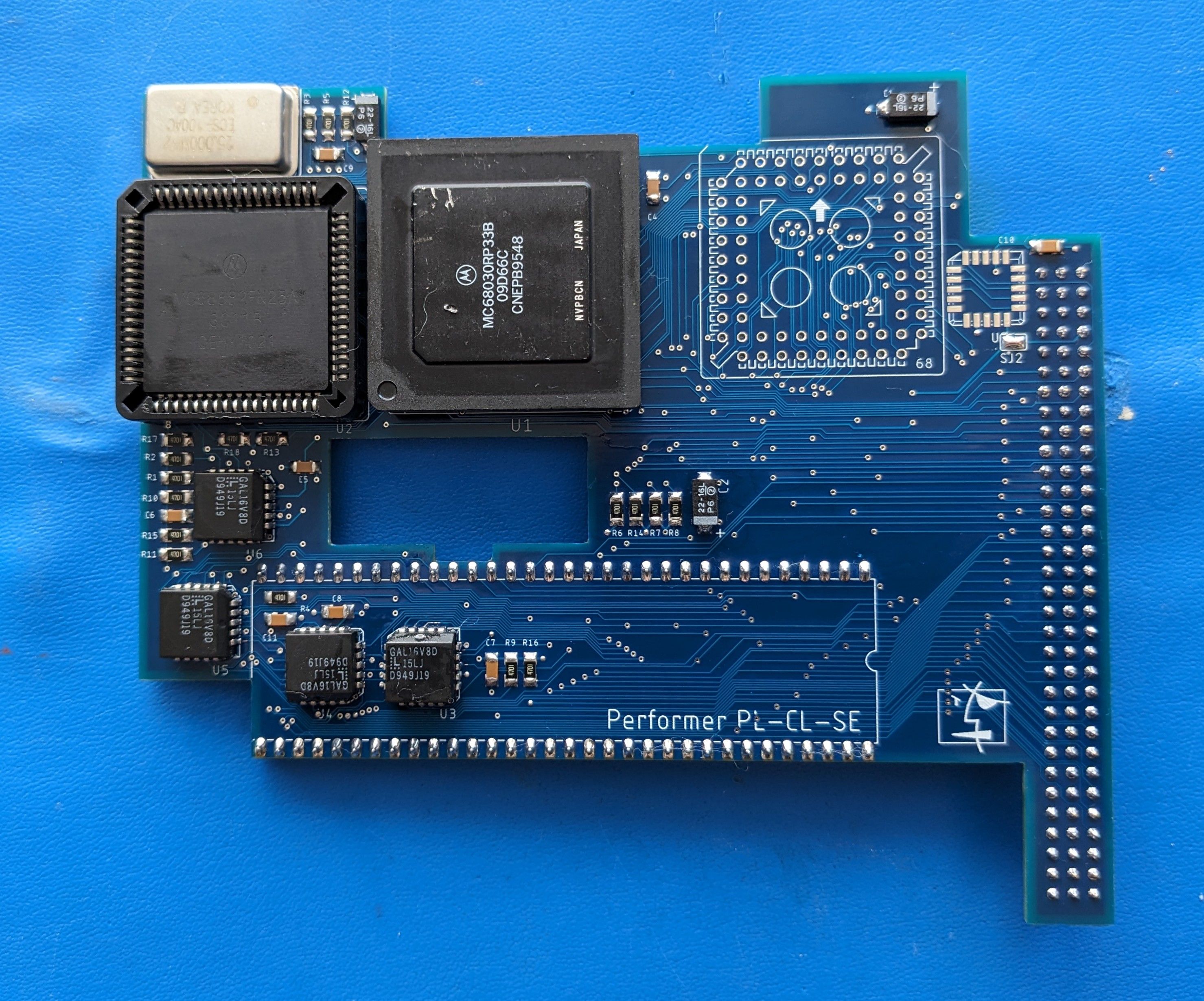

I then moved on to the CPU and FPU sockets. Both were very straightforward through-hold jobs. For the first test I left the FPU out. The photo below with the FPU was taken later.
Completed board, front and back
I switched the machine on, and... Checkerboard screen. 😣
Clearly this was not the desired result. This board is pretty simple, there is not a lot going on, so I hoped the troubleshooting wouldn't be too bad. I started by checking all the traces on the whole board with my meter. I also went over the whole board with my microscope to check for traces I might have damaged. This was extremely time consuming, and in hindsight I should not have done the continuity check as my first step. I powered the machine on and still got the checkerboard screen. At this point the GALs seemed like the likely culprits, it was unlikely there was an issue with any of the resistors or caps. I removed the GALs and re-programmed them, this time I used the "GAL16V8D-@SOIC 20" chip selection rather than the regular "GAL16V8D". I left the LOCK bit in its default checked setting, the first time I un-checked the box. I also erased the GALs before programming, the programming step also erases the GAL as part of the process, but I figured it would not hurt to do it manually. I re-installed the GALs, crossed my fingers, and got the beep-of-life.

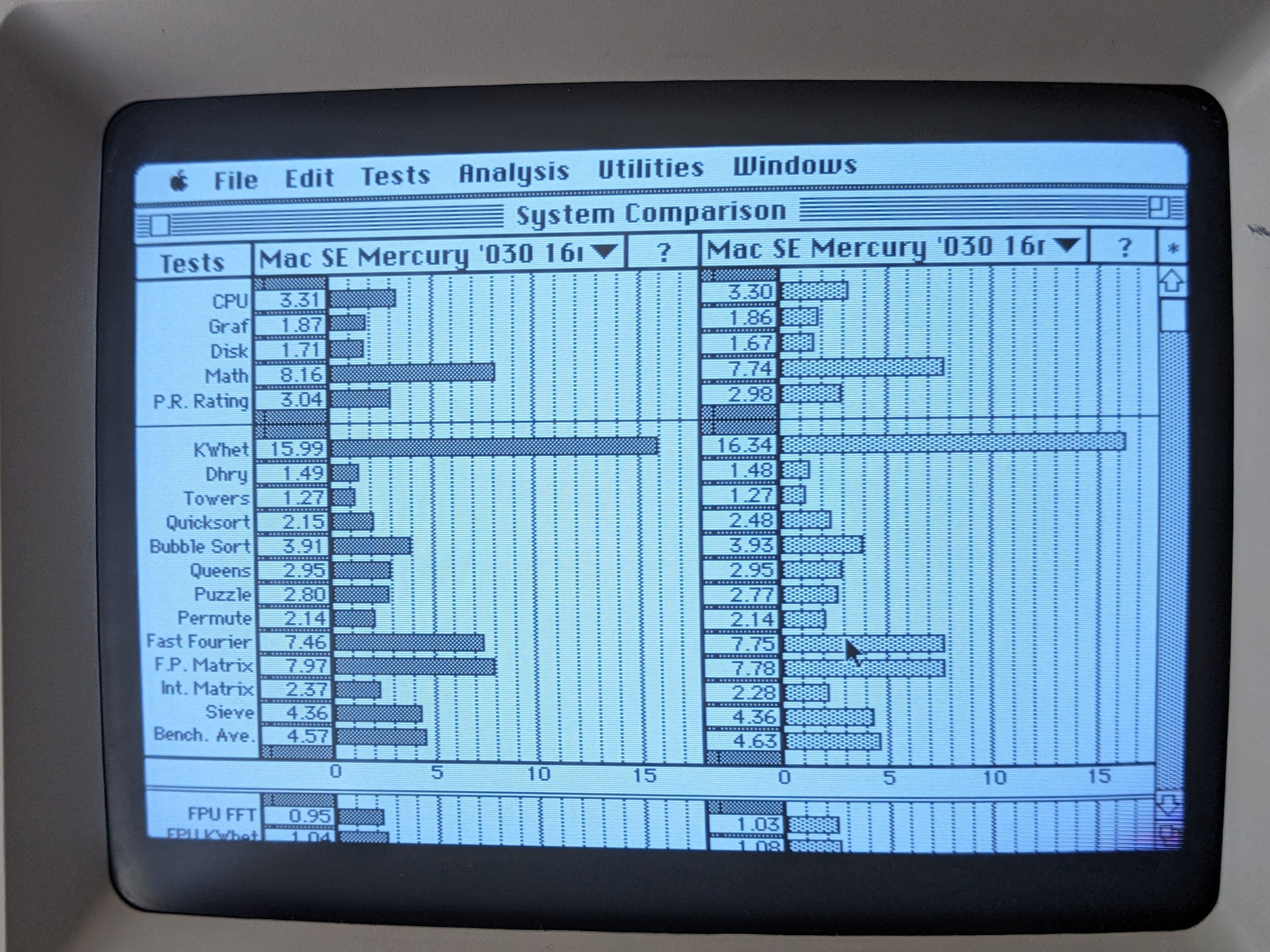

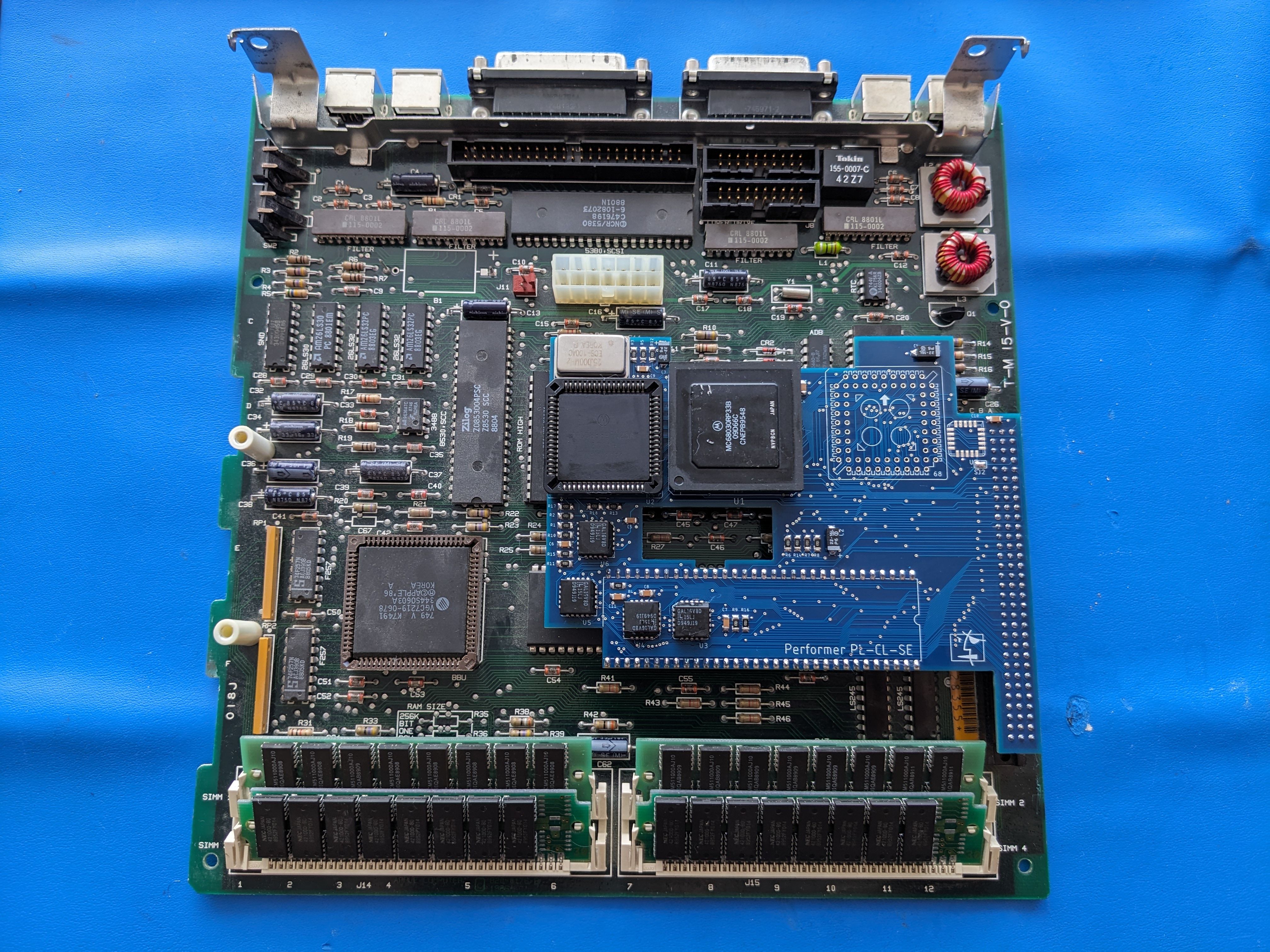

I already had the GemStart accelerator driver installed on this machine so it booted right up and Tattle Tech showed a 16mhz 68030. Without a driver, the '030 will run at 3mhz, so the driver is very important. I later switched to the proper Performer driver from Macintosh Garden. I ran Speedometer 3.06, the CPU test showed 3.3x faster than a Classic. I then installed the FPU, leaving off the crystal oscillator for the moment. Without the oscillator the FPU will run at 16mhz, with an oscillator you can increase the FPU speed to 25mhz. If you are running without the oscillator you must bridge pads SJ1.
I booted and everything worked fine, Tattle Tech recognized the FPU. I ran some Speedometer benchmarks and the math score increase was substantial. Then I installed the 25mhz oscillator (after un-bridging SJ1), and the results were not quite as expected. The math benchmark was actually lower with the 25mhz oscillator installed. This mirrors DrGonzo's results on his build. I do not know why this is, the overall math score was about 5% lower. The difference is tiny and won't affect anything I will do with this machine, so I left the chip in place, partly because I didn't want to deal with removing it, and partly because I think the board looks better with it installed.
Benchmark with (left) and without (right) FPU oscillator
Photo of finished board installed on an SE logic board

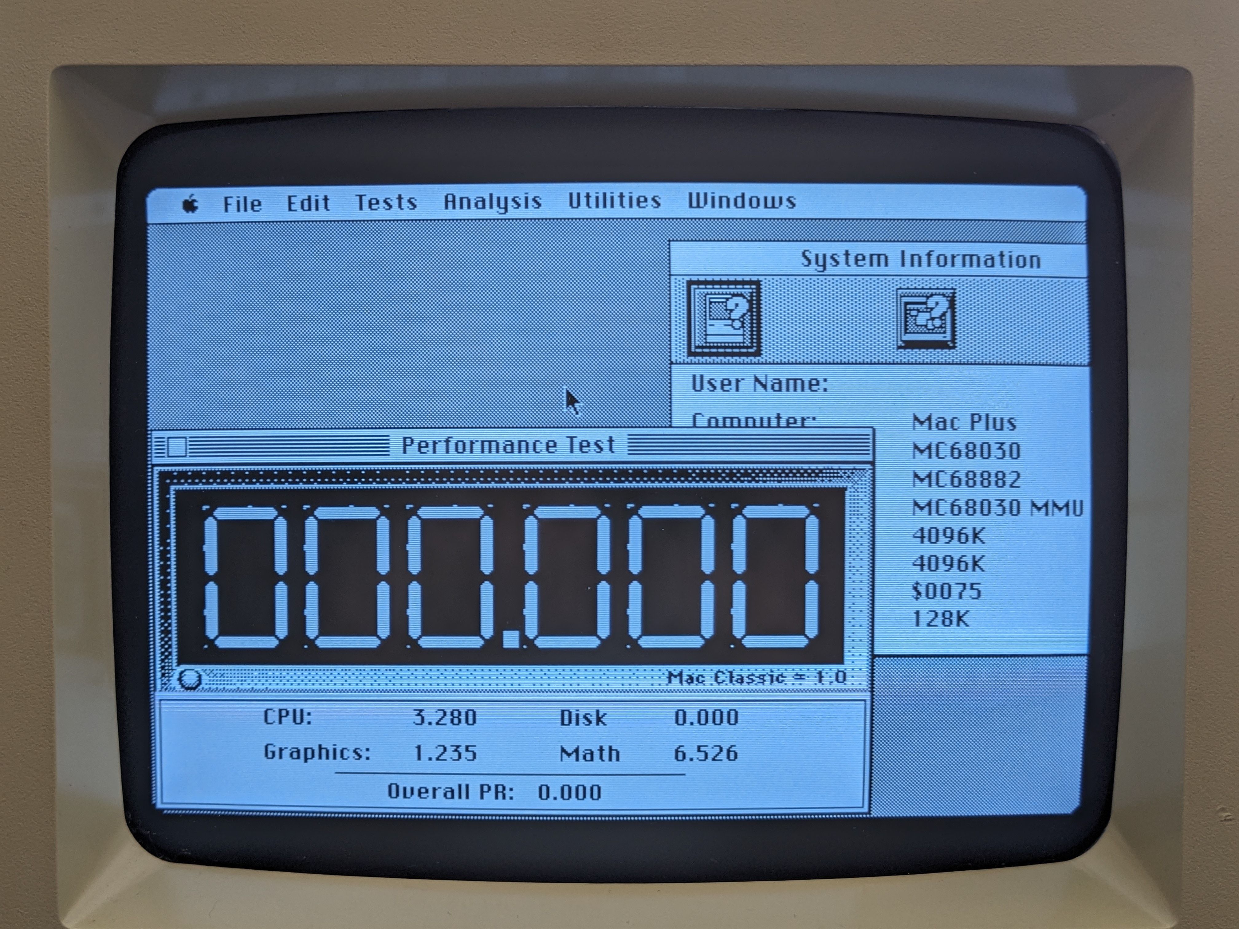

The next step was to see if it would work in my Plus. Originally when these boards were new they would have had a "Killy clip" which clipped over the 68000 on the Plus board. Those are no longer available, so using it on a plus will require a 64-pin female DIP socket on the bottom of the board, and then pin headers installed on the 68000, as shown in the photo below.
I put the card in my Plus and ran a quick benchmark. I wasn't able to run the full test, I was unable to use my BlueSCSI since I haven't added the needed diode to the Plus logic board, so I was running off my Floppy EMU. The disk test didn't like the Floppy EMU, and I didn't like all the image swapping, so I only ran the CPU, graphics, and math tests. I also wasn't using the proper Performer driver, I was using Gemstart 2.2.
The CPU test was the virtually identical to the SE at 3.3, graphics were 1.23 vs 1.87 (34% slower), and math was 6.52 vs 7.74 (16% slower). I'm not sure if the scores would have been higher if I was using the Performer driver rather than the Gemstart driver, likely there would be no difference.
