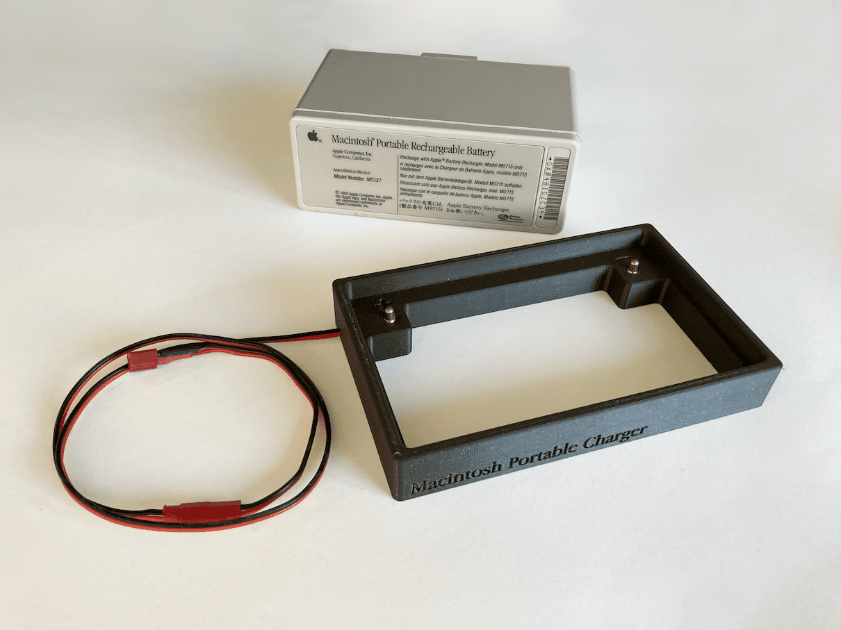

Today, I would like to share my design of a 3d-printed tray that can hold the battery and uses pogo pins to make reliable contact with the battery contacts. The design more or less resembles the original Apple charger that sometimes shows up online for pretty high prices.

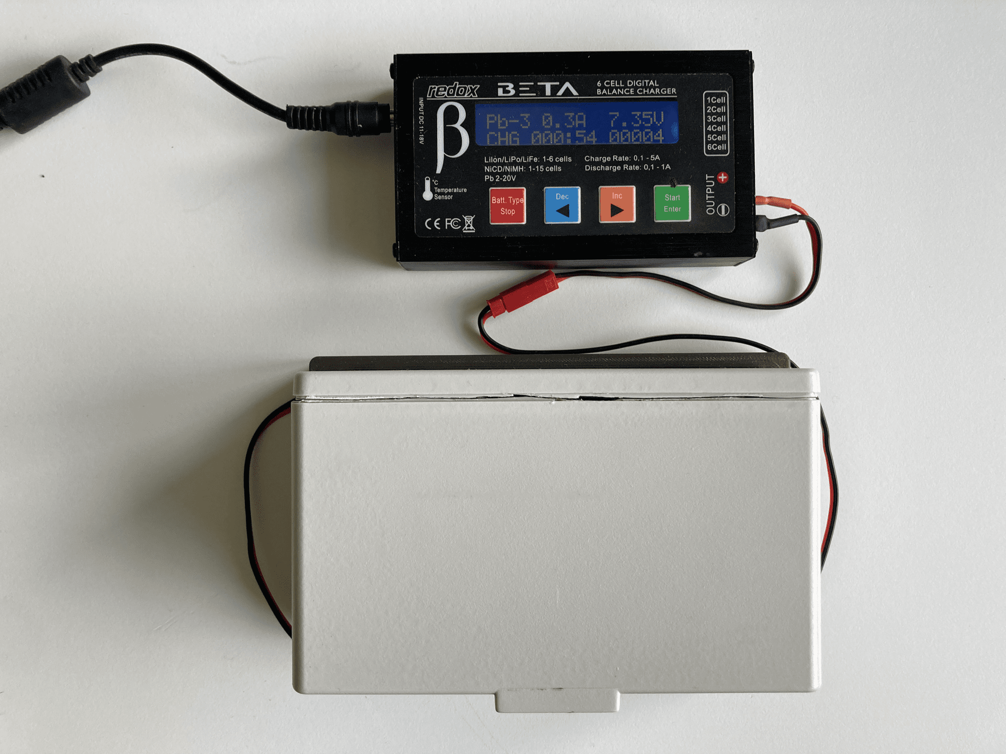

To keep the charging process safe and automated, I’m using an RC battery charger that can handle a 3-cell lead battery. Works great!
I hope this might came useful to someone looking for a way to conveniently charge and store Portable batteries :)
Hi, I can't seem to access your website. Great work on this, would love to make one! Also, what charger did you use? Would it work with rebuilt batteries? Thank you so much for documenting this!
Oops, the URLs of my website changed, the original post is updated now and should work
