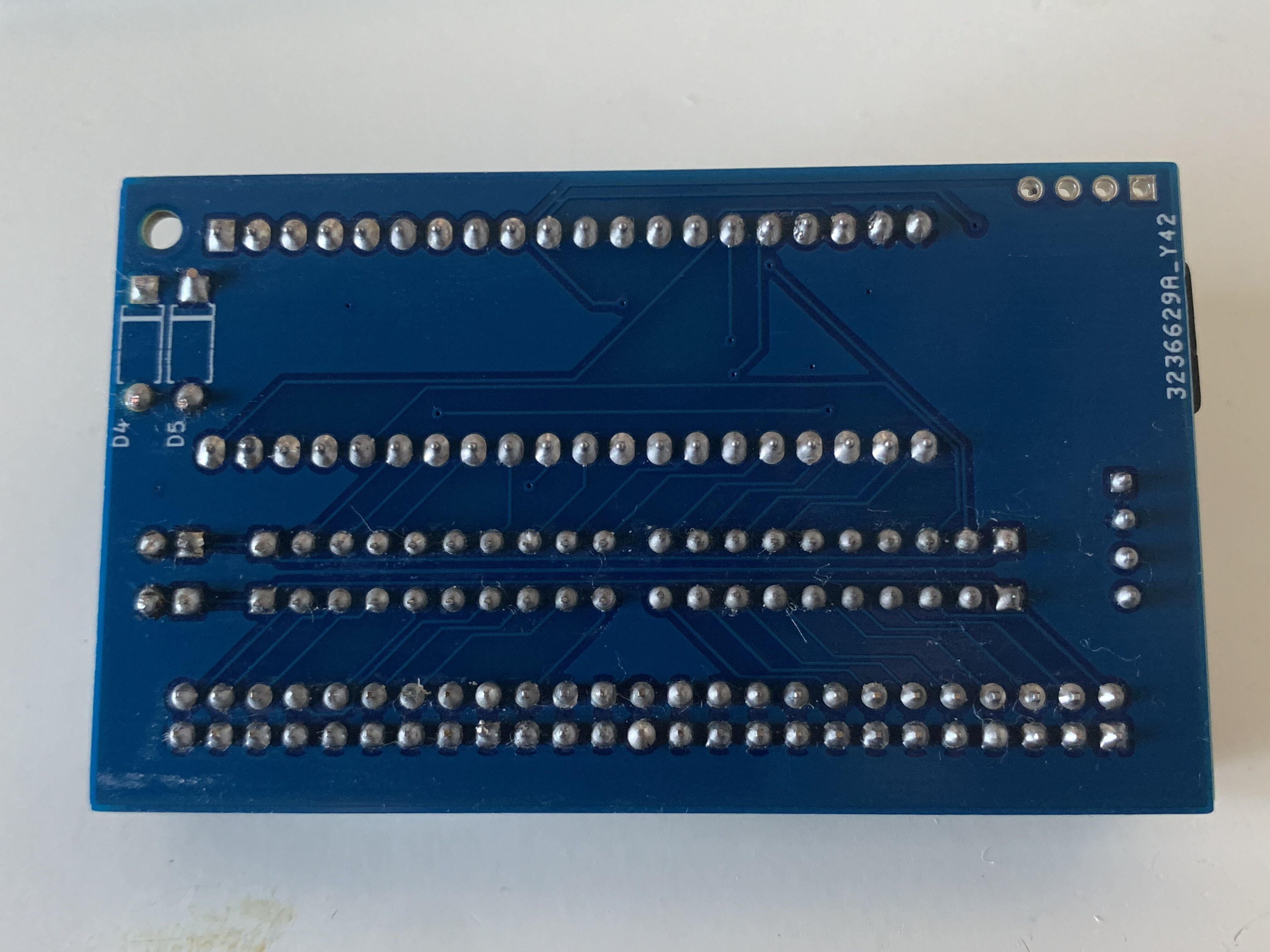

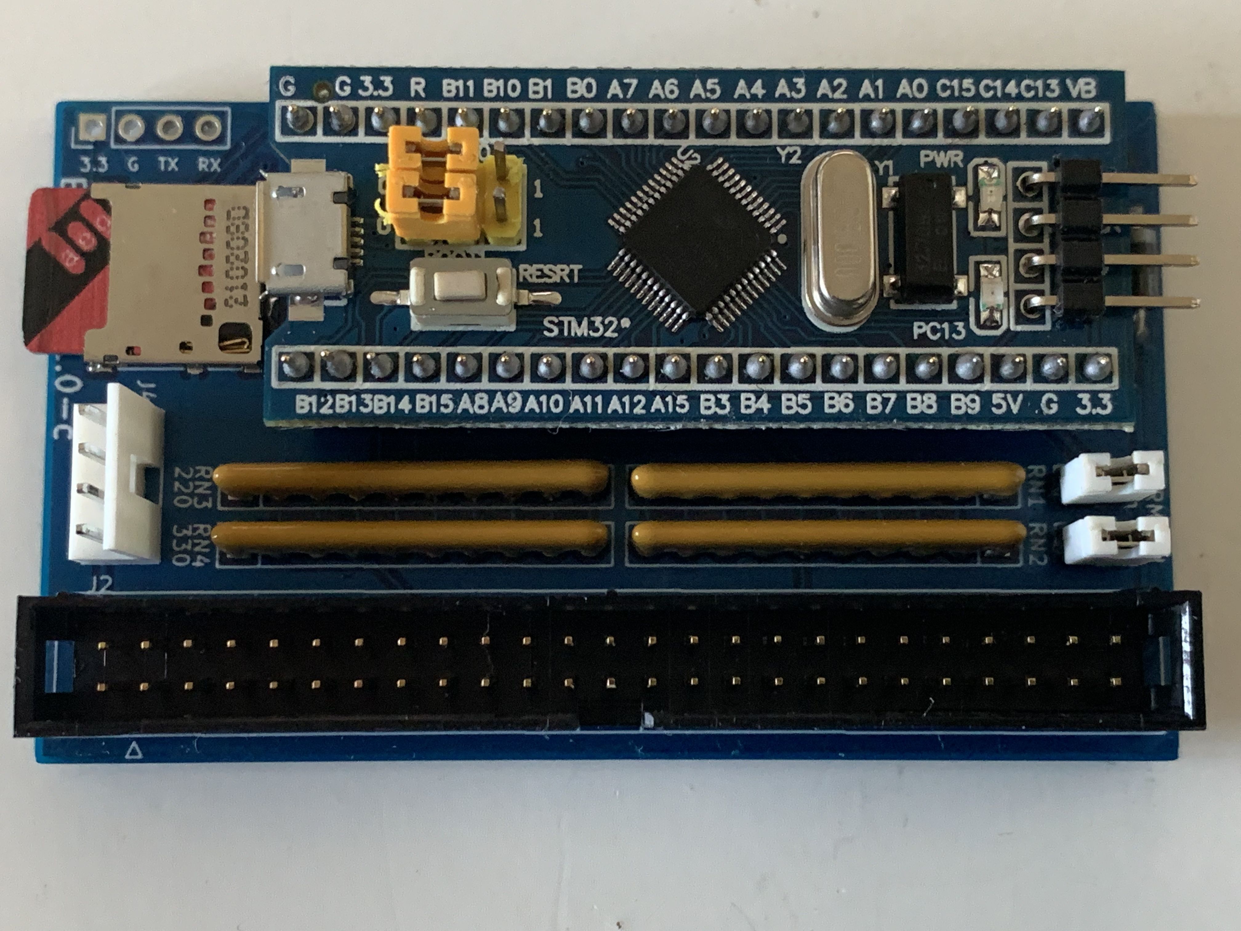

If you could try to attach a clear photo of the back and front to see if there's anything obvious issues.
Thanks, eric -- I’ve taken the photos (attached) and will get the meter out to test the voltages this evening after work. Just to check - should I test across the two termination jumpers (with them closed)?
The only deviation I made from the instructions was to mount the diodes on the front of the board, since with the socketed BluePill there’s room for them there.

Looks clean, and yes the diodes can sit like that if there's enough clearance. Only thing I cant see is the resistor nets - just make sure they're pin 1 is correct.
