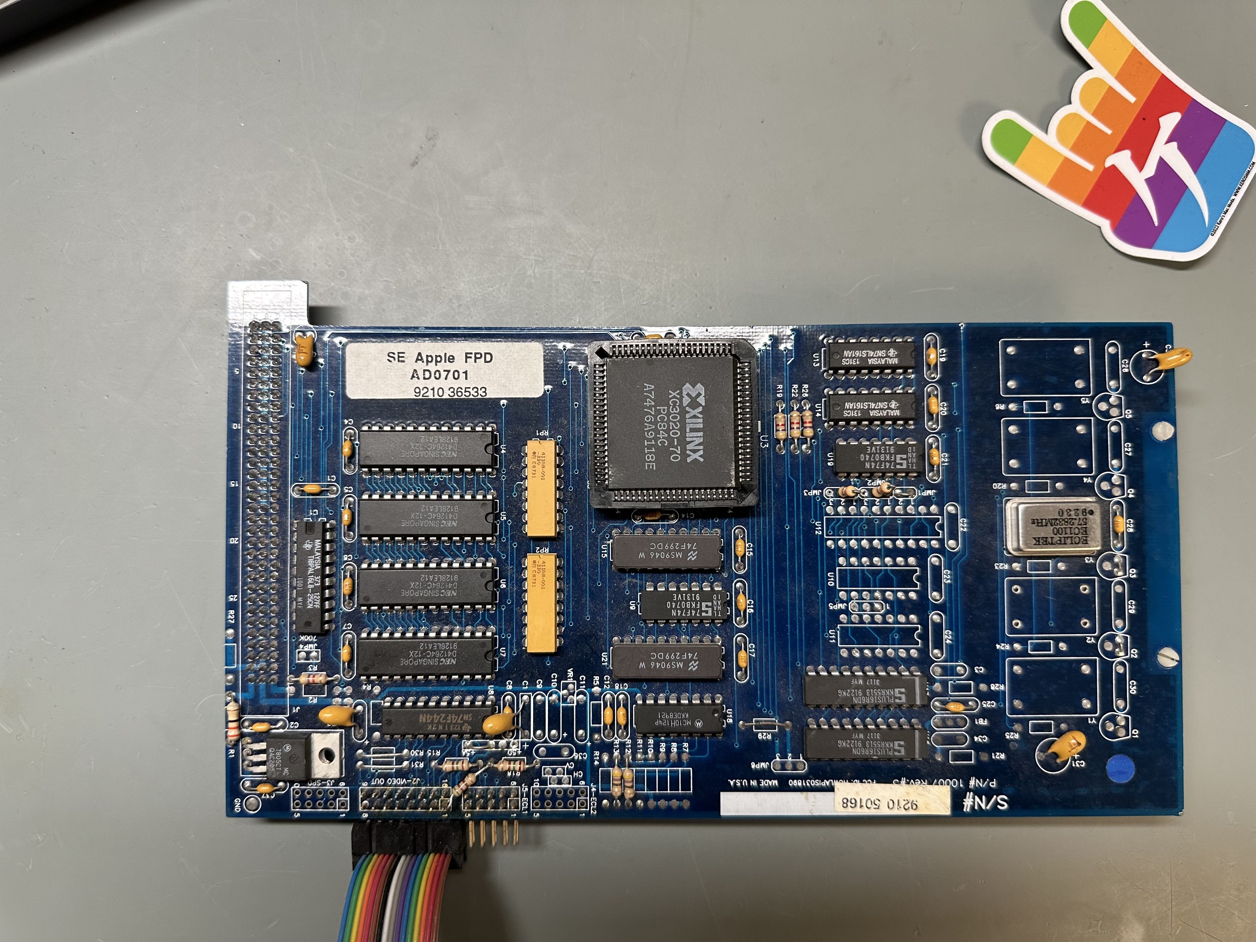

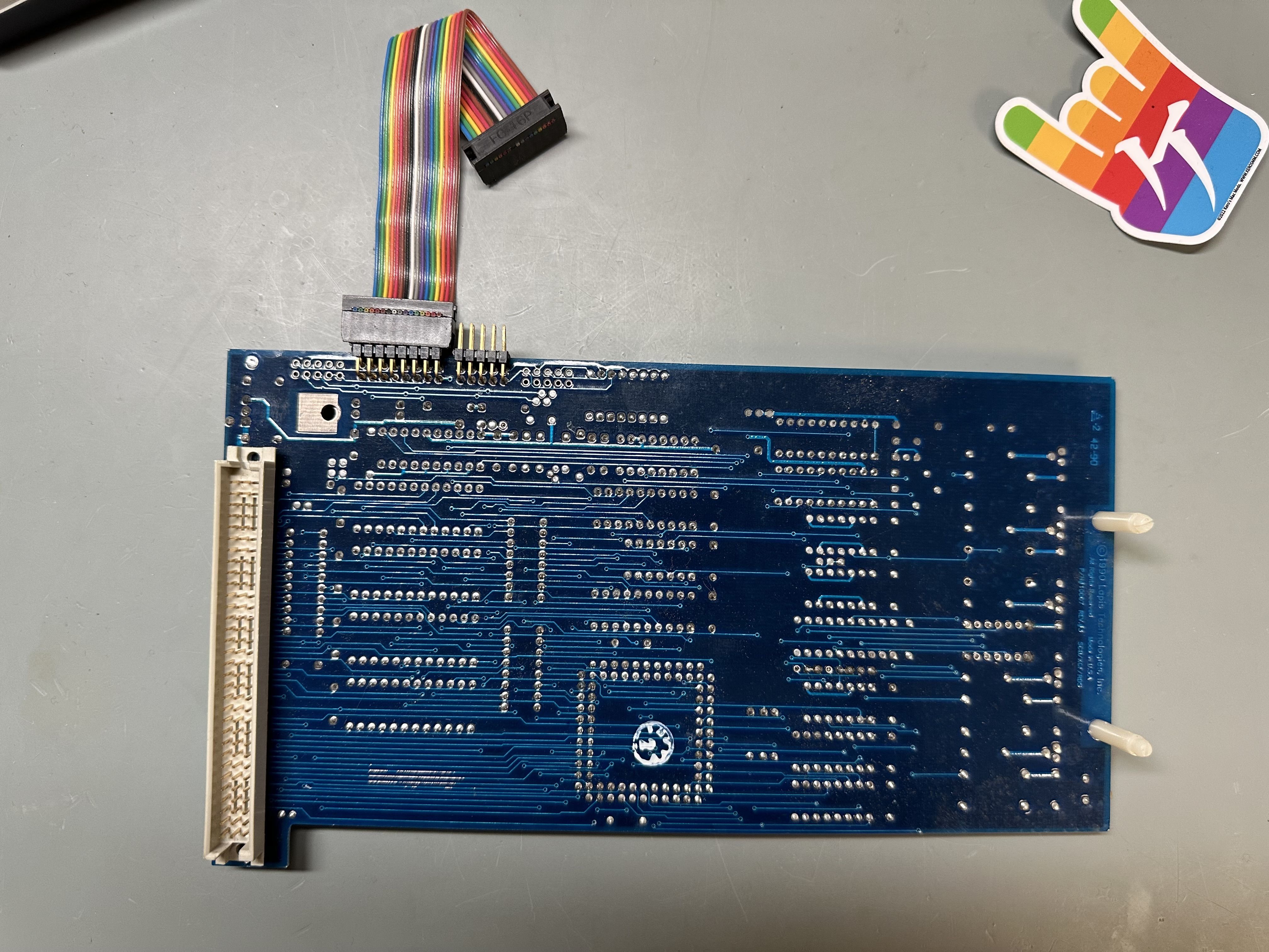

Hi all !
I just acquired a Full Page Display board for Mac SE, which is good, because I do own an FPD :)
However, the board was sold with just the ribbon cable from the card, and I guess there was something to connect it to a bracket leading outside.
Do we have the pinout for this ?

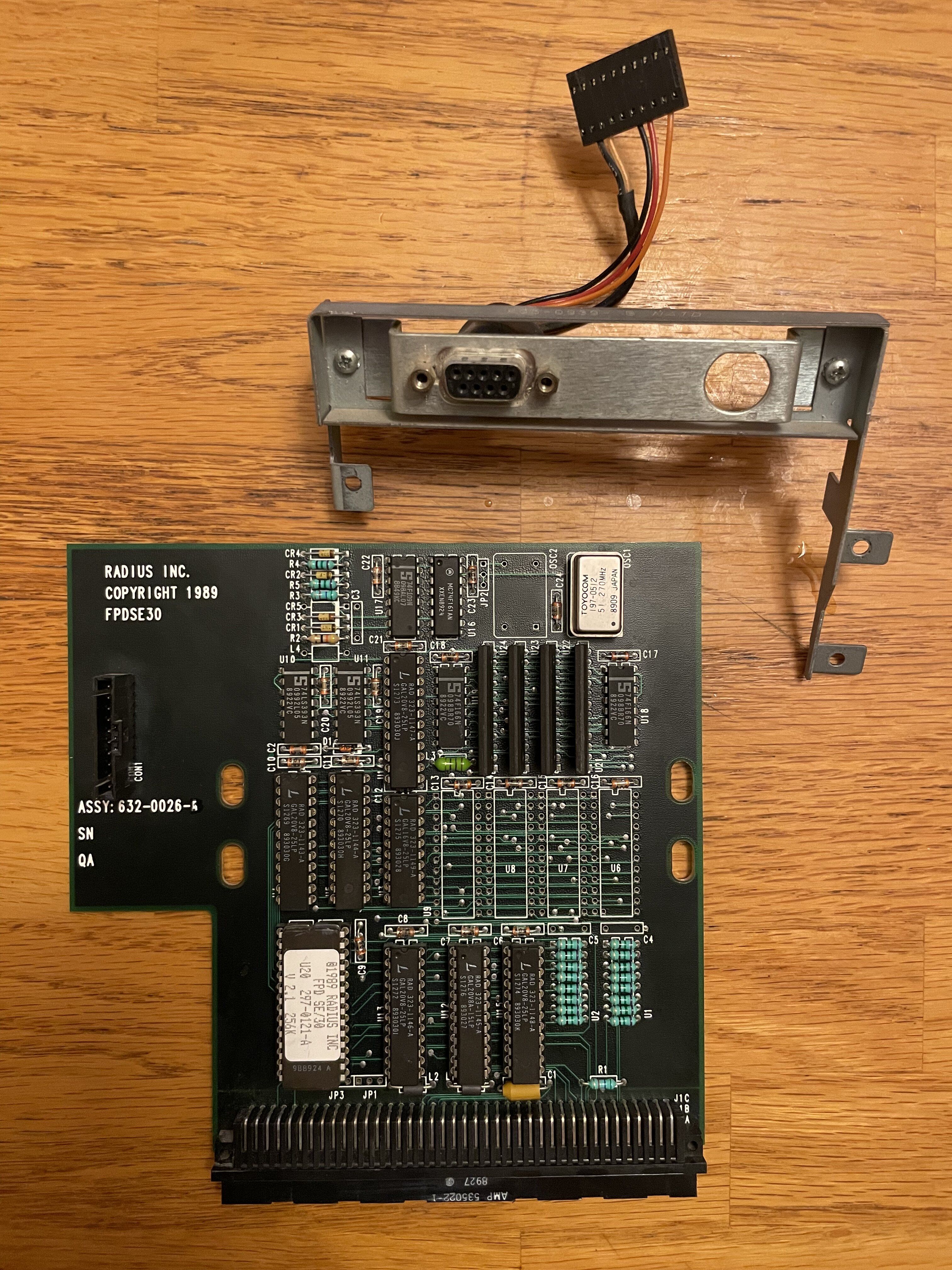

I have an SE/30 Full Page Display board that i haven't gotten to work yet, but it did come with the external connector bracket. Does you ribbon cable and connector look like this?
Let me see if i can trace the wires...
Reactions: iPhil64
Here's what i was able to trace out.
External Pin (facing connector)ColorInternal Pin (from top of card)
5Orange2
4Red4
3Black5
1Clear (bundled with Black)8
2Black (bundled with Clear)9
I'm not sure what the functions of each pin are. I can guess that the clear and black bundled wires are the actual video signal. Red and Black being 5v and GND. And orange a sense?
