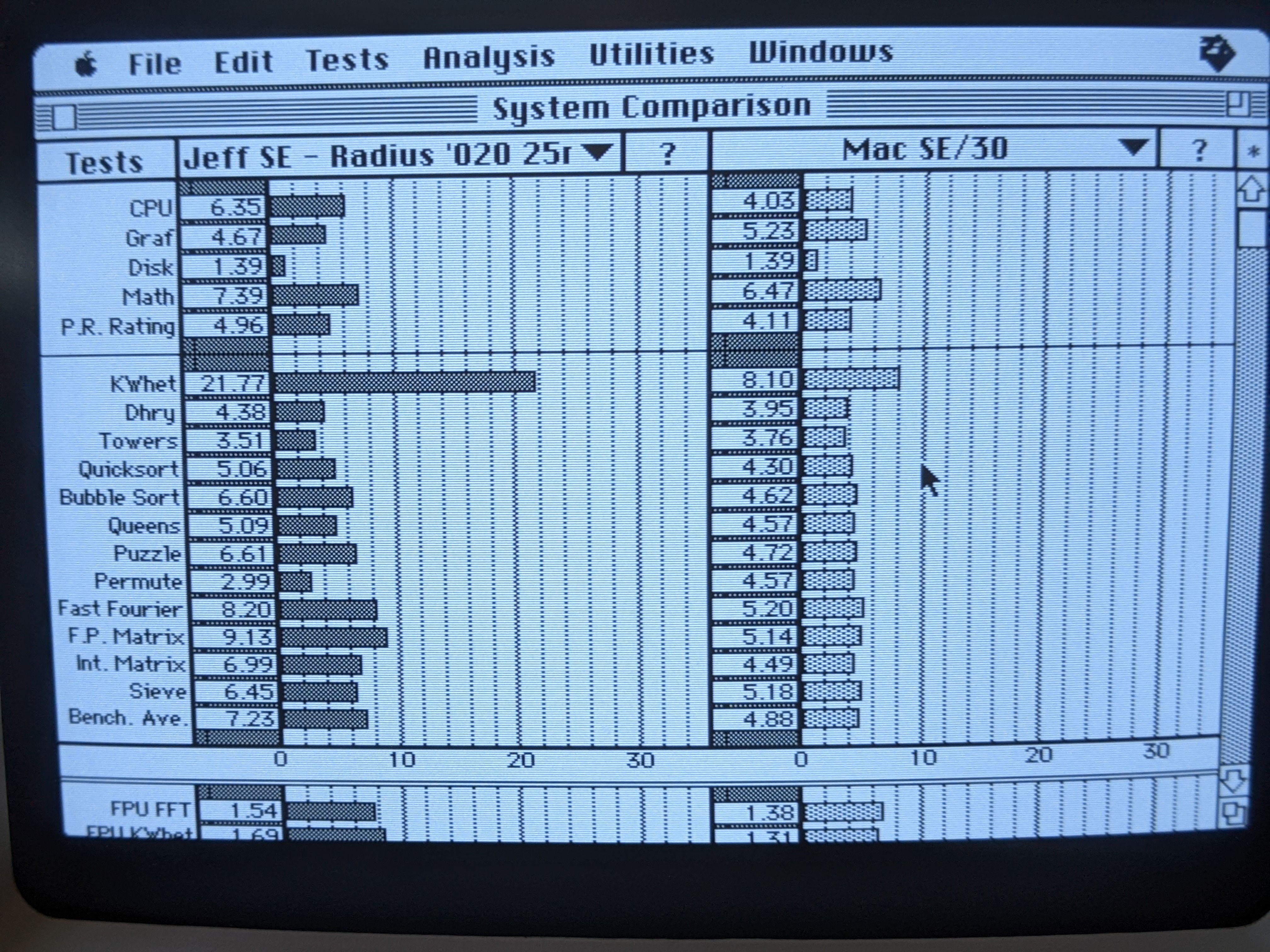

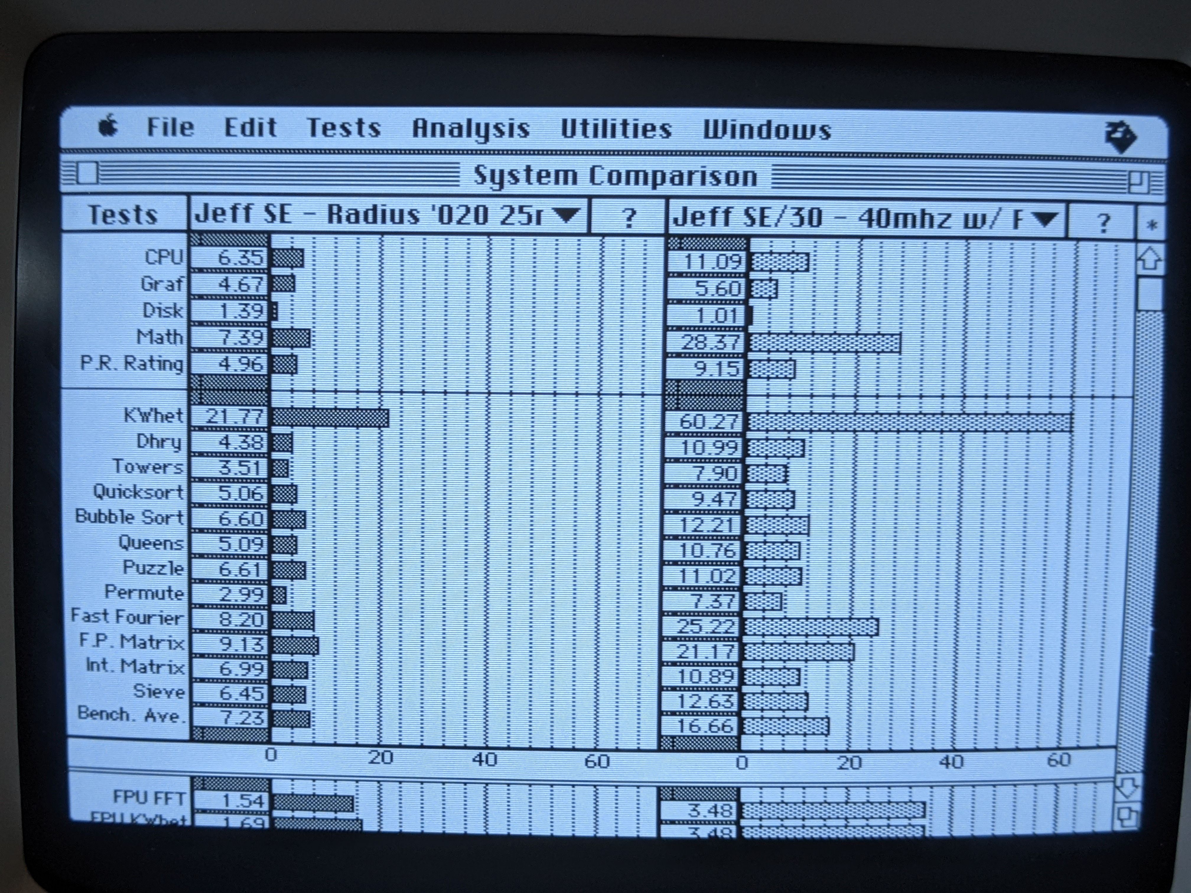

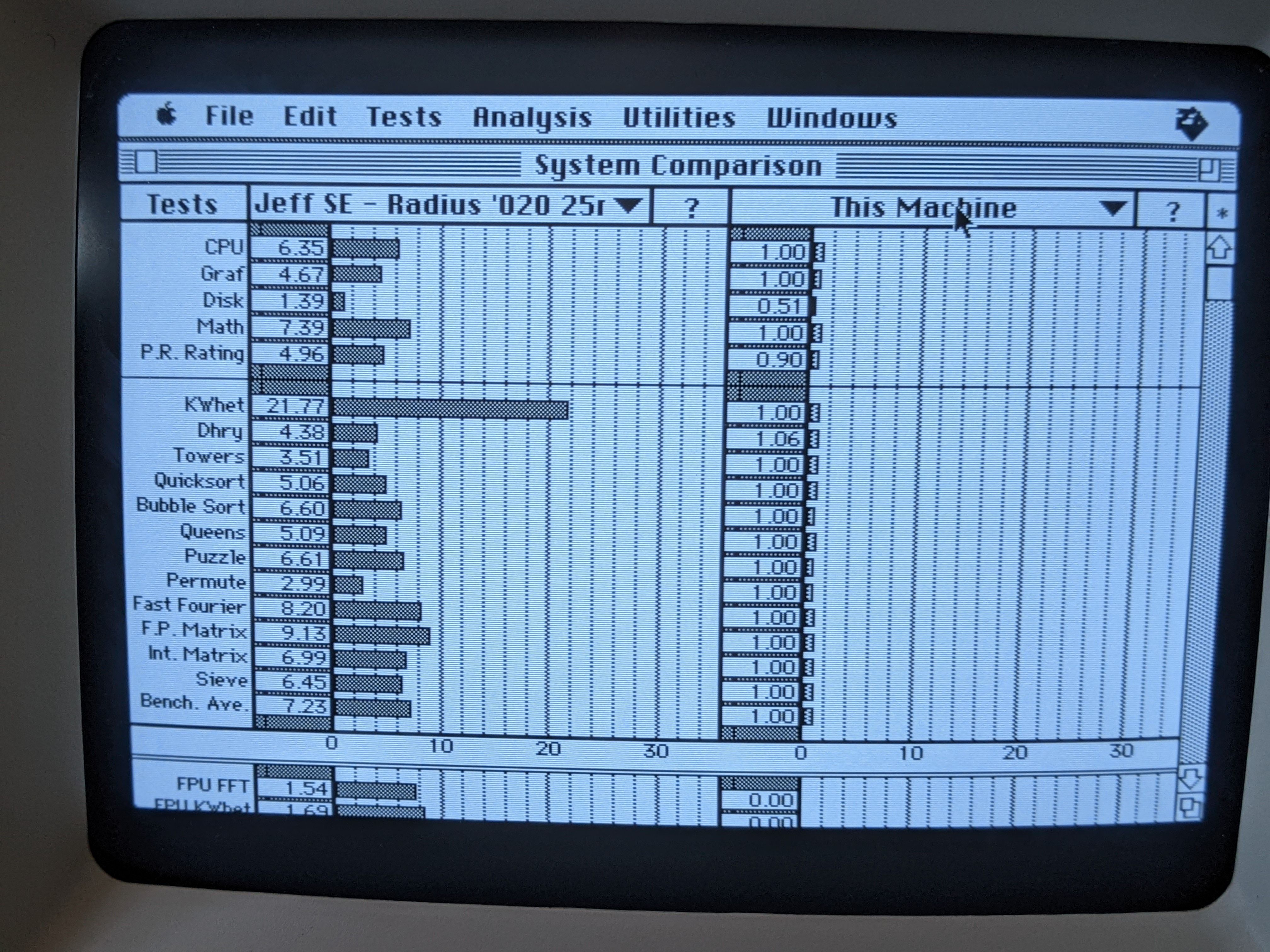

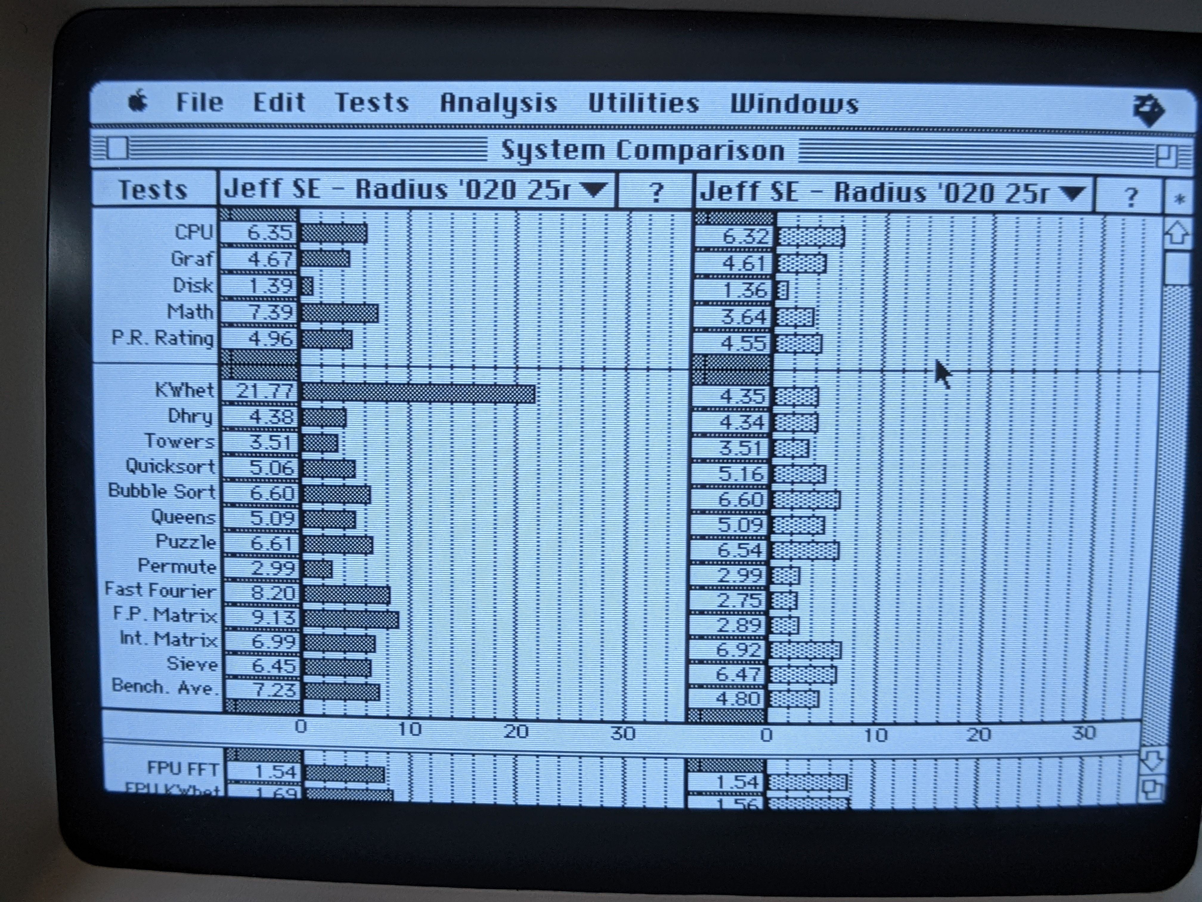

I thought someone here might be interested in some benchmark results from my accelerated SE. The machine has a Radius 25mhz 68020 accelerator with 68881 FPU. 4mb RAM, spinning-platter HD. The SE/30 used in the tests has 8mb RAM, Mac SD drive, and a Radius 40mhz 68030 accelerator. Both accelerated machines were run with the appropriate accelerator drivers and cache enabled, except for the last test which compared the '020 SE with the cache and math extension against the same machine without the extensions. Both machines were running System 6 (I think 6.0.8, though one might have been running 6.0.7). The tests were run with Speedometer 3.06. I benchmarked the stock SE, which not surprisingly was a 1.0 on most tests, which lines up with the Mac Classic that Speedometer 3.06 uses as a baseline. I'm not sure why the disk speed was so slow for the stock SE, but I'm concerned since it seems fine with the accelerator enabled.

No I haven't done any disk-specific benchmarks. The "stock" SE in the comparison was the accelerated SE with the accelerator disabled, I might try running the same benchmark on one of my non-accelerated SEs and see if I get the same low results. Maybe the low disk score had to do with the accelerator being installed, even though it was disabled? Since the disk benchmark seems fine when the accelerator is enabled, I didn't put much thought into it, I was more interested in the processor performance.
The Radius accelerators for the SE (16 and 25mhz) don't have additional RAM slots on the accelerator board, and I'm 99.9% sure they don't do anything that would allow more than 4mb on the main board. This creates a performance bottleneck, which Radius tried to mitigate using a 32k cache. There is an accelerator review article in the March 1989 issue of Mac World (https://vintageapple.org/macworld/pdf/MacWorld_8903_March_1989.pdf), pages 119-127. On page 124 there is a paragraph describing the Radius cache. These are the magazine page numbers, they may not correspond to the PDF page numbers. I'm not certain on your question about address lines, I'm sure someone on here can probably answer that better than I can. Is your question about the 68020 in general, or this board in specific?
