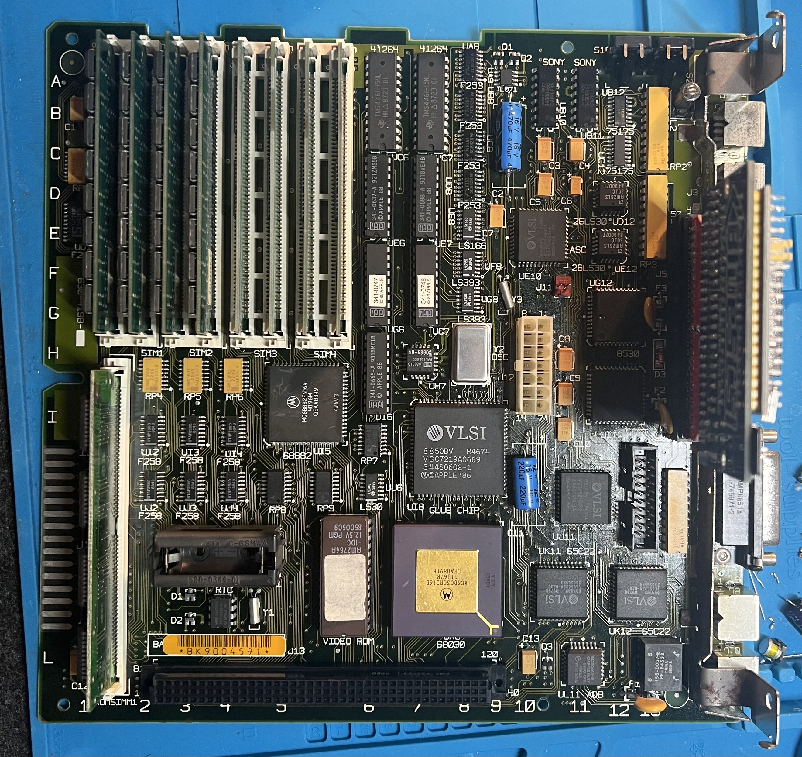

wottle Active Tinkerer Oct 30, 2021 973 735 93 49 Fort Mill, SC Sep 9, 2023 #21 YMK said: Now I'm really confused... UG8 is the column counter. UF8 is the row counter that had the wrong frequency on pin 3. They're both surface mount LS393s. Click to expand... Went to look at the board. I'm an idiot. It was UF8... Reactions: YMK
Y YMK Active Tinkerer Nov 8, 2021 451 365 63 Sep 9, 2023 #22 Ok, that makes sense now. Thanks for confirming.
wottle Active Tinkerer Oct 30, 2021 973 735 93 49 Fort Mill, SC Sep 9, 2023 #23 YMK said: Ok, that makes sense now. Thanks for confirming. Click to expand... Thanks again for you help and your patience!
