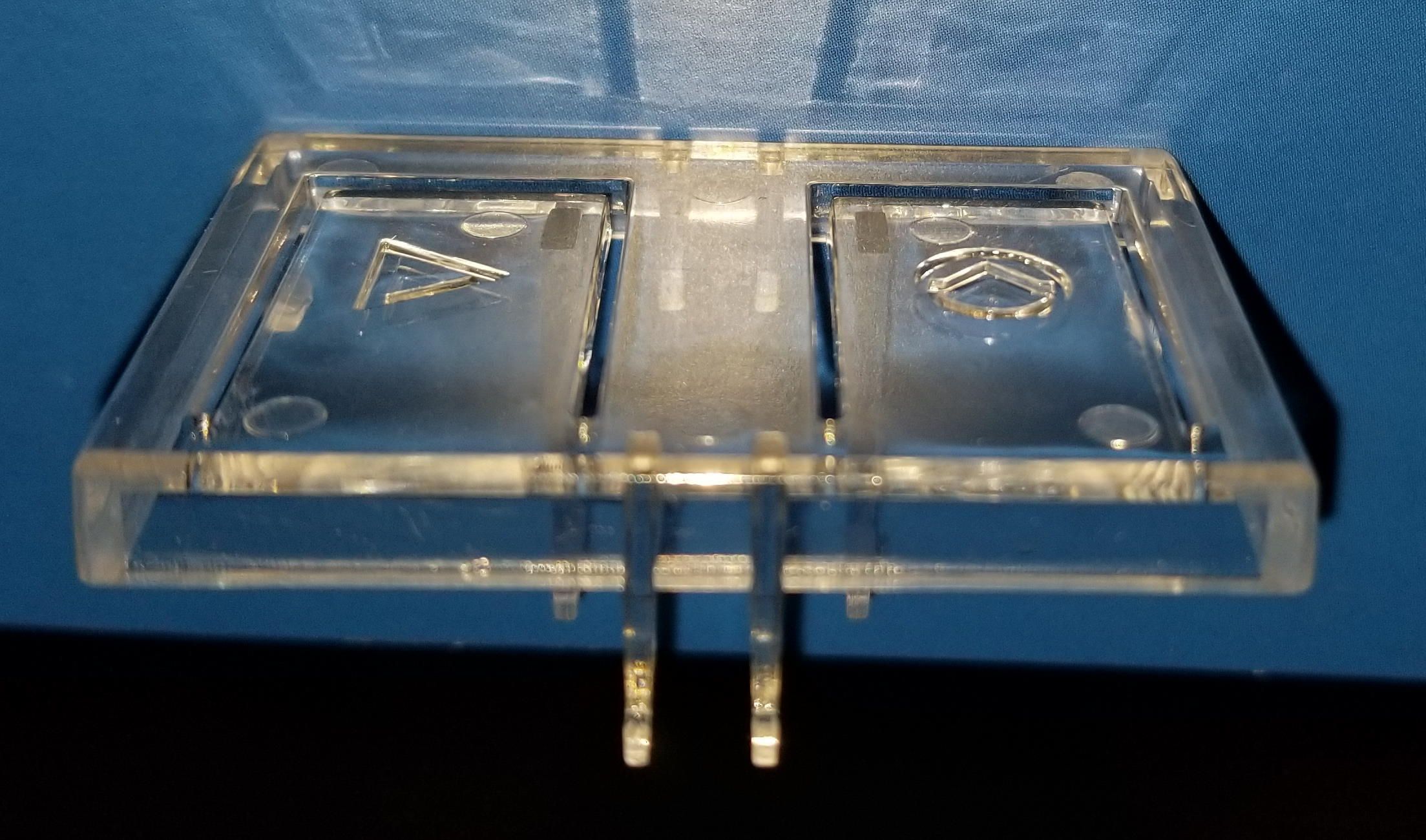

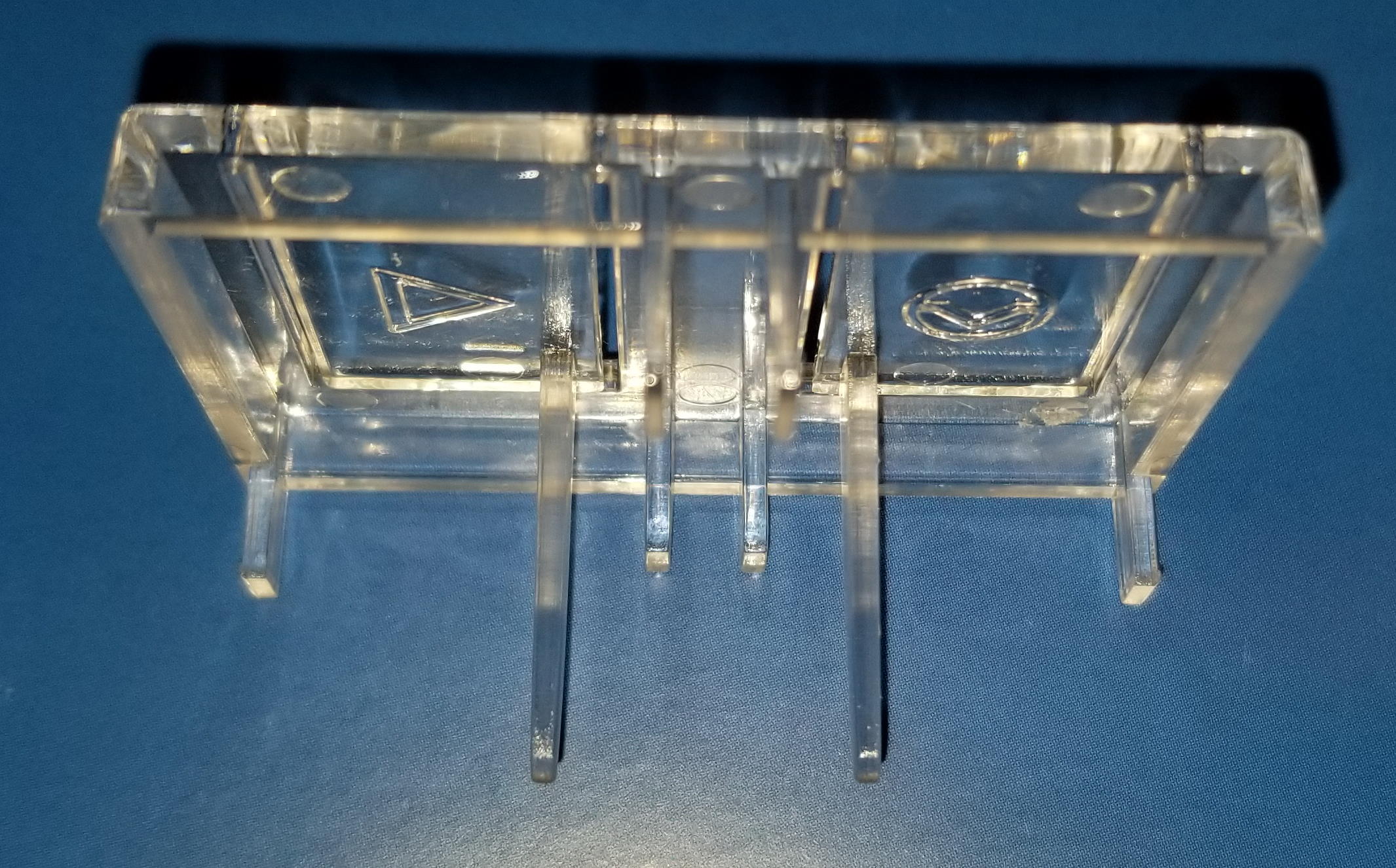

I needed a programmer's switch for my Macintosh SE/SpeedCard and looked around for a vintage one, but ended up getting a new MacEffects Clear Programmer's Switch.
I decided against using a vintage switch because, even when they were new, they were somewhat brittle and lost clips under mild strain (albeit often because of mishandling...but..). Now, that the plastic has aged, it is potentially even more of a liability. Also, the vintage switches are significantly overpriced. So, why pay more for old, fragile part with polymer degradation just for the sake of appearance? No thanks. I need one that is strong, functional, reliable and that will stand up to regular use.
Attached are some pictures of the @MacEffects clear SE switch - it looks good, seems well-made and works great! There was a slight tolerance issue between the switch prongs and the gaps in the MacSE's lower ventilation slots - both switch prongs got stuck/wedged in the gap when pressing the buttons. To fix this issue, I lightly sanded the related SE case openings (on ventilation slots #5 and #8 - counting from the back edge). I removed a couple mils of material on either side and that fixed the tolerance problem. I am happy to have slightly thicker (stronger) prongs and the minimal case sanding is an imperceptible change. The reset switch snapped perfectly into place.
See the attached pictures.
Anyway - I recommend this product, albeit with the (reasonable) caveat of required case sanding to very slightly enlarge the ventilation slots. Now, I can successfully disable my SpeedCard!
MacEffects ships First Class in the US (cheapest), so the cost was $15 + $5.38 shipping. Also, their customer service was very responsive and helpful!

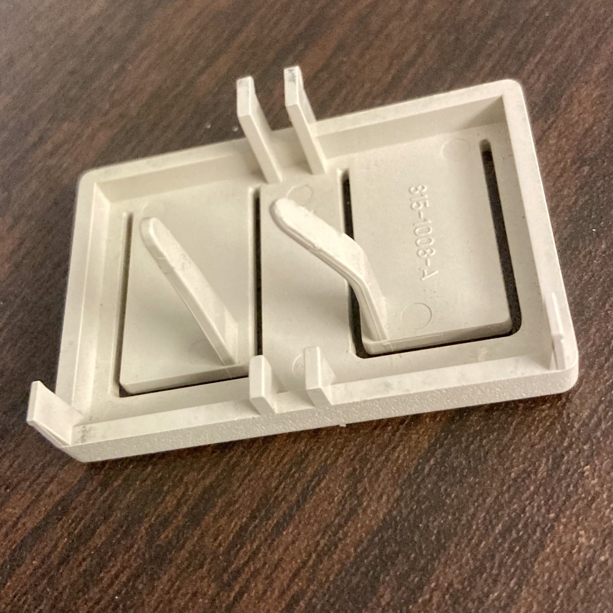

I have one that is bent in the exact same way. One is straight, the other bent. Was thinking about heating it up and gently bending it back. Or, if it snaps off, using epoxy to reattach in the right position.
  • Sad
Reactions: BFEXTU
You should be able to fix that issue with a heat gun. The prong will probably survive if you are careful. @retr01 's switch already shows the tell-tale plastic-fatigue-of-death stress highlights. Heating should allow you to address/reverse the fatigue.

@Paralel @retr01 @Andy - I am home now. Attached below are the pictures of my SE Programmer's Switch after repairing it using the above-described heat gun method. Both prongs were bent at about 45 degrees towards the base and showed pre-fracture white crazing on the outer angles.
I have also included a video that shows the strength of the prongs while testing the ends with a spring/flick test. Both prongs demonstrate springy durability and make an audible plastic "ping" as you would expect, indicating that they appear to have expected strength/durability (maybe as good as new).
In the pictures, you will notice that there are some shiny surfaces on the back of the switch and perhaps very slight darkening on the prongs that appeared during heating. I almost overdid it. :D . But, upon heating, all the white crazing vanished.
Anyway, the heat gun method I describe above worked fine on my switch, fixed the problem and resulted in prongs that appear to be as strong as an unmodified switch.
The take-aways are: NEVER try to bend the prongs back without using heat, and if/when you do use heat, you should be able to fix the prongs if you are careful without having any subsequent issues with prong weakness.
One other comment: It may help to use tweezers or small pliers, since the plastic gets hot (out of necessity). I think you will see some related tool marks in my pictures above when the plastic was hot/slightly softened.
