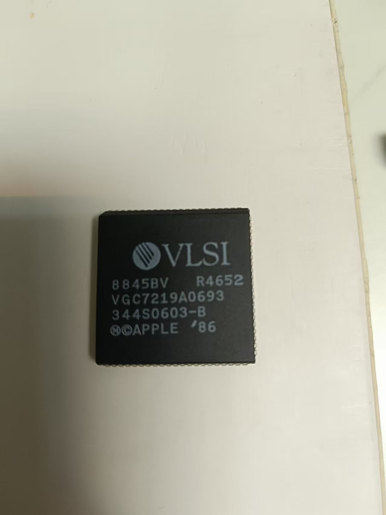

Finally! I found the problem is on the BBU. I bought a new motherboard and tried to "transplant" all the chips. First, ROM and RAM are all good, and I tried the BBU. Before I tried it, I never think the problem will be on this unit, but it definitely happens! This can be a model of these kinds of problems and t
hanks for all your help.
