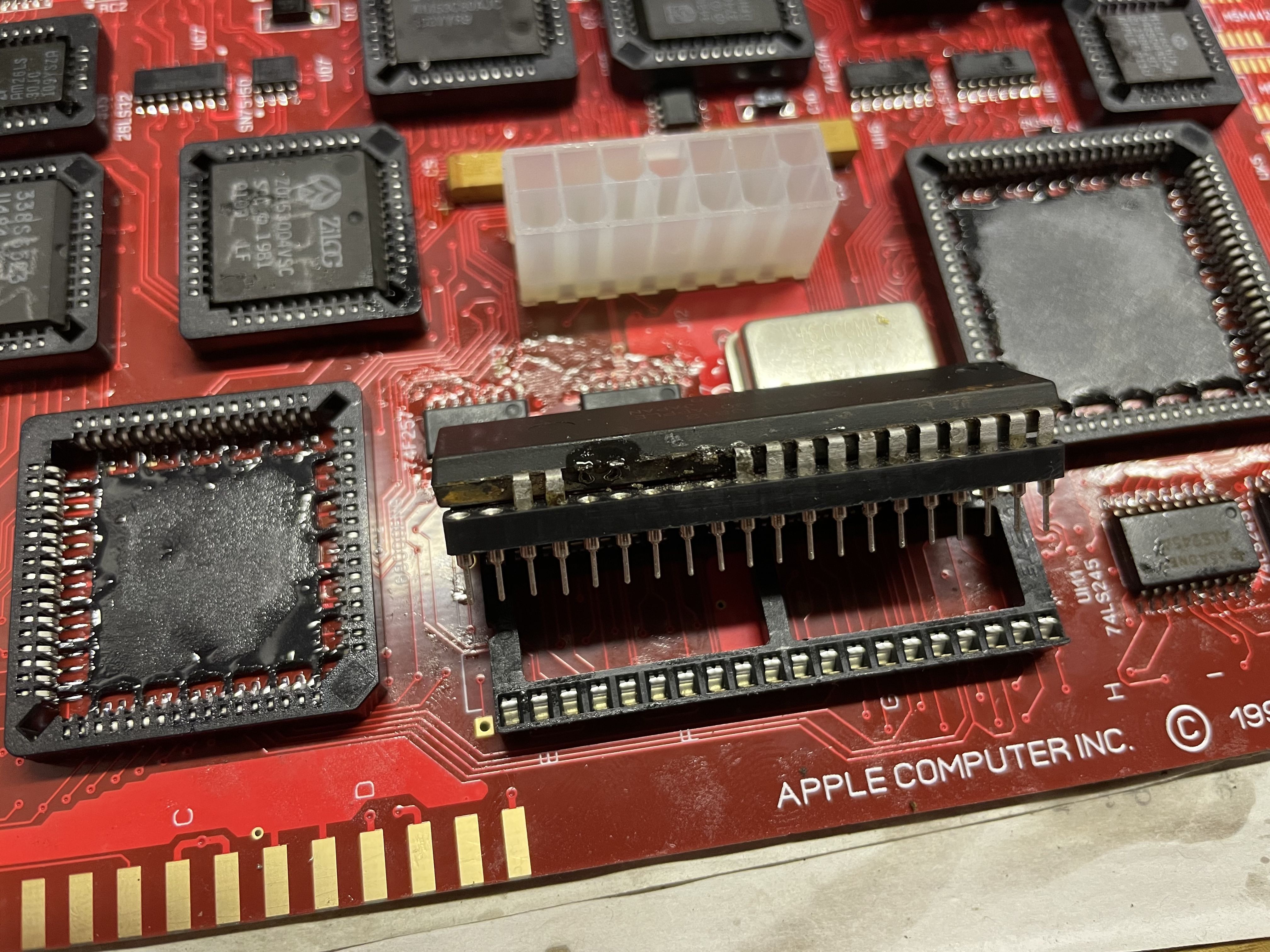

I'm currently assembling a Classic Reloaded board from @Kai Robinson (bought from @MacEffects ).
On my donor board, the ROM and CAS PAL chips lost some legs due to the battery explosion.
Is there a possibility to replicate the CAS PAL chip using something like a ATF22V10C?
I have a TL866 programmer...
As far as I am aware no one has yet cracked that PAL so it's a salvage it form another board part unfortunately
Maybe @Bolle can use his expertise to recreate it?

What about Classic ROMs?
Classics need a 27C400 which you need a adapter to be able to program in most modern programmers, if you get stuck let me know as I have the chips and programmer to make them if needed
