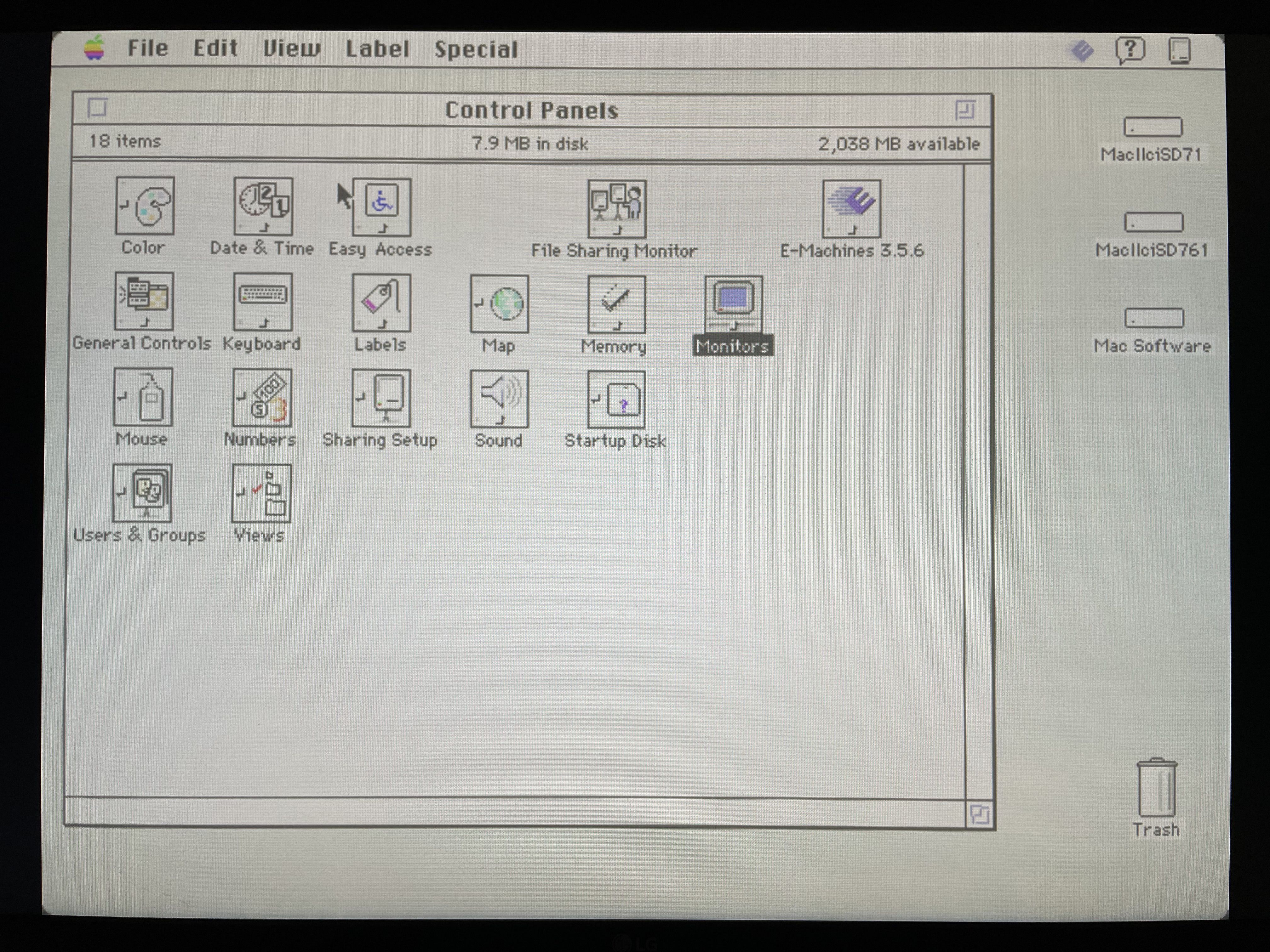

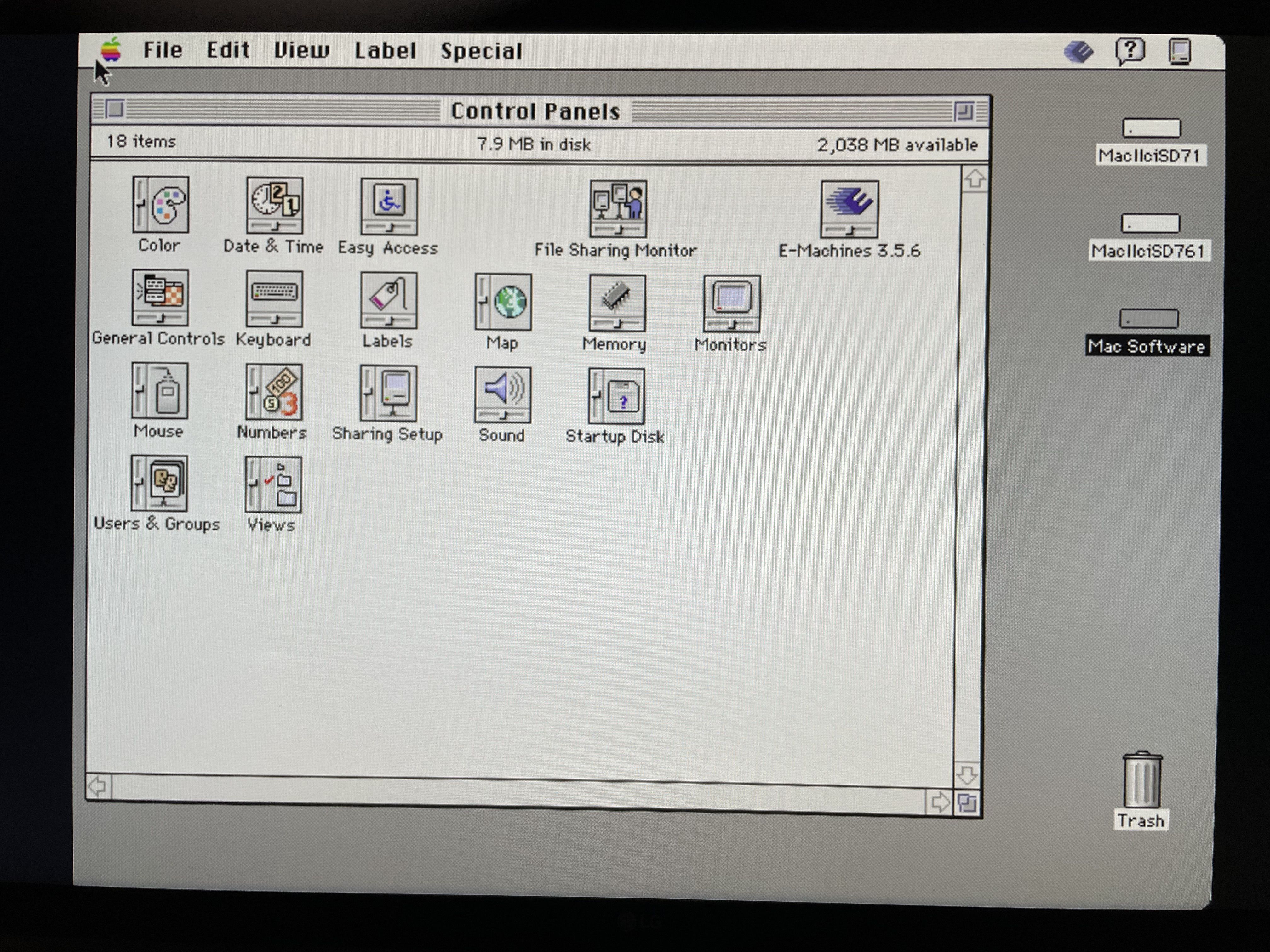

I have a LG 24MP60VQ-P that does show video from the E-Machines video card, but I am unable to successfully show video from the internal video system. Moreover, when I connect the LCD to the E-Machines video card, the only resolution that I can manage to get is 640x480 60Hz, no matter what settings I set on the card or the DA15 to VGA adaptors that I use. The first time it boots from cold It also shows a set of colors too washed out, but that gets fixed after a reboot.

(1): Washed out picture from E-Machines card and LG LCD.
(2): Perfect picture after reboot

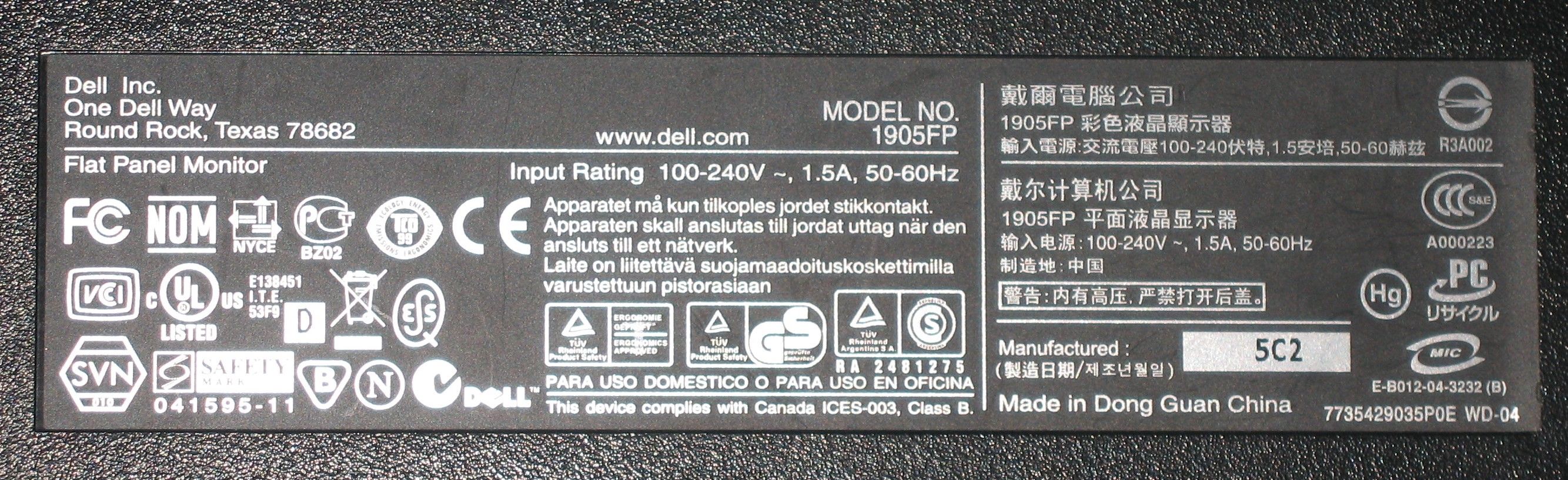

Sorry, found a reference for Dell UltraSharp in an old project thread:

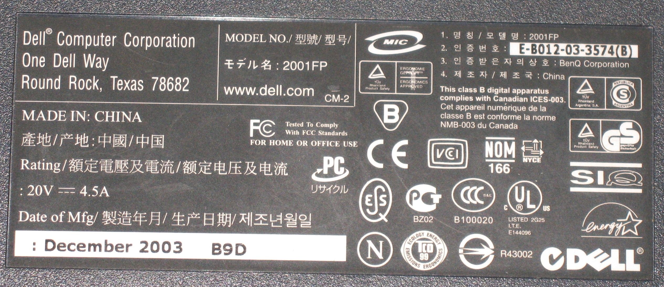

Took a pic of the info plate on one of mine, but it seems you'll need @MacEffects or maybe @JDW to translate. :D
edit: reread the thredd, I used a Dell UltraSharp of 2004 vintage Model 2001FP which seems to be the model number on the plate.
Looks like they're retaining value, dunno what I spent on them, maybe less, then again, inflation. :oops:

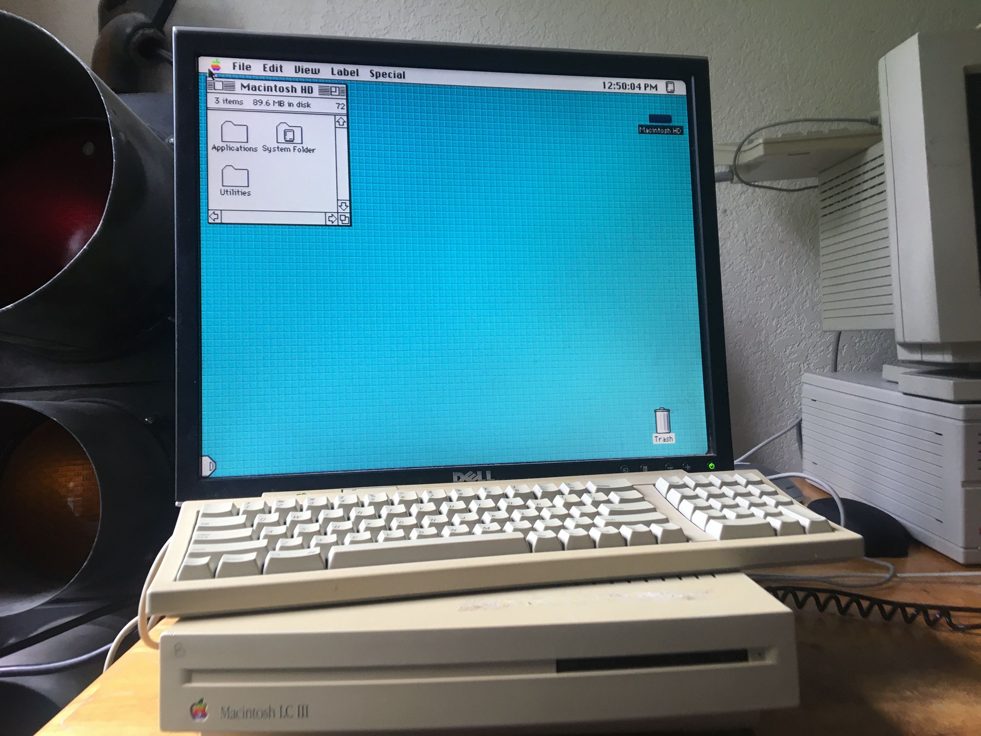

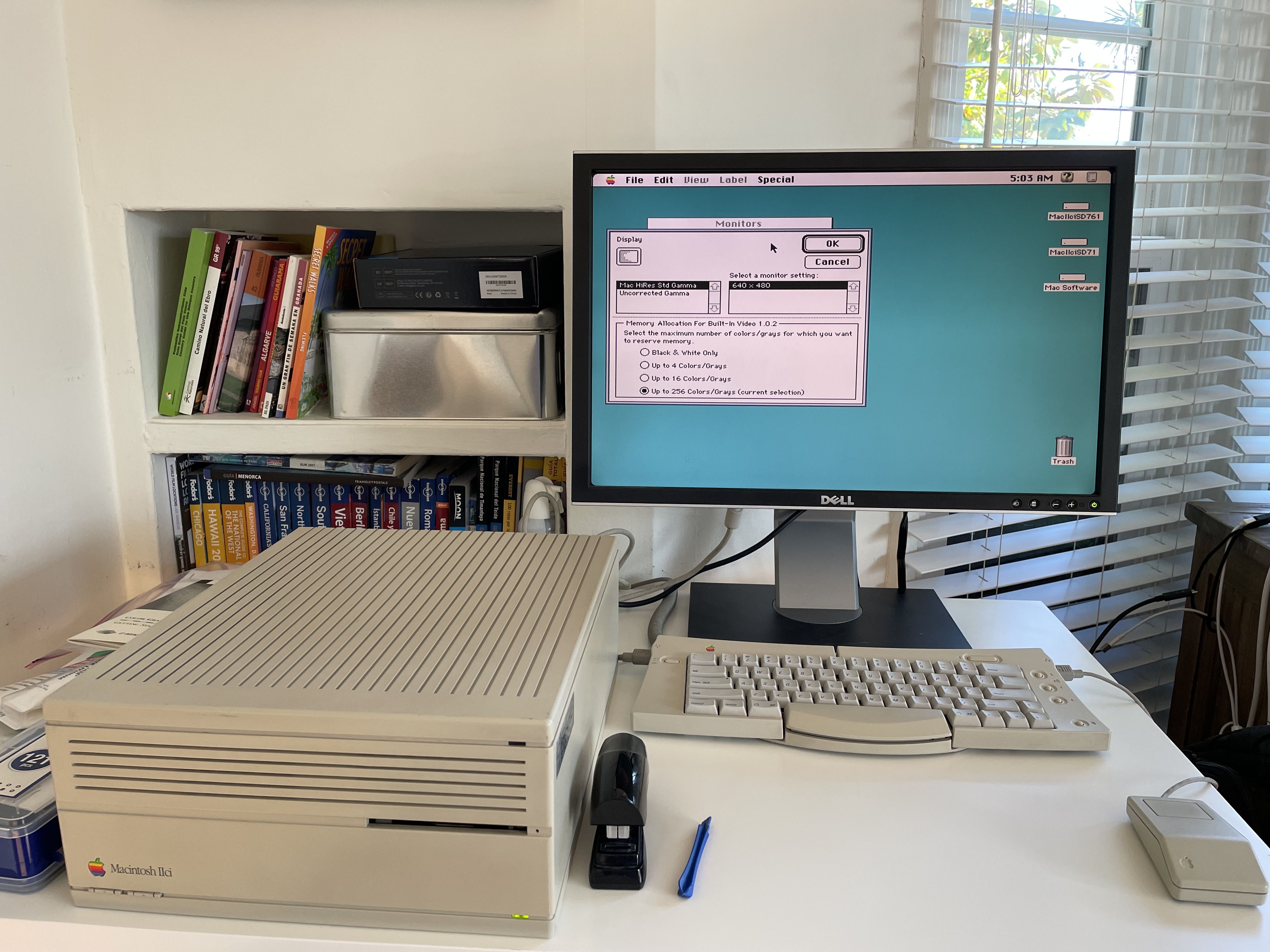

Hi guys, I managed to get it running, yes. I managed to get my hands on a DELL 2208WFP LCD monitor and it seems to like the sync on green signal from the IIci. It works both with the E-Machines and the internal video ports. I attach proof.
Thanks for helping me out pointing to DELL LCDs! Who would have thought!

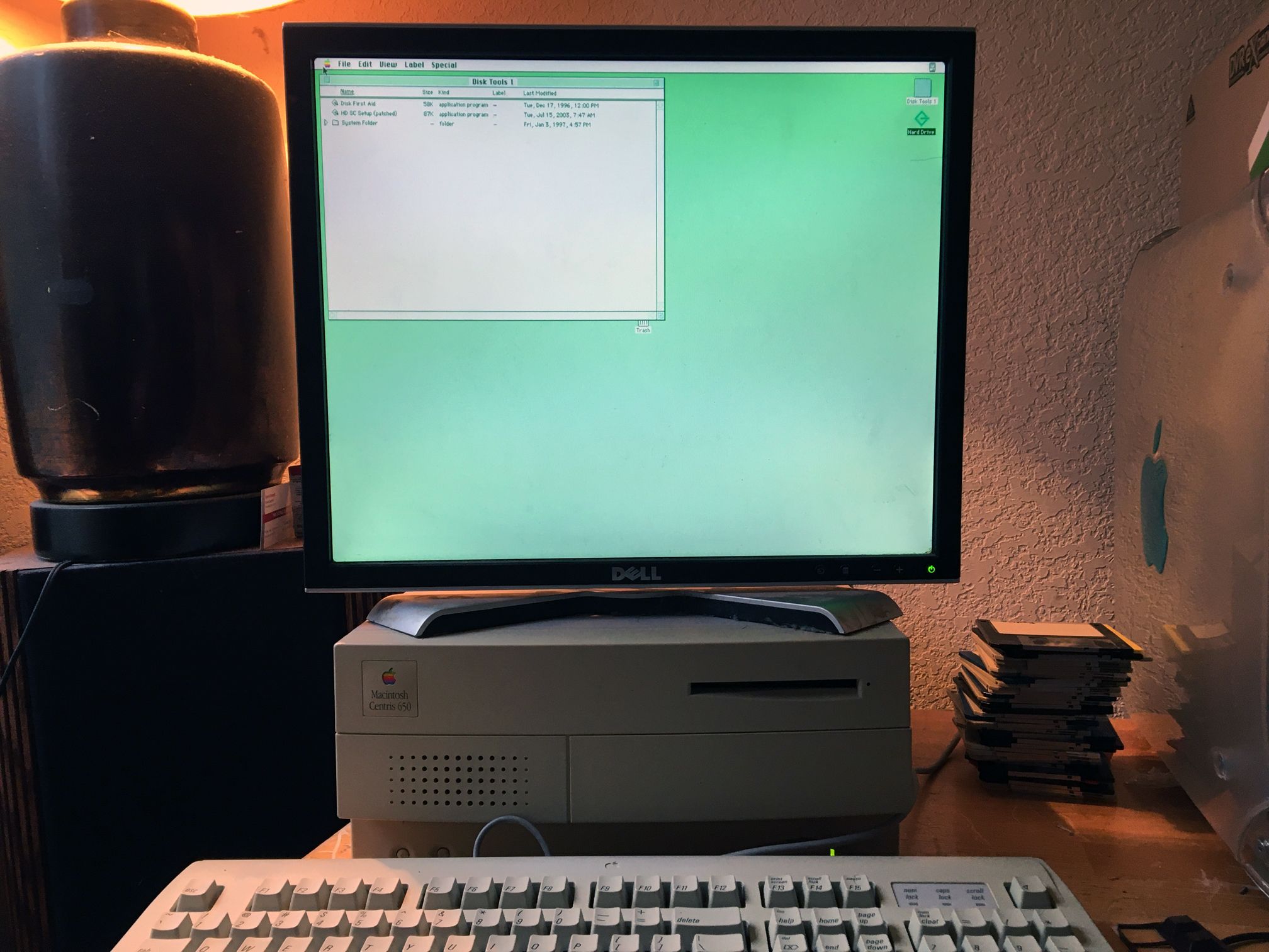

Nice. Suspect the reason why I had SOG issues with the 1908FP on my old Centris 650 was due to the DIP switches being set wrong on the Sony MacView LX adapter I was using. Looked like this:
Overly green.

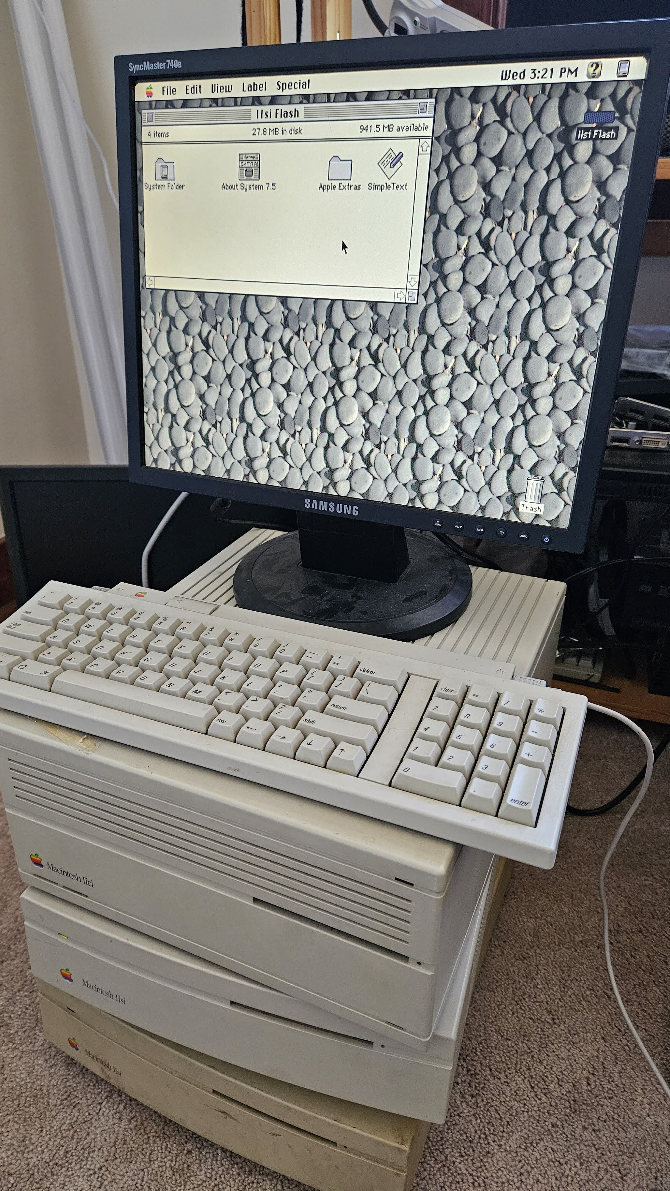

I have a Samsung Syncmaster 740B that is nice and crisp on my IIci and IIsi.
