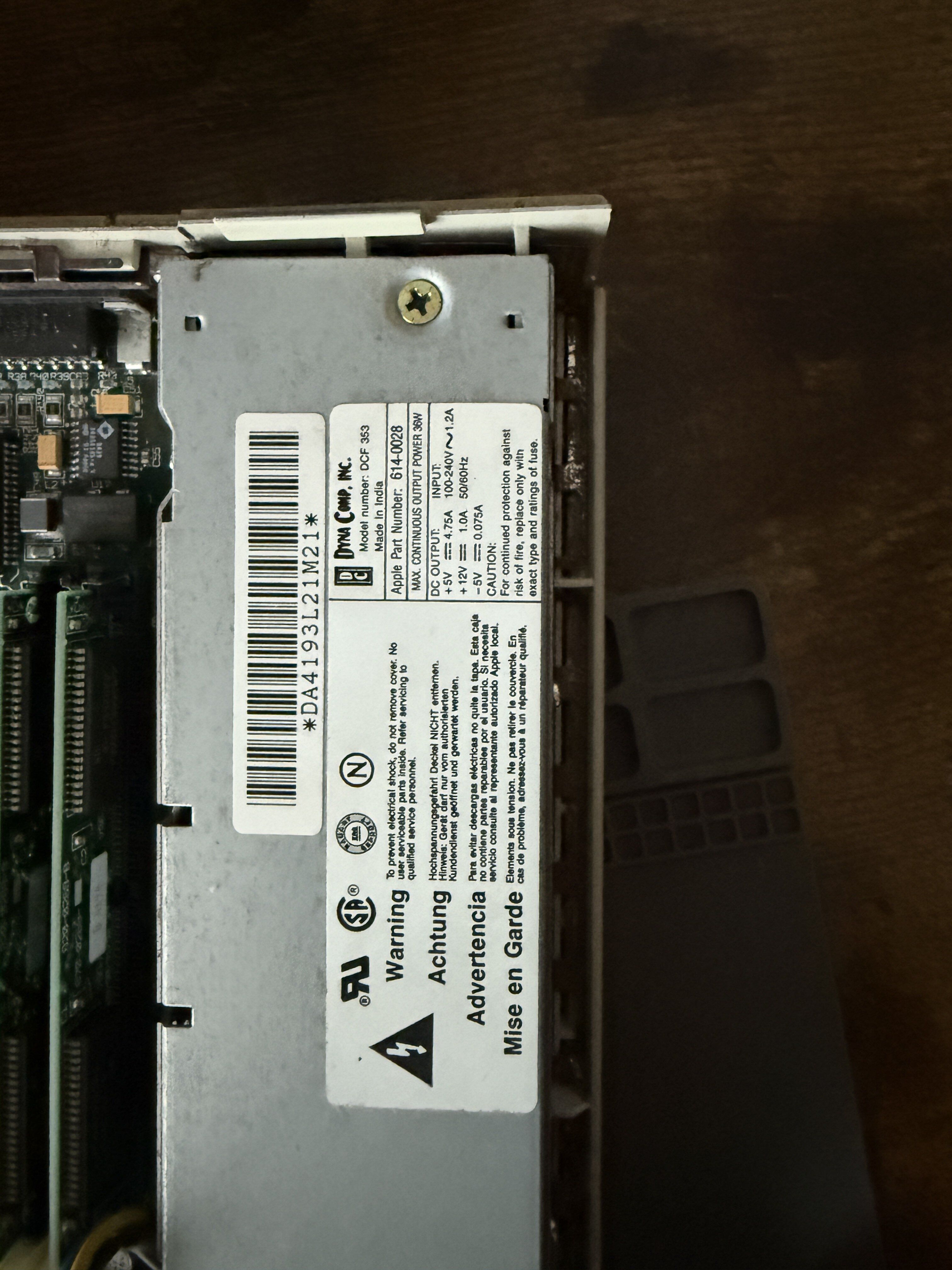

Im looking to recap this PSU, but can only find info on other PSU.
Does anyone know of this model and what caps I need?
Thanks

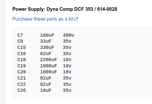

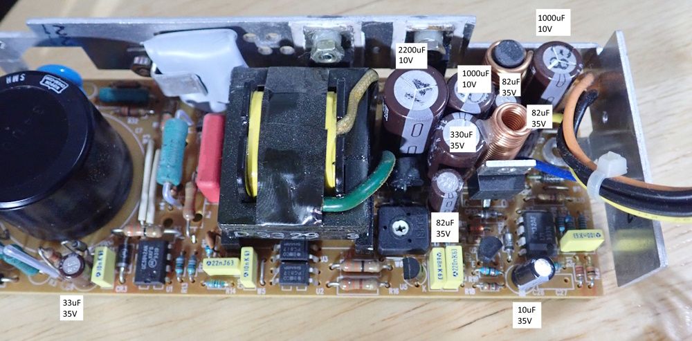

I reuse parts across different models that I repair. Therefore, my capacitor list may not be optimized for this power supply.
C19 C20 10x20 1000uf 10v 5mm ls A750MV108M1EAAE014
C18 13x25 2200uF 10v 5mm ls A750MW228M1CAAE010
C15 10x20 330uF 35v 5mm A750KW337M1VAAE020
C16, C21, C22 6.5x15 82uF 35v 2.5 mm 35SEPF82M (not quite correct -- it fits but is too wide of diameter)
C9 5x11 33uF 35v 2.5 mm A759B0336M1VAAE075
C26 5x11 10uF 35v 2.5 mm 870055673001
C7 180uF 400v did not replace
