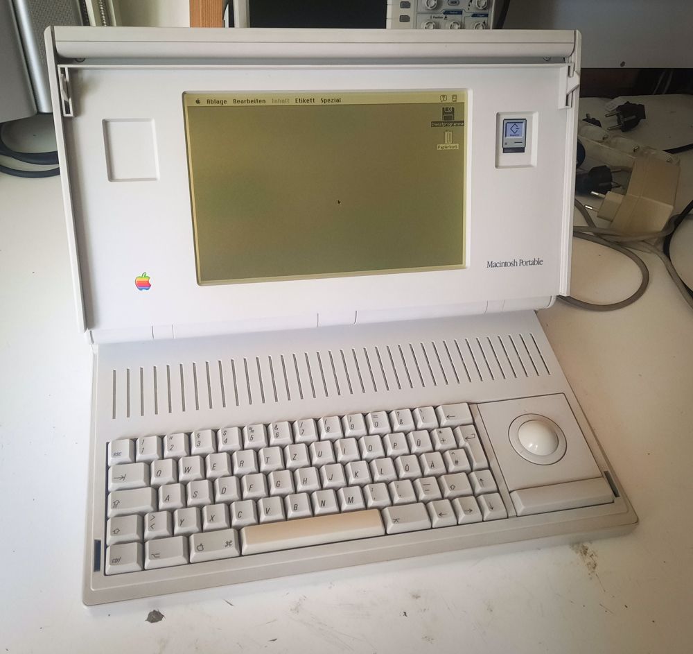

Hi,
my name is Tom and this is my first post in this forum. I run a small online homecomputermuseum site and i repair a lot of vintage computers.
Now, i am in the process of fixing a non working Macintosh Portable M5126 for a friend
After recapping and fixing 3 broken traces / Vias the mac greets me with a chime and boots a systemdisk from the diskdrive.
BUT: then i get the "no reserve battery power - good night" message imediatly after the system is bootet.
BTW: the battery is a new replacement one and gets charged from the mac and meassures around 6V, but the mac battery menuitem shows battery level at 0%
the small battery compartment switch is working and both buttons (reset and inerrupt) are working.
Without the powersupply the mac does not startup at all / or only 1 second...
Yes, it is possible that there are more bad VIAs
It would be great if someone could give me a hint where to search, or what to meassure (i can use my oscilloscope) ... to narrow down the search-area :0)
Cheers and many thanks in advance, TOM:0)

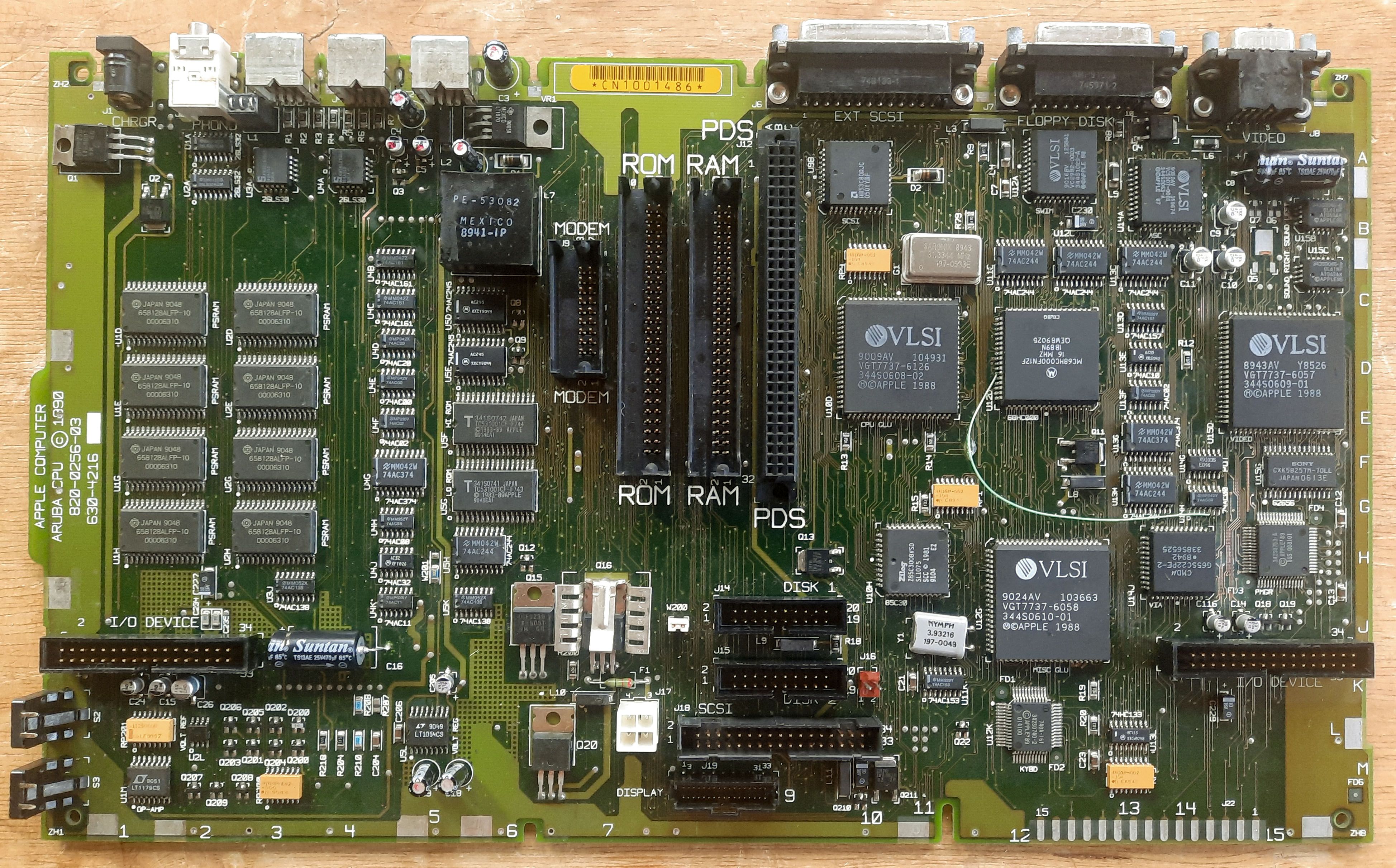

PSPS: is there a correct schematic for the M5126 somewhere?

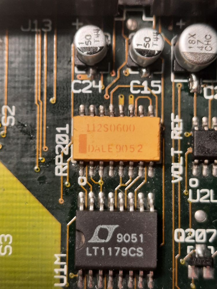

I have watched all the videos from @techknight regarding mac portables, => very informative and a great help!!!!! Thanks!
In one video he removes a few of the smd chips and finds cap-rot beneath...

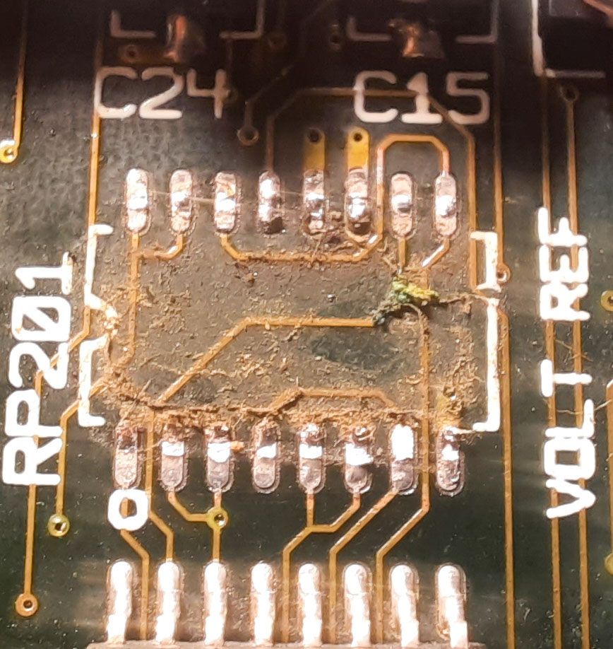

I thought the area looked fine, but decided to remove the resistor-array => and found at least one VIA completely gone...
Next step: patch it up and remove the other smd chips in the area...
Cheers, TOM:0)
I have removed two more smd chips and found no more corroded traces... :0)

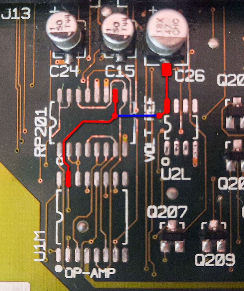

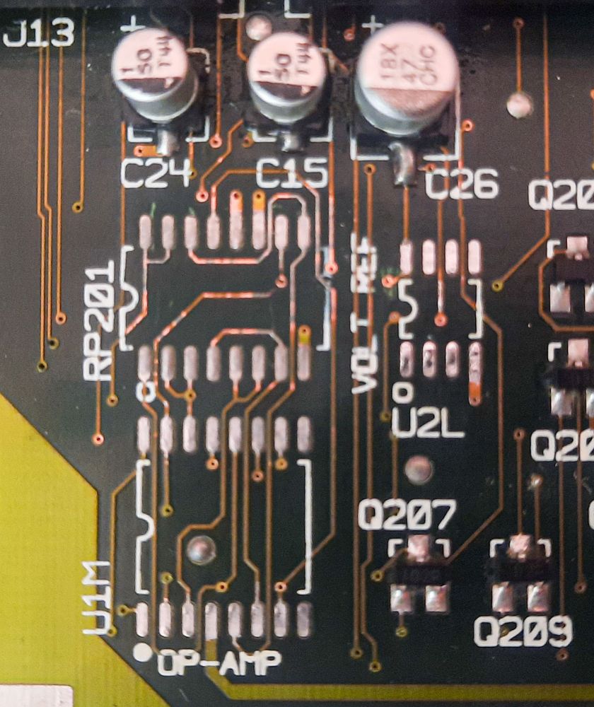

Find a picture attached for future reference of the traces under the chips... so you can check for continuity without removing the chips...
Red: Topside, Blue: Bottomside
Cheers, TOM:0)

Hi and Eureka!
after soldering everything back and patching up the bad VIA the Portable has the correct voltages, recognizes the battery and its charging-level, boots from Floppydisk even without an external PSU attached... NICE :0)
