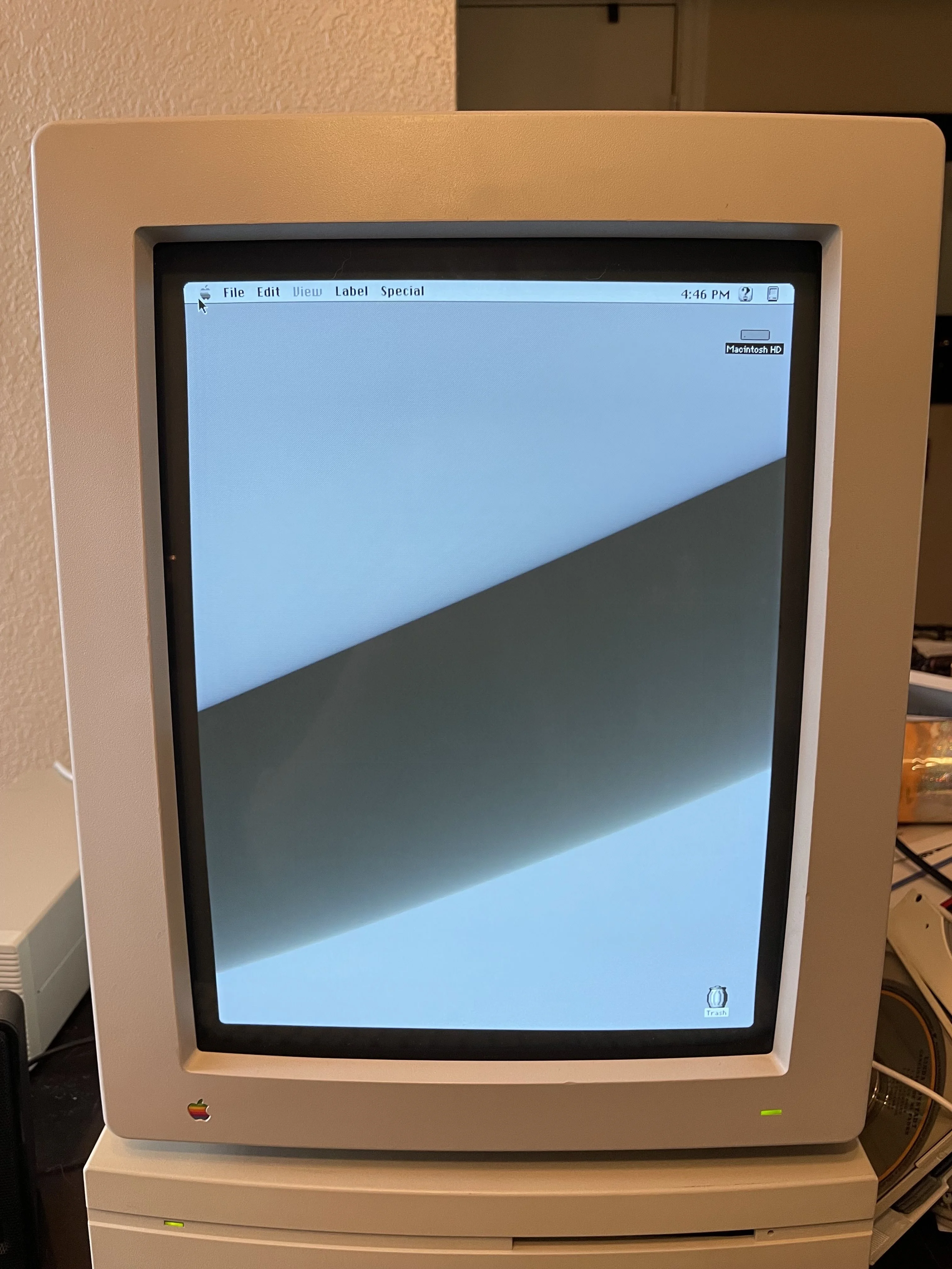

Macintosh Portrait Display Repair - Smearing/Pulsing Image on Screen

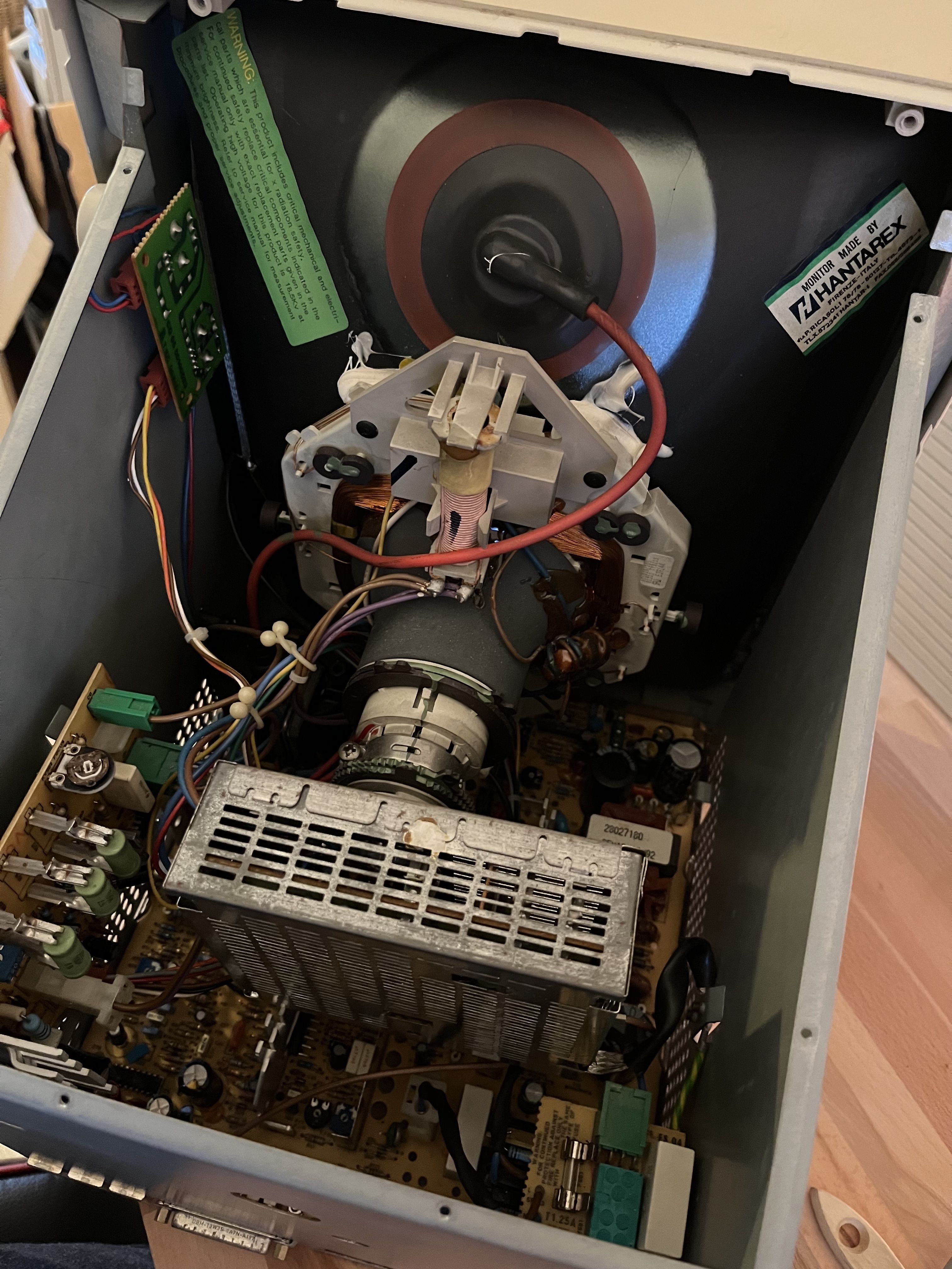

Thanks for sharing this list! -- I went ahead and purchased the caps from the mouse project and replaced the signal board and neck board, Unfortunately the sweep board I just didnt.
The reasoning behind is because the caps on your list are rated for 85c which are fine for the signal board, but the neck and the chassis board they come originally with 105c rated caps :(
Yes I know that they will just work but on the long term that might not be the case :).
The signal board caps are fine at 85c but the neck and the Sweep board require 105c rated caps. Hope this helps someone in the future :)

Oooh! My Portrait display is doing the same thing after spending a decade in non-climate-controlled storage in east Texas. I've been putting off diving into it, but that cap list gives me a great head start.

Interesting @JDW I didnt think about the ESR -- FWIW the portrait display on the inside has a fan I imagine to recirculate air -- while I was adjusting it it was getting warm, not 85C warm but nonetheless warm.
If it measured 85°C with a fan, I would be very surprised! Probably measures in the 40's, but you would need a thermal camera or maybe a cheap IR thermal meter to check it more accurately. Thermal cameras are neat because you can point them at the whole circuit board and see how hot certain components get. In this case, knowing how hot the capacitors in question are after 1 hour of the monitor being on would be very useful info. But unless they are right next to something extremely hot on the circuit board, I suspect those caps may be quite similar to the internal ambient temperature. However, with a thermal camera, you would need to remove the case plastic. But in order to get an accurate measurement, you would have needed to have kept the case together as it heated up, then quickly remove it and test. Even then, a lot of that heat will escape when the case is removed.

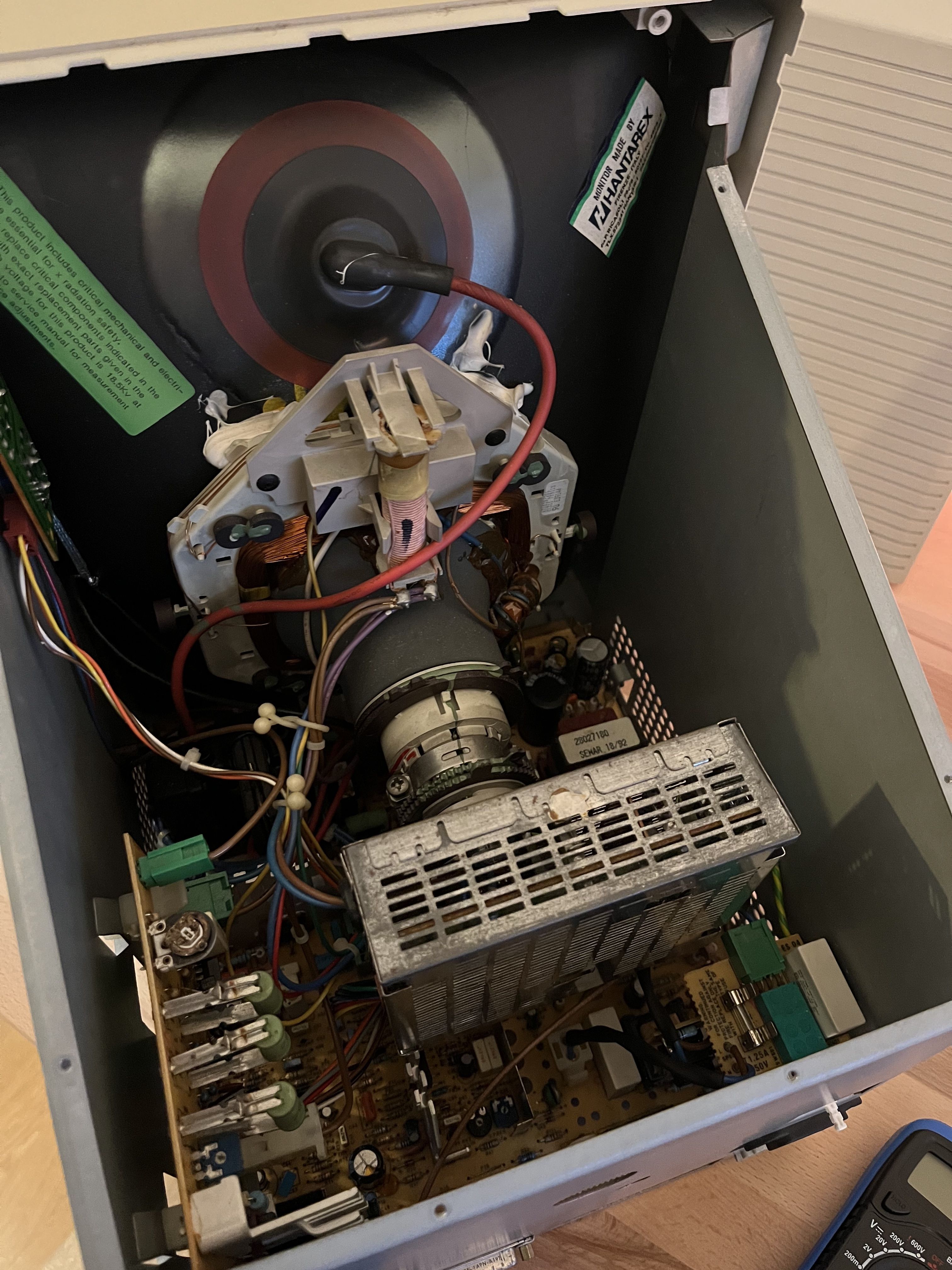

Reactions: Nitram78
