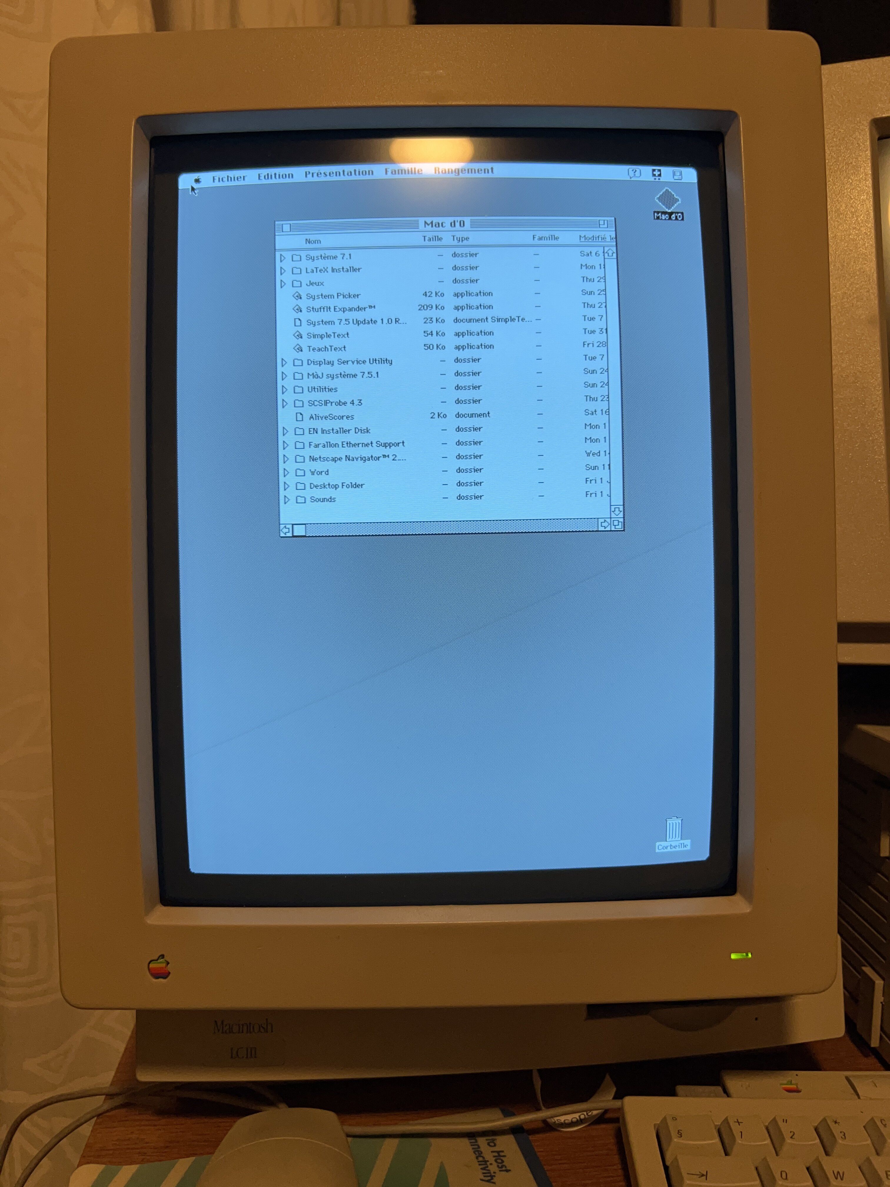

The Apple 8*24 card will also drive it. I believe the on board video on a IIci worked for me as well.
I am the happy owner of a working Apple Portrait Display and Yes, the Apple 8*24 in my IICI drives it. But wait, my LCIII also drives it with its built-in video. A superb display indeed.

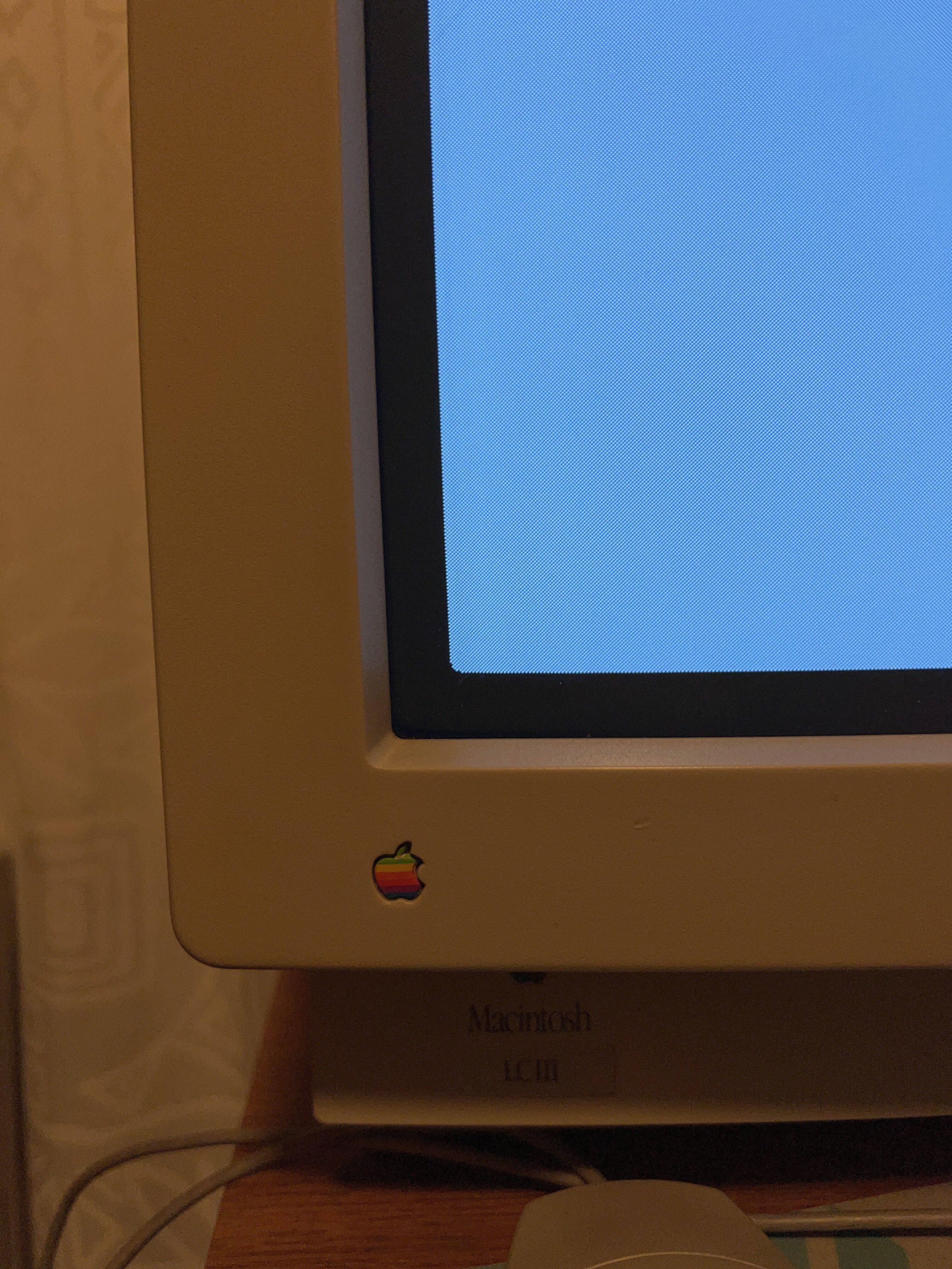

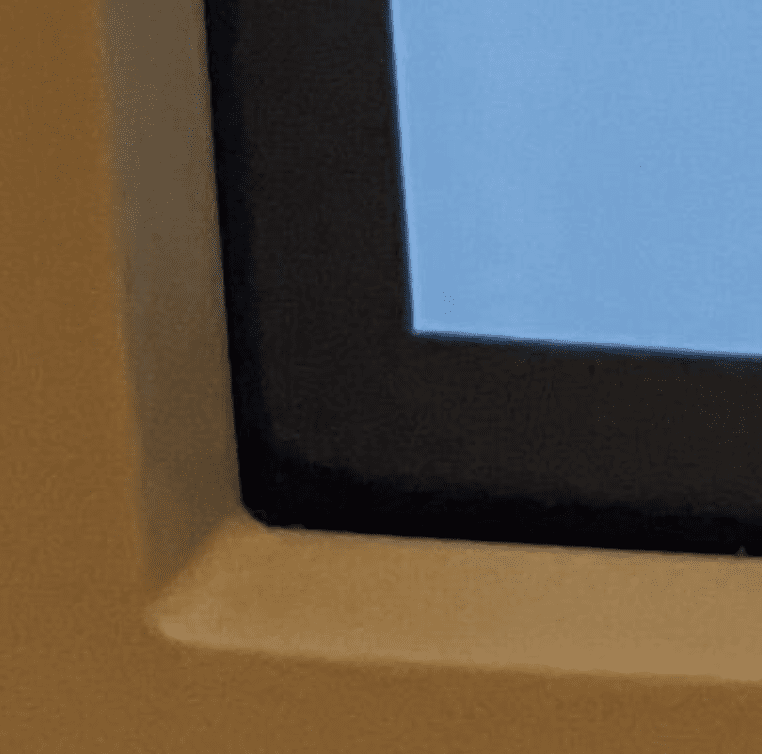

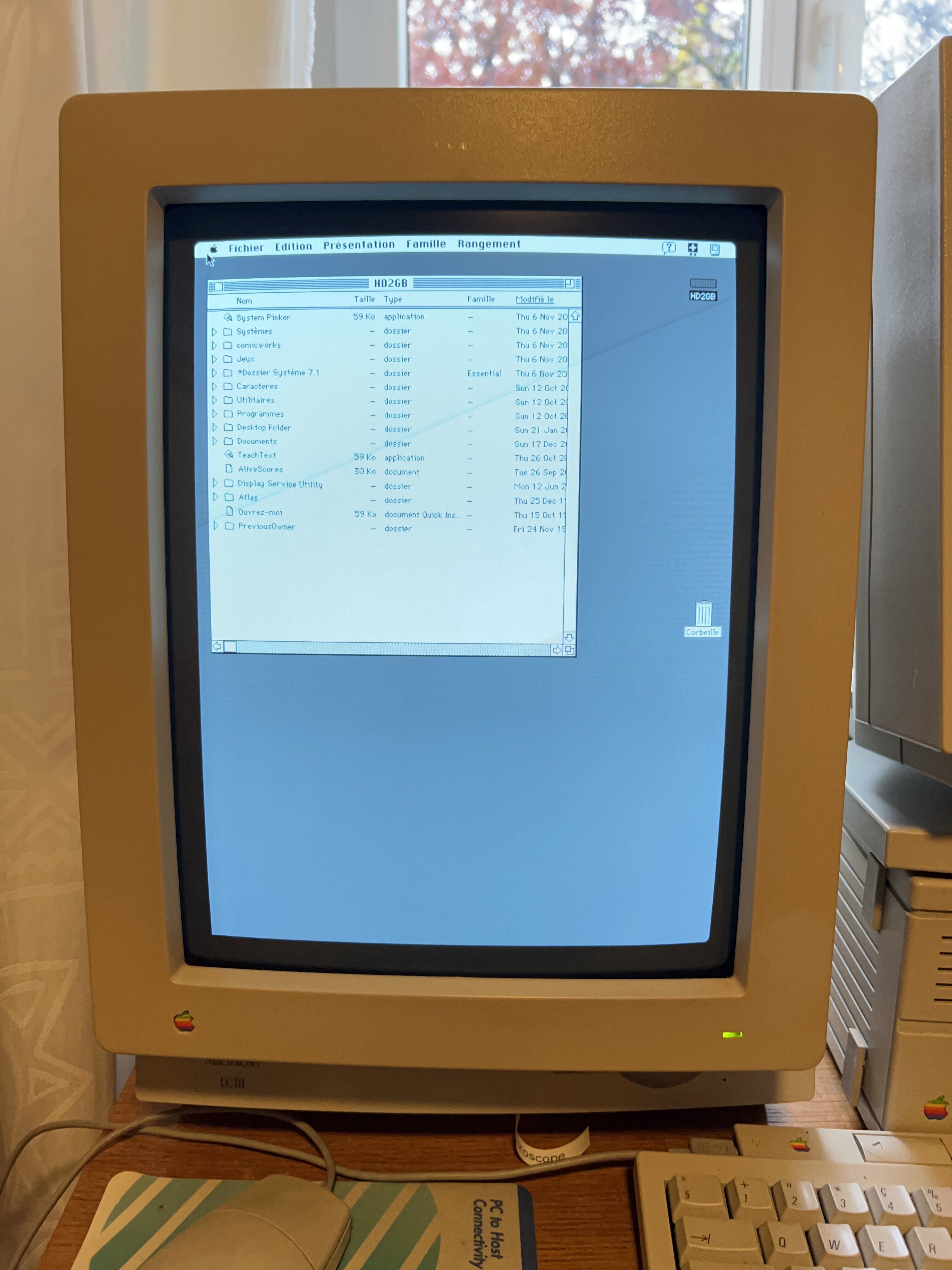

Fun fact. I connected the Apple portrait display to my LCIII and the bottom left corner was like the three other ones. Well almost. Now the bottom right corner is more cut than rounded. 🤣

I thought the rounded corner disappears when you have multiple displays and that edge/corner is where another display extends the desktop?
