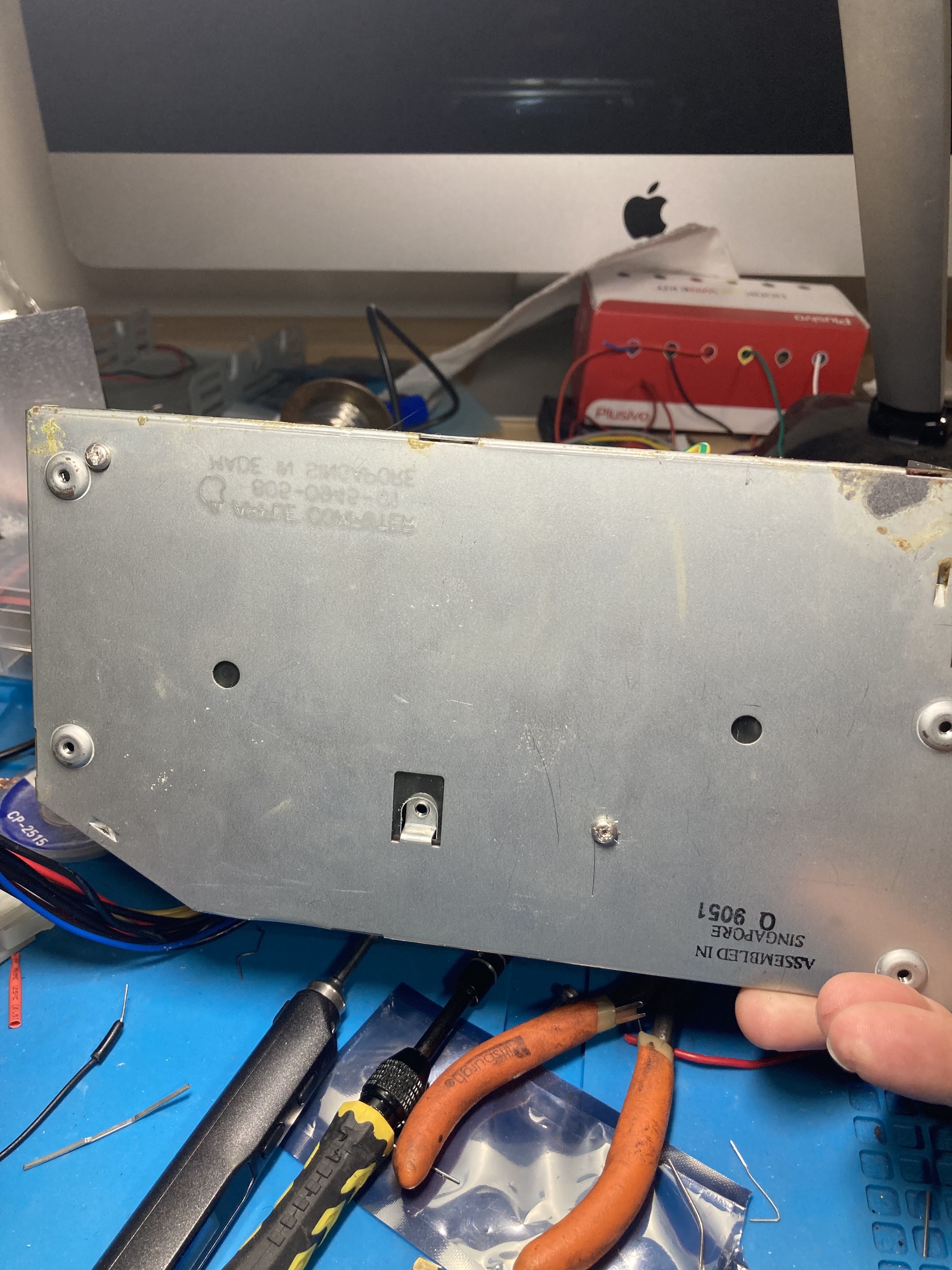

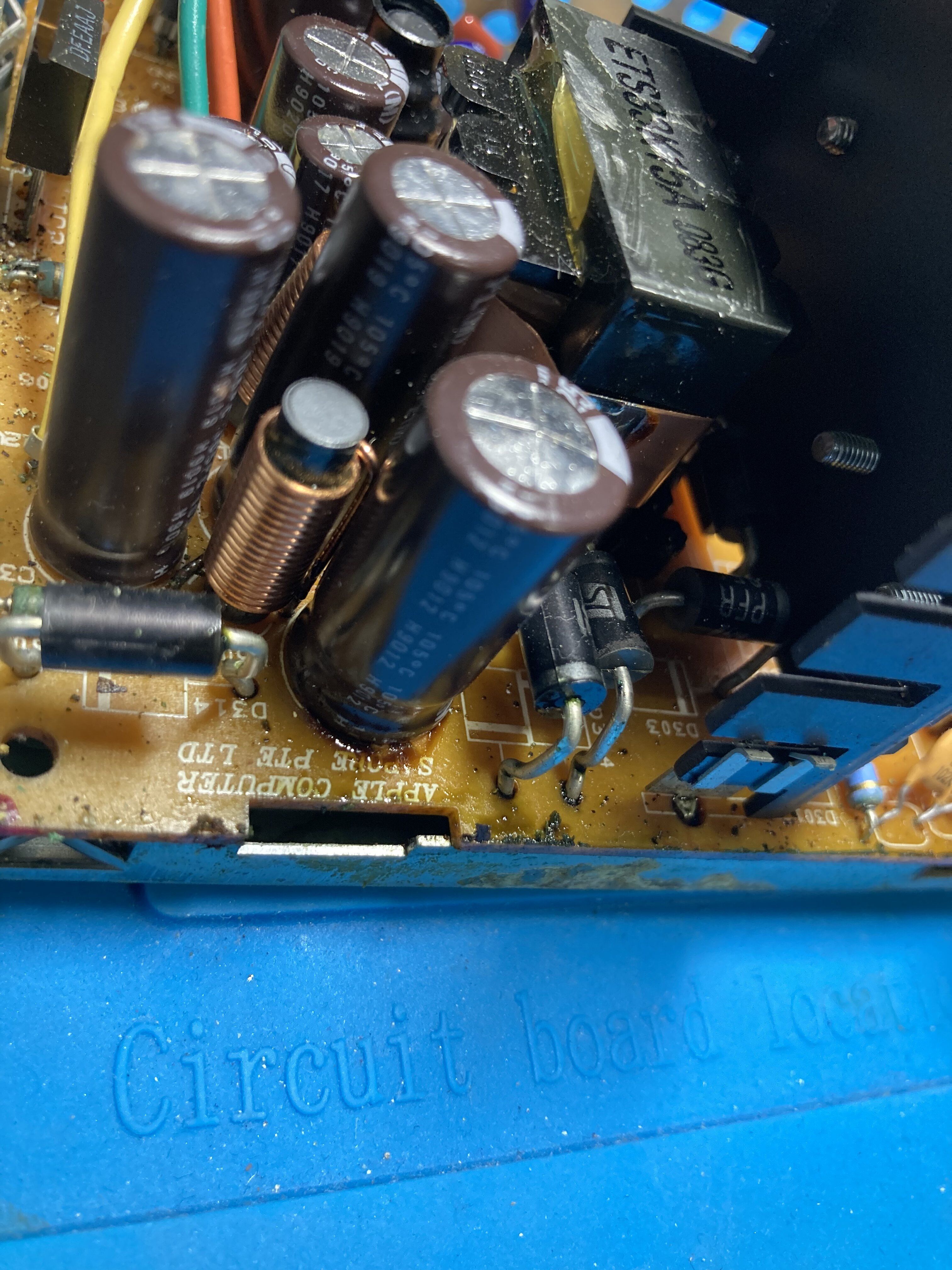

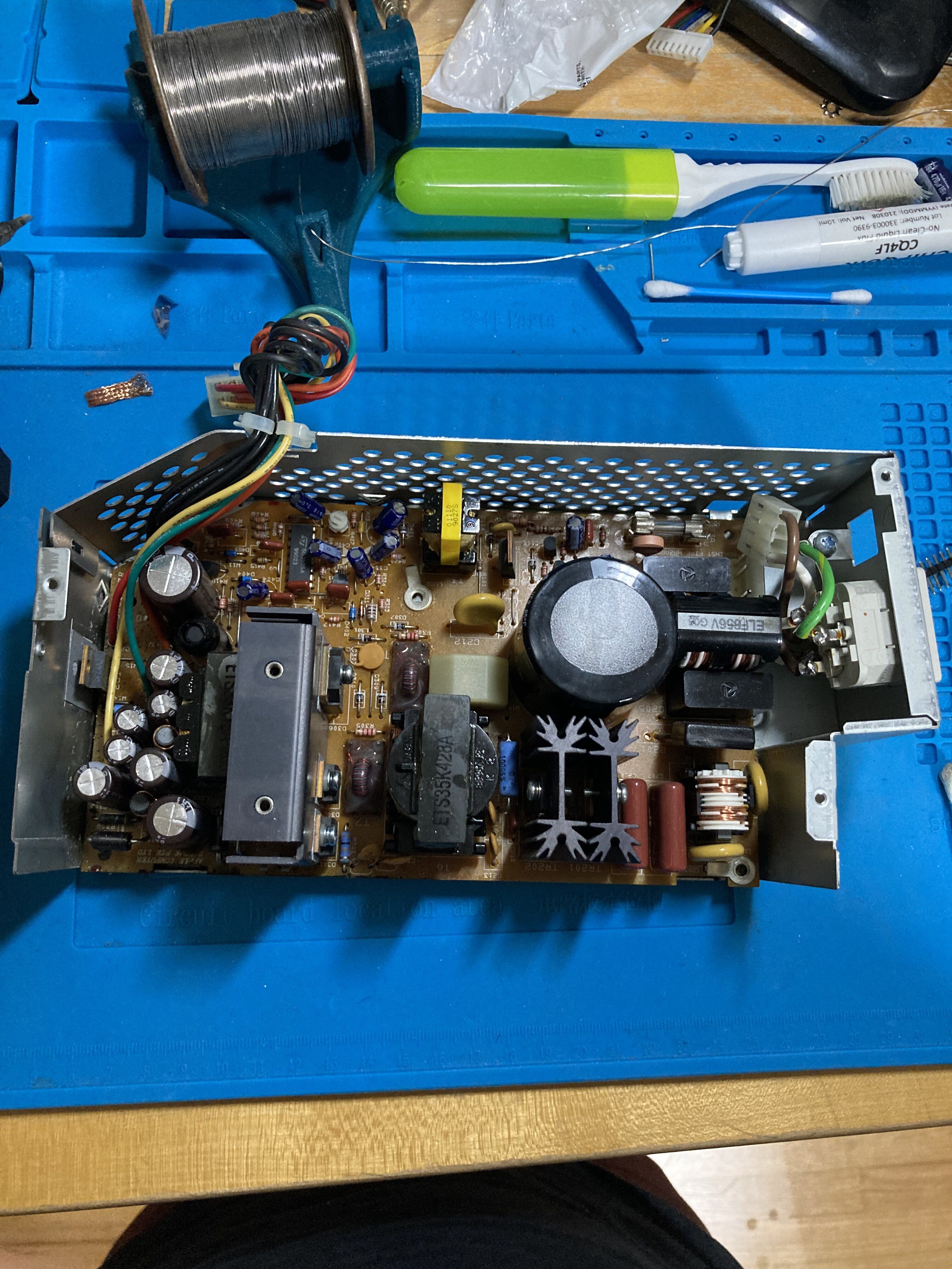

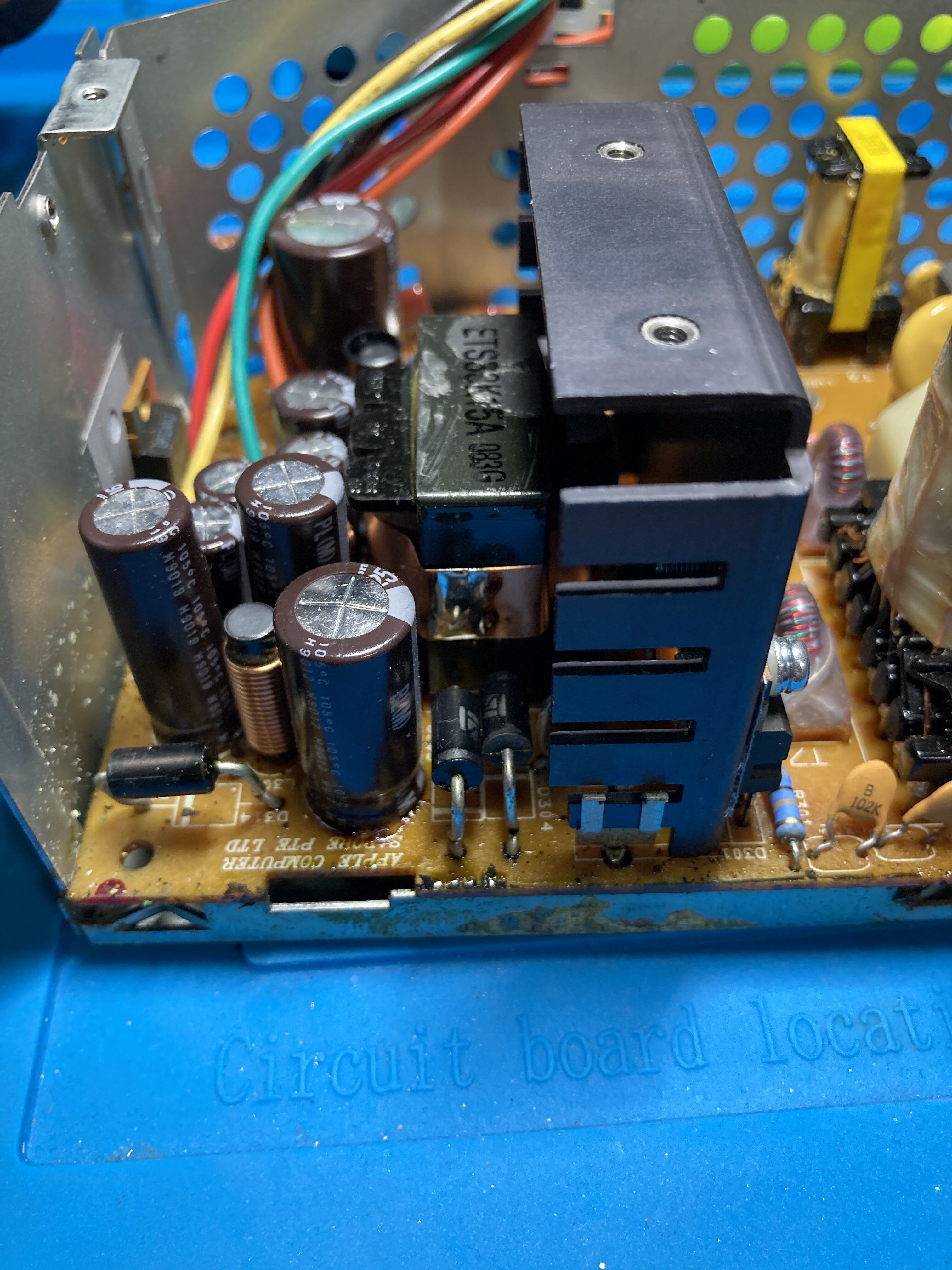

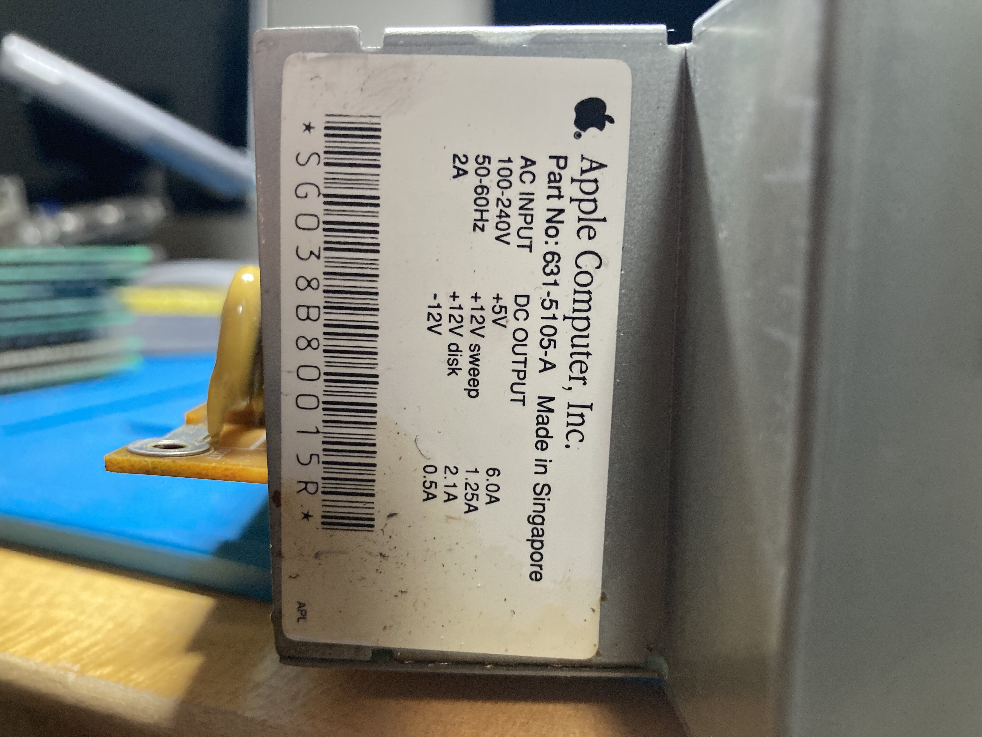

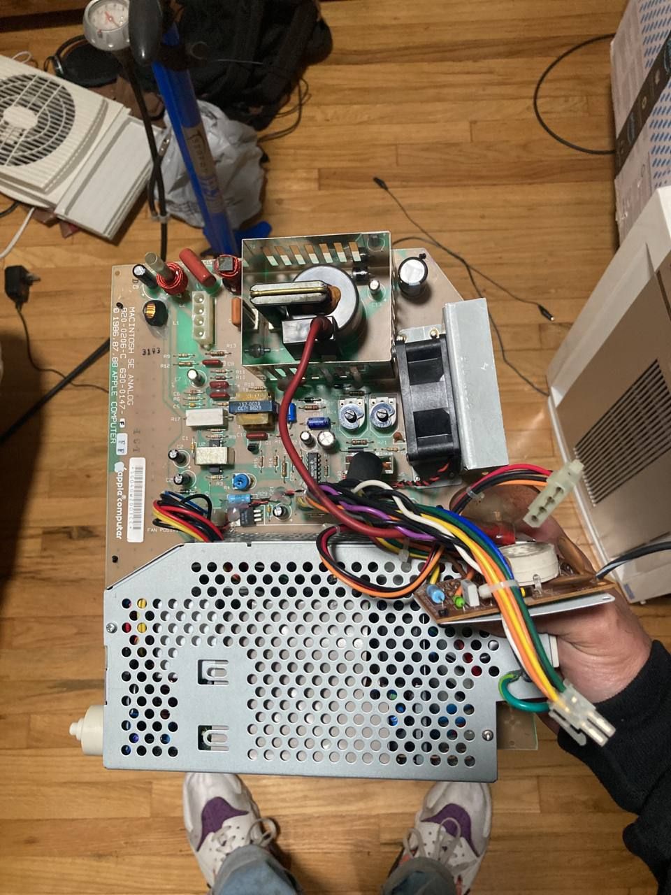

Also while on the subject, I noticed when searching for a capacitor list to replace the ones in my stock psu that my unit isn’t really listed anywhere. I’ve included pictures here of the apple psu part #: 631 - 5105 - A it’s apple branded and says manufactured in Singapore.

It’s the Hitachi power supply.
Notice the text “S’PORE PTE LT” match.
Seems to have went Aztec -> Hitachi -> Sony from what I’ve seen with Aztec used in ‘89, Hitachi in ‘90, and Sony ‘91, roughly.

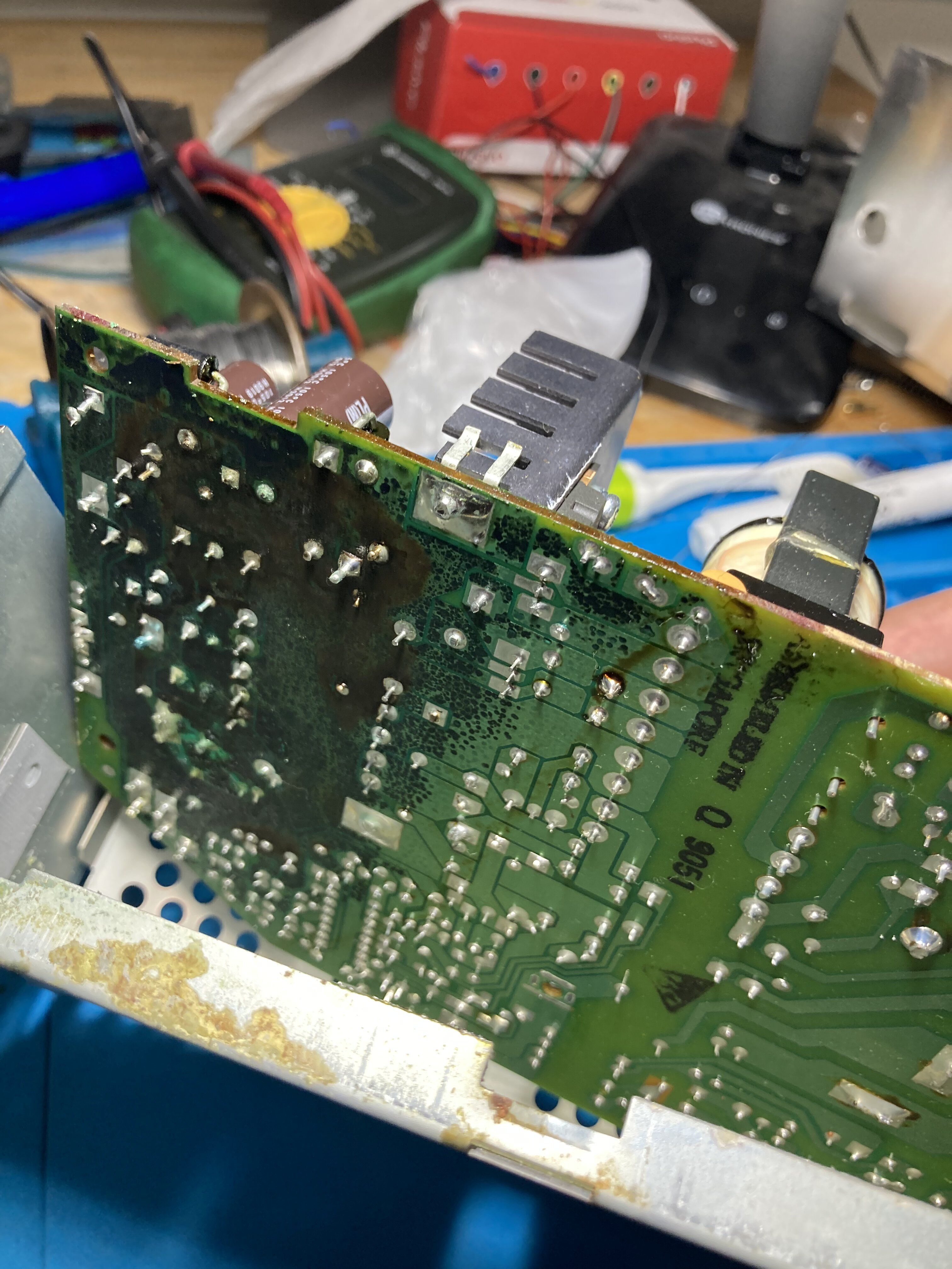

Awesome thank you, I think I will hold off recapping this powersupply for now and just remove the caps, clean it with vinegar, and put it into storage. I am going to Frankenbuild the best se/30 from two machines I have. One of them has the Aztec psu that is still operational but I’m going to investigate that one once I get the seasonic psu. The analog board from one of these machines has a much better transformer on it (less white build up) and the monitor looks to have less hours on it. However the motherboard for the second one has had a horrible battery bomb in the past that I think makes it not worthy of restoring. Hopefully one day I can move the parts onto a new pcb.

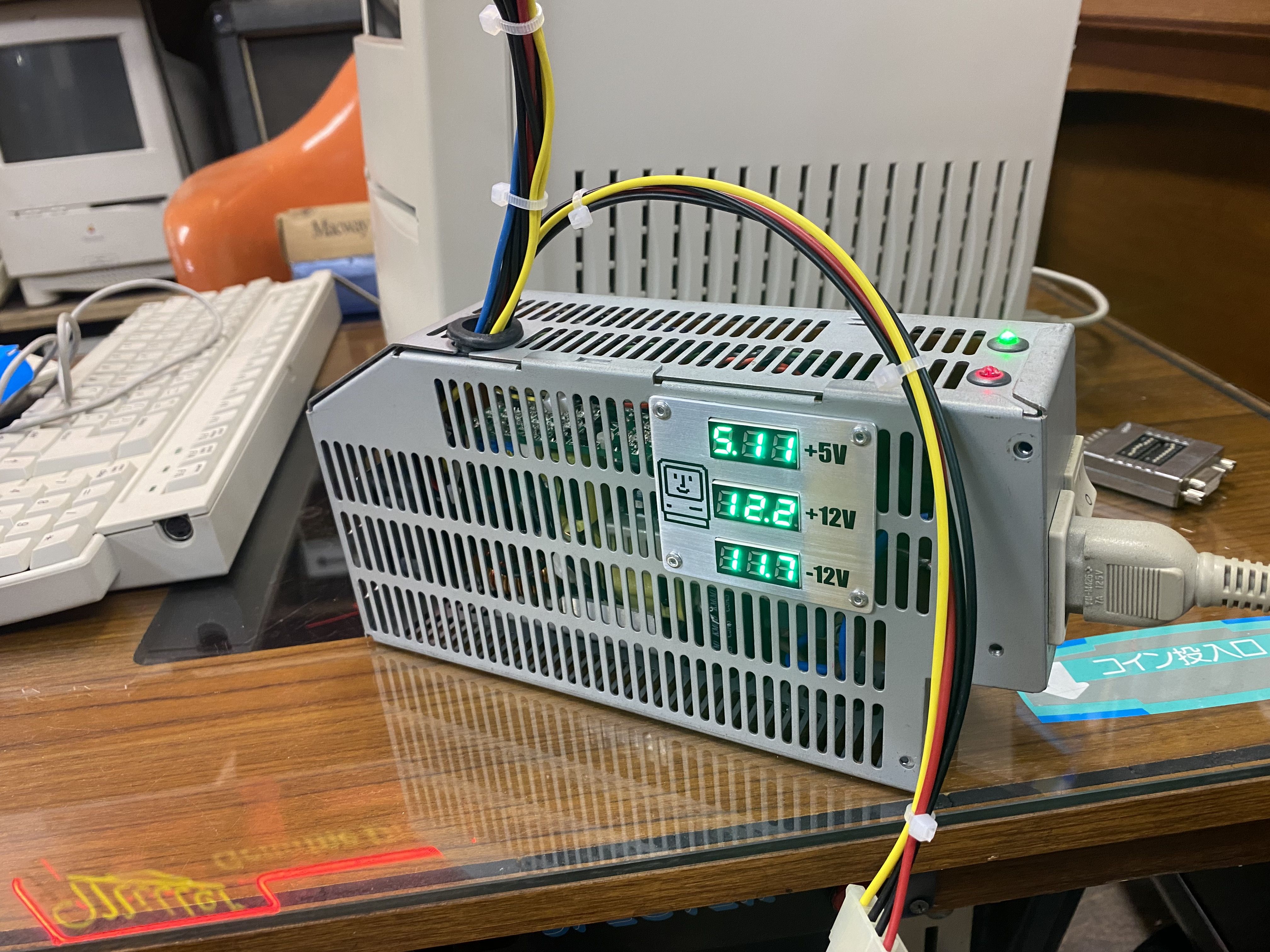

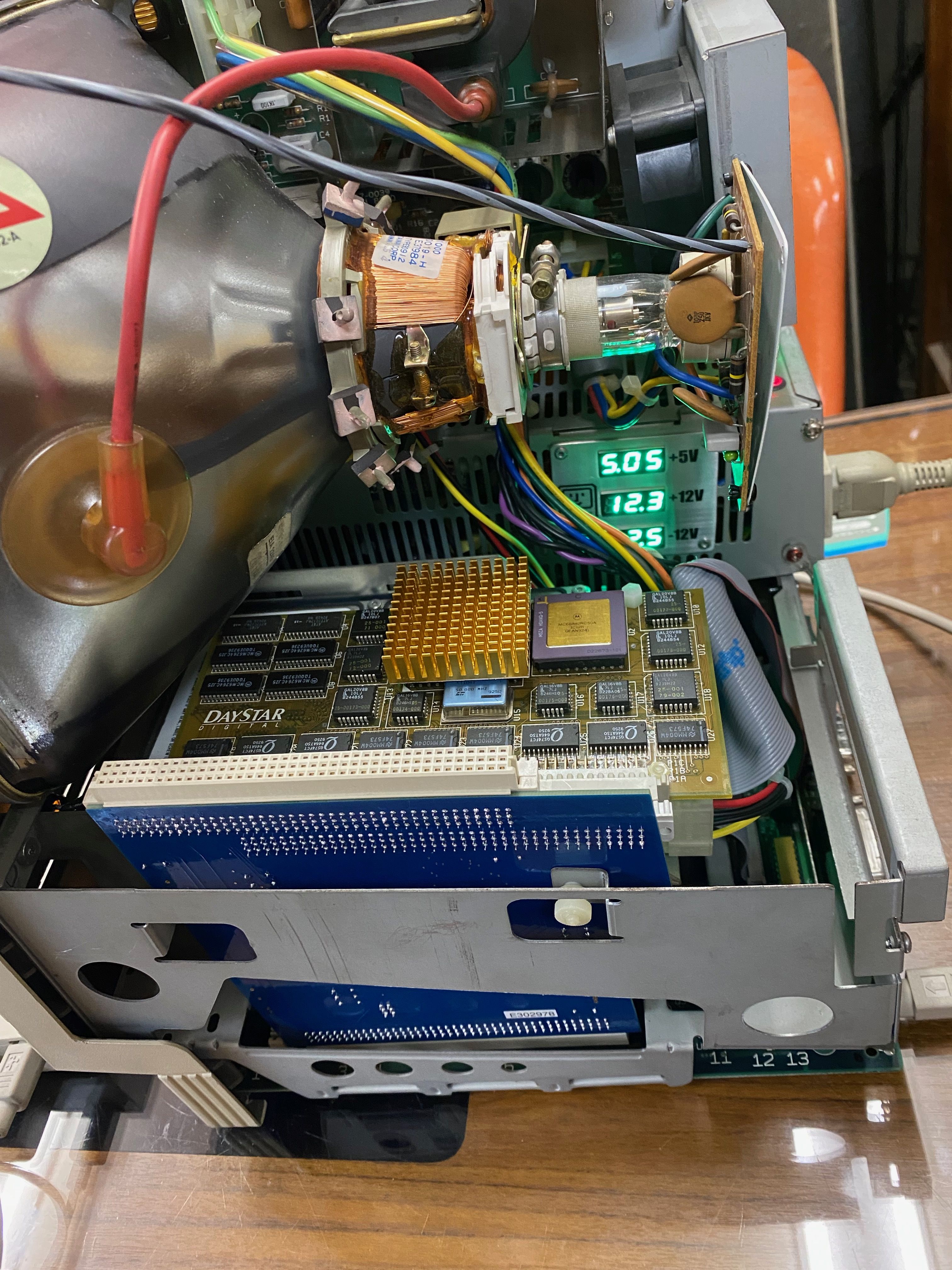

Not long ago, I made a SE/ 0 PSU using a Flex ATX power supply. It has -12V so I didn't have any trouble. LED monitors for each bolt is attached just in case. Please note that the + 5V voltage may be slightly lower depending on the PSU used.

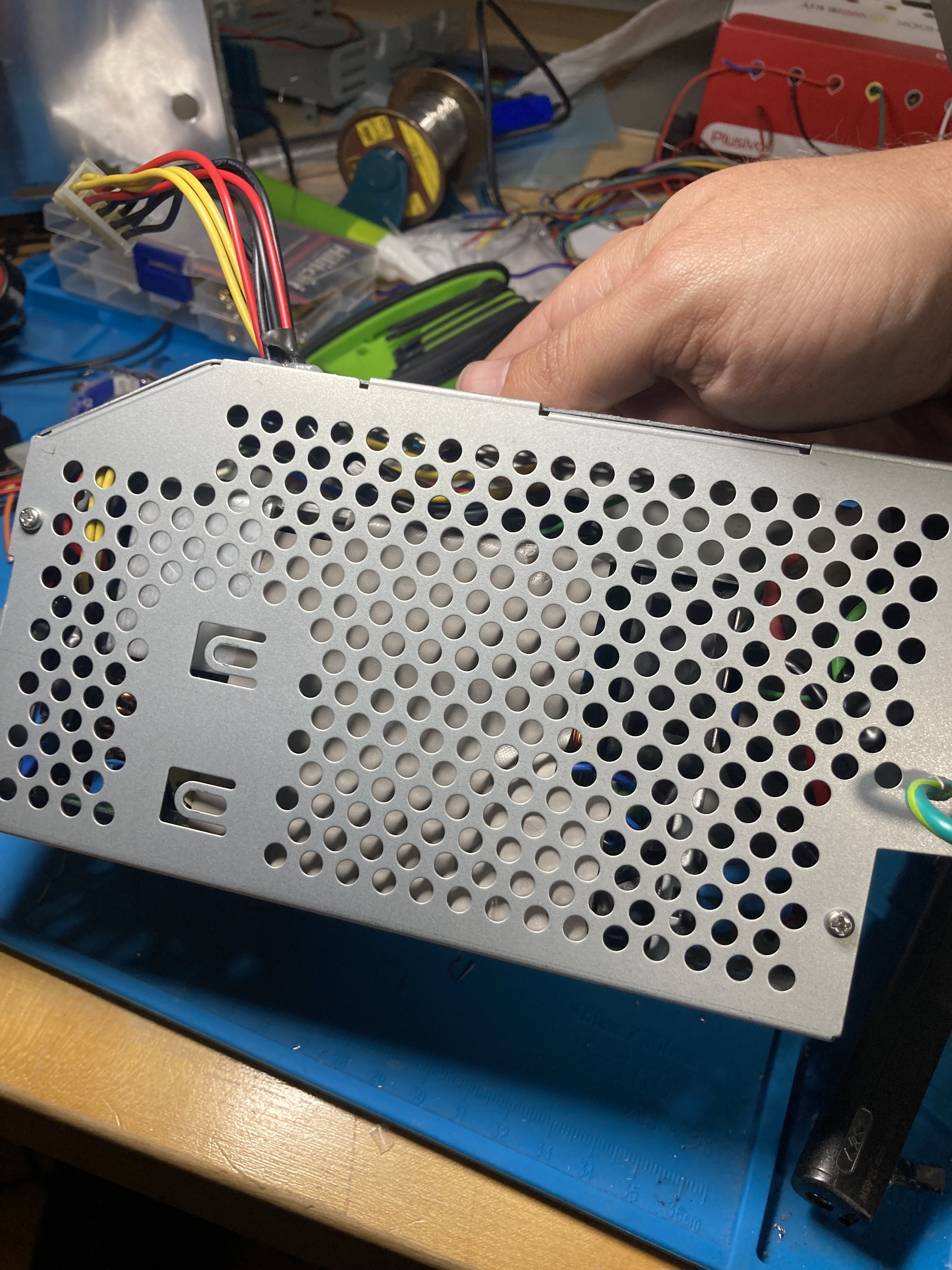

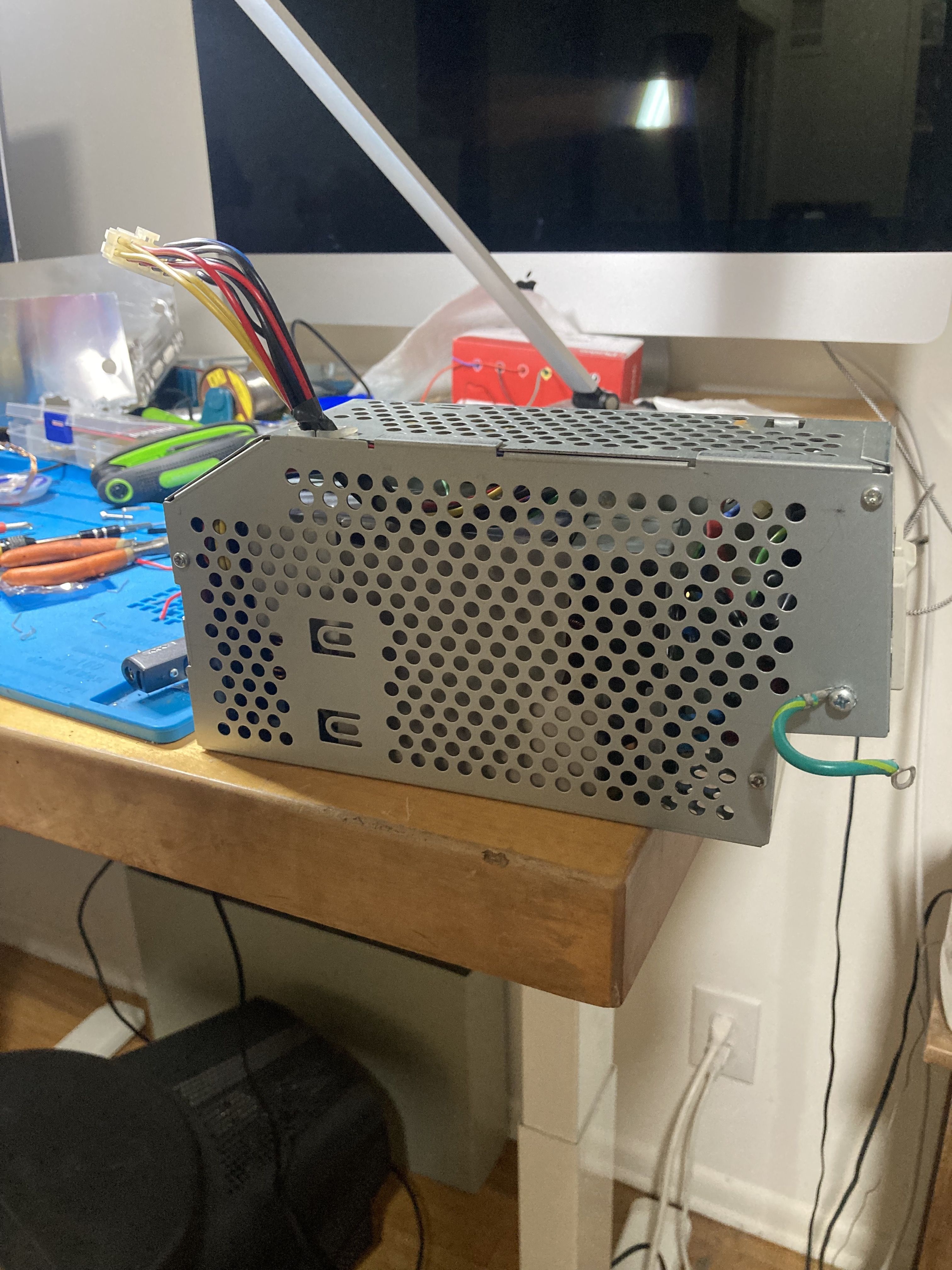

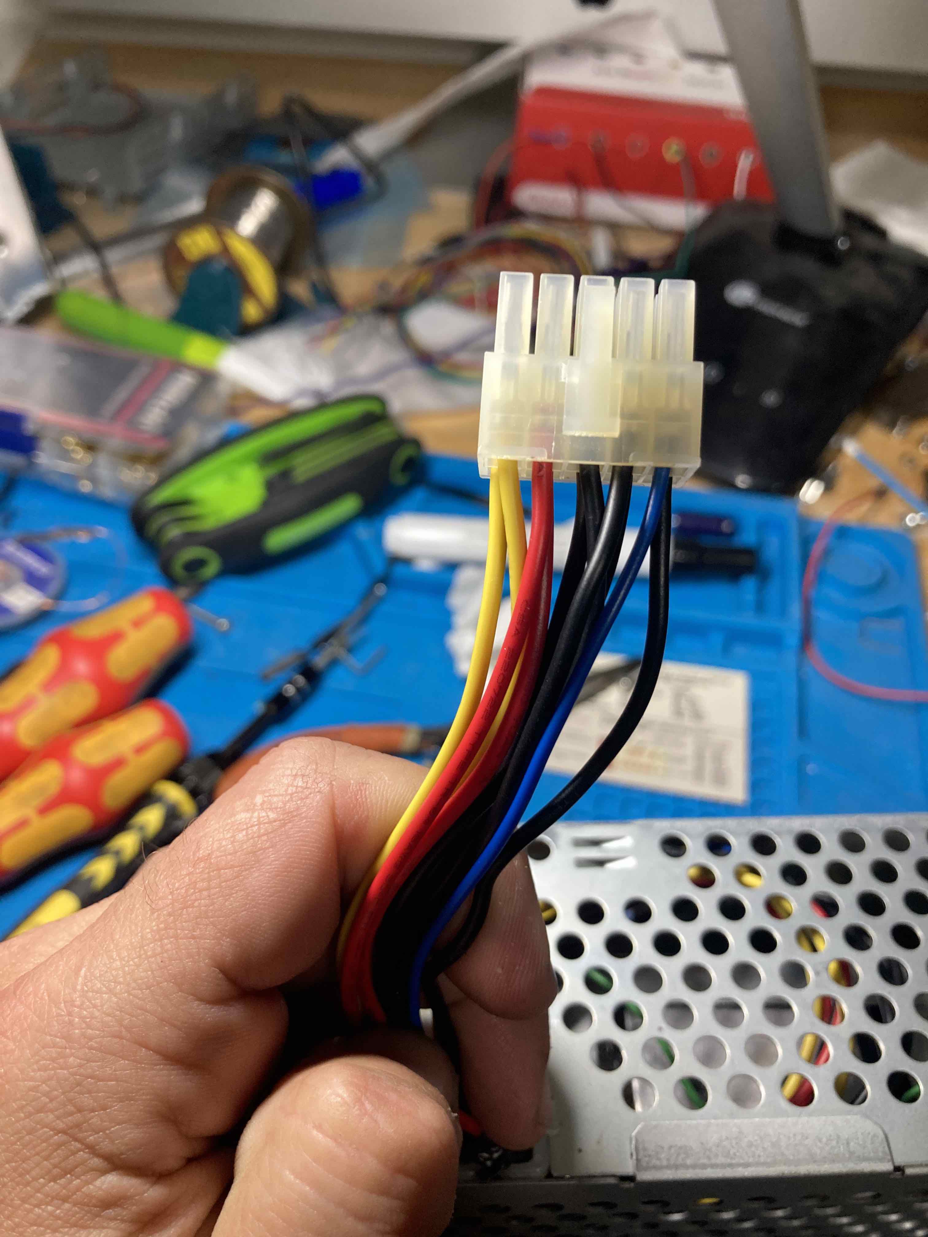

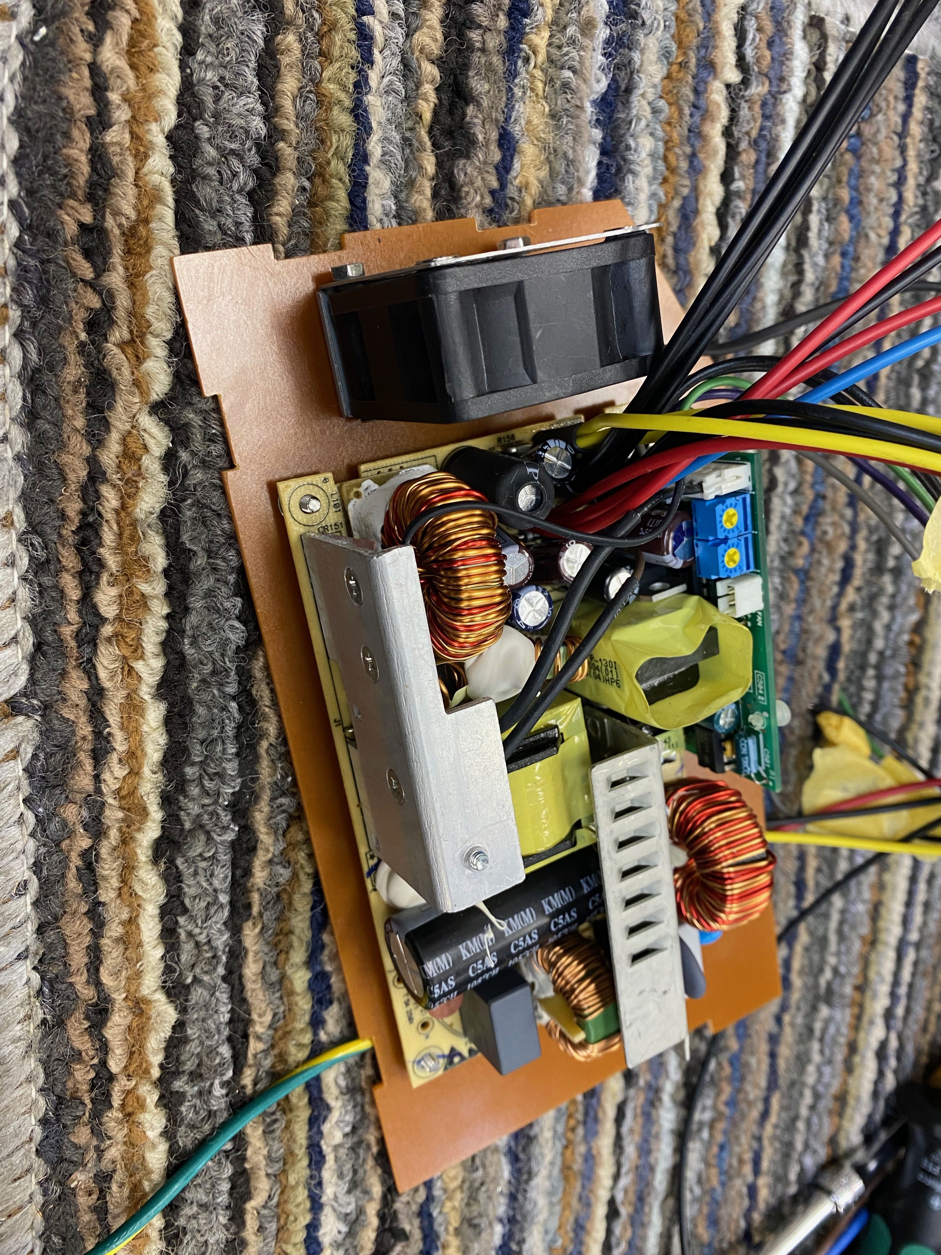

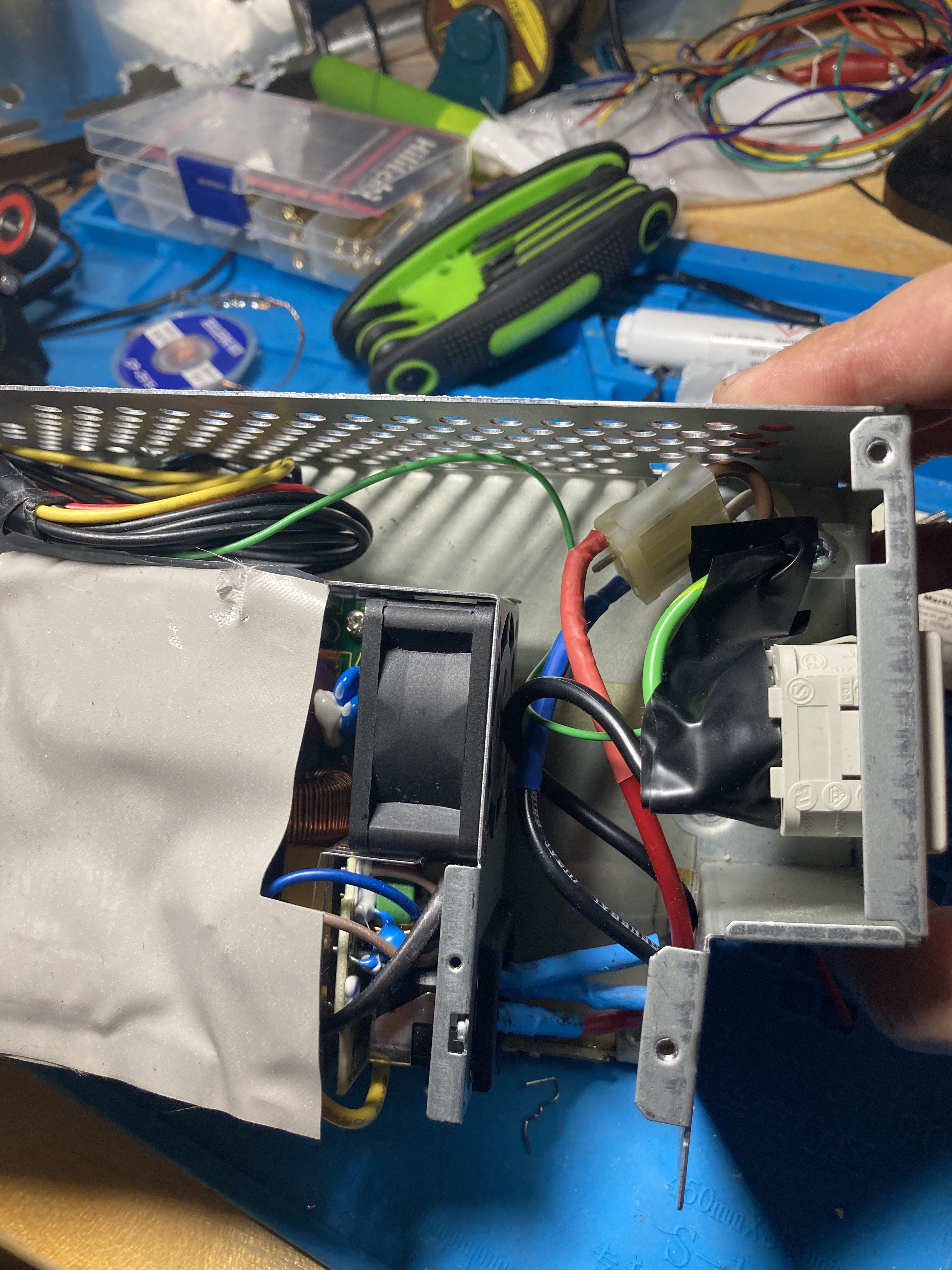

Hey all,
Just wanted to give an update.

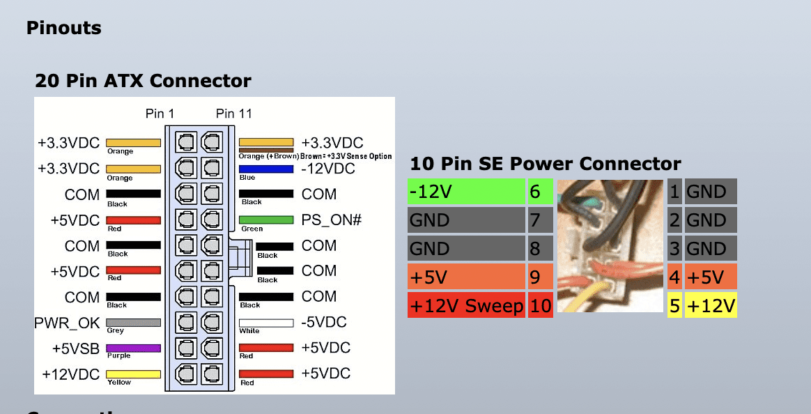

The thread on that other forum from 2018 contains photos that are no longer linked or the url's are down, so I had to cross reference the pinouts from here, thanks to Eric, JDW, and everyone else involved:

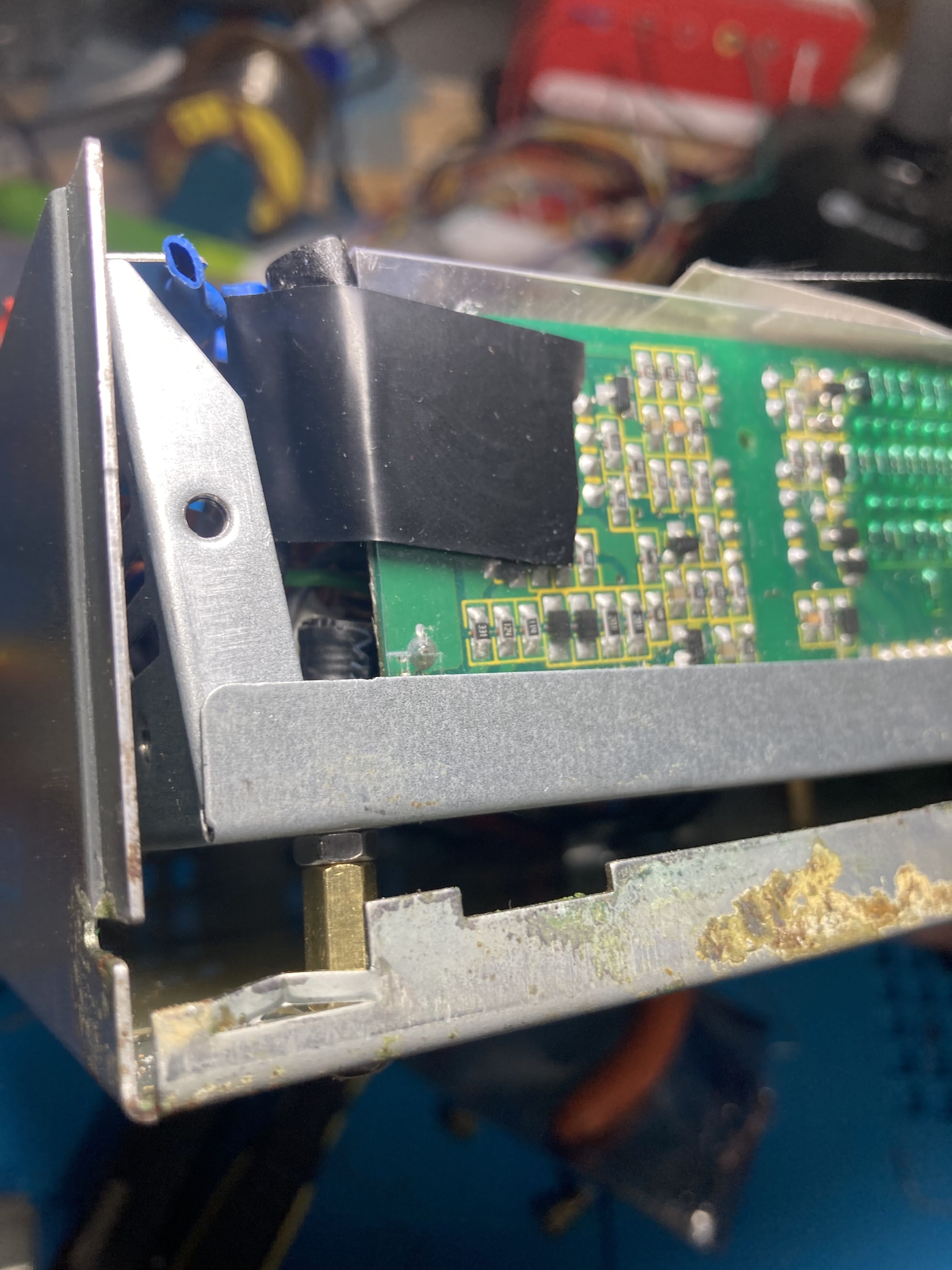

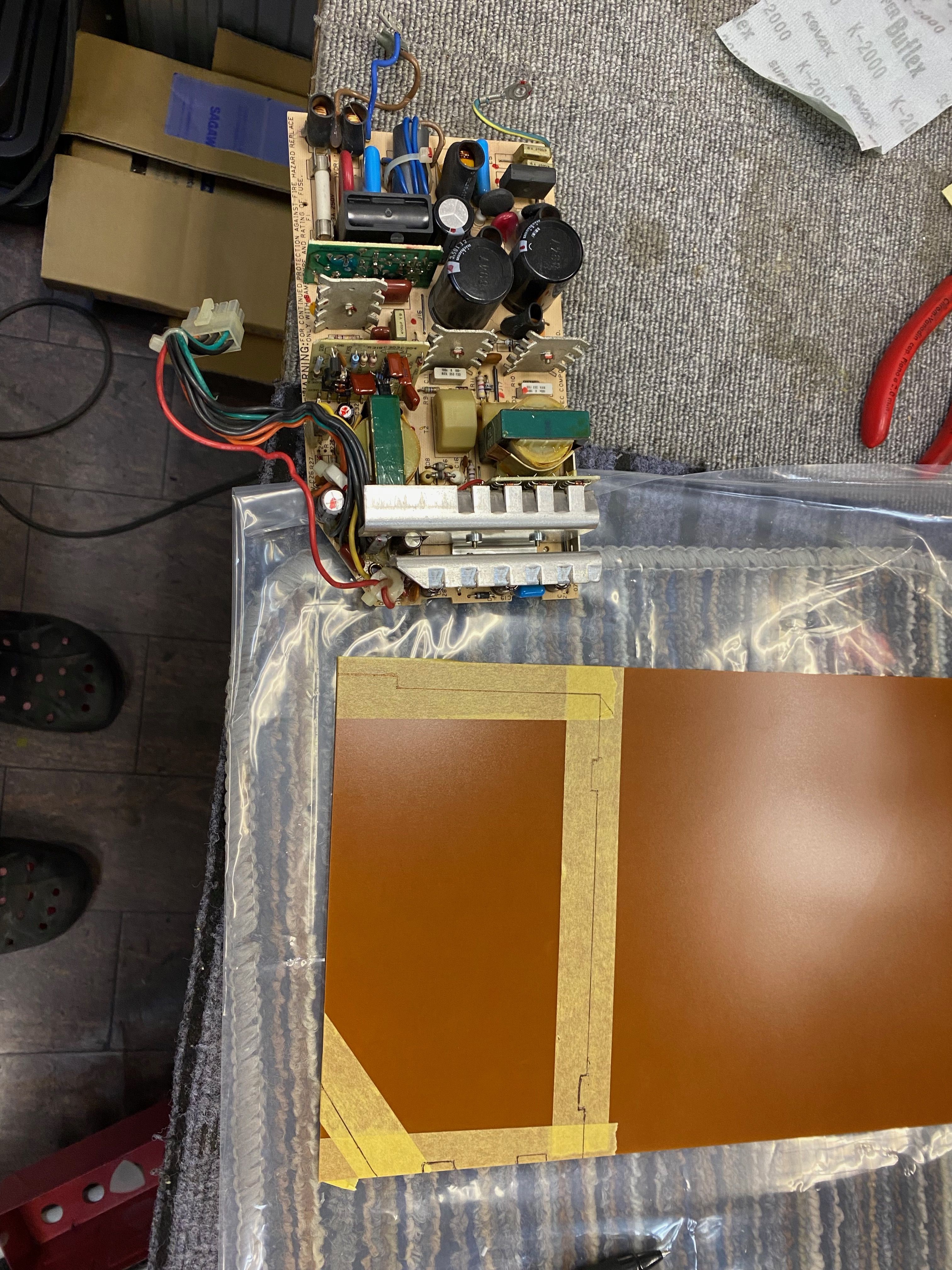

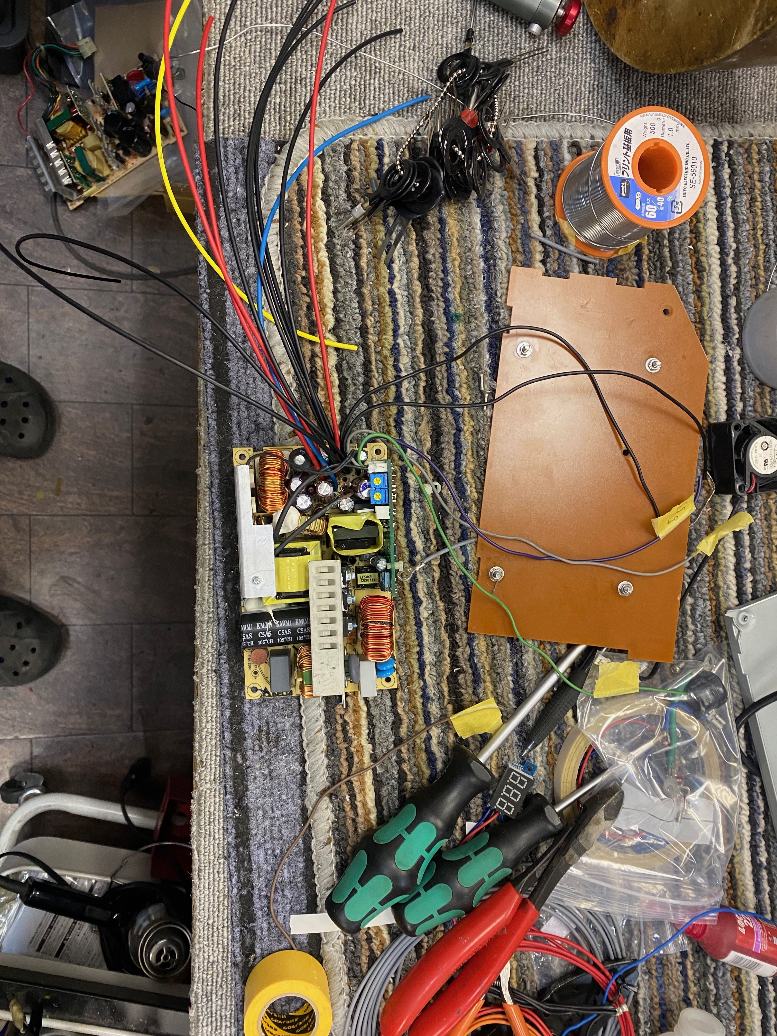

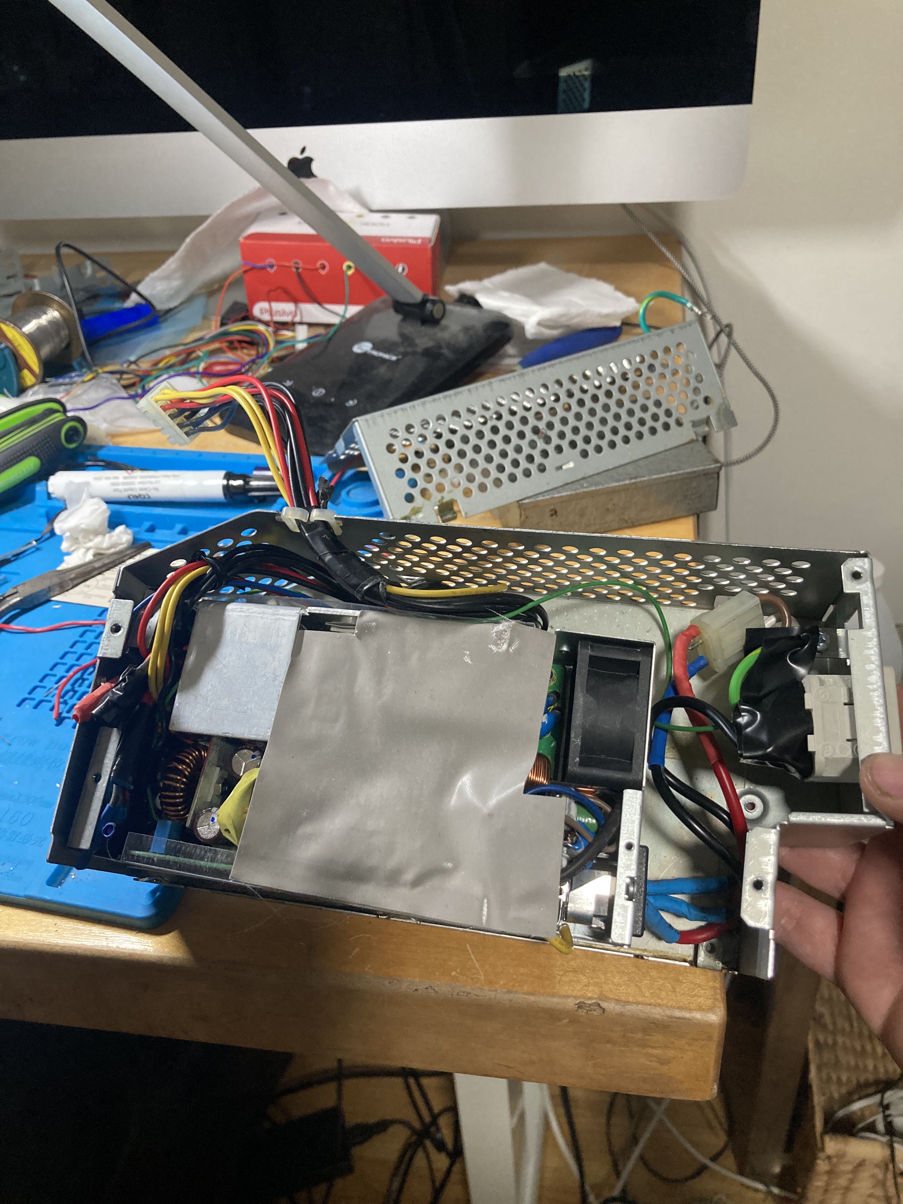

Here's some pics of the power supply installed.
I used some brass standoffs from my MiSTer build parts, I drilled out two small holes in the bottom of the original PSU case to mount it inside, left off the seasonic's top cover plate but I reapplied the heatsink sheet for some reason I'm not too sure since it doesn't actually mate up flush to the top of the original case. I soldered the green PSU on wire directly to ground terminal on the case. I also cut away and heatshrinked all the extra wiring I didn't need from the seasonic, since this psu I bought doesn't have the modular removable connector. I was originally going to desolder the wires from the seasonic directly, but when I got in there I noticed there was solder over bundled large gauge crimping, and tbh I didn't want to dig out my dad's old weller solder gun from the 1960's...
Anyways, I just finished recapping the analog board for this SE/30 I will swap this analog board along with this seasonic PSU into my SE/30 that works to test and report back.
