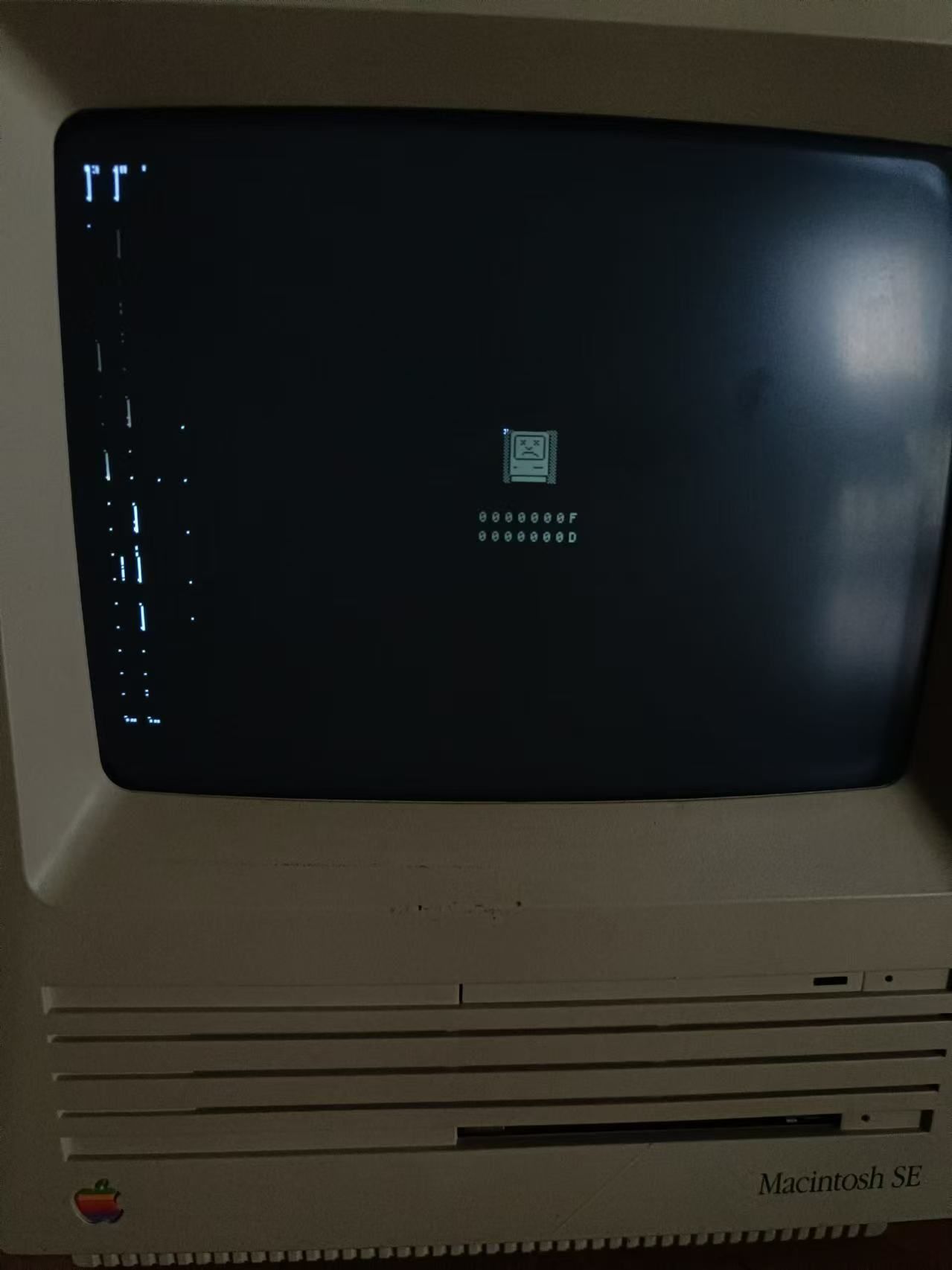

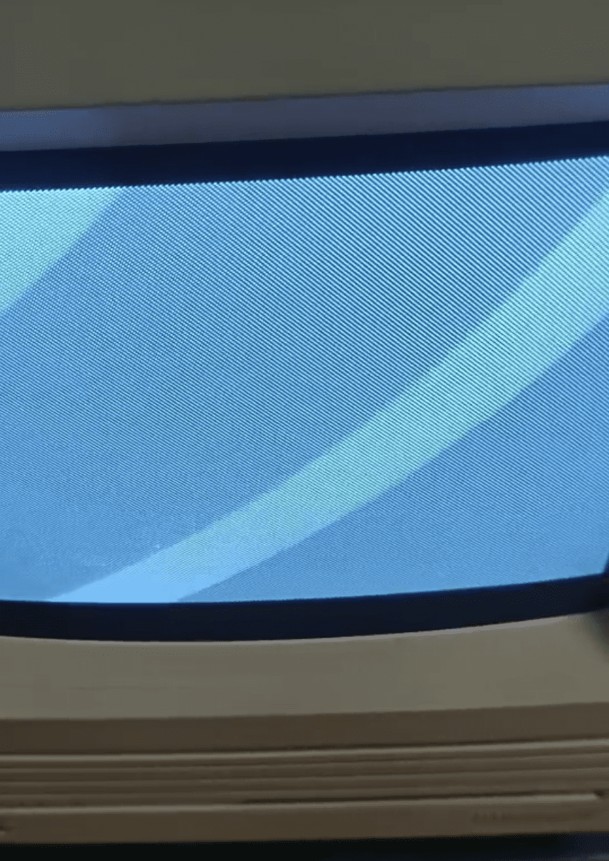

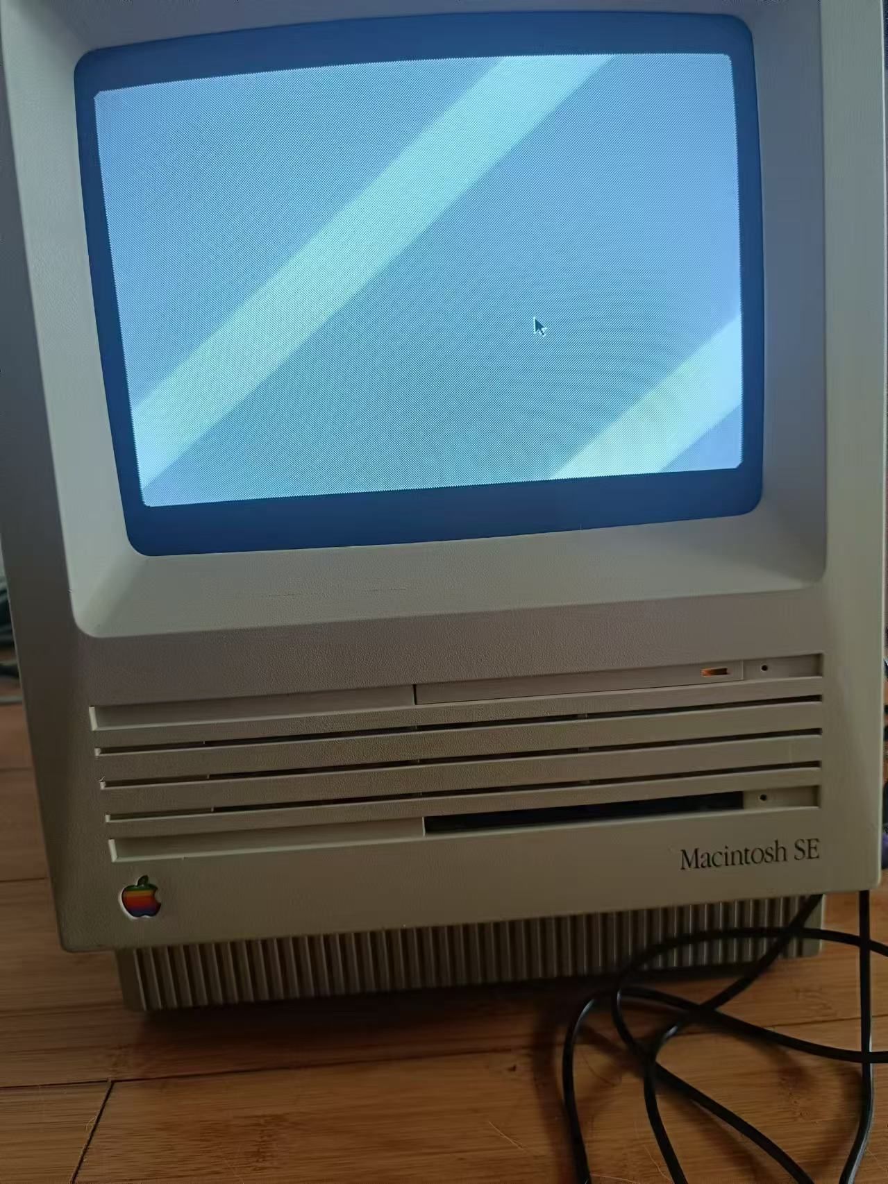

Hi, I signed up for this forum because of my Macintosh. When time pasts, there're three problems appeared, worse and worse. The first problem is shown on the first image. there're only mouse on the screen, and the inside card disk light is always on, also the BlueSCSI. And I tried to make a system in BlueSCSI. It did work, but for few more minutes, it started to crush. Debugger opened automatically, and can't be closed. While I was searching for how to use it, a white rectangle appeared on the center of the screen, and can't do nothing. When I restart, there became the second problem. You can see it on image 2: there're no mouse, and the machine RESET(just like pushing reset bottom) automatically, and the "beep" sound also appear when it reset over time. I tried to use multimeter to determine the voltage for the external floppy drive. The voltage with +5V is 4.985V, and for +12v, one is 12.256V, one is 12.254V. Unfortunately, I have no more time to determine. I notice that the third problem came(also can be sen=en on image 3). Unhappy face appear, and soon whit pixels appeared from left to right, and the speaker make crack sound. (the picture is taken just when the situation began). What should I do next???

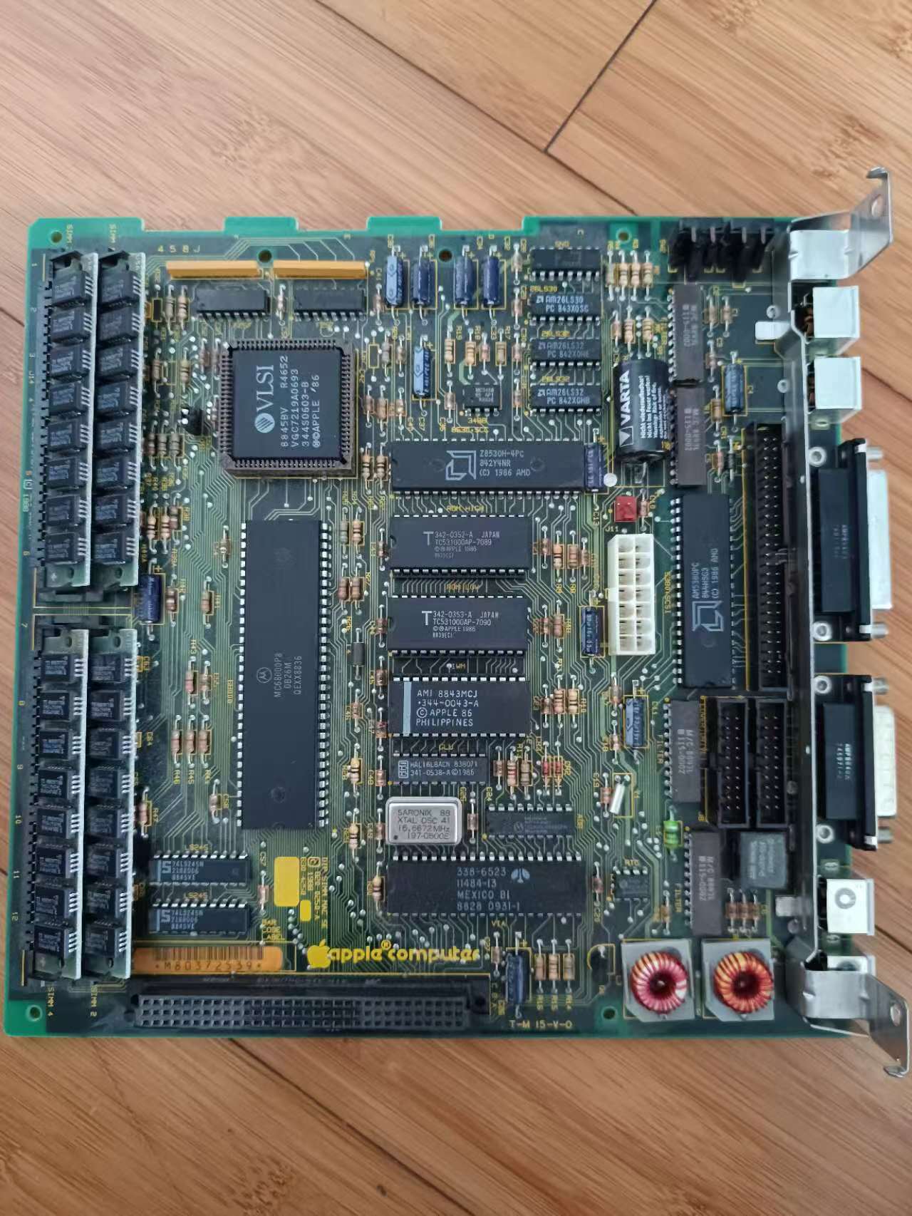

This is my motherboard, and I only replaced one gear in the floppy drive's eject motor.

If I understand right it means your logic board, analog board,and power supply are all still "original" with no work done to them, right? If so, it might be time to grab your soldering iron, it's very likely the capacitors have started to fail and have to be replaced.

Lastly, your motherboard photo is low resolution, so I cannot see any possibly damage, but your metal bar looks pristine. I don't see rust. That's good! Your VARTA PRAM battery probably never leaked. But it surely is dead by now. So what you need to do is take wire cutters (nippers) and cut the leg on either side of that battery to remove it. Obviously, do that with the motherboard REMOVED and not powered. After that, put it back together and test. Probably will still show the same problems, but I want to hear how it reacts without that ancient PRAM battery connected.

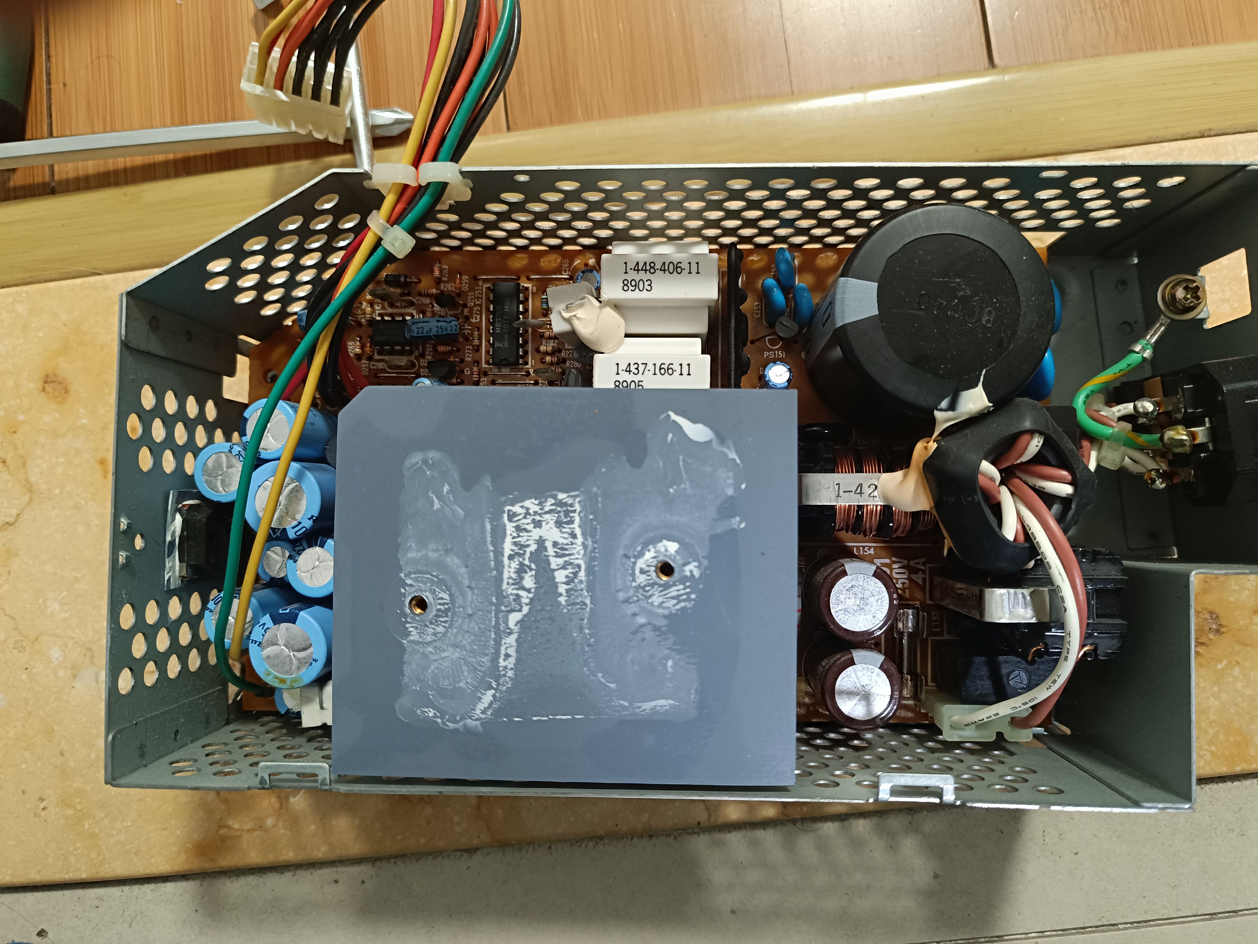

Wow, thanks, I'll follow your advice. I'll first replace the battery and have a look. Then I'll have a look at the power supply. If there're anything wrong, I'll say and take photos. Thanks :) I think I can remove the speaker and test.
HI, I remove pram, but it's still. I determine C36,it's 1.7V, C34 is 0.6V, while two of others are 5V, are there anything wrong.

Hi, this is the power supply. It looks well

Things, sounds different. After I replace the power supply, check it carefully, and clean the logic board, the floppy disk face with question mark appears again. I restart for a lot, and am sure that nothing will change. However, all the method I tried can't work. Floppy disk, internal hard disk, external hard disk. I even changed more than 3 systems. but with floppy disk, the ❌ mark on the floppy disk always appear. Even if I replace all the other drive. With hard disk, it also can't be read. What should I do???
