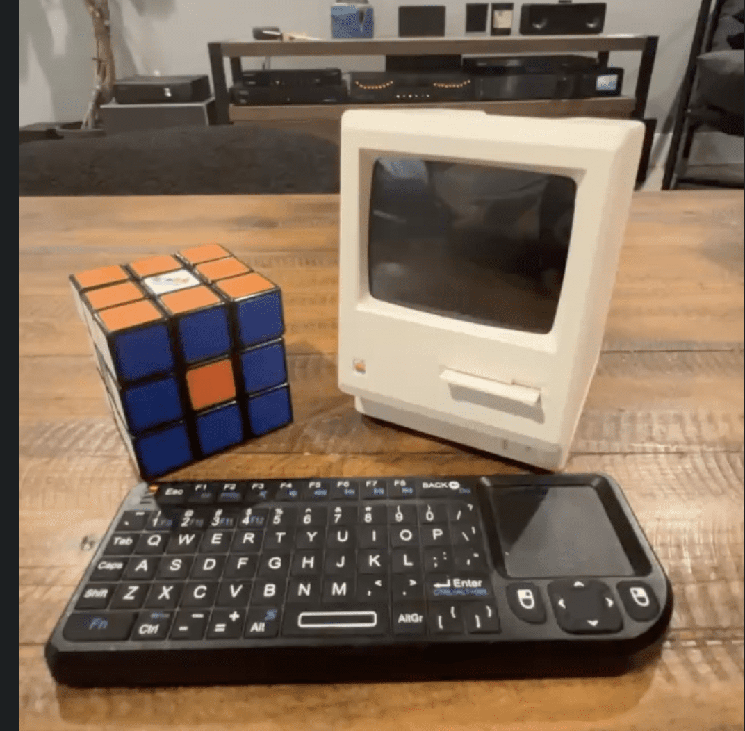

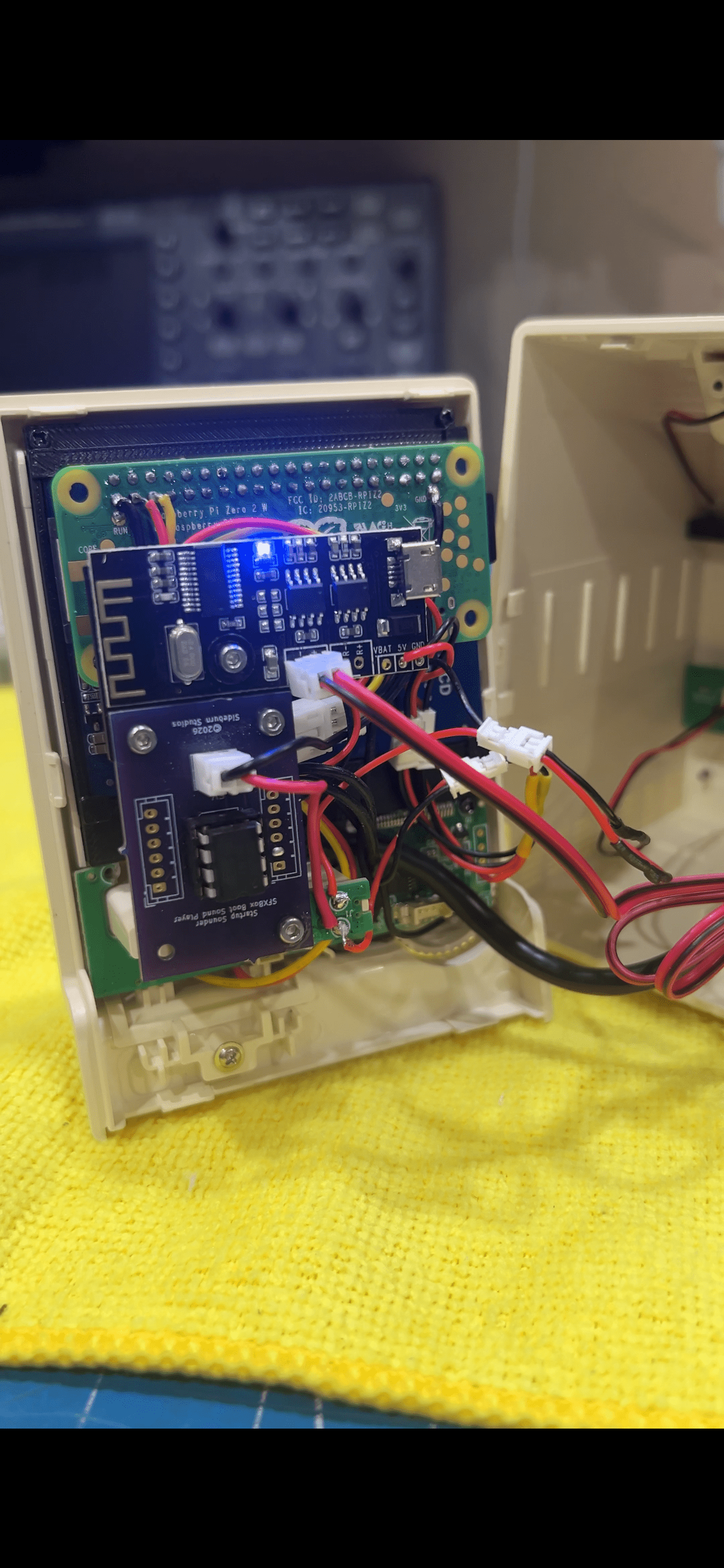

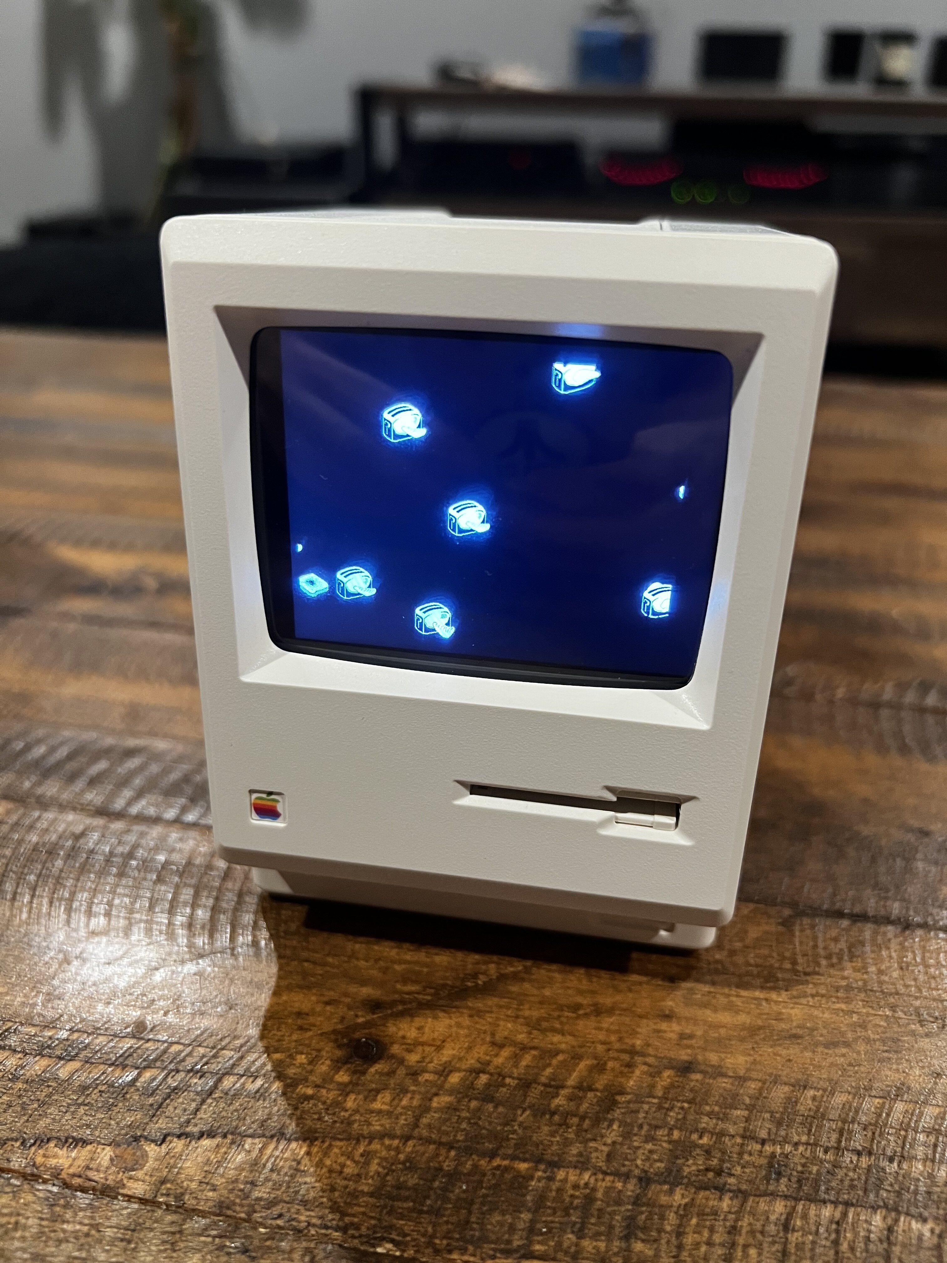

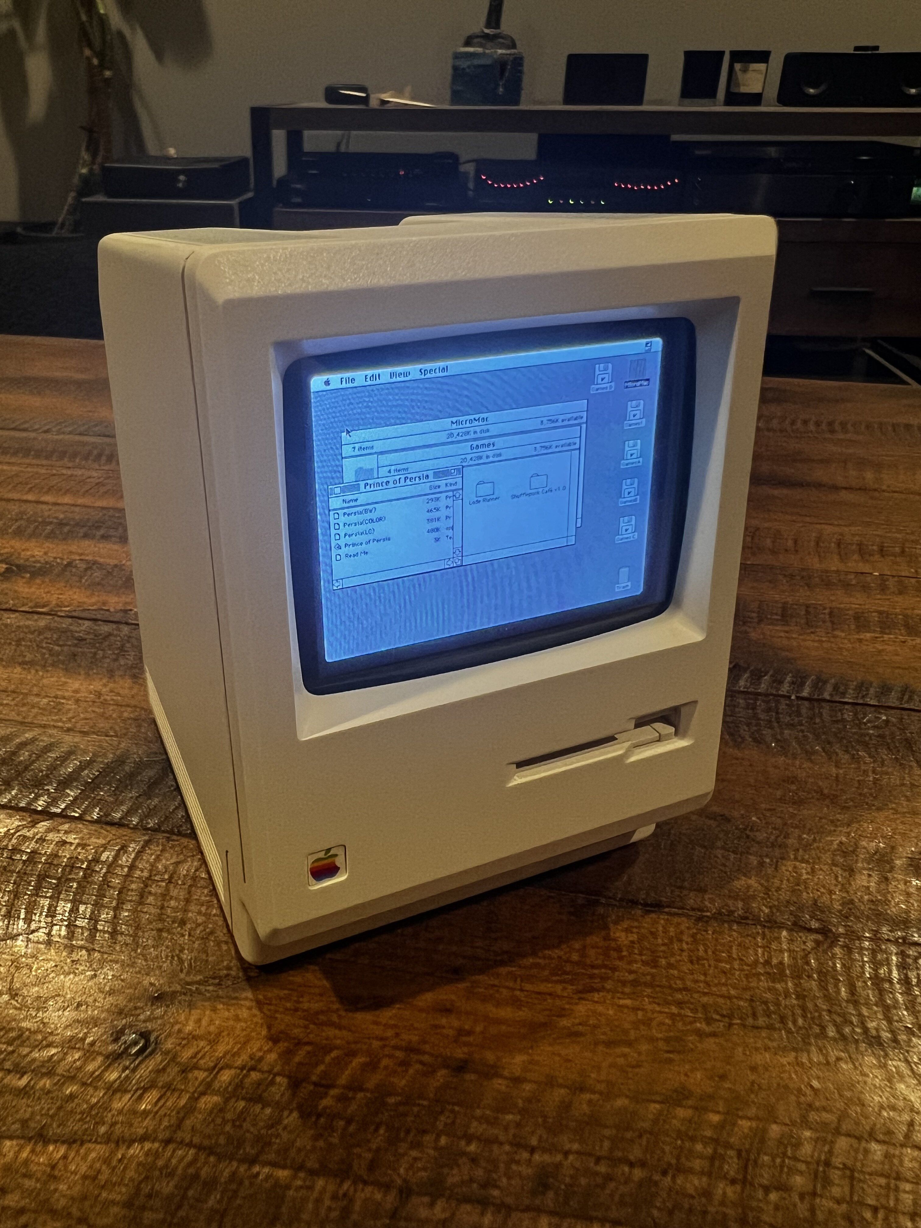

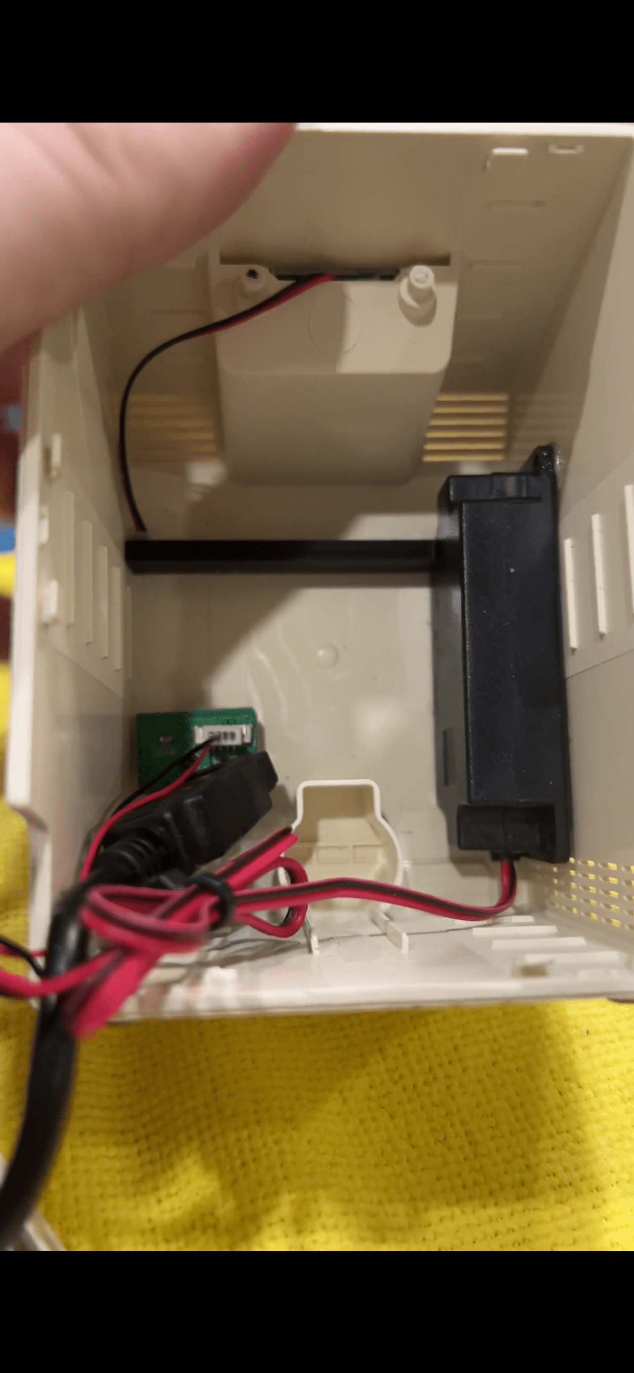

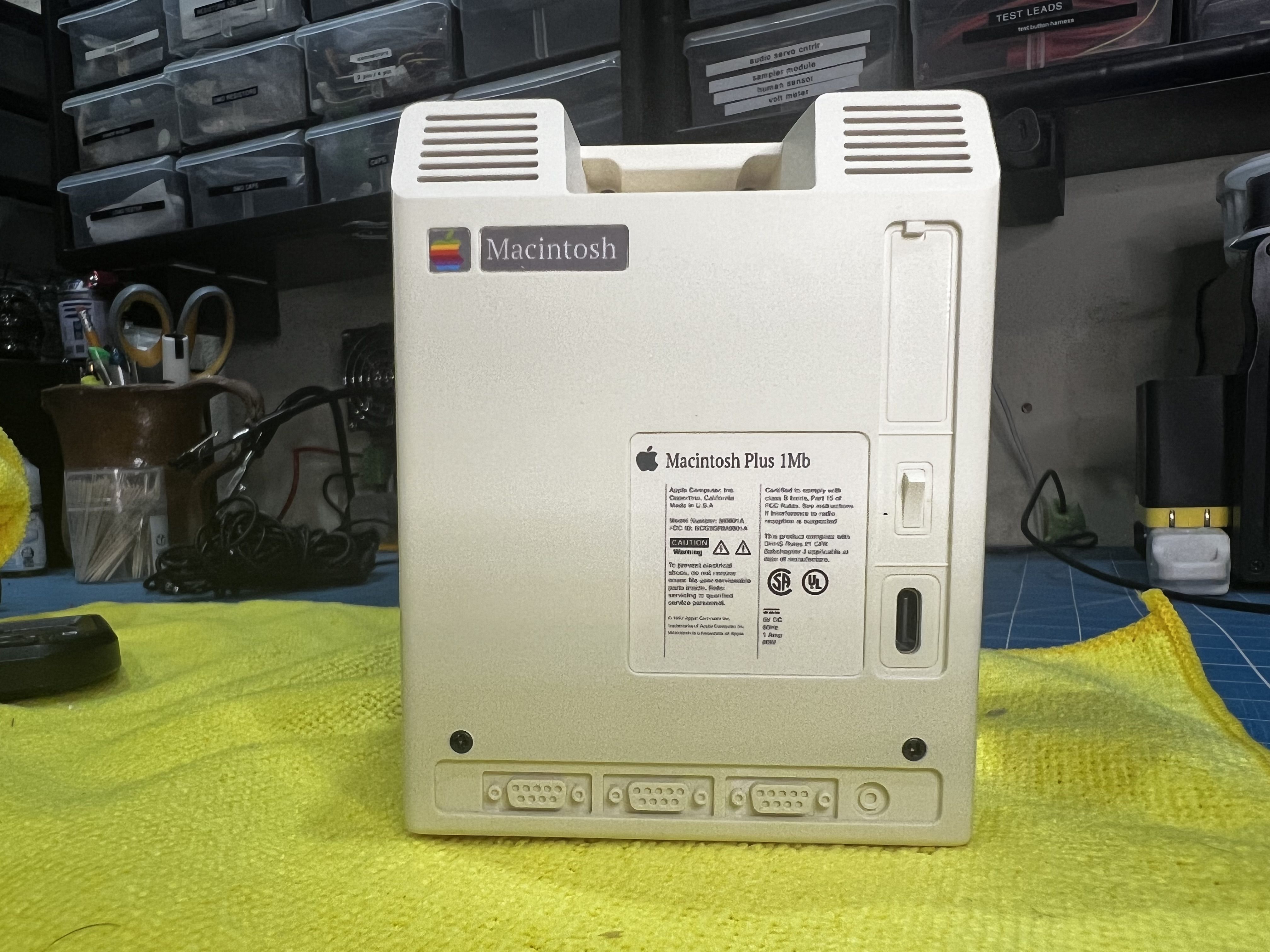

Hey all,
I think I am finally done with my rendition of a MacClock Hackintosh. I spent way too much time on this 🤣
I made a post in the Marchintosh thread but this one is more detailed and now it is finalized.
I'll be making a build video soon but here is a youtube short:
my additions:
• Boots straight into Mini Vmac
• Proper Screen scaling and positioning to match authentic Mac Plus (no need to use the existing LCD bezel).
• Button under the front are functional (restart Vmac & shutdown Pi).
• Inserting and ejecting the "floppy" powers it on and off.
• Custom power up chime when "floppy" is inserted.
• Buit in speaker & bluetooth circuit with amp (auto connect).

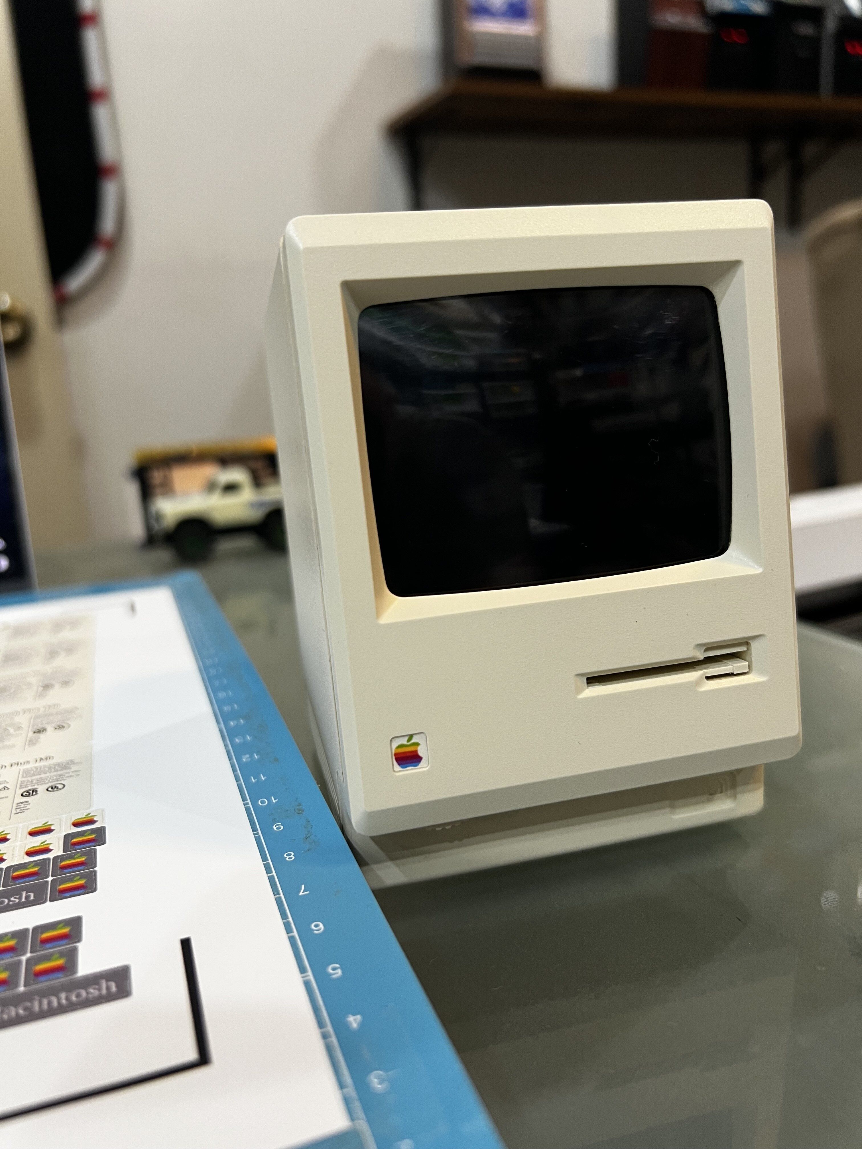

• Custom made stickers (no mac branding on my sticker set so I had to make my own, made the large one a replica of Mac Plus).
• No mods required to the plastic case. Everything drops in and bolts together (speaker mounts utilize the Faux screws on back, LCD bracket uses case screw holes).

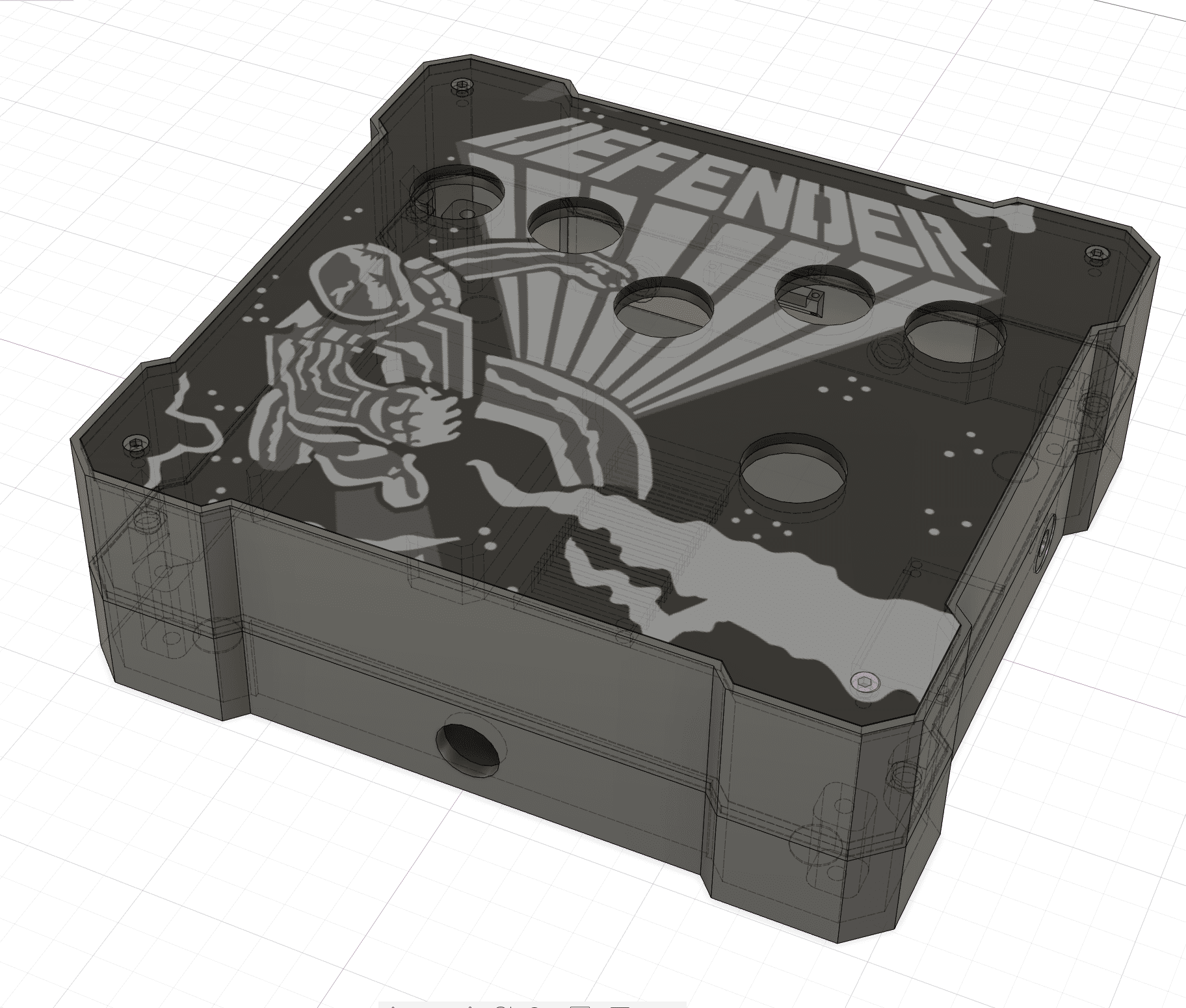

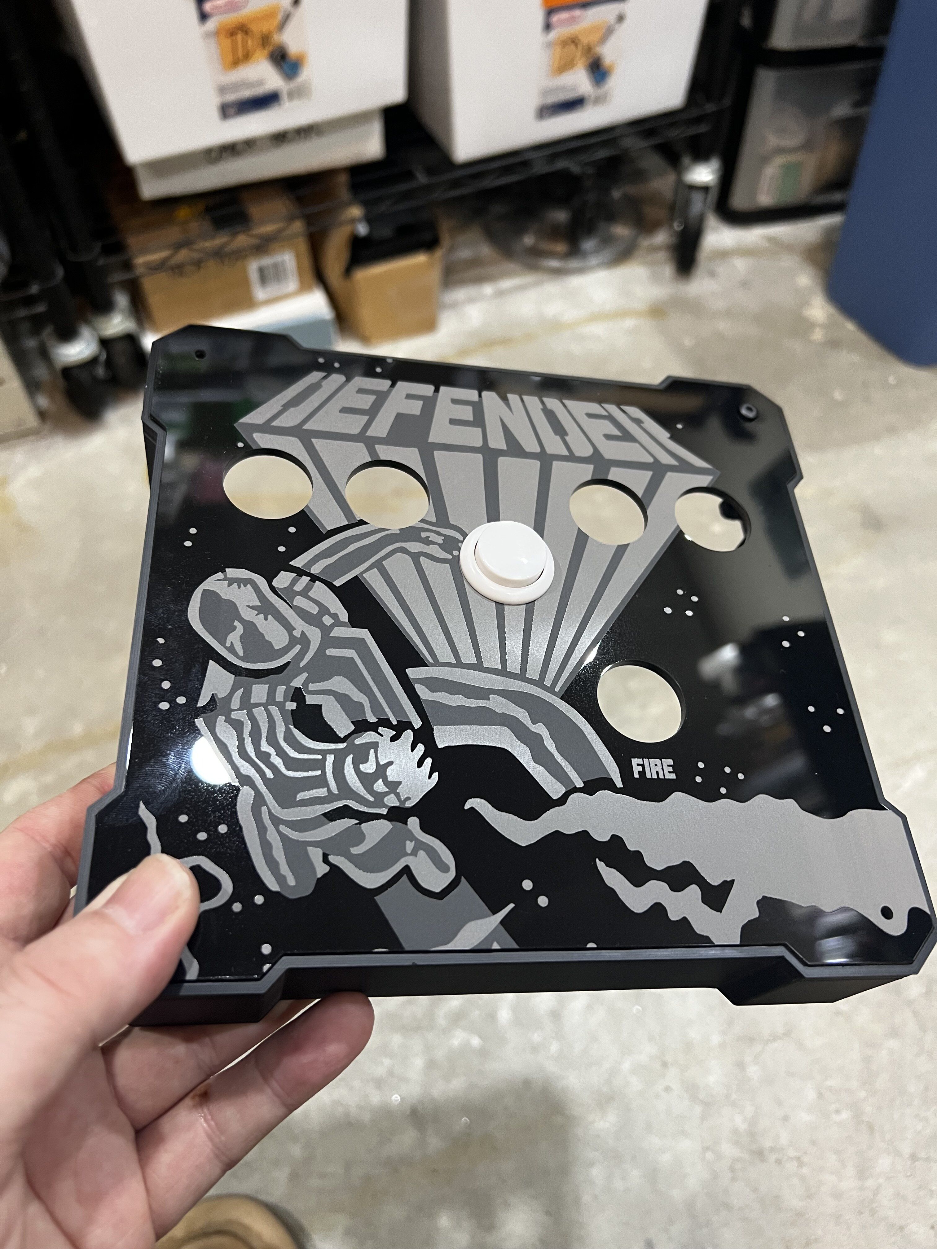

oh I thought it was a device that played a pre-programmed sound when it received power (startup sound)
It is on this. Funny coincidence but in this case it’s actually generating the sound with loops and pwm driving the speaker.
but the Actual reason its called a startup sounder for the SFXbox is it was designed for this Williams arcade sound player thing I’m making and when you power THAT one up this board pill trigger one of the built in sounds on the Defender board (the insert coin sound or something) so in that case the ATTine is just pulling a pin low to GND.
Burton this Mac mini it’s actually generating the sound. So by coincidence the name of that PCB works in both cases 😆
