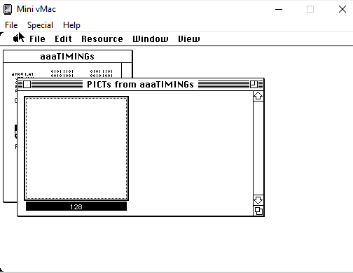

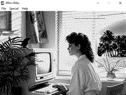

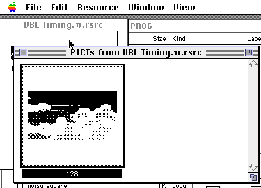

No, I'm just using Photoshop CS 2 to convert to gray-scale, then 1 bit (diffusion dither) while playing with contrast brightness to influence the result before switching to 1bit.
Then, it's export to PICT, transfer to basilisk. Edit in resedit to give it file type PICT, open in Superpaint v2 and copy & paste into a resource file in resedit.

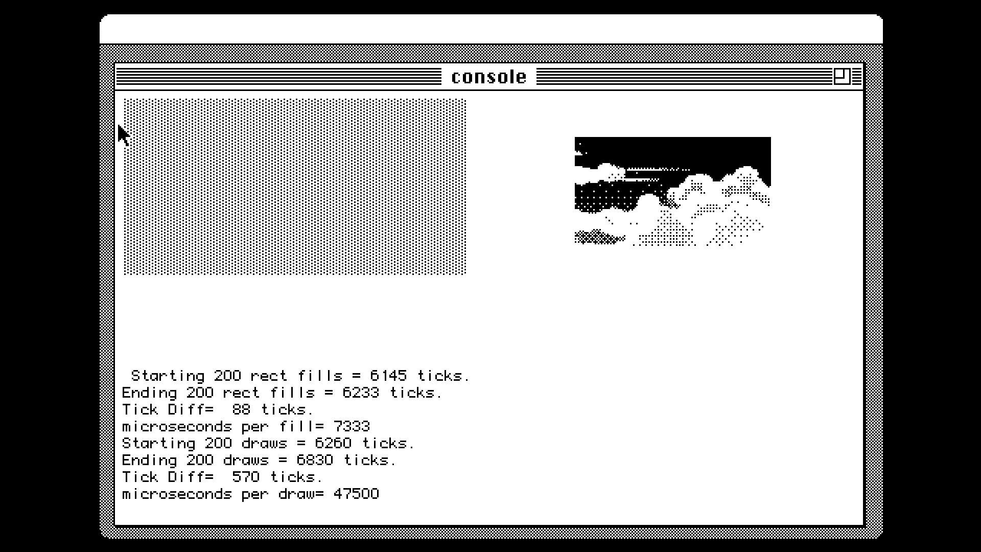

Target machine: Mac Plus or other similar 68000 compacts
Goal: offer less-than-fullscreen graphics drawing that beats copybits and does something blockmove can't do since it can copy non-continuous orderly chunks of graphical data without requiring it all to full-width like blockmove would need it to be.
Feel free to demolish/support my assumptions:

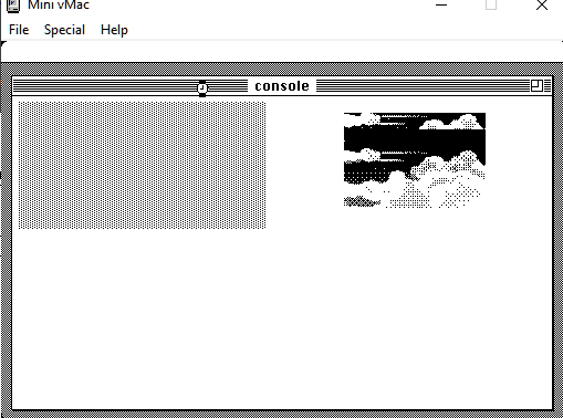

gives this:
instead of this:
you can kind of see the structure of the black area at first, but it gets skipped over quicker and then gets into garbage pretty fast. I've tried every combination of skipping faster/slower. I'm checking that the crucial move.w (a0)+,(a1)+ moves up values the right way under the monitor and yes, it increments the address values of both by exactly 2 bytes every time that line executes.

yields this:
perfectly normal, since I have to stop doing move.l source,a0 in @startofline to stop myself from feeding a0 a now stagnant address that never gets pushed on, only the post-increment (a0)+ will push a0 along now, so
Change 2: I put that line only once before the loops:

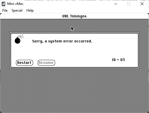

uhhhhhhhhh...............................what.
Oh, you want DBRA not DBEQ there. DBEQ says “first check if condition code Z is true and if so, stop looping, else continue unless the counter has run out”. You just want to loop until the counter runs out, which is DBRA (equivalently DBF ... “never stop looping unless the counter has run out”). I can’t instantly see why this is giving you the result it is, but I’m pretty sure that first DBEQ will start blitting the next line of the source bitmap anytime you move over 16 white pixels, which is of course not what you want.
If that doesn’t fix it, there is something weird happening and I will try your code myself.
And sorry you’re right about my misinterpretation of #2. My brain refused to see that you were doing it differently than I would. 😊 Not to be annoying but your way is slightly slower because you are doing the extra “MOVE.L dest,a1” once per line. If you just use a single dest register and increment it by 0x30 once per line, you can delete that MOVE.L (and free up a register — also by the way, you should ensure THINK its putting all those variables in registers, and consider blitting 32 pixels at a time instead of 16 by changing the inner-loop MOVE.W to a MOVE.L and adjusting your counter to use longs instead of words).

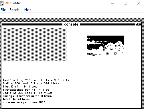

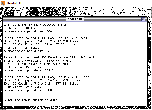

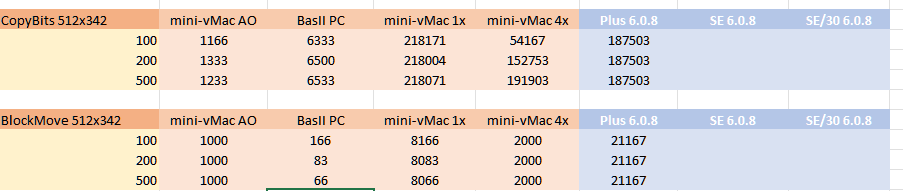

Early results (mini-vMac, Finder 4.1, under 1x speed):
ASM block copy with words (16bit) of a 128x72 bitmap, average of 100 times: 166 microseconds per blit (copybits was 14166 microseconds!)
ASM block copy with words (16bit) of a 128x72 bitmap, average of 200 times: 83 microseconds per blit (copybits was 14250 microseconds!)
ASM block copy with words (16bit) of a 128x72 bitmap, average of 500 times: 33 microseconds per blit (copybits was 14300 microseconds!)
I thought it'd be faster, but this is next level faster.
ASM block copy with long words (32bit) of a 128x72 bitmap, average of 100 times: 166 microseconds per blit (copybits was 14166 microseconds!)
ASM block copy with long words (32bit) of a 128x72 bitmap, average of 200 times: 83 microseconds per blit (copybits was 14250 microseconds!)
ASM block copy with long words (32bit) of a 128x72 bitmap, average of 500 times: 33 microseconds per blit (copybits was 14300 microseconds!)
absolutely no change so far. The real is gonna be later on real metal.

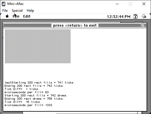

Oh, I see why the optimizations aren’t improving your timing.
Highly suspicious fact: Your benchmarks are always giving the same result. 100*166 = 200*83 = 500*33 ≈ 16600 microseconds = 1/60 second = exactly 1 tick.
Explanation: You are getting all these blits done inside the timing resolution of TickCount. 😊
Try increasing the number of bits until the total duration increases roughly linearly with # blits. Then measure the impact of optimizations from there.

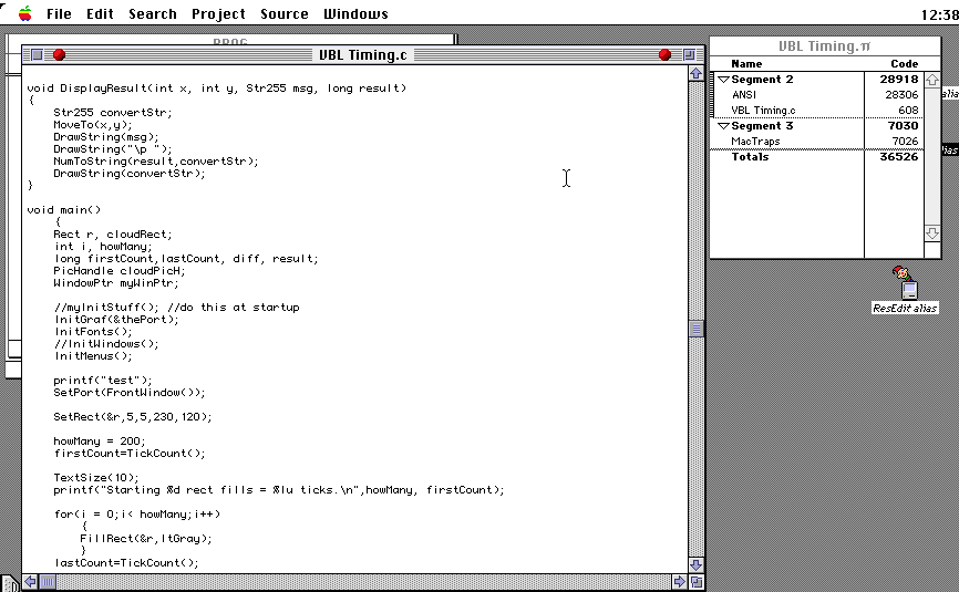

I'm an idiot. The move from C to asm remove the outer loop so I was always doing it only once.
I've set yet another register for the repeat loop control.
Also I read that I shouldn't use any old register freely to make sure I don't lose control as per:
so I replaced:
A0 -> A2
A1 -> A3
A3 -> A4
D0 -> D3
D1 -> D4
D2 -> D6
fun fun fun times refactoring the asm code that's now slightly repeated in 4 places

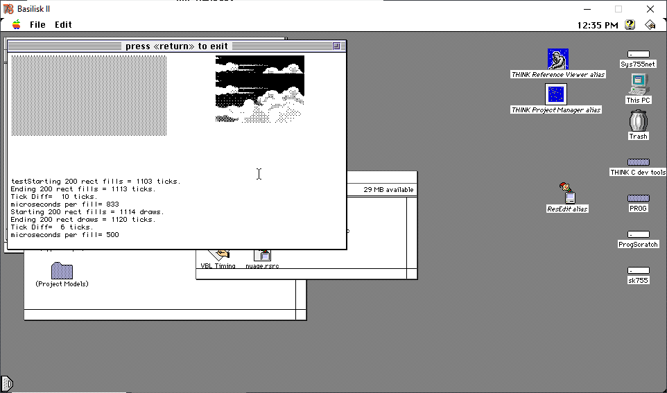

mini-vMac benchmarks at 1x speed:
16-bit - move.w
using a flexible reference pointer allowing for other sizes (aka +0x40 to go to the next line with that reference)
ASM block copy with words (16bit) of a 128x72 bitmap, average of 100 times: 3166 microseconds per blit (copybits was 14166 microseconds!)
ASM block copy with words (16bit) of a 128x72 bitmap, average of 200 times: 3083 microseconds per blit (copybits was 14250 microseconds!)
ASM block copy with words (16bit) of a 128x72 bitmap, average of 500 times: 3100 microseconds per blit (copybits was 14300 microseconds!)
ASM block copy with words (16bit) of a 128x72 bitmap, average of 2000 times: 3091 microseconds per blit (copybits was 14300 microseconds!)
using an inflexible reference and jumping to next line with +0x30, a hardcoded accounting for image width used
ASM block copy with words (16bit) of a 128x72 bitmap, average of 100 times: 2666 microseconds per blit (copybits was 14166 microseconds!)
ASM block copy with words (16bit) of a 128x72 bitmap, average of 200 times: 2750 microseconds per blit (copybits was 14250 microseconds!)
ASM block copy with words (16bit) of a 128x72 bitmap, average of 500 times: 2700 microseconds per blit (copybits was 14300 microseconds!)
ASM block copy with words (16bit) of a 128x72 bitmap, average of 2000 times: 2691 microseconds per blit (copybits was 14300 microseconds!)
32-bit - move.l
ASM block copy with longs (32bit) of a 128x72 bitmap, average of 100 times: 2500 microseconds per blit (copybits was 14166 microseconds!)
ASM block copy with longs (32bit) of a 128x72 bitmap, average of 200 times: 2416 microseconds per blit (copybits was 14250 microseconds!)
ASM block copy with longs (32bit) of a 128x72 bitmap, average of 500 times: 2400 microseconds per blit (copybits was 14300 microseconds!)
ASM block copy with longs (32bit) of a 128x72 bitmap, average of 2000 times: 2400 microseconds per blit (copybits was 14300 microseconds!)
ASM block copy with longs (32bit) of a 128x72 bitmap, average of 100 times: 2000 microseconds per blit (copybits was 14166 microseconds!)
ASM block copy with longs (32bit) of a 128x72 bitmap, average of 200 times: 2000 microseconds per blit (copybits was 14250 microseconds!)
ASM block copy with longs (32bit) of a 128x72 bitmap, average of 500 times: 2000 microseconds per blit (copybits was 14300 microseconds!)
ASM block copy with longs (32bit) of a 128x72 bitmap, average of 2000 times: 1991 microseconds per blit (copybits was 14300 microseconds!)

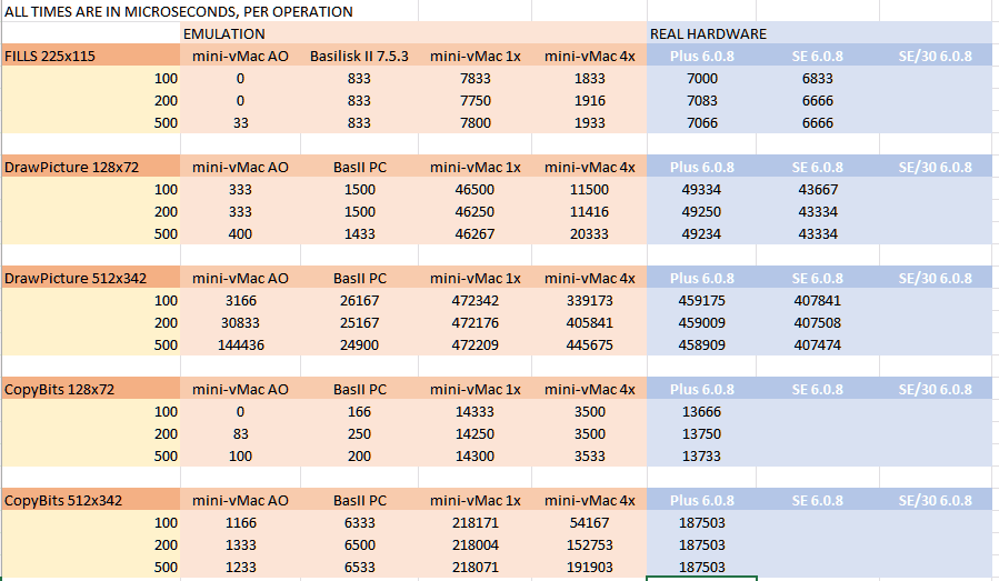

You are vindicated at every turn @Crutch :
1) going for 32-bit copying instead of 16-bit copying gives a roughly 35% speed increase
2) hardcoding the jump to the next line destination gives a roughly 15% speed increase
3) doing both gives a roughly 55% speed increase!
sideways takeaway: I can finally stop doing so many repetitions, 100x is plenty enough.
Nice and great to see the intuitive results match the benchmarking! This is a really nice project by the way.
Side note: in your asm code as you shared above, you were actually OK using a0, a1, d0, etc. Those registers are considered “trashable“ registers by the ROM and so can be nuked any time you call a Toolbox routine, but are guaranteed to be preserved within an asm block between calls to the Toolbox. (Because if you don’t call the Toolbox, and you never leave the asm block, no other code is executing between your asm statements … except maybe interrupts, which must preserve all registers.)
mini-vMac benchmarks at 1x speed VS real Mac Plus
16-bit - move.w
ASM block copy with words (16bit) of a 128x72 bitmap, average of 100 times: 3166 microseconds VS 3666
ASM block copy with words (16bit) of a 128x72 bitmap, average of 200 times: 3083 microseconds VS 3666
ASM block copy with words (16bit) of a 128x72 bitmap, average of 500 times: 3100 microseconds VS 3633
ASM block copy with words (16bit) of a 128x72 bitmap, average of 2000 times: 3091 microseconds VS 3616
ASM block copy with words (16bit) of a 128x72 bitmap, average of 100 times: 2666 microseconds VS 3166
ASM block copy with words (16bit) of a 128x72 bitmap, average of 200 times: 2750 microseconds VS 3166
ASM block copy with words (16bit) of a 128x72 bitmap, average of 500 times: 2700 microseconds VS 3200
ASM block copy with words (16bit) of a 128x72 bitmap, average of 2000 times: 2691 microseconds VS 3175
32-bit - move.l
ASM block copy with longs (32bit) of a 128x72 bitmap, average of 100 times: 2500 microseconds VS 2833
ASM block copy with longs (32bit) of a 128x72 bitmap, average of 200 times: 2416 microseconds VS 2833
ASM block copy with longs (32bit) of a 128x72 bitmap, average of 500 times: 2400 microseconds VS 2833
ASM block copy with longs (32bit) of a 128x72 bitmap, average of 2000 times: 2400 microseconds VS 2833
ASM block copy with longs (32bit) of a 128x72 bitmap, average of 100 times: 2000 microseconds VS 2500
ASM block copy with longs (32bit) of a 128x72 bitmap, average of 200 times: 2000 microseconds VS 2416
ASM block copy with longs (32bit) of a 128x72 bitmap, average of 500 times: 2000 microseconds VS 2366
ASM block copy with longs (32bit) of a 128x72 bitmap, average of 2000 times: 1991 microseconds VS 2366

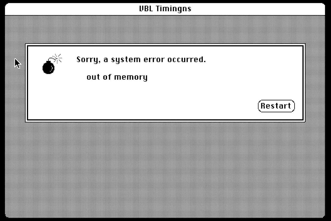

Also, rereading that thread again in this post:
particularly this passage from National Treasure @Crutch,
Also, you should not be calling CopyBits from a VBL task. CopyBits is on the list of “Routines that may Move or Purge Memory” in Inside Macintosh and therefore shouldn’t be called at interrupt time. (If you must use CopyBits you can set a flag in your VBL task and have your application’s main event loop check the flag and call CopyBits itself when appropriate.) If you roll your own bit blit routine by writing directly to the screen, you won’t have this problem, which is another reason to do it in your case.
Testing that idea out: I get flickering again, because I can't ensure that the graphic will be done in a timely fashion before the electron beam cuts through my CopyBits operation.
But I do confirm that doing CopyBits inside the VBL task will produce garbled graphics from uncertain RAM locations.
All I'm doing is doing CopyBits from global BitMaps that only contain total black or total white and I'm using a Rect to do the drawing (for black) and wiping (for white) oprations from these BitMaps to these locations.
I know this is moot since I'll eventually use my better ASM block copy function, but it'd nice to SHOW how CopyBits can be used and shown to be slower.
Am I relegated to CopyBits into an alt buffer during a frame, and switch to it every other frame? I made it work without that before, I don't remember how. I could dig up very old code.
