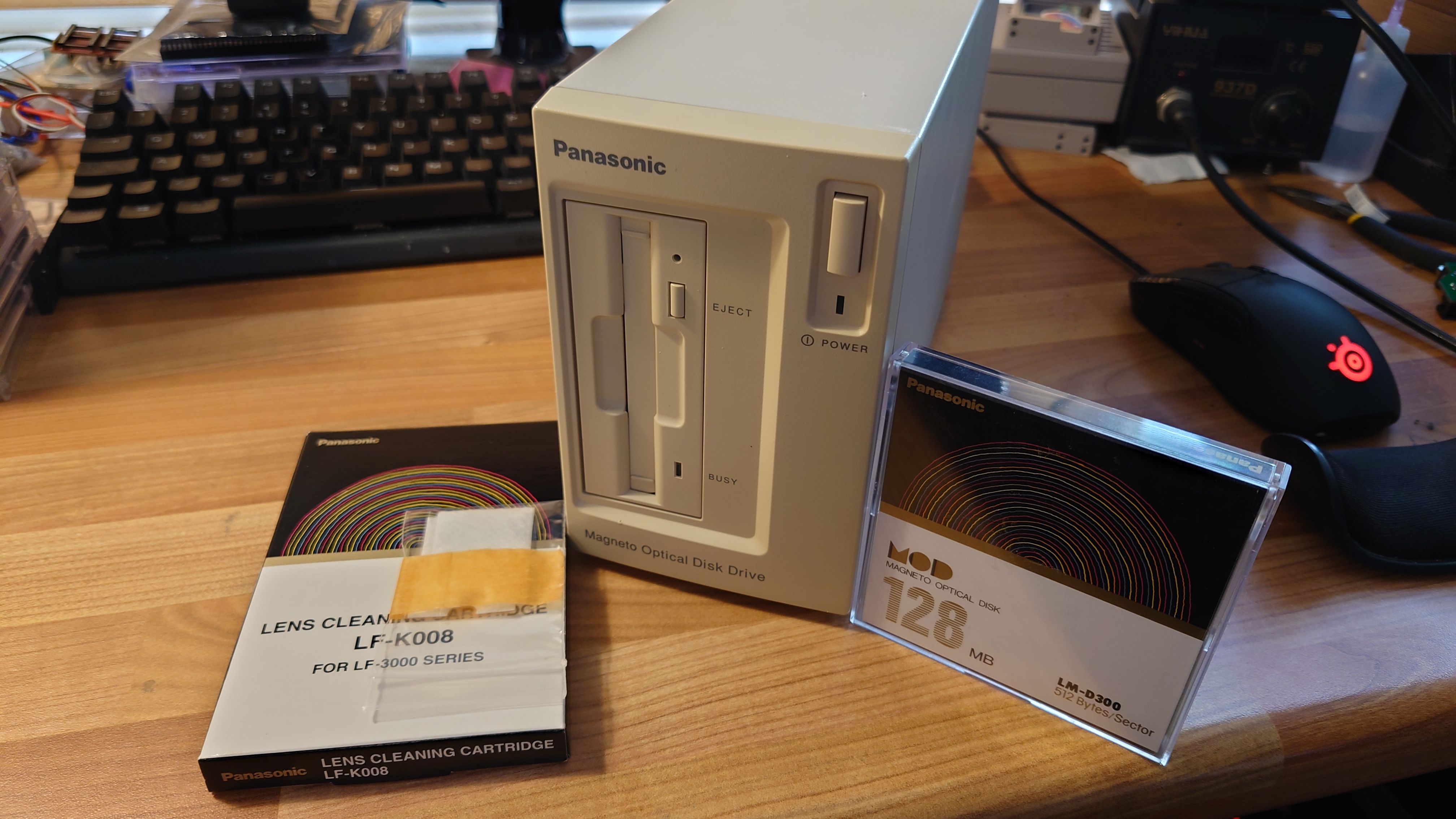

More Magneto Optical fun! This time, a Panasonic LF-3000E...
Kai Robinson
1,414
1,420
44
Worthing, UK
This is part of a haul that included a Macintosh 8100/100AV and a 15" Sony Trinitron Monitor.
It came with 5 x 128MB Cartridges, a cleaning cartridge and the manual and original SCSI cable. It's sooooo quiet compared to a ZIP drive, but about the same or slightly slower speed - 33MB took around 4 minutes to write to the disk. All 5 disks in the haul formatted just fine, and work without any issue. FWB Toolkit had no problems with formatting it, either.
Seems like media is still available for these drives, too.
It's my new favourite piece of oddware! :D

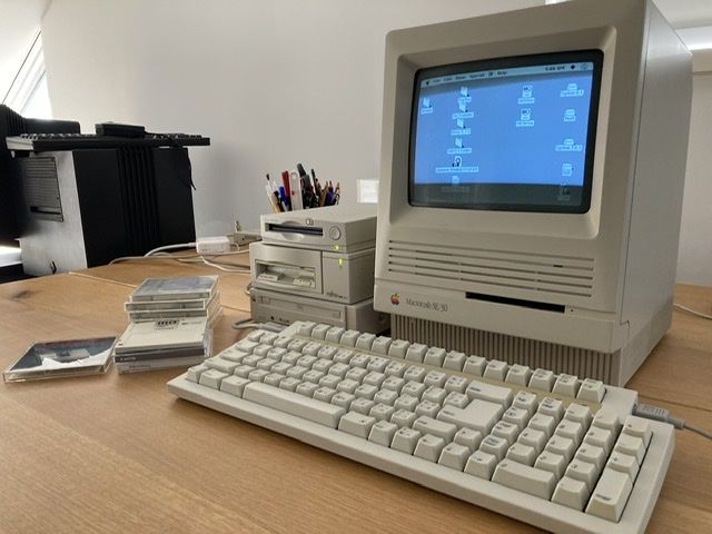

Hi All,
I recently managed to score a couple of MO drives for relatively cheap money.
In Japan (where I’m currently based), the format was very popular, so it’s indeed easy to find drives and blank media.
One drive has already arrived, the second one is on the way, both SCSI units from Fujitsu. I had no experience with MO drives (except with the father of them all, the one in the NeXT Computer…), so I trusted the vendor that was showing the disk mounted on a Mac desktop.
The first drive arrived in really excellent conditions, I would say “as new”.
And in fact, when I connect it to my SE / 30, everything works fine. I can even boot from the external disk.
So, everything cool, except for the eject function.

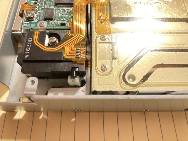

I just gave it a quick look, the issue lays in the mechanics of the eject mechanism.
As you can see from the picture, there’s a rotating cam, which acts on a pin, translating rotational movement into linear one.
Apparently, nothing looks damaged, just kind of snapped out of position (even though there seems to be a tiny gear train that I still have to inspect, but the cam always rotates back to initial position, so it should be OK).
As is now, as the cam reaches rearmost position (270 deg), the pin just slips under the cam and the sledge is abruptly pulled back to closed position by the action of the springs.
Seems to me that by fiddling with the mechanical eject and pushing the eject button at the same time, the whole mechanism went out of synchronization.
I’d need to see a working drive for figuring out a fix…

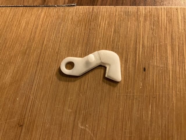

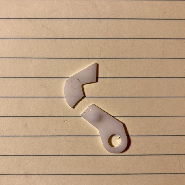

The loading mechanism is not remaining in open position because there’s a broken piece.
Fatigue. Such a lousy design I could hardly believe.
Will see if it can be reliably fixed.
Could 3d-print a replacement part :)
It’s of course a possibility, even though the cheapest way wold be to just get another drive. But I like fixing things, so I‘m considering options…
Baseline is made of POM, very sturdy plastic, so I doubt a 3D printed repalcement would stand a chance to survive.
The failed component is just a hook which keeps the loading mechanism open and gets released when a disk is pushed into the slot.
The “natural“ position of the mechanism is in seated position. When the disk is ejected, the eject mechanism lifts the sledge and the disk is free to get ejected by the action of a pre-loaded spring.
At that point, the mechanism would just get back to seated position, but the hook is supposed to engage and prevent it from closing.
The action of mechanically catching and stopping moving parts is like hammering and the design is so poor that fatigue failure is just a matter of time.
I’d bet majority of the surviving units have the same defect.
So, I think I will try to prototype a replacement out of some brass or aluminum sheets, as the failed part is basically 2D and just 1 mm thick. Ideally I should aim at laser cutting, but I’m not sure where to look at.
So, here’s the fix. The two pieces bonded back together with epoxy and laminated on top of a 0.2 mm Al sheet. The metal layer now bears the mechanical stress, the plastic pieces ensure the fit.

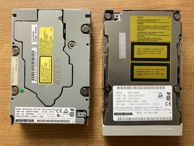

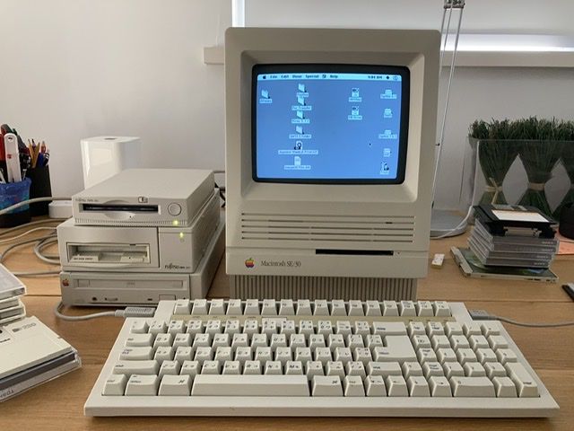

Two 640 Mb Fujitsu drives, MCF3064SS (Aug 1999, the one that arrived with broken gears), and a M2513A6R (May 1998).
They are now housed into Fujitsu 243 (fan less!) and 241 (very noisy fan) SCSI case respectively, both of which nicely match the “snow white” of the Macs.
Configuring the dip switches on the drive and on the external cases seems to be black magic, couldn’t find much documentation.
In the current status, one is being recognized as “Drive”, the other as “Optical”.
They both work, though.
However, the one recognized as “Drive” is much faster, don’t know if it’s just because it’s “better” or because of the configuration and / or the driver. I need to investigate further.
Anyhow, I like more the slowest one, as it’s better engineered, the other one is indeed built to cost.

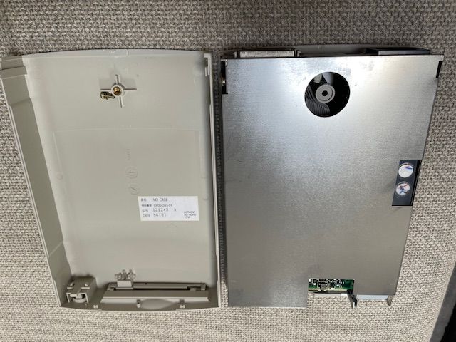

Since you were able to put the MCF3064SS in the fanless SCSI case, could you describe how this case can be safely opened without breaking any parts?
I have an external Fujitsu Dynamo 640 SD drive with basically the same case but which has a different coloring in a combination of blue/green.
See https://ru.pc-history.com/wp-content/uploads/scsi__mo-640sd1.JPG [1] for how it looks.
While i found the one obvious screw at the bottom and also the one hidden behind the rubber to its right, simply removing both screws and trying to carefully pry open the case appears to require more force than i dare to apply.
Judging by https://ru.pc-history.com/wp-content/uploads/scsi__mo-640sd_21.JPG [1] it is the blueish cover that is supposed to be removed.
But what is the not so obvious trick to prevent any physical harm to the enclosure?
[1] https://ru.pc-history.com/scsi-fujitsu-dina-640d-mo.html
Thanks Paolo B!
Your picture infused some confidence and finally allowed boldly opening the case without any damages.
The reason it required some more force to open the case was that some self-adhesive tape strips were applied at the two corners of the inner metal cover near the slot for media insertion, supposedly to hold the external cover in place. Not sure whether these tape strips were applied by already the manufacturer or one of the drive's former owners.
Since the enclosure design appears to be equal apart from the different colors there is not much sense providing any additional pics for illustration.
Finally this nice fan-less enclosure can be repurposed for another MO drive of larger capacity!
