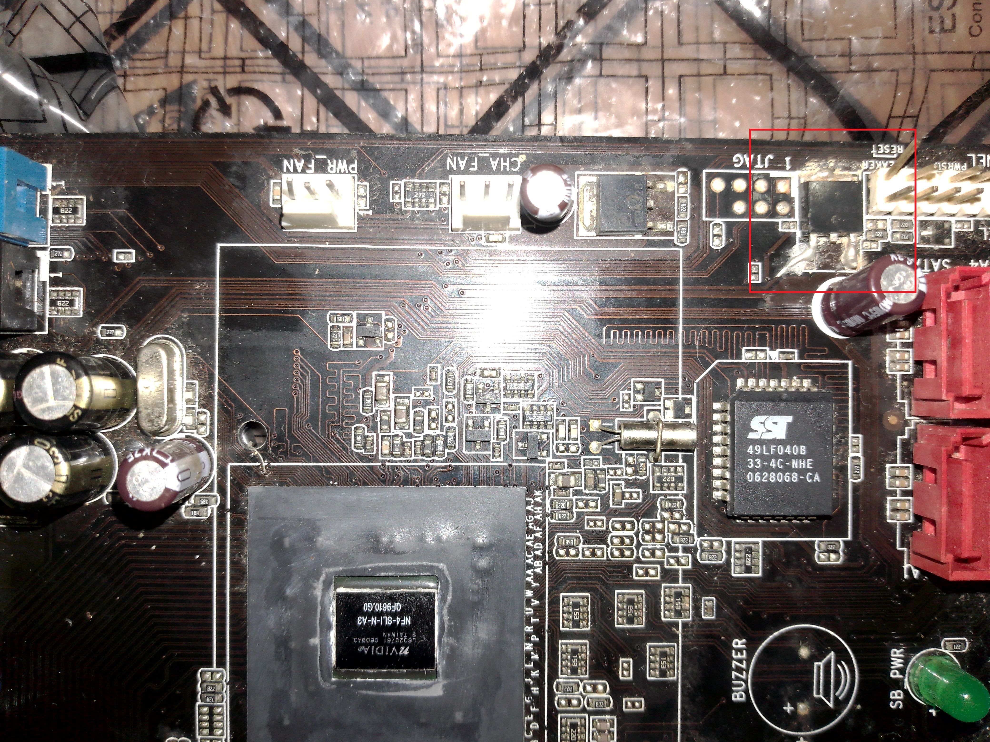

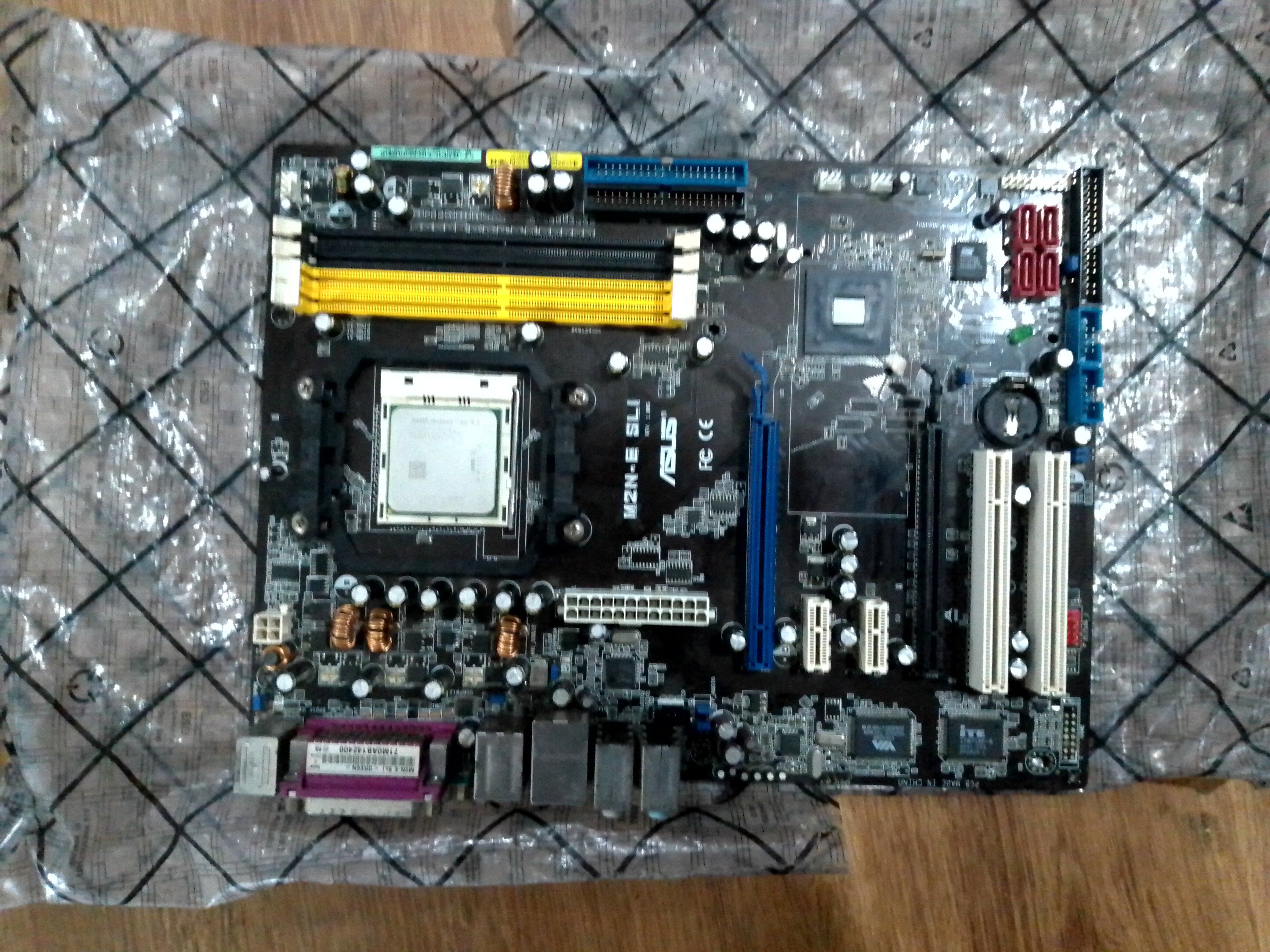

Hi there dident know what section put this under tho i thought id try here its bit newer then a 6x86 class machine anyways years ago my nforce 500 mobo decied to die one day i tried to resurect it using thermal cam spoted a mosfet on the board go bad tried to repacle it with a genecric one from a dead lga board dident work lost the fet and years ago tried to reflow that with a hot air station ive got some pics of the fet that the orginal suspect i put is a npn one think its a pnp. also cant find a board view file my model love to resurect this with some 680 sli goodness ;)
If anyone has one of these please tell me the fet part number, its the one with the red square and touge at the right angle :p

I wonder if it's possible to find a good high resolution image of the board, read the part number off it?
Hi Kai after hours and hours of searching google found a board view file for a similar revsion mines 1.00G theres 1.00GA turns out it's a P3055LDG N-Channel Logic Level Enhancement Mode Field Effect Transistor , have to rip the scope out do lots of trouble shooting with this, btw if you want that x1600 pro agp send me a pm with your details :)
