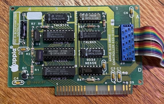

I believe this //e comes with one of these. But we might have others somewhere else.
Can someone share a pic of a smartport card please?

If you see the thread I link to it shows what machines and ROM's are compatible. It's a feature of your floppy controller card - I don't believe there is a SmartPort "card" per say (or i just dont know about it!)
Thanks Eric,
I'm afraid I'm not following then. I am aware of the ROM requirements for the //c but the //c has a 19pin port at the back. The //e does not. So I guess I would need a floppy controller card which is compatible. I checked the link you mentioned (Thanks) but I did not find mentions about the //e besides that it works with it.
My //e has the original controller card with the flat cables directly connected to it. The one at the museum has the newer version with maybe a 19pin port connected at the back - does that make it "smartport" compatible? :)
Sorry for not being too familiar with that area of the //e!
