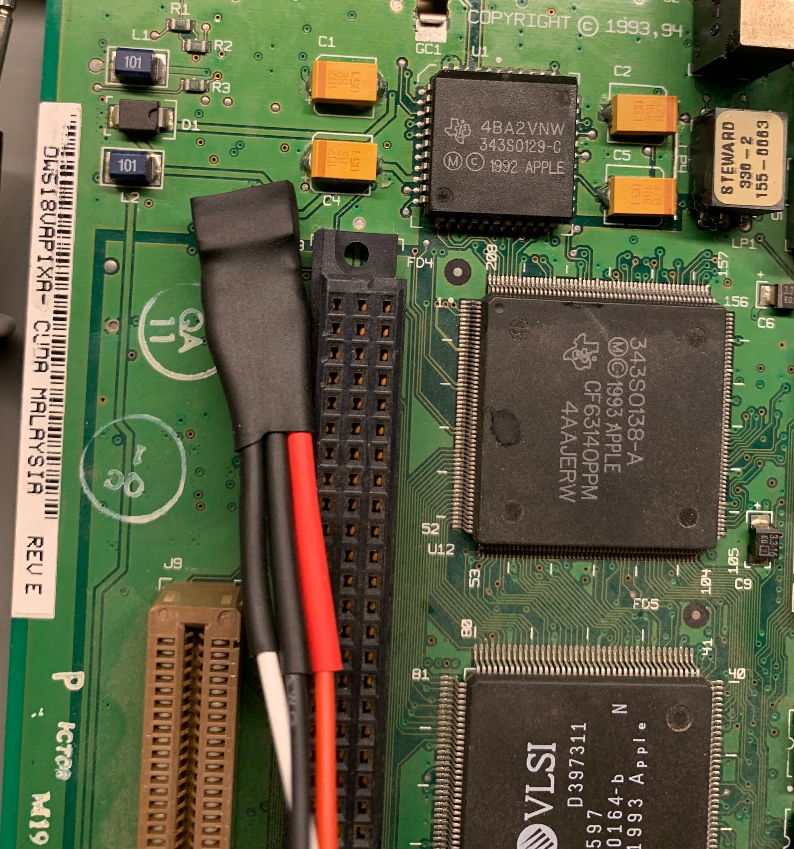

Yes, I managed to solve the snapping and popping issue. It wasn't the wire but something funky going on with the plastic housing (where and logic and analog board reside) and where it mounts to the front of the CC. It has some play in it and moving it while turned on resulted in the weird noises. I took everything apart, made sure all contacts were good and nothing was pinched and put everything back and haven't had any problems since.
Kay did reply and asked to make sure that the gestalt ID was set properly, which it was. Kay did the stereo mod some time ago and that Mystic is now a Takky. He currently doesn't have a Mystic with a stereo mod to check but he indicated that he does have the parts to do it.
Josh.
