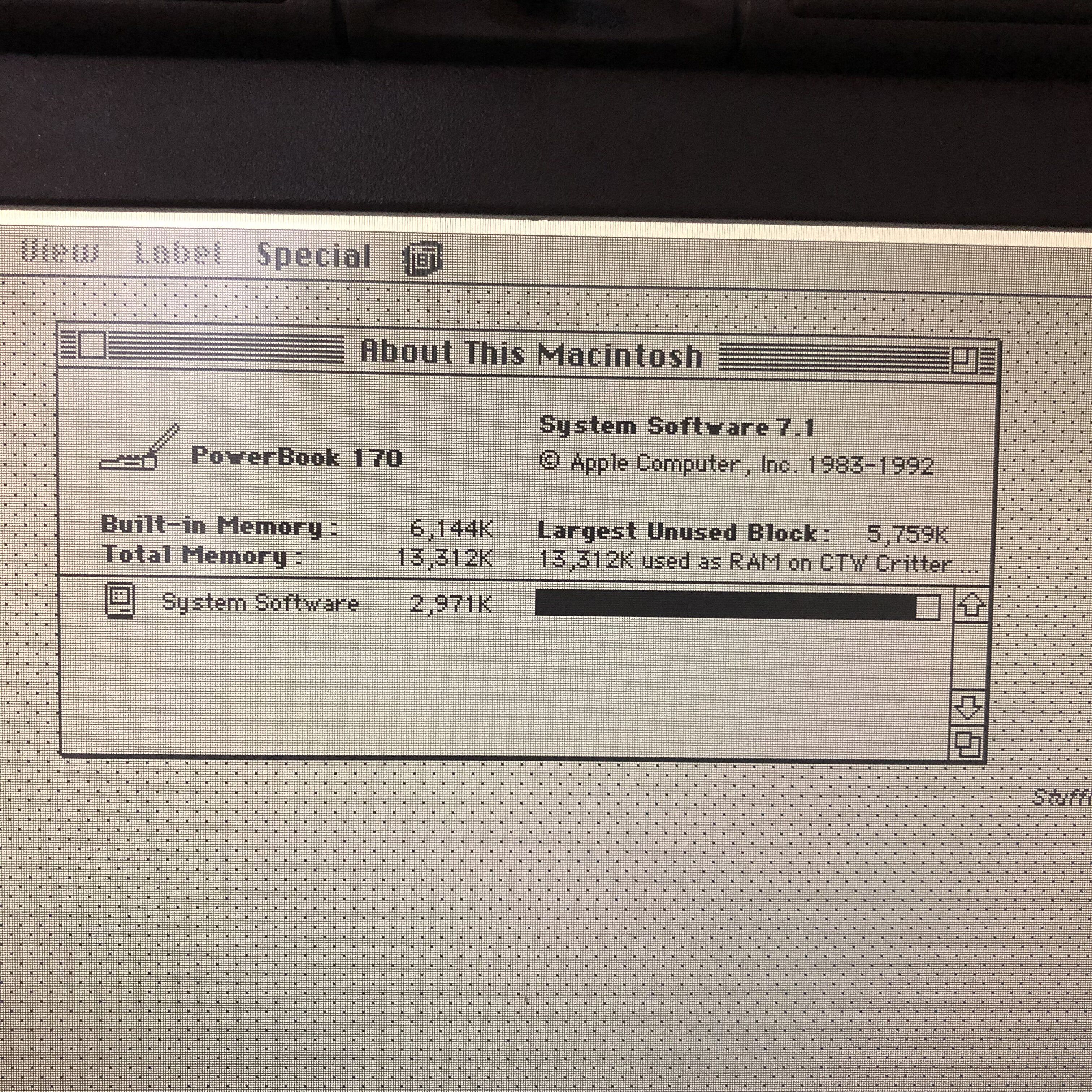

In the photo the tunnel vision is not evident, so it seems you were lucky. No need to recap the screen?
I guess you're using some RAM software doubler, right?

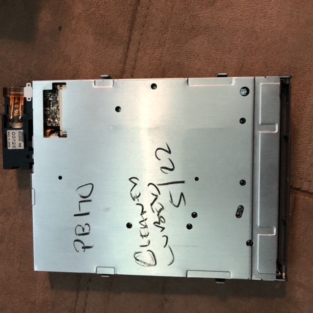

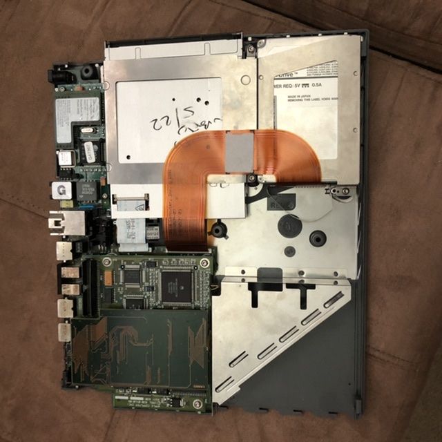

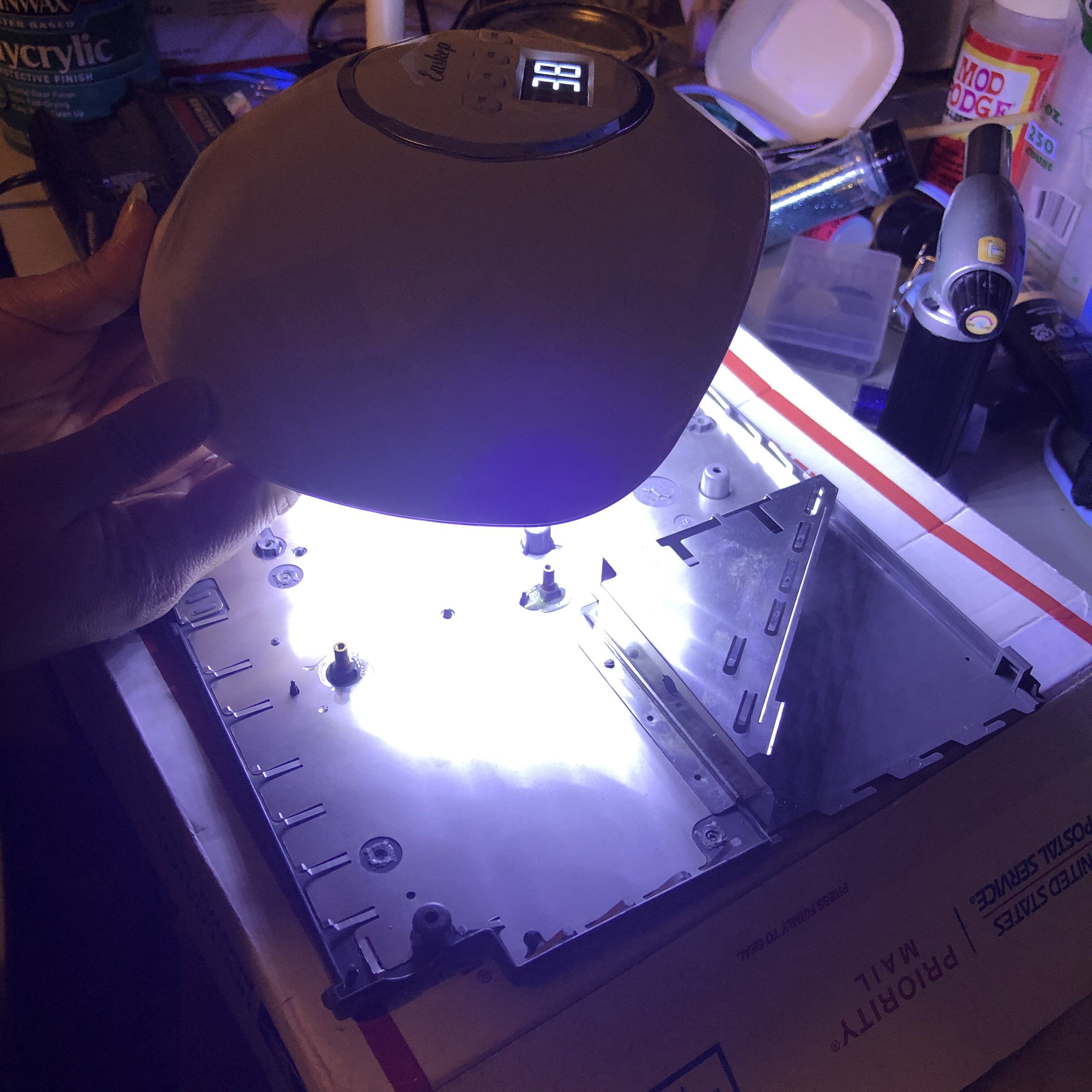

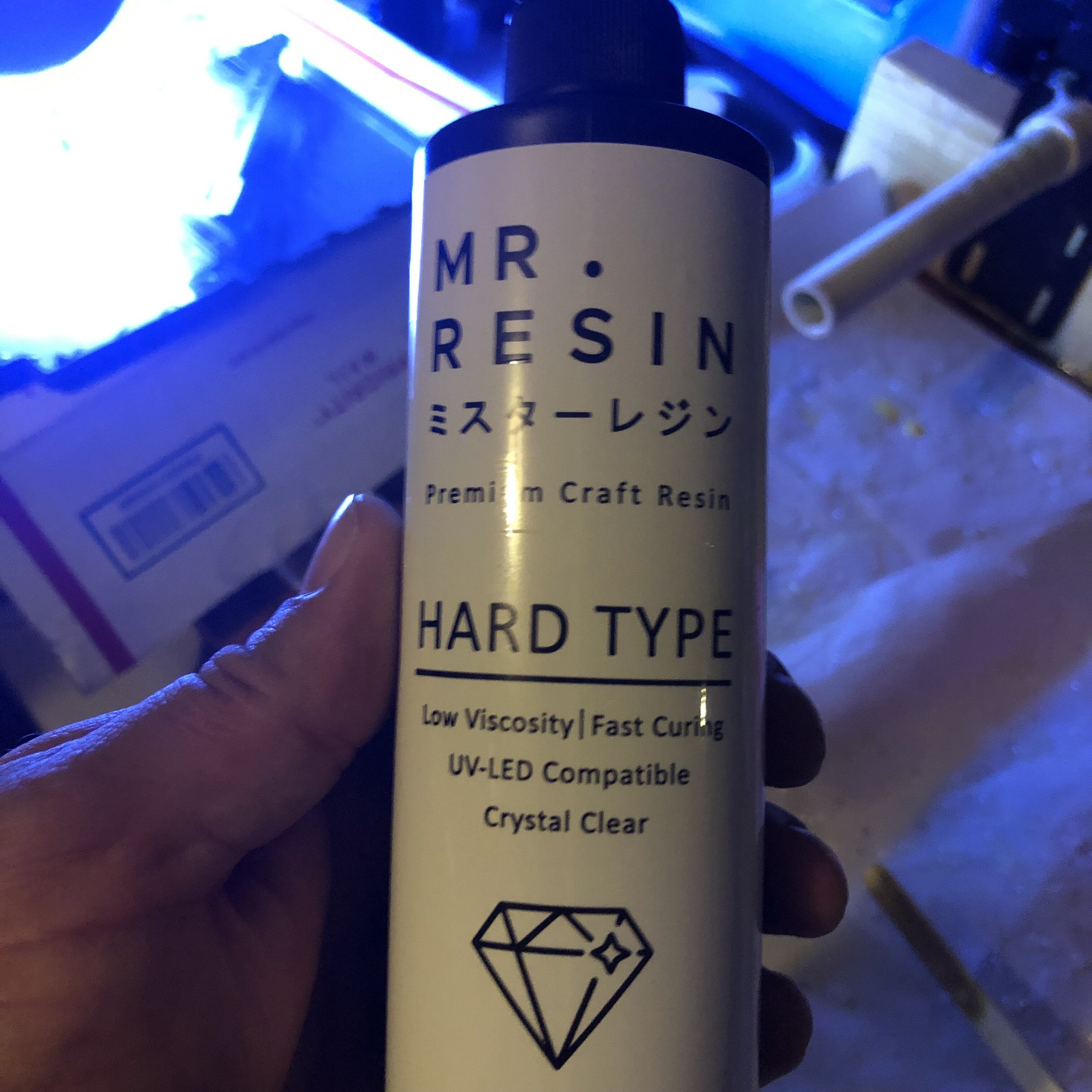

Stand-off repair is complete for the bottom half of the machine. Very happy with the resin I used.
Projects remaining for bottom half:

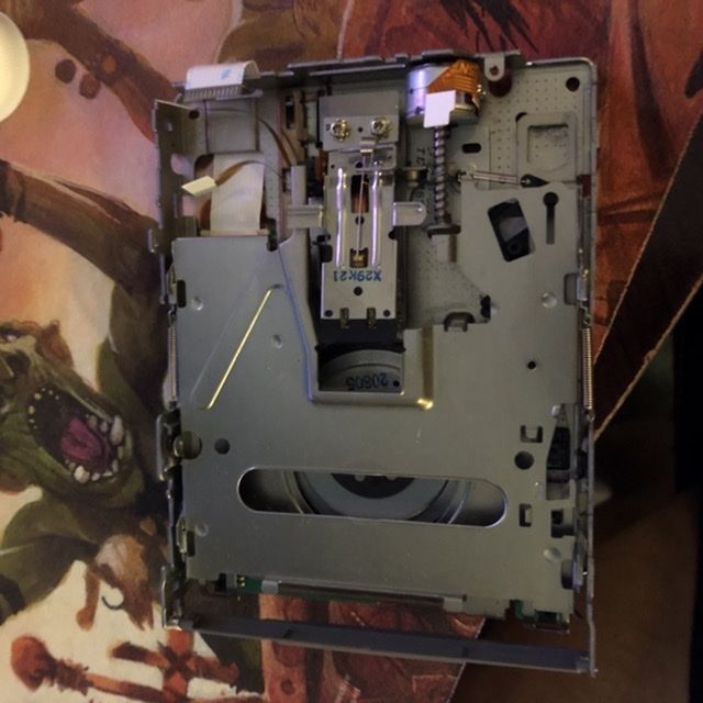

1. Research refurbishment of disk drive

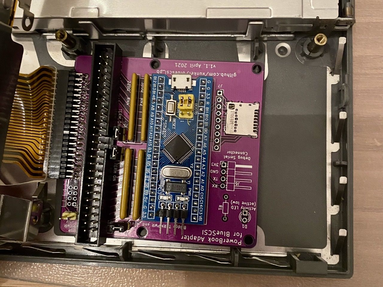

2. Look into building PowerBook BlueSCSI

Adding the BlueSCSI is a great improvement. Having it running silent is neat.

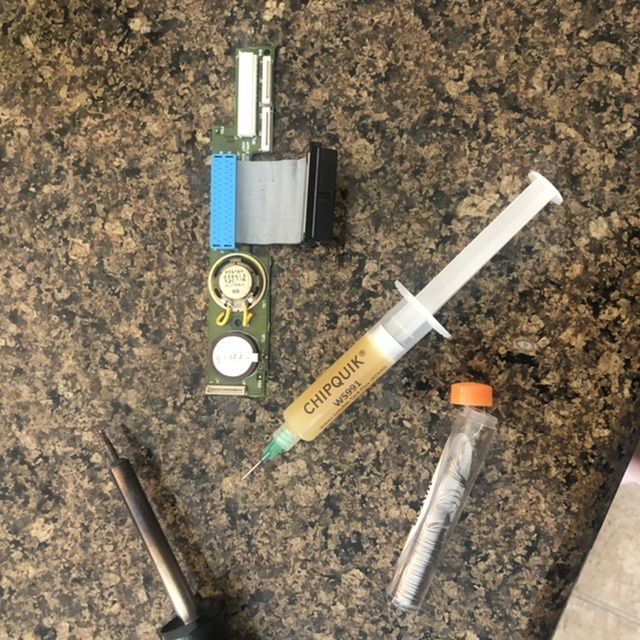

I made myself these:
I just miss the network capabilities of the RASCSI.
