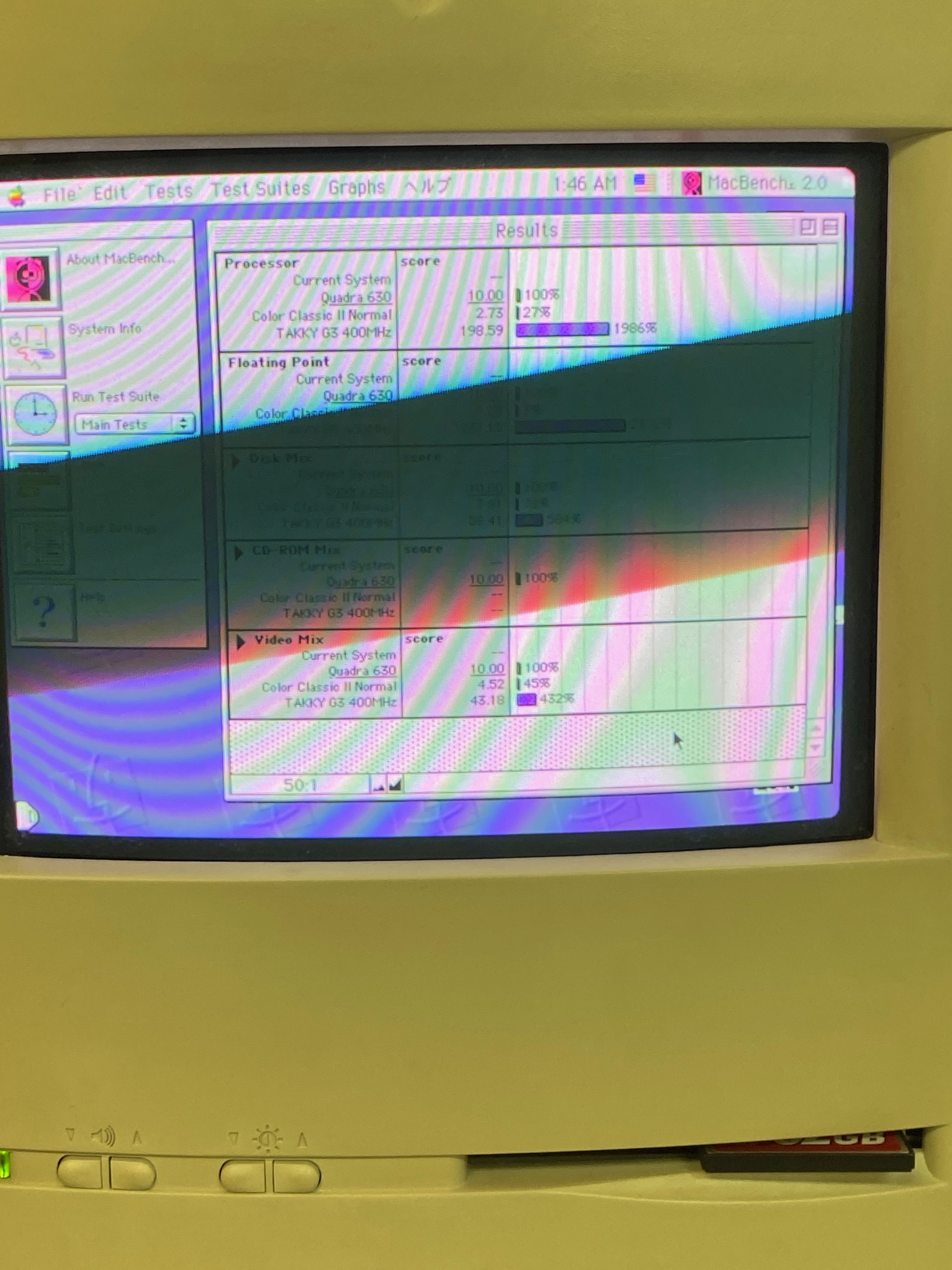

Hahaha, this is my takky(No.2). Do you think this is slow :LOL:

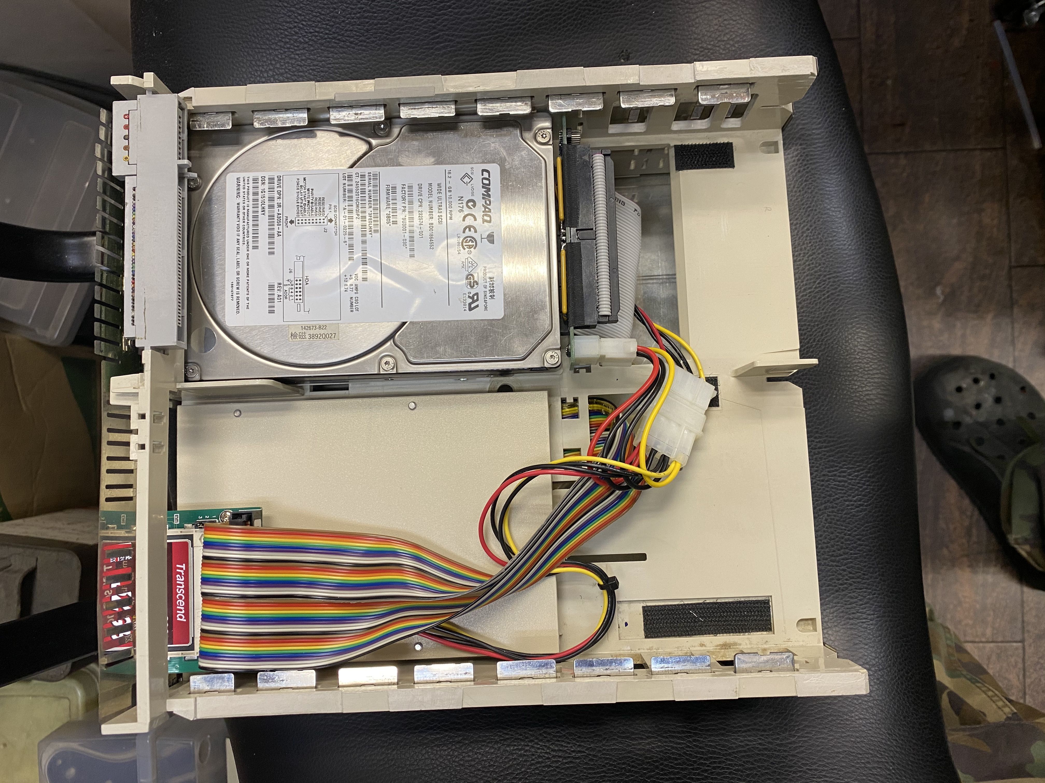

What’s with the CF card in the front? How are you doing that?

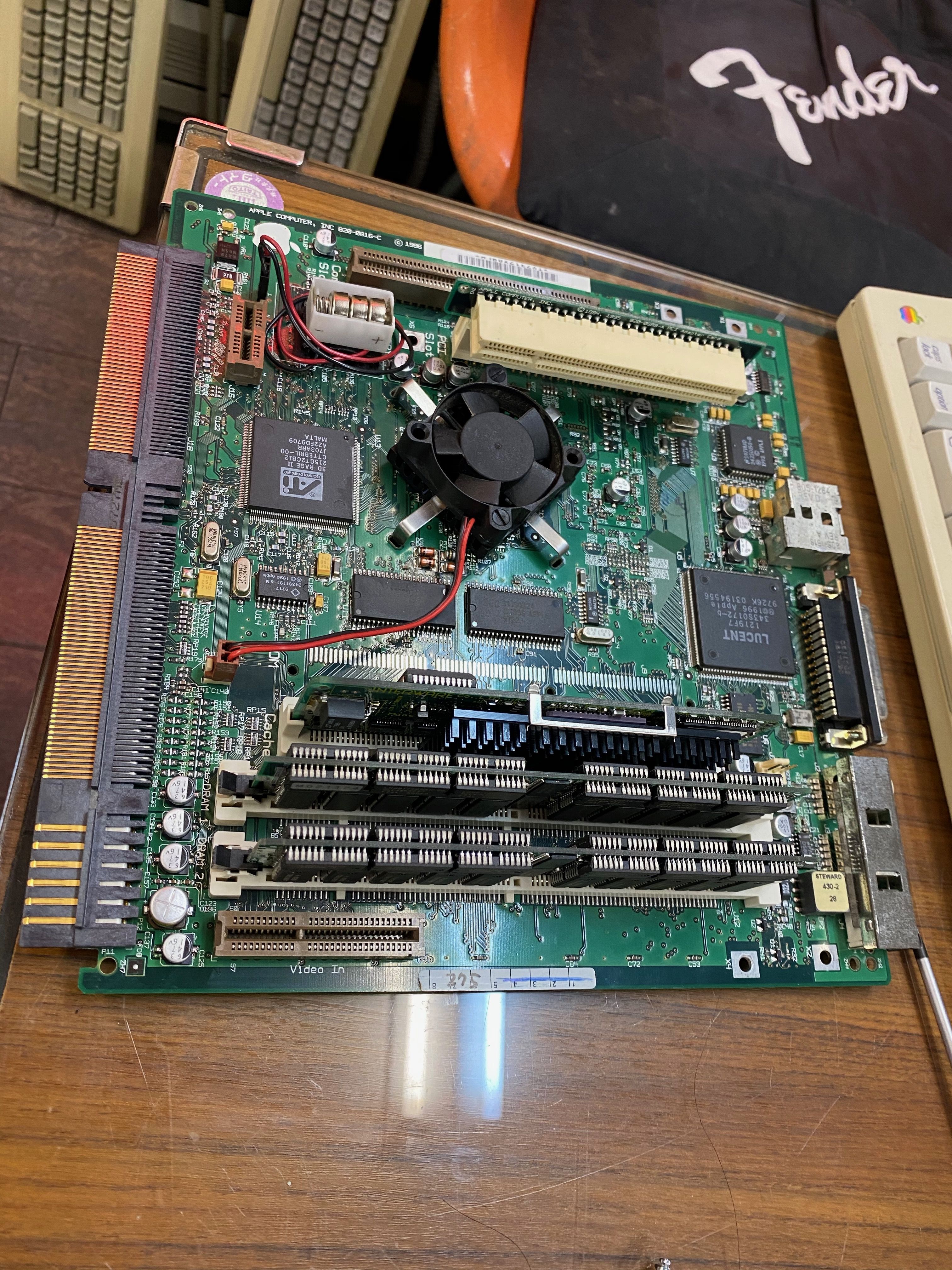

This Takky No.2 had IDE socket cause it's Gazelle 275MHz logic board. Gazelle and Alchemy has IDE and SCSI both connecters.
CF cards r compatible with IDE(ATA) w/out a controller chip. U can buy CF card adapter from anywhere, Amazon, ebay...
